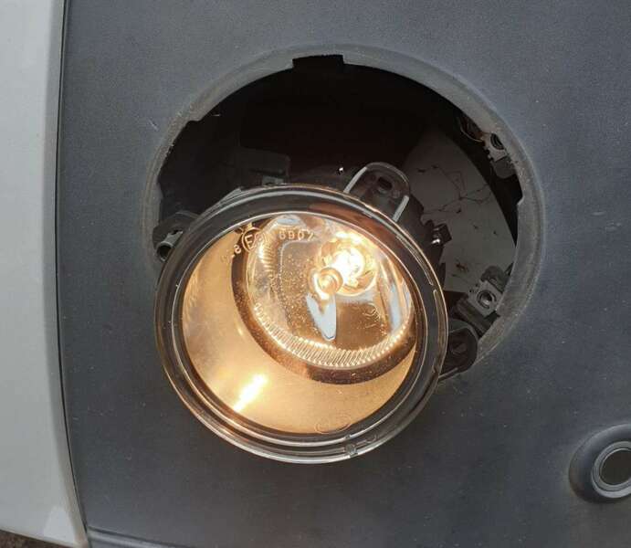

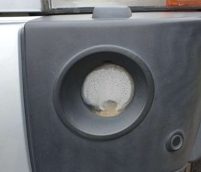

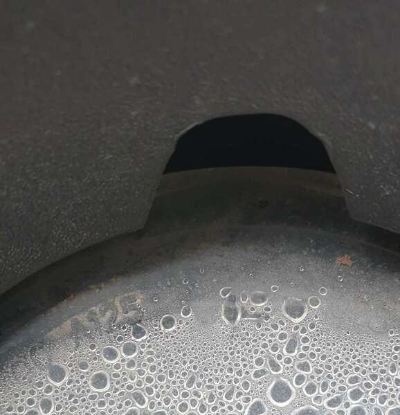

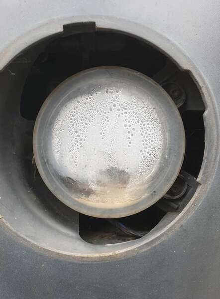

So, the Disco 3 had crap fog lights, the left one was letting in moisture, the right had gone cloudy.
Even though she is on the naughty step, I ordered replacements from Powerfulluk Ltd. Largely because they also provide a long handled t20 with the lights. Saved me a trip to Halfrauds. Also came with fresh bulbs.
First the bezel needs to be removed.
Small finger shaped hole at top of bezel. Very good at cutting your finger, quite shit at pulling the bezel out, but got there in the end.
Then three t20 screws and out it pops.
New light is shiny :)
Clip, unclipped surprisingly well and new unit attached and tested.
Then screw back in place and put the bezel back.
Then do the other side.
Piss easy, but satisfying that I've slightly improved it.
