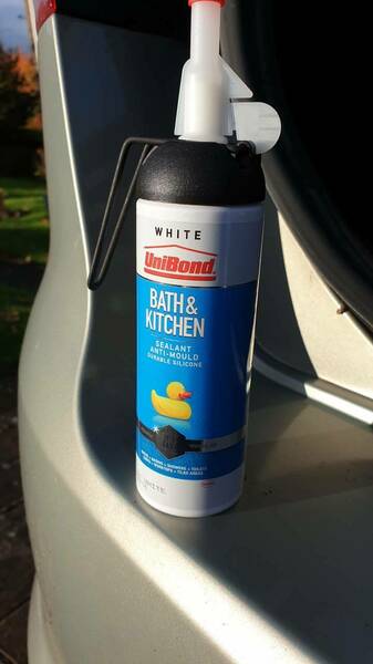

What the storm made crystal clear, was the water leak, that's been present since purchase needs to be sorted, as the boot carpet wasn't just damp but wet.
So I went shopping for some bathroom sealant and brake cleaner.
The Boot gutters on the Mondy are filthy, cause I don't clean it.
This is the better cleaner side.

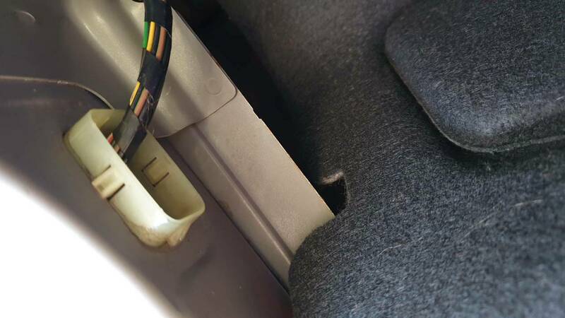

The water is getting through the wiring loom hole on the nearside.
So liberal amounts of brake cleaner applied and cleaned up the boot shut.
Access is difficult and im crap with applying sealant, so its not pretty, but hopefully effective.
I'm hoping this cures it.

Gromit leaks..... My Savvy had the same on top of hatch aperture (wiper wiring/washer tube route) = black gunk *Black car 🙄
Brand New 🤬... Gromit 'rattling fit' in hole.
*Deliberately avoided 'free warranty' dealer interface = fixed right & 1st time 😎
