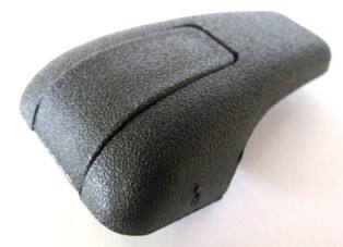

What in the name of god is a curry hook?
the curry hook was supposed to be for hanging your takeaway from so that it didnt fall everywhere and make a mess. you hung the carrier bag from it, totally useless in practice

It's on the passenger side of the front console. I used it a few times to hang my bags of chinese takeaways from. As @big_al_granvia says, I was jonny no mates on those occasions . :mellow:
