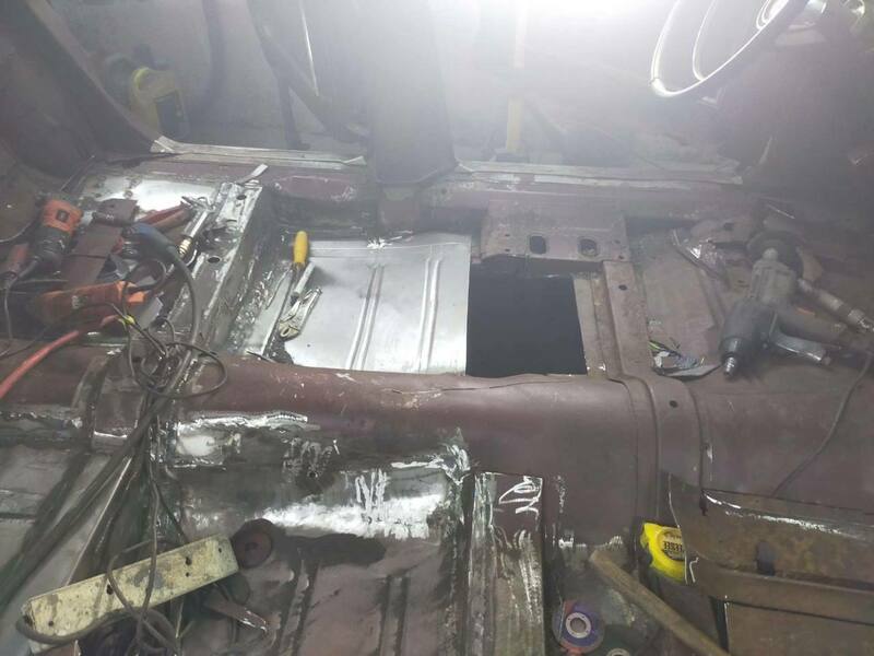

GingerNuttz Posted August 24, 2021 Posted August 24, 2021 I've got some more pics of how bad it was Give you an idea of how much was replaced just under the back seats anonymous user, sdkrc, dome and 15 others 17 1
PhilA Posted August 24, 2021 Posted August 24, 2021 All just plugged space with no real way for a leaky door to drain to outside. That's about right.

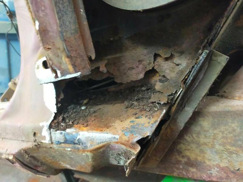

sdkrc Posted August 24, 2021 Author Posted August 24, 2021 I've left out a fair few photos but there are many inconsequential areas with minor crust which collectively formed a lot of work Tail light The boot structure vulgalour 1

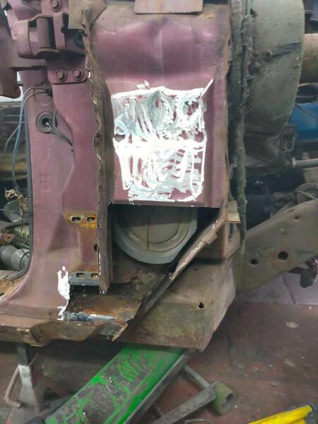

GingerNuttz Posted August 24, 2021 Posted August 24, 2021 Inner wings too including a battery tray that was non existant 😂 Other one was just as bad Jim Bell, Skut, Shite Ron and 9 others 12
