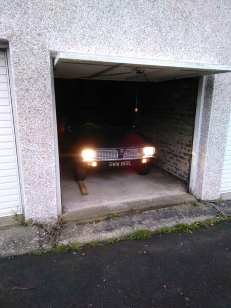

The Toledo still had sealed beam headlights and one of them blew on dip not long after I got the car. So what to do? Dolomite 1300 headlights are a straight swap and have a regular H4 bulb fitment. Downside is they are only available from Rimmers as a complete assembly with the back shell and cost £118 each! While not adverse to spending that much on car parts I didn't want to just yet as the headlamp mounting panels are 50% metal and 50% bran flakes and hope. I will address this in time but wanted a cost effective interim solution. Internet wisdom suggests Bedford Rascal headlights can be made to fit so I rolled the dice and spent £34 on a pair delivered to my door.
They are 10mm higher and wider than stock so the retaining rings and adjusters don't fit. They do fit perfectly straight into the bowls though and can be held in with a mixture of old and new hardware that still allows for a degree of adjustment for alignment.
The downside is that the front of the lens sits 30mm further back in the car than before so the bowl needs to be packed out from it's mounting panel on spacers.
It does look half devent (from a distance) though. While it was apart I rubbed down the grills and sprayed them with some generic silver wheel paint and polished the bumper.
Next up was to fabricate a wee bracket to hold some relays
....and wire the hi/low through them to take the strain off the headlight switch.
And there you go, nothing award winning and it's still a 30ft car but it's well enough done to last a long while and has functioning lights with replaceable bulbs. I even used lucas bullet connectors to tie into the existing wiring so no original parts have been hacked!

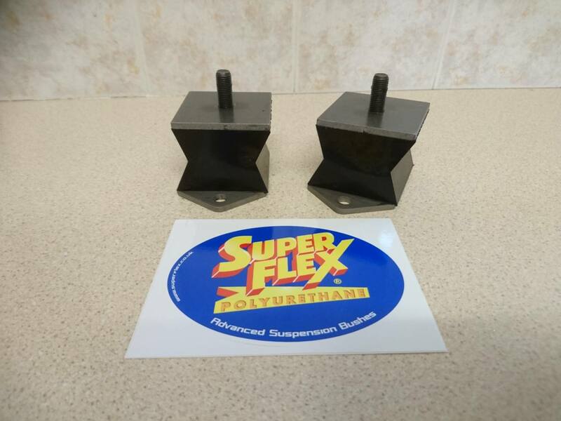

Bit more Toledo love. Had to wait a while on them being made but these beauties arrived in the post.
New front engine mounts. One of the ones in the car was in tatters making the engine sag too low and bounce around too much at idle. There are only 2 choices for replacements. Cheap repo parts that are the wrong hardness of rubber and will be toast inside a year or these beauties that are the correct shore hardness of poly mated to stainless backing plates. £80 a pair but worth every penny.
A pair of jacks were deployed and they were replaced one at a time. The totally foobar one came out in two pieces.
The other was still in one piece but starting to go bad. Original metalastik so a fair old age.
Made a massive difference and worth every penny.

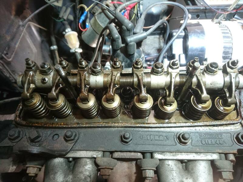

Check out how clean this valve gear is.....
Clearances were all still pretty much spot on so to celebrate I painted the rocker cover.

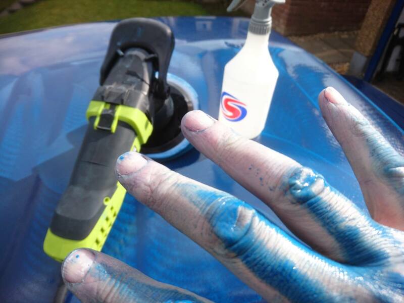

First up I cashed in a ton of nectar points to get a DA polisher from Argos for a net cost of £0.00.
I then set to with a bottle of metallic t-cut chosen because I'd had it lying around for over a decade so it too cost £0.00. Net result was I ended up looling like a smurf...
But the bits of the car with good paint looked jolly good indeed.
These pics were taken after giving it a coat of MER polish post t-cut. Again the polish was chosen because it'd been lying around forever.

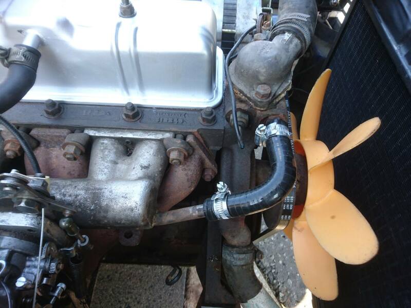

Next up was replacing the perished heater hoses. The two 90 deg elbows were replaced with silicone elbows and the two longer shaped hoses were just replaced with good quality coolant/fuel hose. Hopefully they'll last longer than the repo ones that were on the car and falling to bits.

What's the score with buying silicone hoses? I need some new ones for the back of the Cavalier's inlet manifold but they bend at quite an acute angle. Can you choose from a range of diameters and angles off the shelf?
12 minutes ago, Split_Pin said:
Nice job on the polishing, looks grand.
You sure can. Just search ebay for "silicone elbow" to see what's available. Large variety of diameters and different degrees of bend. You can also get aluminium joiners as straights and bends which make replicating more complex stock hoses possible.
I bought these ones simply because it was a big UK based supplier with massive feedback selling branded parts.
https://www.ebay.co.uk/itm/45-90-Degree-Silicone-Hose-Bend-Pipe-Elbow-Air-Water-Boost-Intercooler-Pipes/401823561758?_trkparms=ispr%3D1&hash=item5d8e8cf81e:g:SO0AAOSwfmFeKsKt&amdata=enc%3AAQAFAAACcBaobrjLl8XobRIiIML1V4Imu%2Fn%2BzU5L90Z278x5ickkTboA95HSvGa1O5UmCCGJLqaj4cwQYPnk2YPtj1vnojEGf%2BPF9VK4ylLbt7jnRbupsIIbVIkVD9RfXWZ3RTCQWMOdMzHifmihUGC0hr7I4BNkDiHkeuKlRaI9wZwrakPZDRDU%2BIHg2ZSl8j5X3R8pljDKYJVDD0kBCTOe3GuaZf4cGTL4uKrsqcogpON%2BNkq8R%2F6uZdH5OO%2FNeiEGkIVOnO%2B5c8CYwKGV9X%2FTQvmPbWG2AOttz%2Fj9ED5boGhFmBhl8eo4l3EAblcS3ALAO7f5i5BVCt1%2B1g55pAL6%2FyxdCoRQ4jkVoVAZ0EWEC9%2ByJRuWB%2F5ma%2FaIT%2Fe6IVb7azQaBrJvMPGUFQCOe4gfq966aZgyCywn0gplTTM4PLp07xdEuLsdzCwRNKTwbrXocgk0PVPGK3oX71pIvT5Vanz25tl7nm%2FDYvaJQF7Fdtyh5mTVJuIrkQUOQ4Wvu%2FvkVk0YHZeWMZPMGDmO%2BzPZaQ6JNnnkM8Nr7MxduQSYBAjCtYZgyYRTPLvkUKSoizL%2F7U7gFDzsPJsoVr25FczU8mGPVg%2BlEDG9dLp%2Bul6dZdeLdVRYBmWw%2FjUzMeFHAEqLgI6ne2WQCfz4cC3N8c%2BfxSIGR7blBHDlgI290HGa1CH%2Bf%2FtXJZN9u69oyVMrF%2F97fgZ%2B5XzfCEBYnrsvQjLP3BQp90Kv5ObcXg6IhtpHOkP2g%2B5HWnfGJlMW%2B6jEI01IxgIrlFl7g%2ByQDdEFEQrwCIfSfPE8k05DaAqceLasIlXk1tMyJ6HE6yqrSOHo4FGrE1i%2FAw%3D%3D|cksum%3A401823561758f44796b0fbb74734981bd2faac1ed7ee|ampid%3APL_CLK|clp%3A2334524

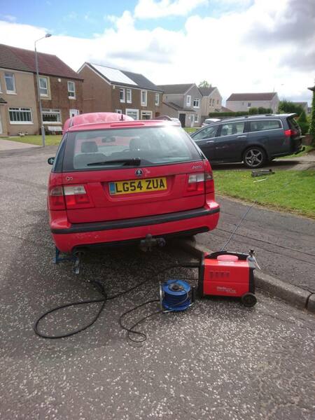

So the Saab made a return to the fleet a few weeks ago after being out on loan to @captain_70s for the last six months.

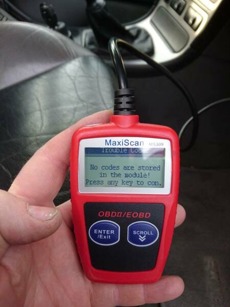

First order of play was to address the random refusal to start issue as documented in the captains thread.
Code reader wasn't giving any clues...
But the culprit seemed pretty obvious. Symptoms were sometimes not cranking in the start position, sometimes cranking but not starting and one time cranking, not starting but then bump started as soon as the clutch was lifted. Everything pointed to a faulty ignition switch.
Haynes rate getting to the ignition switch as a 3 out of 5 spanner task on the difficulty scale. Can't be that hard can it?
Yes it can! Getting the gear change mechanisim disconnected was a real swine as the connection is inside the big anti theft gearchange unit that holds the ignition switch. Eventually swearing and determination paid off and the unit was removed.
New* switch was obtained from ebay.
And was transplanted into the base of the unit.
Back in one piece and Saab goes vroom once more. Might be a heap but it's still a very fast boosted heap.

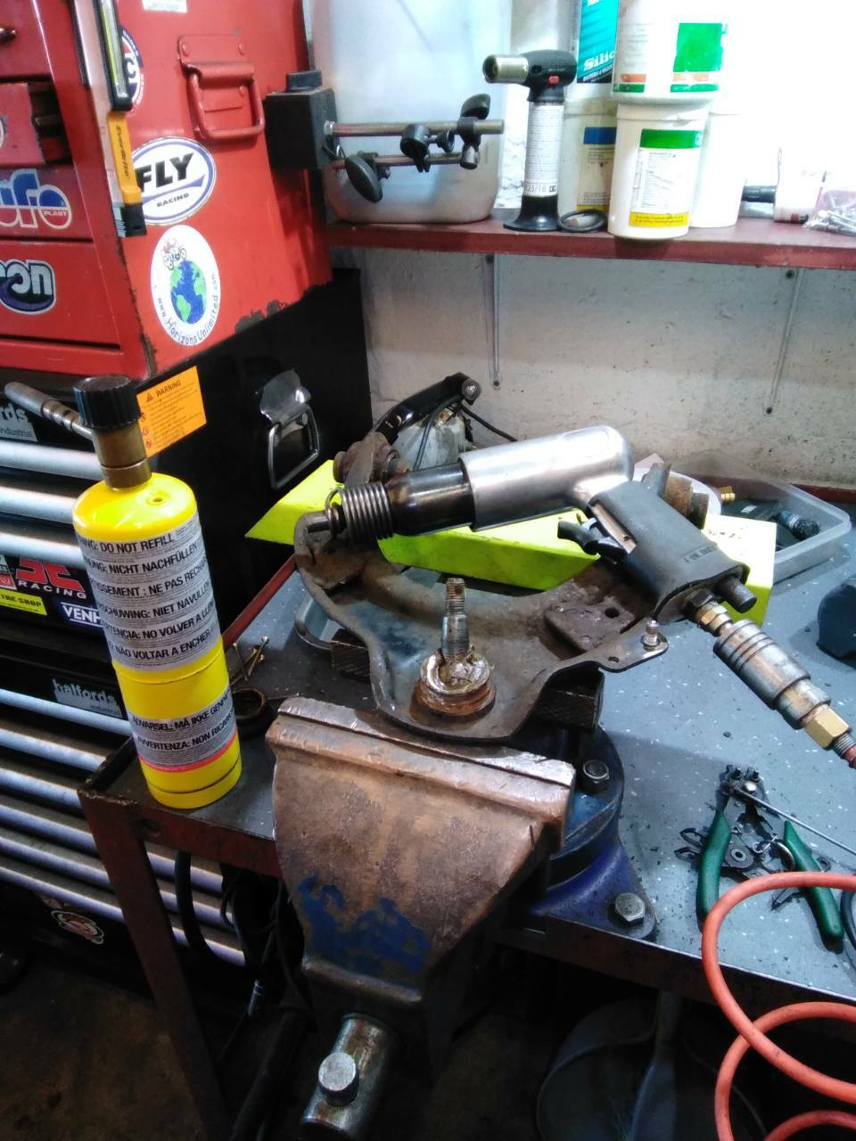

Very long time without an update, my bad! Not a lot of tinkering has gone on at boilersuit towers for many months as work has been really busy in the second half of the year and I've been focusing on long overdue work on the house and garden when I wasn't working. A month ago though I noticed some uneven tyre wear on the Accord and investigation showed an upper control arm ball joint had a bit of wear.
Arm was pulled out with greater ease that first inspection suggested would be the case.
Then the ball joint was removed with the assistance of fire and an air hammer.
New giant g-clamp style ball joint tool was procured from eBay. A snip at £50.
Despite the kit coming with a "comprehensive" set of sleeves to suit "most applications" a 3/4 whitworth socket still had to be added to the mix to press in the replacement joint.
To finish the repair a scrappy special wheel and tyre combo was added. Rim was in mint condition and the rattle can repaint is a perfect* colour match for the rest of the wheels.

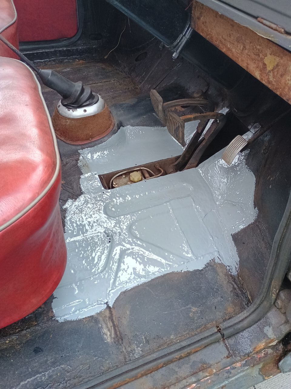

Next up was to look at the brake/clutch master cylinder. Like a minor this is under the floor in the chassis rail and the cover looked like it hadn't been removed in a hot while! I have all the parts to go through all the brakes but wanted to assess just how bad things were.
Took a while but I managed to get the screws out and the plate off.
Assessment is rough but not immediately dangerous so brakes can stay #2 on the list after the engine for the time being. Major relief also fealt after finding the chassis rail was solid!
While it was apart I cleaned up the worst of the loose muck & rust on that section of floor. Gave it a quick acid wash and then slapped on some zinc primer with a brush. The cover has some rot so that'll be welded up and painted before it goes back on.

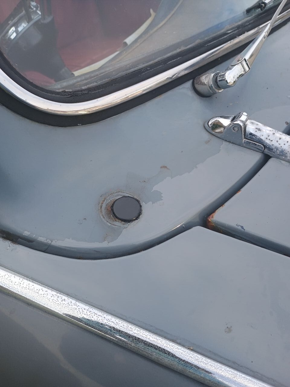

Next on the list was something that had been doing my head in since day one. The outer drivers door handle was falling to bits, the inner handle was sticking and the window wouldn't move.
The front end of the handle should be held by a retainer that bolts to the door. It's a rubbish design and the only advantage is being able to remove the handle with a single screw that's under the door seal without having to take the door card off. I tried to adjust the original handle then swapped it for a spare but it was still the same.
The front end of the handle has a hole for a rubber stopper that's supposed to hold it into the retainer. This hole is just the right size for an M5 helicoil.
I helicoiled the spare handle because it was the rougher of the two, fitted a stud and made a missing rubber seal from a piece of old inner tube. Everything fitted and it's as solid as a rock.

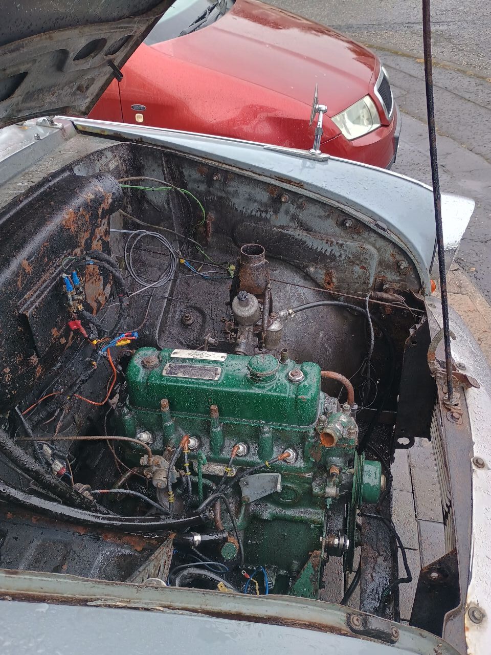

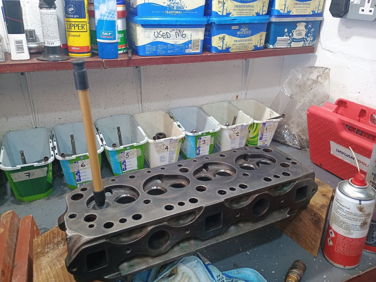

Talking of bigger chunks of work. I started in on the engine today so that'll be the next installment. Watch this space.....
And so it was time to start in on the Oxfords tired old engine.

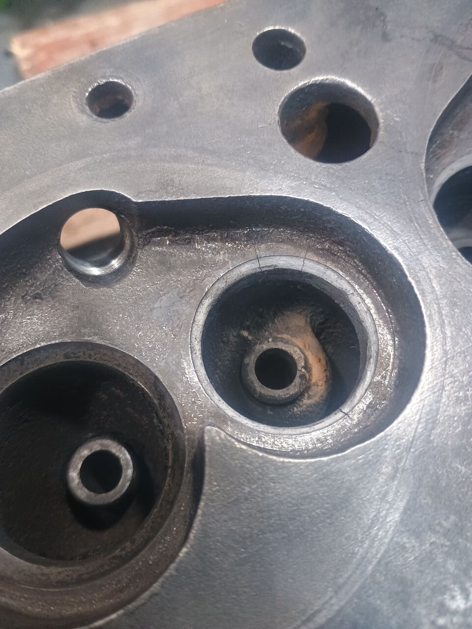

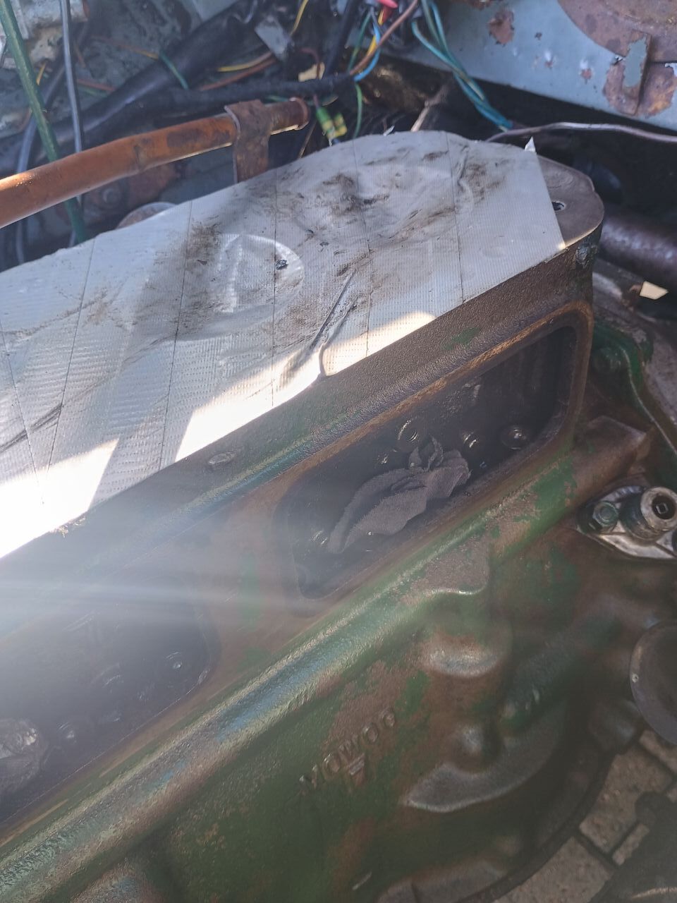

Plugs out, I wonder why cylinder #3 wasn't firing 🤔
Head off, oh that'll be why......
I wonder why piston #4 has so much oil sitting on top of it 🤔
Oh, the cylinder wall looks like the hull of the Bismarck.
The cylinder damage is obviously very old, looks like a rust seizure from water lying in the cylinder. All the bores have a big ridge so it's seen a few miles. For the purposes of the current mission though nothing is a disaster. The goal is to get the engine back to being a rough runner that'll start reliability. It's always been a tired and smokey old bus and we can still get back there with hard work but minimal spend. A lot of scrubbing later and it's cleaned up ok.
Both a and b series  blocks can be prone to "pulling up" the threads for the head studs and unsurprisingly this was evident so all the stud holes were countersunk to keep the surface flat.
Then the deck was taped up to keep it clean and all the carbon & sludge cleaned out the timing chest. The drains to the sump were stuffed with rag to stop the sludge going where it shouldn't. Scrapers, brushes, WD40 and LOTS of compressed air were deployed but eventually everything inside the timing chest was clean.
Once the chest was cleaned I pulled all the lifters, wire wheeled the carbon off and refitted them with liberal amounts of fresh oil. They're all lightly worn but still perfectly serviceable which would suggest the cam is too.
The timing chest covers show the extent of the carbon & sludge build up.
After soaking & scrubbing in petrol, then degreaser then washing and wire wheeling they look a bit better.
Next the head had all the studs removed, threads cleaned up and all the crap was wire wheeled off.
Valves out and the laborious process of lapping in burnt exhaust seats began.
Much like the bores the head really needs a proper refurb but is still within the realm of salvaging a rough runner for close to £0. The whole car is tired so I'm making the best of what's there without going crazy to get a functioning car in as short a time as is practical. The inlet valves are all saveable but the three exhausts that are still whole are burnt beyond lapping. I've ordered 4 new old stock ones for £27 delivered so this repair is not going to break the bank. While I wait for them to arrive I've spent nearly 5 hours with the twiddle stick lapping in the burnt exhaust seats with one of the old valves. Cylinders 1 & 2 are fine. Cylinder #3 (with the burnt out valve) has three cracks in the seat but they're localised to it'll still do a turn. Cylinder #4 exhaust valve seat has sunk like the Titanic and has one small crack but it too will still do a turn.
The inlets still need to be lapped in and then the new exhaust valves lapped in so there's still a bit of work to do.
Yes it's all rough as feck and definitely close to end of life for a lot of parts but I'm still confident I can build an engine capable of doing a couple of hundred miles a year while I work through the rest of the car - even if it burns a gallon of oil in the process!

It is quite impressive this car ran at all with bits of valve missing and no cylinder walls!
I remember it a year ago settling down to a steady 850rpm idle despite a good 50 years of neglect...
Do we think this is a coveted Riley engine or just a boggo B-Series with the wrong rocker cover?
It looks like its a Riley engine by the size of the exhaust valves. There was also a bracket for a non-Oxford air cleaner bolted to the head and the documentation that came with the car has a photo of a different engine in the car in times gone by. That was pre @Squire_Dawson owning the car so a decade or more ago. Looks like a pukka Riley engine, all be it an utterly fucked one 😂

Then I sacked off the abomination of a 90' rubber aerial from the scuttle panel, replacing it with a grommet held in with tiger seal.
