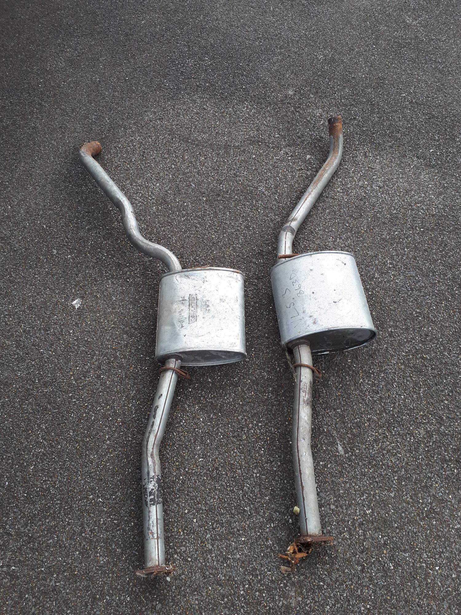

It's dumped on my parent's driveway for the time being.  But hopefully we can get it up and running before the current MoT runs out on the 12th September.  Mind you, how it got one with an exhaust like this is beyond me.  It can't be a recent thing I'd have thought.  When it first started it was blowing badly, so it's not like me ragging it around the block has caused it to go.
Fortunately I've got spare ones from when I previously had a Senator (cheers JohnK!).  Hope they'll fit as it'll save a few quid.

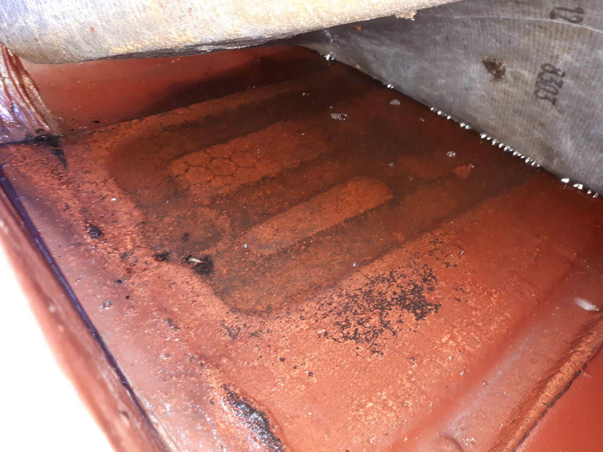

Plenty of water ingress.  This is the driver's footwell which I bailed out best I could, although the carpets need to come out fully for a proper job.  The sound deadening foam stuff is highly absorbent.

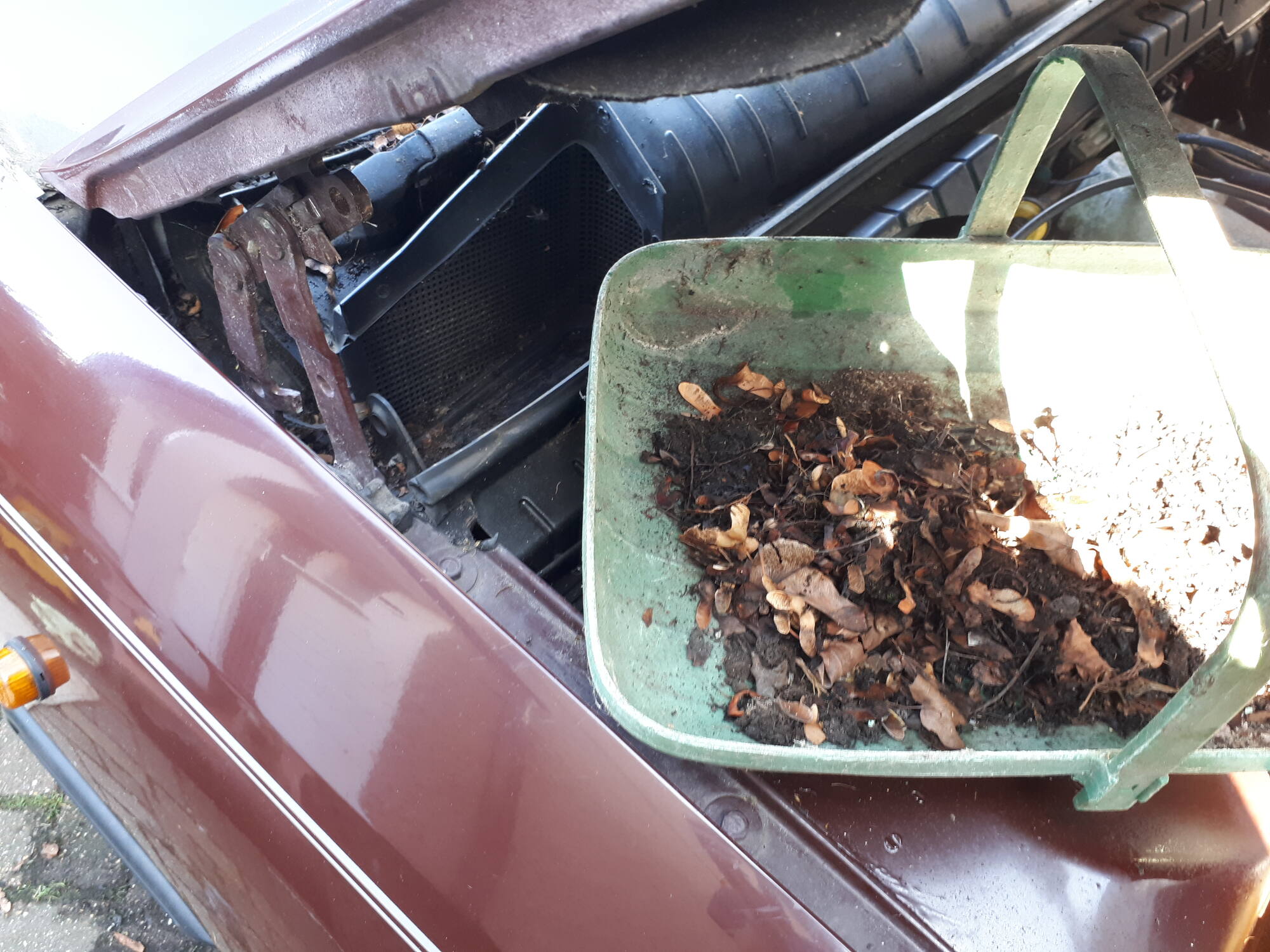

A spot of gardening in the scuttle has unblocked the drains, so maybe it's that rather than knackered door seals.

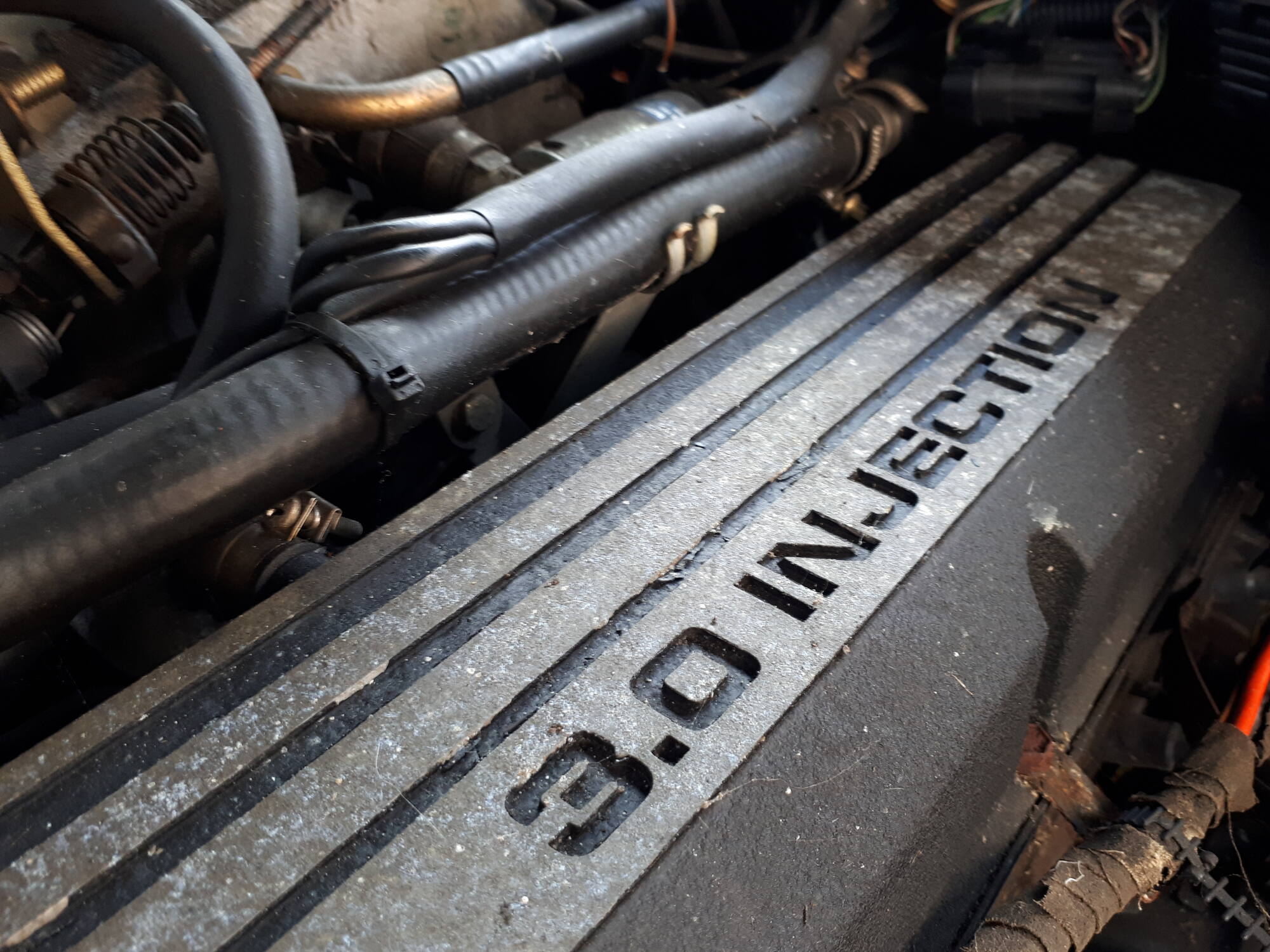

Engine bay backs up the 70k miles, as it's pretty tidy under there.

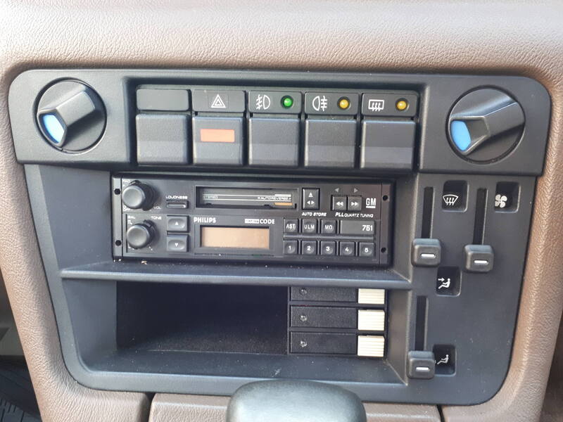

Lovely brown interior, and centre console simpleness.

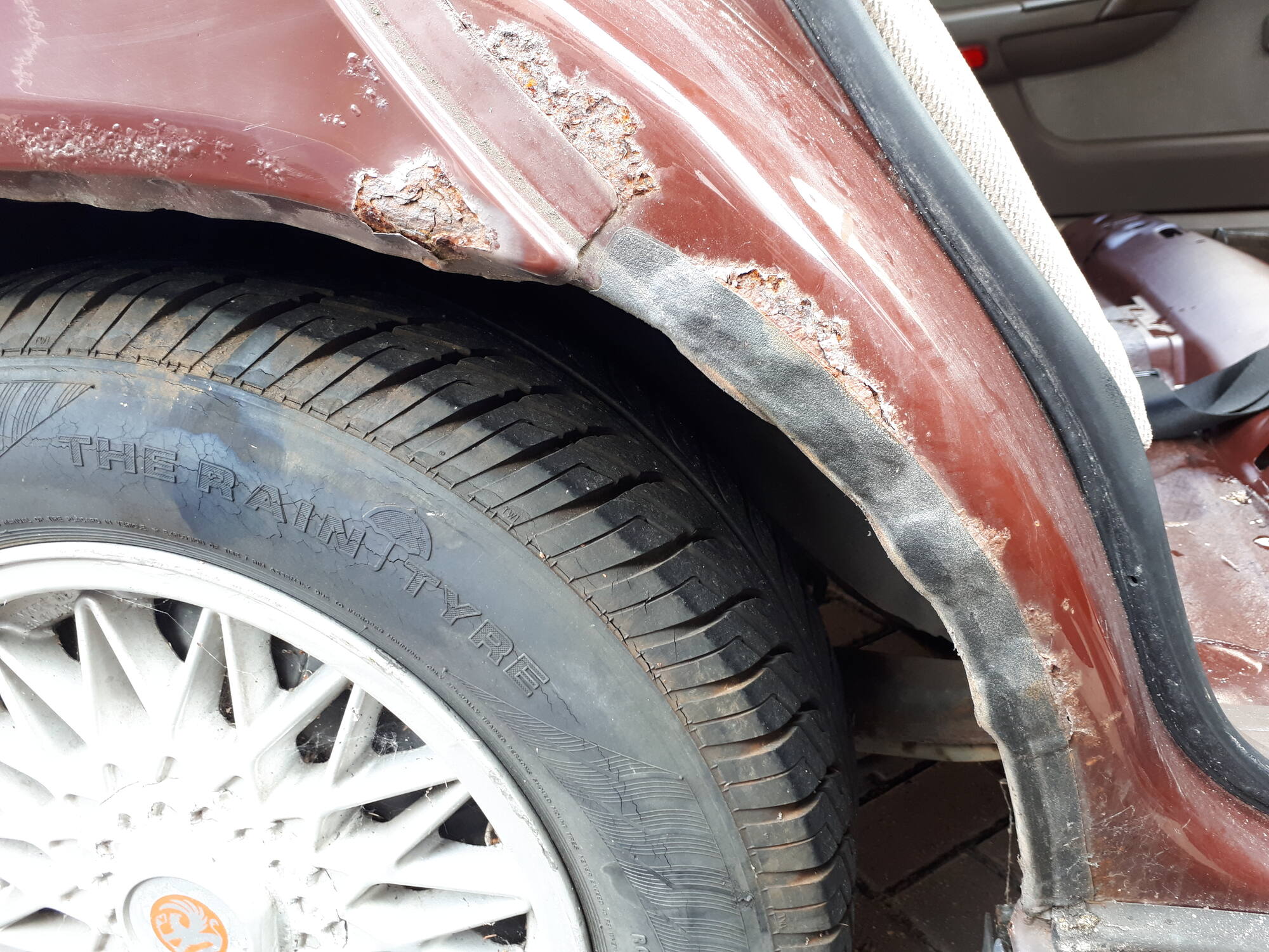

OS arch is crispy (best we don't touch that until an MoT is achieved), but for the most part it's not bad.  Sills are very good surprisingly, and that's the first thing I checked.  If they were shot the full length we wouldn't be here!  Although the bits by the jacking points are showing rust, but I dared to have a prod and it's just surface I think.  Didn't prod too hard mind.  Vactan over that and fingers crossed for the test.

Not sure that’s just a scab, to stop it getting worse I’d grind it back with the flap disc, very likely want a bit of metal letting into the lip then filling. Worth doing right though. The bit on the arch tub to rear wing seal I would chip the bubbles off and use Vactan or whatever on. Difficult without splitting the seam to make sure it’s rust free.
Yep, something does need to be done there.  We'll tackle it once the MoT is in the bag.  There's optimism for you, no If.
