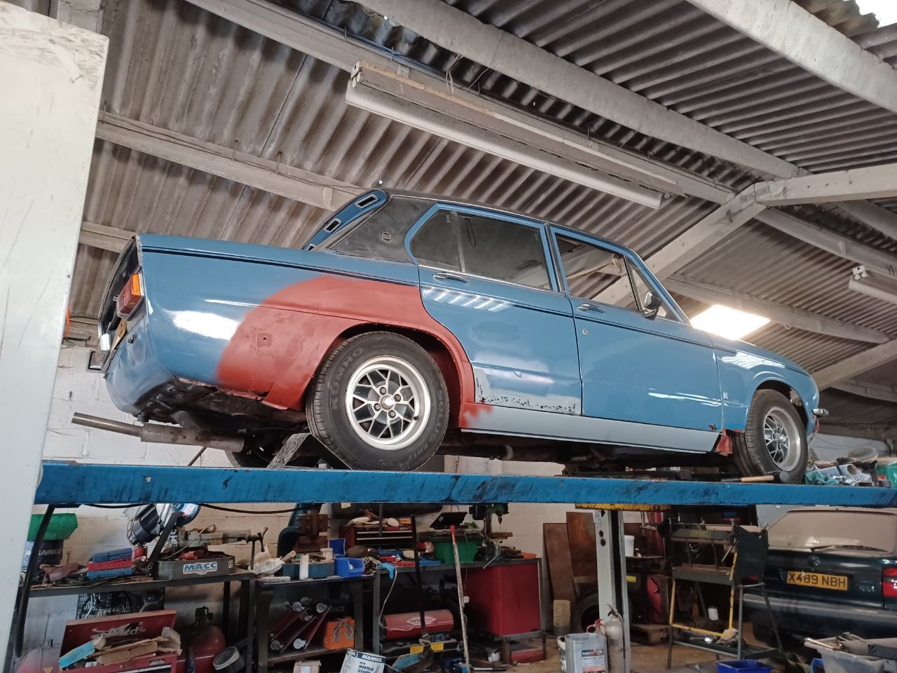

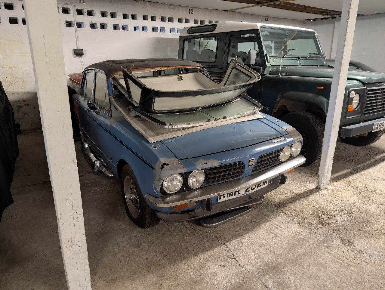

I was up at storage briefly earlier to check on the Cayman. While there I did have a quick look around at the sad old thing and what still needs doing.

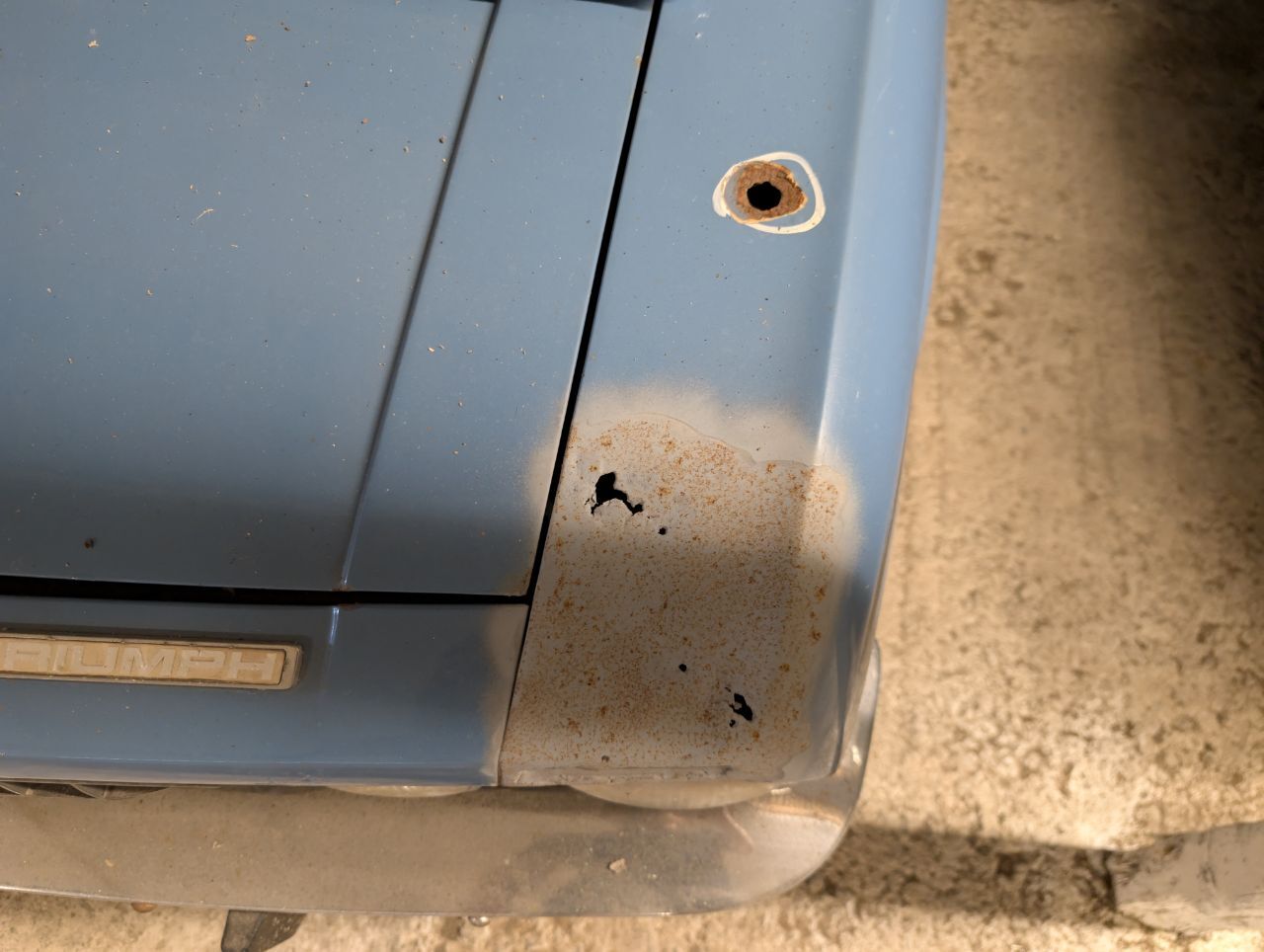

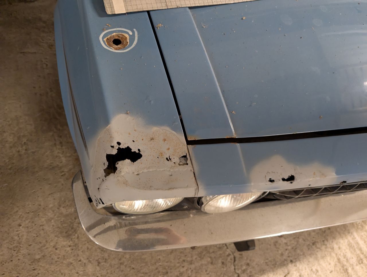

Front end needs some love. I'm less bothered about this now as it's not structural and I think a bit of filler/fibreglass/patching bodging will get this looking a bit more presentable. Or just duct tape. 🙃
I do have a complete NOS right wing that I could sort that side easily too. Tbh that is the worst side and it may need it.

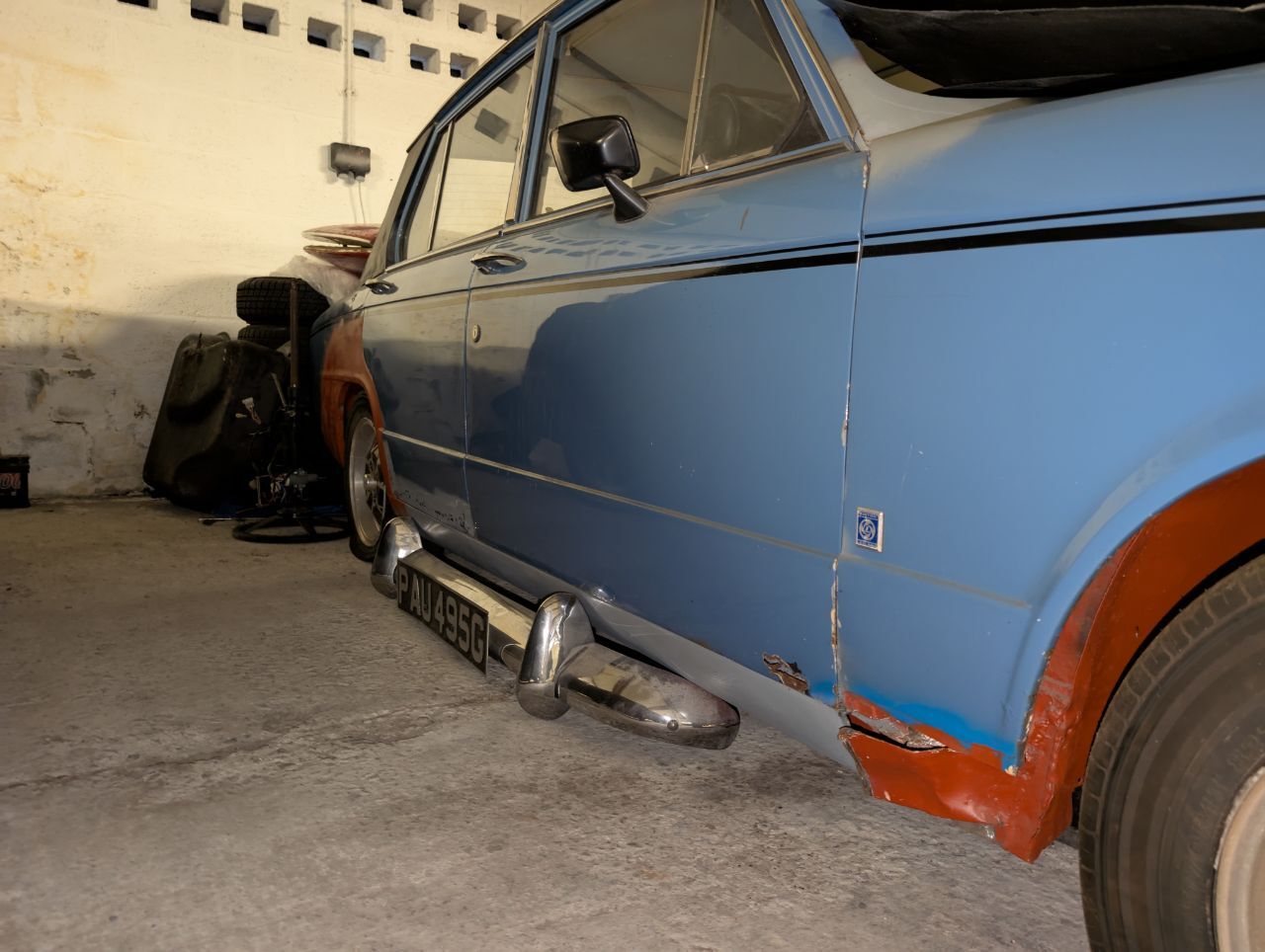

My offside repair has held up just fine. There is a bit of filler under here but it's solid after my repairs. Probably needs a further sand down. Rear door is buggered at the bottom but iirc I bought a repair panel. Or just live with it.
Nearside is where the majority of the bodywork is needed. Sill, inner membrane, rear arch and inner door arch areas need sorting. Apart from the inner door arch areas (which aren't that complicated), I have all replacement panels.
Honestly right now, I'm seriously contemplating paying someone to do the nearside metal work to speed this up. Yes it won't be cheap but I don't think a professional would take that long to do it, especially with the repair panels I have.
Then I can sort the front end, filler and rattle can paint.
I think that's the quickest way to get it back on the road which I'd love to do in not another few years...

Want to waste 8m30s of your life that you won't get back?
Well here is a walk around video going through all the crusty bits and where I'm looking for someone else to do some bodywork for me.
It's a lot tidier than mine was and mine was a daily driver!
Bloody hell, tempus does really does fugit.

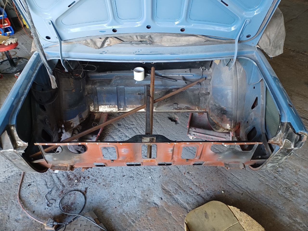

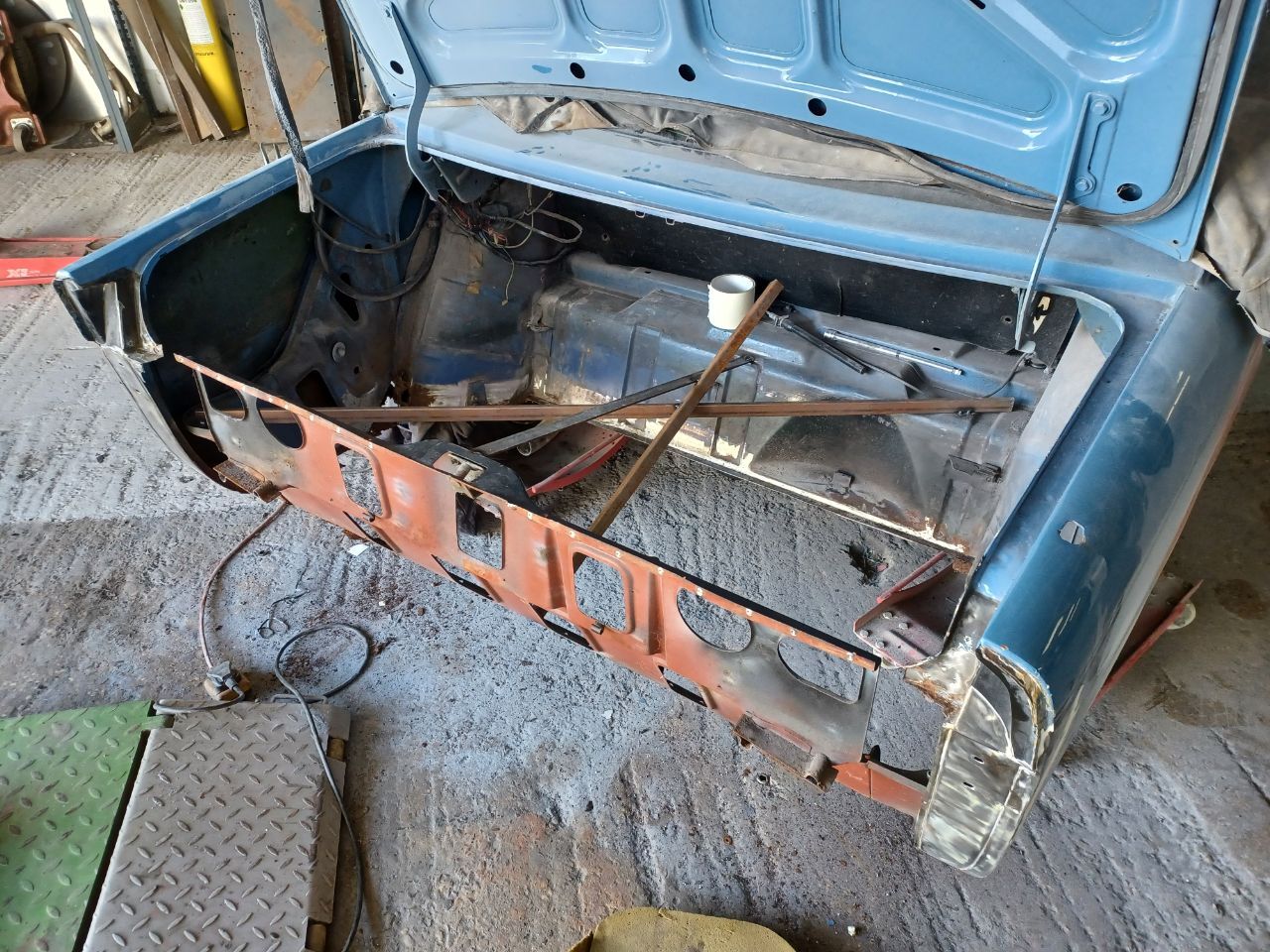

At least you found good metal eventually before there was nothing left on the back end!

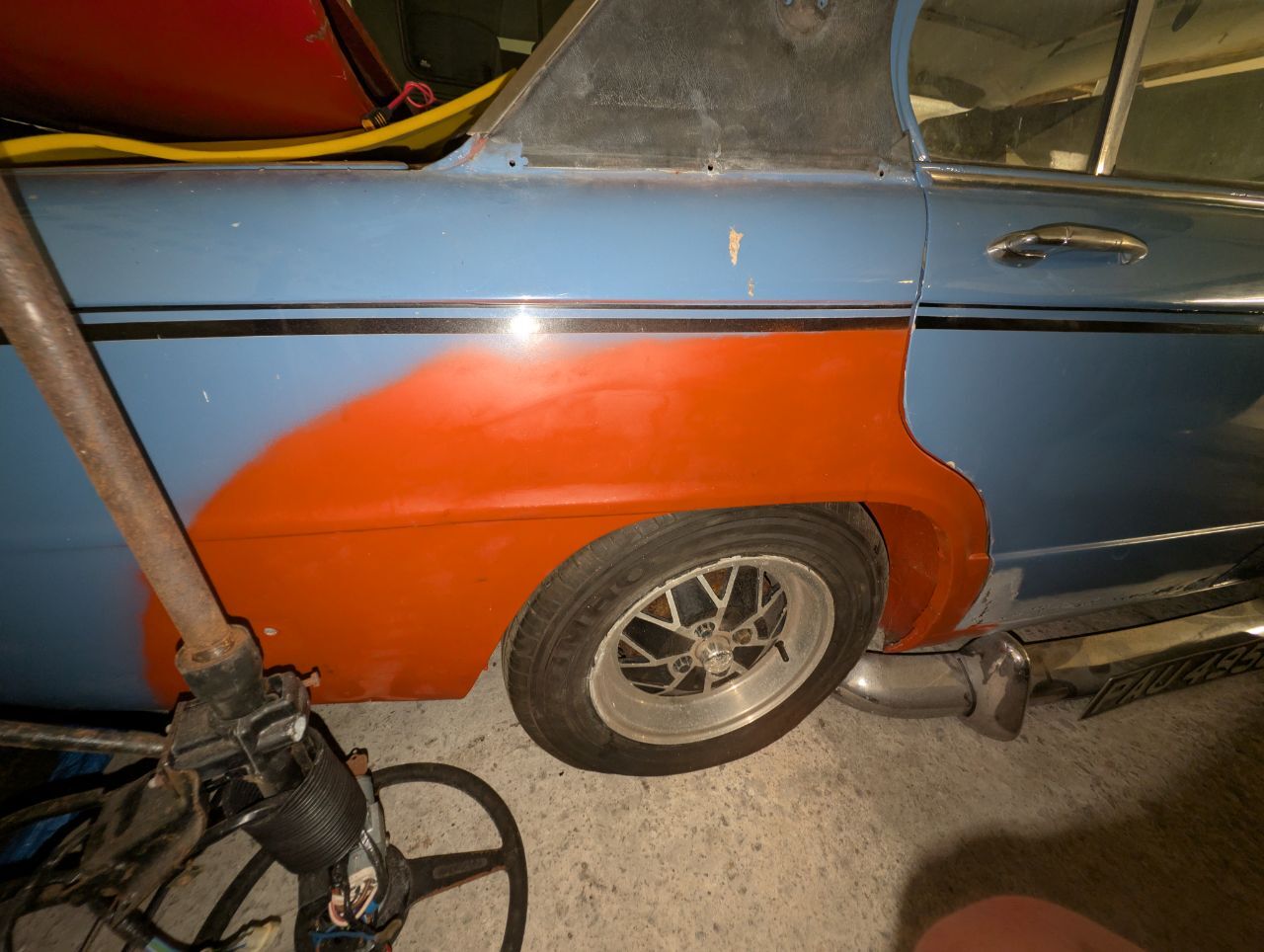

Shame the good metals a bit bent! Both rear corners have taken a bit of impact that tweaked the Offside more.
I do have a replacement boot lid that isn't rusty on the bottom. Not sure if I put it in the pile of bits or if it's still down at storage.

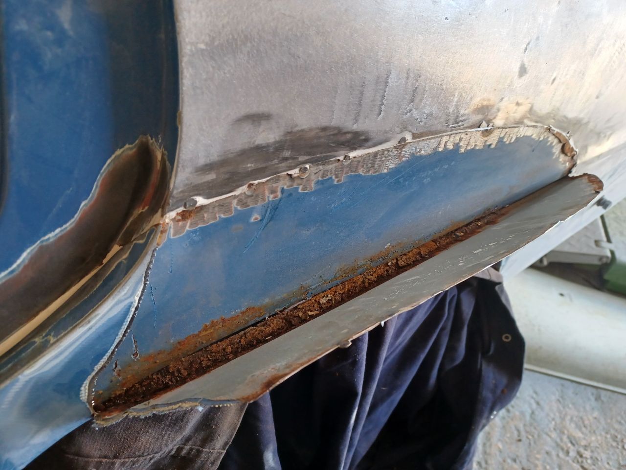

Peel back the layers on the onion. I found the otherside was in better condition under the slapped on repair panel than what the repair panel condition was in.

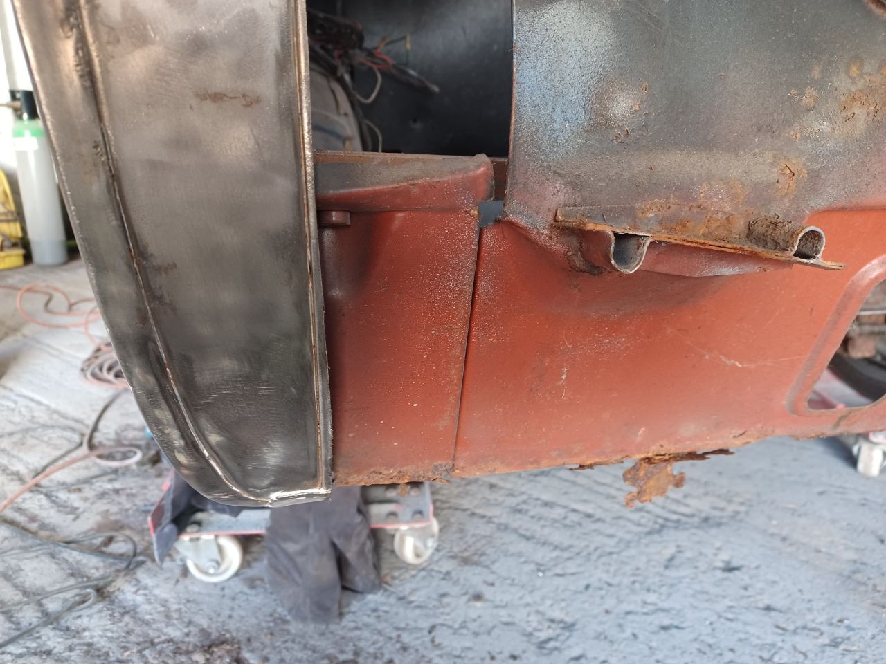

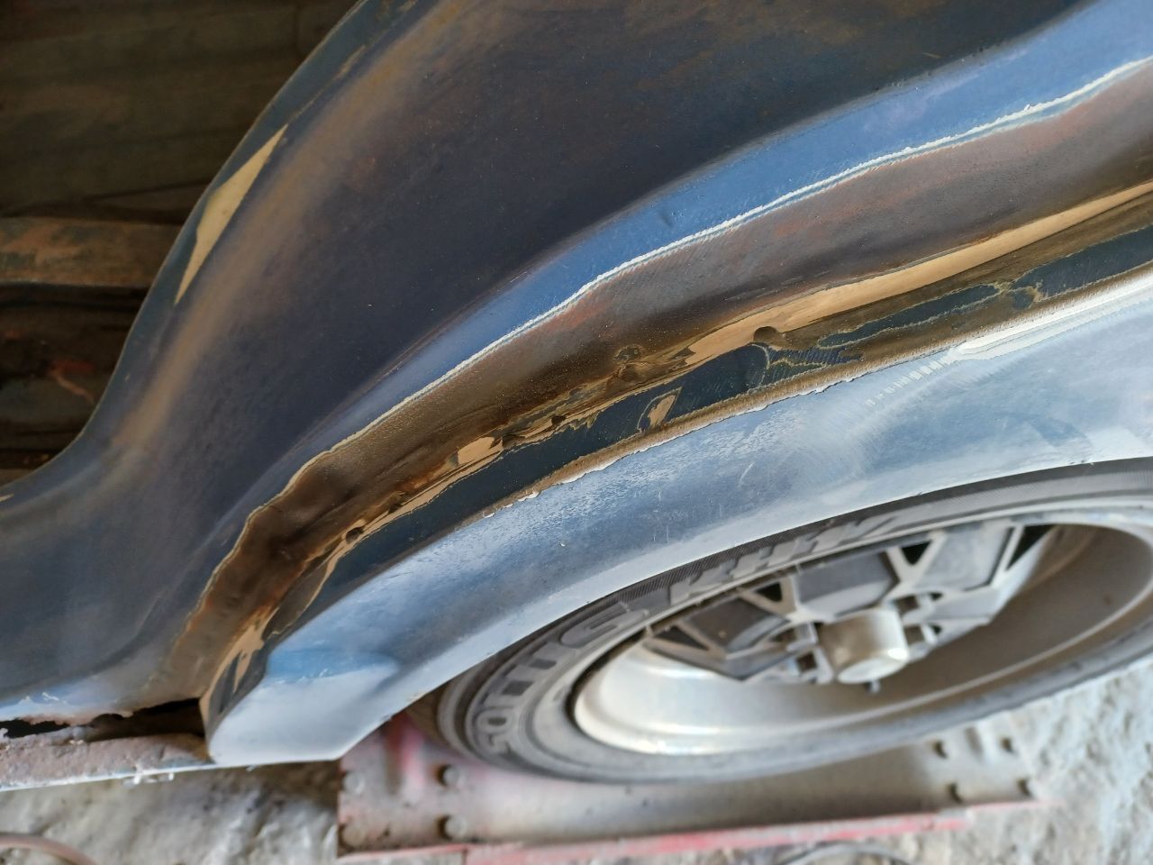

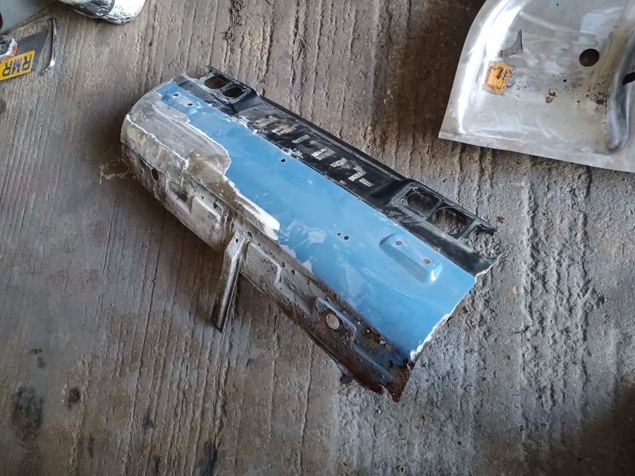

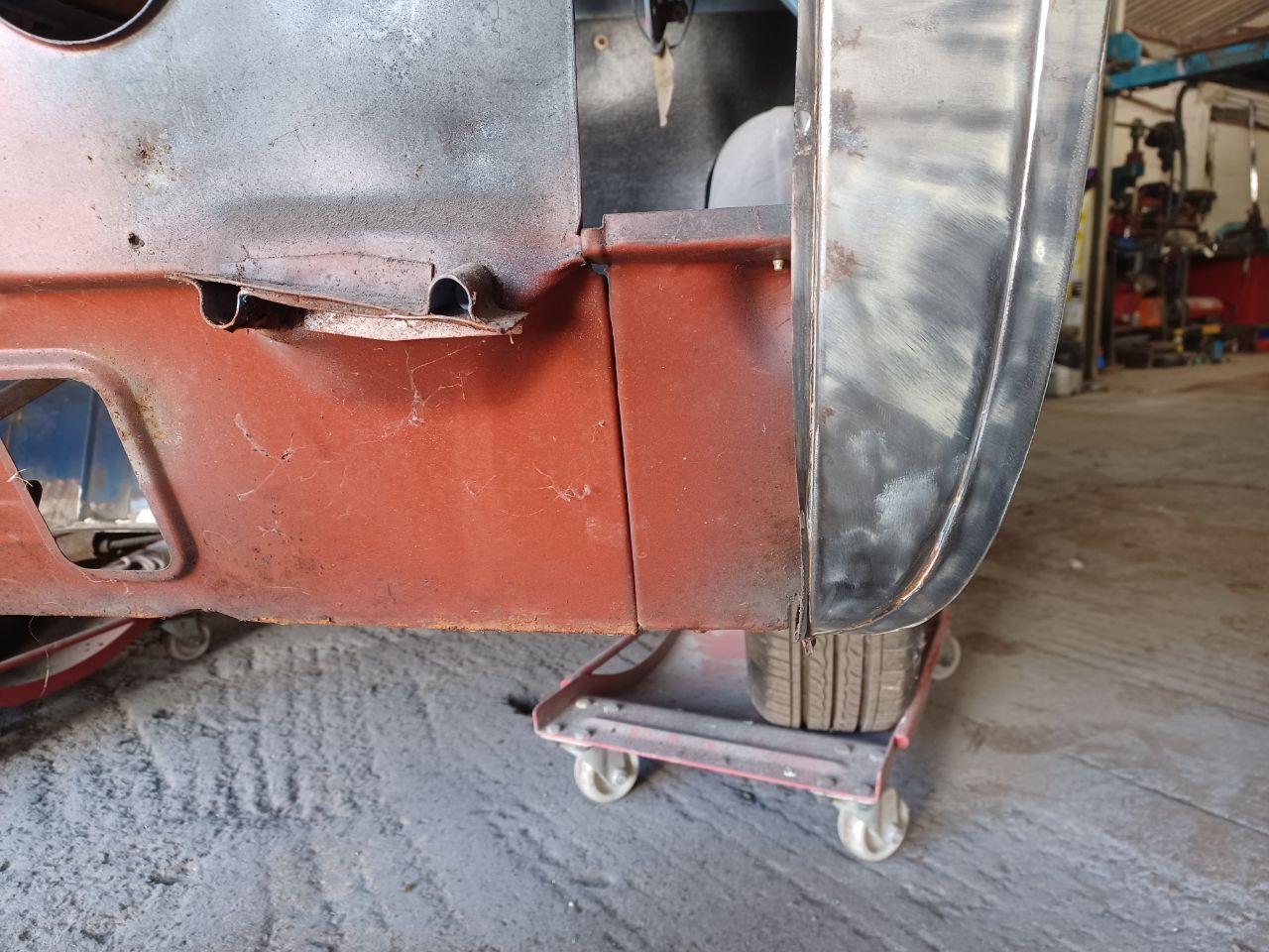

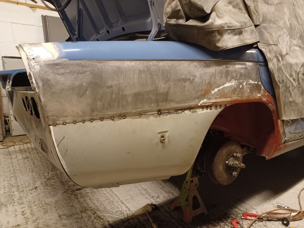

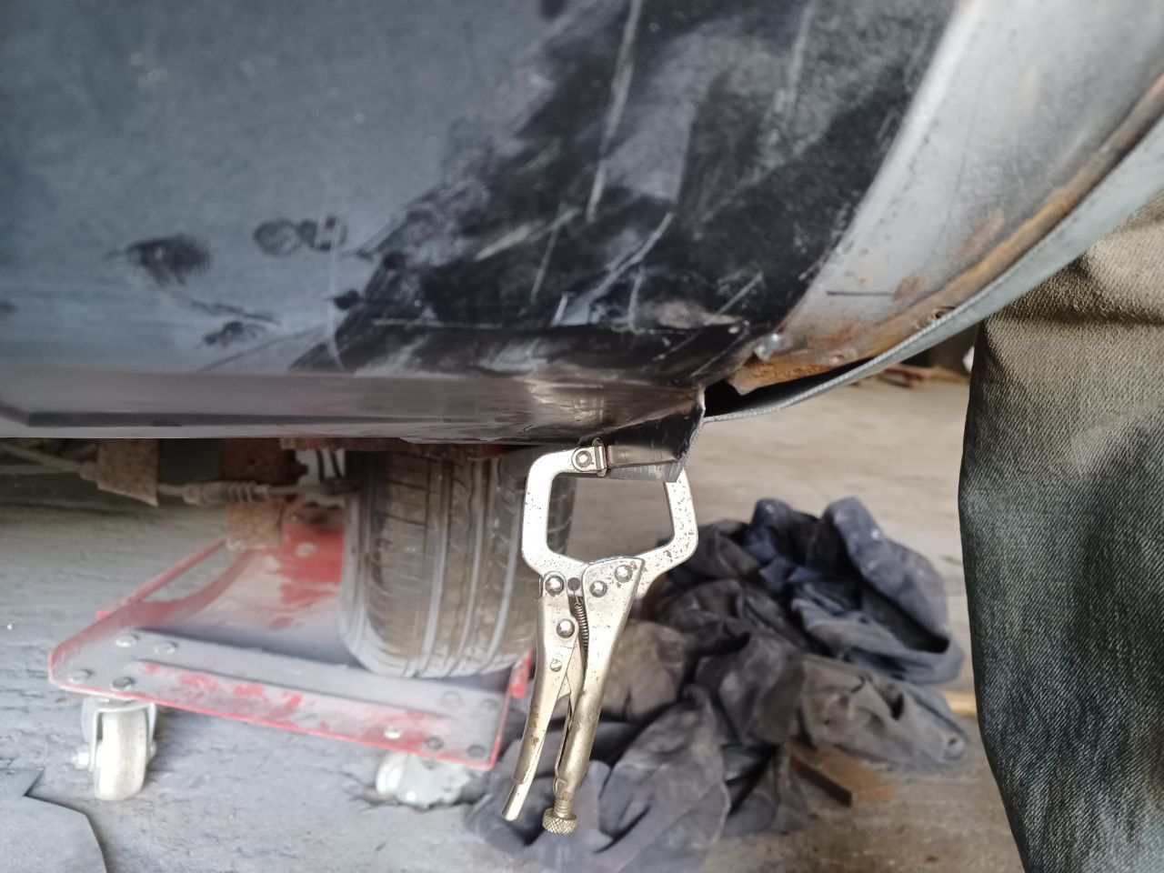

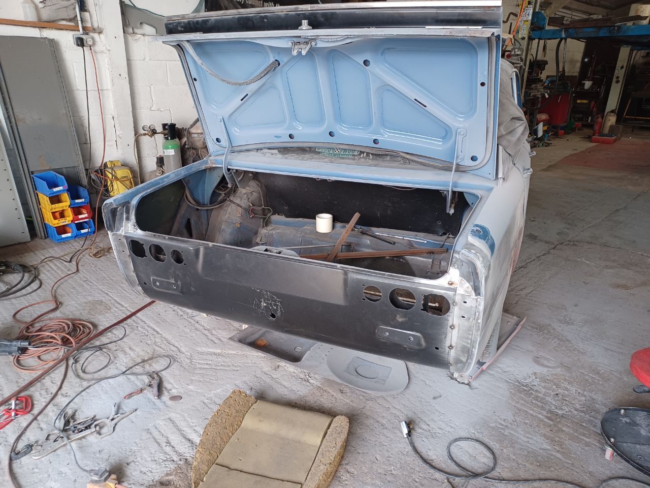

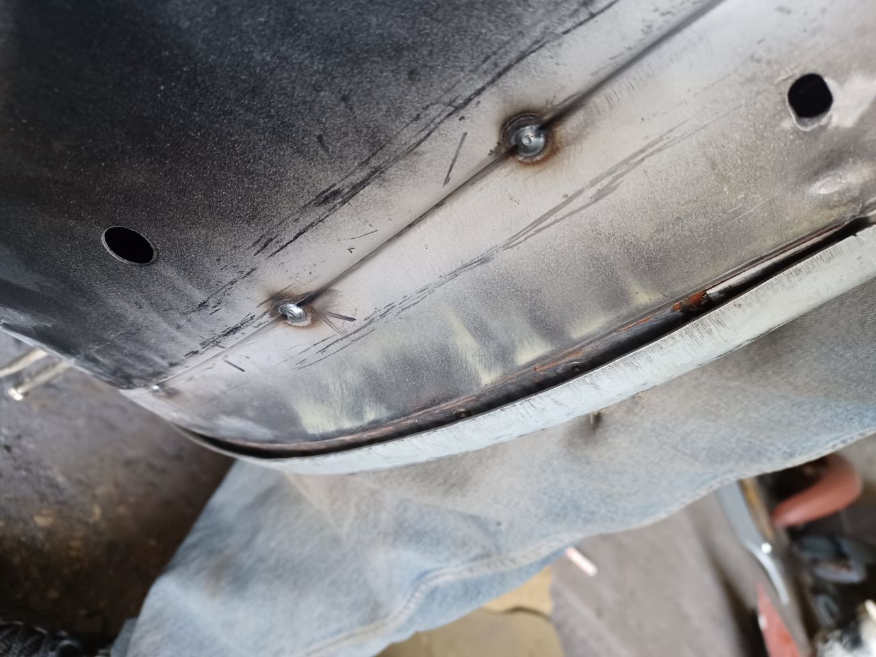

While it is a decent panel, a good few hours of tweaking and adjustment gets its where I'm happy. Tacked externally so should it need moving the welds can be cut off, made a start looking at the lower rear quarter panels. Nice thick panels, sadly the rear return lip is the wrong shape at the base and the panel itself a bit long
With a snug screwdriver in the bumper bolt mount hole the rear return gap is significant.
Lots of swearing and a little welding
While the lower rear panels are a nice thick steel sadly they are not quite the right shape, to get the panel to sit comfortably I had to slot the bumper bolt hole down to shift the panel up.  The inner arch was the wrong profile to match the club panels, which seem to be a different shape to the wheel arch panels.
With the thickness of the panels, tweaking them into shape takes a fair bit of effort. I decided to trim the rear return off and will weld the corner joint once I've made another lip.
Excellent work Andyrew ;)

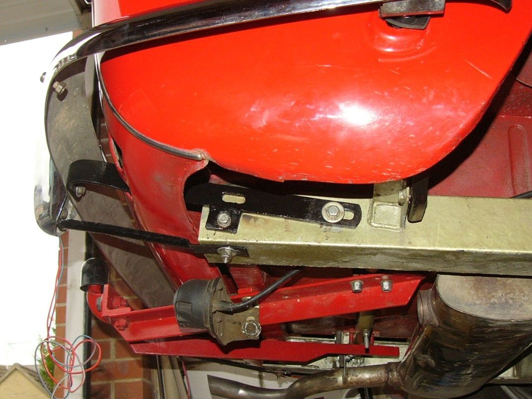

Although after working on my own car for the past four years - it seems to me that needing to elongate a hole for the bumper bracket by just 1/4" is .. a pretty darn good fit.
I've recently refitted the bumpers to my Triumph .. the same bumpers and brackets that came off the car soon after I bought her, and the bracket-to-panel-alignment was so far out that I had to modify two bumper irons and leave two others off. . .
^ The bumper iron needed to be re-bent (on both sides of the car) to swan-neck away from the chassis, rather than be straight, so as to clear the aperture in the rear valance panel.
P1310606a.JPG.db67296e46c3b3cab2e24d345a1bd515.JPG   P1310646a.JPG.65e261ab70f4c19ede6d9e93e9b6e985.JPG
^ And then (again on both sides of the car) the bumper iron which is supposed to tilt down, from the upswept chassis leg, needed a plate welded onto its lower edge. That plate was then drilled to find the captive nut in the chassis.  The body was sitting on the chassis legs but still that hole was an inch-and-a-half out.!   The outside corner irons would not fit and had to be left off.  The side mounts of these wrap around bumpers were fine, but needed spacers.
^ and the final alignment of the bumper (with the bumper irons so modified) was good.
Keep up the good work, and do check the bumper's alignment before welding those panels together.
