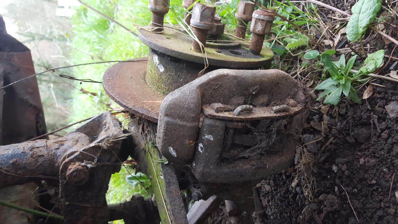

Getting what is left of the bearing out may prove interesting but at least he's found the bit it's mounted in!
Looking a bit sorry for itself at the mo but that's the reg no if it helps anyone, will upload more photos when I've got access to my laptop.
I might try running a big bead of weld around the inside of it first and then a fly press. I've had success with that in the past.

Best way to get an outer shell of a bearing out of a housing is to run a couple of beads of weld around the inside of it . Wait TIL it cools down and it will practically fall out .
One of my fave tricks that one
Mine too, and worth keeping the welded race as a drift to knock the new one in, now it has shrunk enough not to get jammed in the housing.
Ahh yes - some I’m not the only one with a box of old bearing shells under my press then ?
I always wrap a rag around old bearings if I use them on the press . I know it’s not good practice and they do have a habit of exploding but in the real world the rag stops bits flying about
