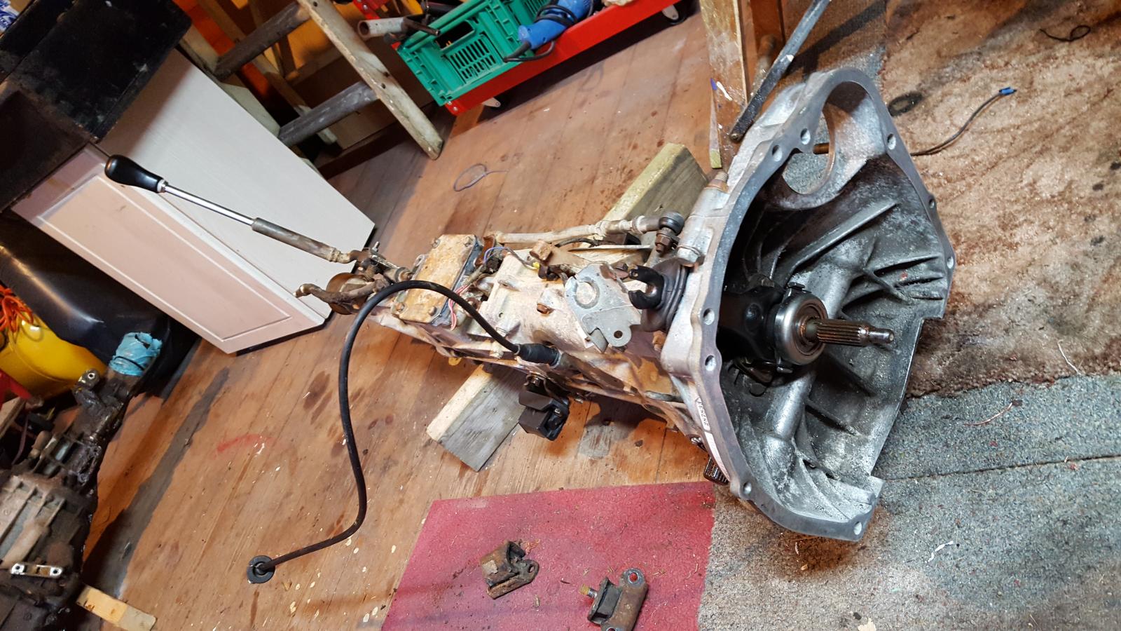

Time to get the incontinent,noisey gearbox out today.
The driveshafts are secured with a roll pin and because the gearbox was loose i was able to yank it left and right to release and remove them without having to drop the bottom balljoints which was a result.
Everything came undone ok except the speedo cable which is plastic and screws into the alloy box but 29 years later it was not moving so i had to release the cable from the back of the dash and pull it through the bulkhead instead.
I was hoping i could drop the box downwards and drag it out from below but it's a heavy bugger and my backs not as good as it once was so i hooked the crane on it and pulled it up and out instead.
Blue rope and my best Granny knot,proper shitting right there..
That's err better ??
With the gearboxes side by side i tired to to unscrew the speedo cable but i was just chewing up the hexagon bit.
I dont have a spare cable and getting one would be a bit of a hunt so i reluctantly ended up using a cutting disc and slicing into the gearbox where the threads are allowing me to hit it with lots of plusgas which eventually got it moving without totally wrecking it.
But doing this has make a bit of a mess of the old gearbox but if i ever need to use it again i reckon some chemical metal would bodge it up ok.
I had ordered a new release bearing from Rock auto in the U.S last year but it was the wrong one.
The bearing was correct but the carrier it was pressed onto wasn't but i was able to swap it over onto my old carrier.
I had also bought some gearbox mounts at the same time and these did fit.
So that'll do it can go back in again now.
