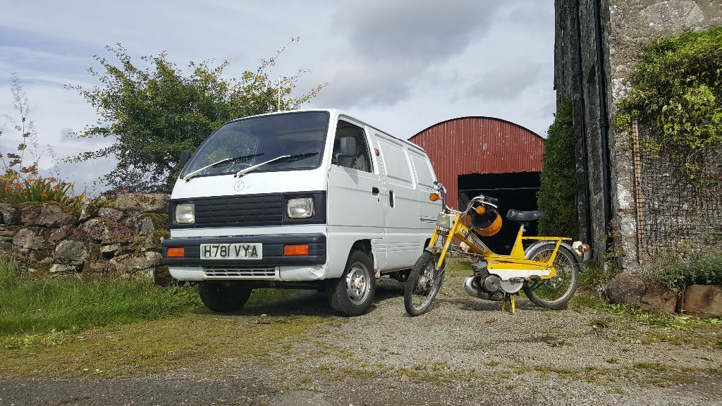

I'm hoping to view and buy something this week.  But if that turns out to be shite I'll be bidding on that 626.  I really liked my old one, and this being auto is even better.
https://www.ebay.co.uk/itm/Bedford-Rascal/223513325521?hash=item340a6eafd1:g:U8wAAOSwBmdc2Cki
Nice photo.........not so nice MOT failure list.Repair immediately (major defects):
  • Windscreen washer jets misaligned and not providing sufficient fluid to the windscreen (3.5 (a))
  • Nearside Front Headlamp aim too high (4.1.2 (a))
  • Offside Front Headlamp aim projected beam image is obviously incorrect (4.1.2 (c))
  • Nearside Front Brake hose excessively damaged (1.1.12 (b) (ii))
  • Offside Front Brake hose excessively damaged (1.1.12 (b) (ii))
  • Nearside Front Seat belt anchorage prescribed area strength or continuity significantly reduced (7.1.1 (a) (i))
  • Offside Front Seat belt anchorage prescribed area strength or continuity significantly reduced (7.1.1 (a) (i))
  • Steering component mounting prescribed area is excessively corroded At steering rack. (2.1.2 (e) (i))
  • Rear Exhaust system insecure (6.1.2 (a))
  • Nearside Front Suspension component mounting prescribed area excessively corroded significantly reducing structural strength Strut mounts. (5.3.6 (a) (i))
  • Offside Rear Suspension component mounting prescribed area is inadequately repaired Spring mount. (5.3.6 (a) (i))
  • Offside Front Suspension component mounting prescribed area excessively corroded significantly reducing structural strength Strut top mount. (5.3.6 (a) (i))
  • Offside Suspension arm ball joint dust cover no longer prevents the ingress of dirt (5.3.4 (b) (ii))
  • Nearside Rear Service brake excessively fluctuating (1.2.1 (e))
  • Nearside Rear Service brake grabbing severely (1.2.1 (c))
  • Suspension component pin or bush excessively worn Steering box drop arm (5.3.4 (a) (i))
  • Exhaust emissions hydrocarbon content excessive (8.2.1.2 (b))
Repair as soon as possible (minor defects):
  • Offside Front Drivers door pillar deteriorated so the door cannot be readily opened or closed (6.2.3 (c) (i))
Monitor and repair if necessary (advisories):
  • Steering lock/ignition barrel damaged.
  • Both rear sliding door handles loose.
  • Offside Sliding door corroded.
  • Nearside Front and rear sill damaged.
  • Oil leak, but not excessive (8.4.1 (a) (i))
  • Nearside Front Floor corroding.
  • Offside Front Floor corroding.
  • Offside Front Tyre slightly damaged/cracking or perishing (5.2.3 (d) (ii))
  • Nearside Rear Tyre slightly damaged/cracking or perishing (5.2.3 (d) (ii))
  • Nearside Rear Inner sill corroded but not structural.
  • Offside Rear Inner wheel arch corroded but not structural.
  • Nearside Rear Shock absorbers has slight external damage to the casing (5.3.2 (b))
  • Rear diff main seal slight leak.
