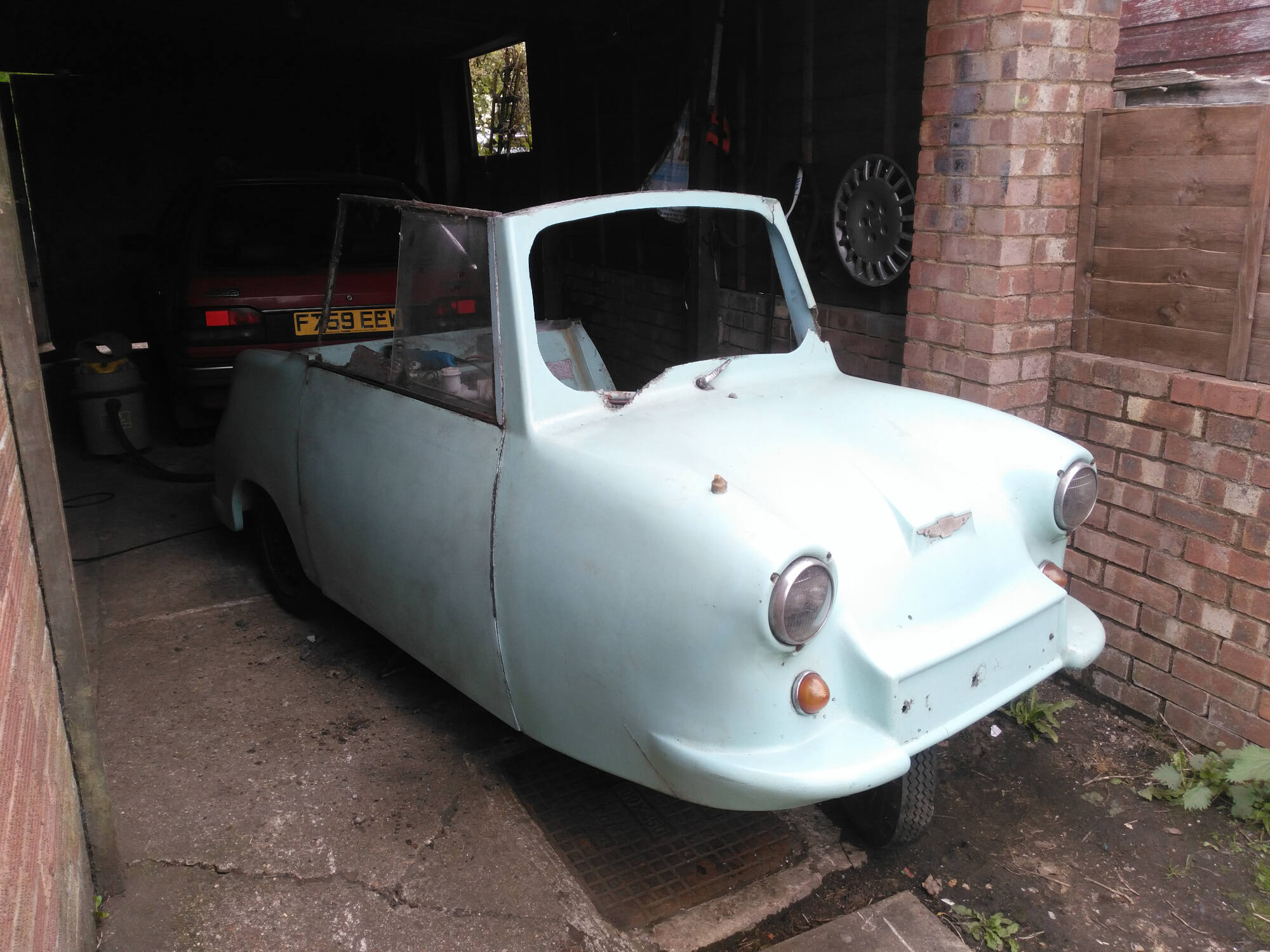

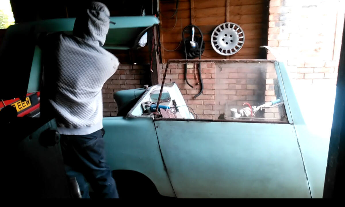

Got the roof off today.
Topless invacar action!

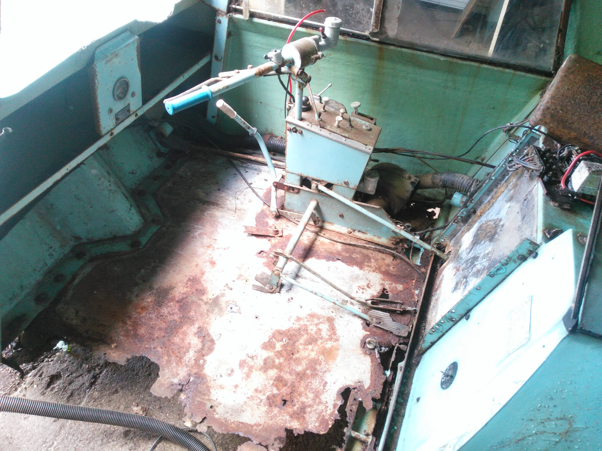

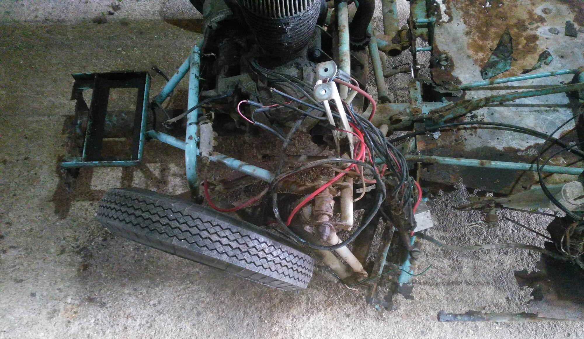

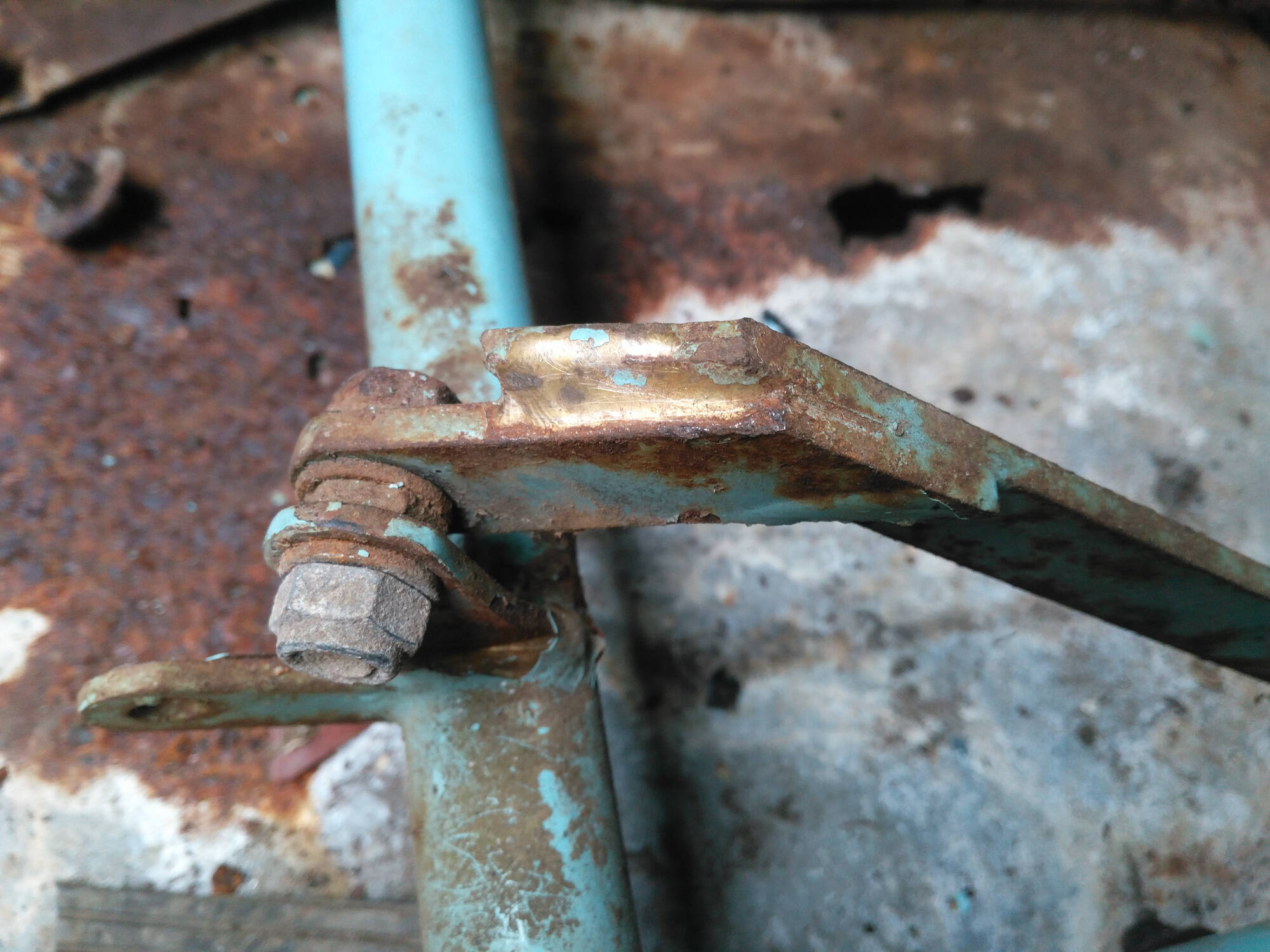

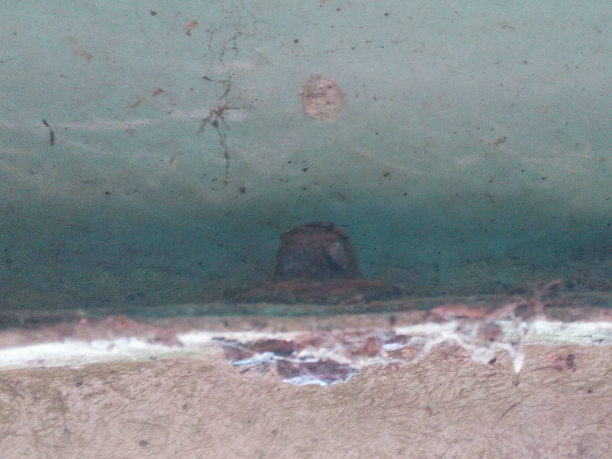

Every single nut+bolt holding the invacar body to chassis is rusted beyond the point of no return so i had to break out the angry spanner.
You know the car you're working on is old when stuff is visibly brazed together.

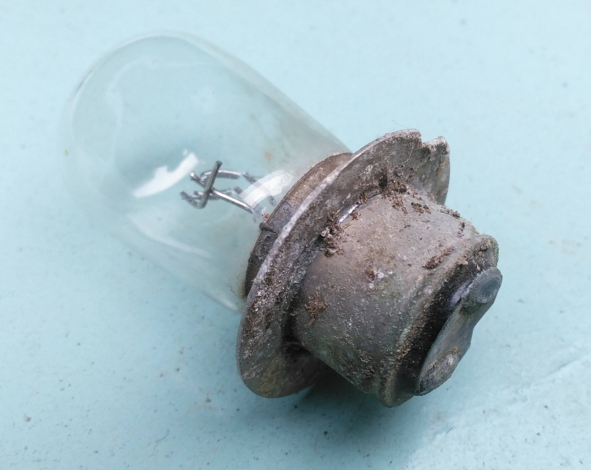

The bulb dangling under the front of the car in the older pictures is the nearside headlight bulb, here are a couple of close-ups upon LBF's request.
No visible markings that i could see.

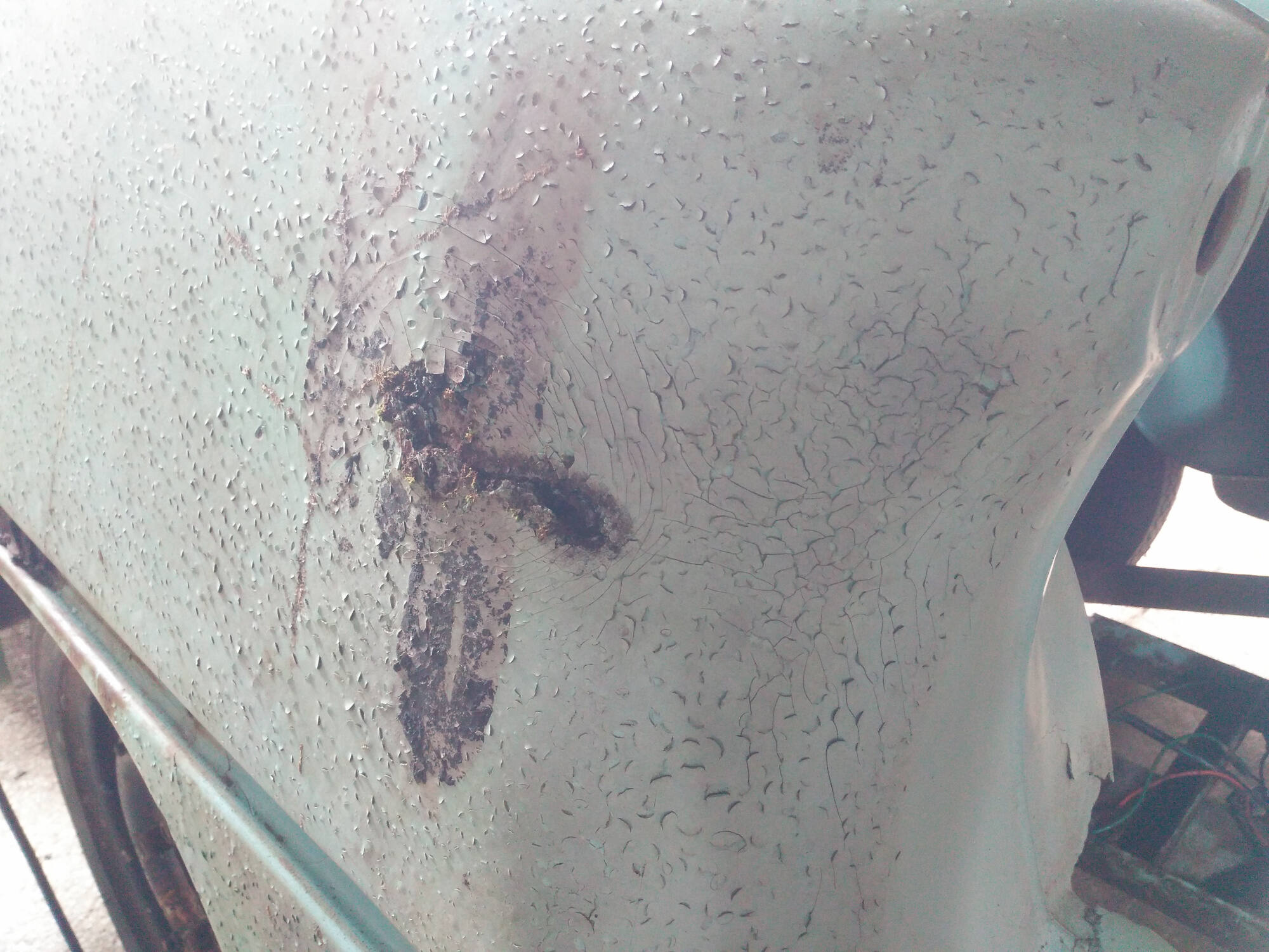

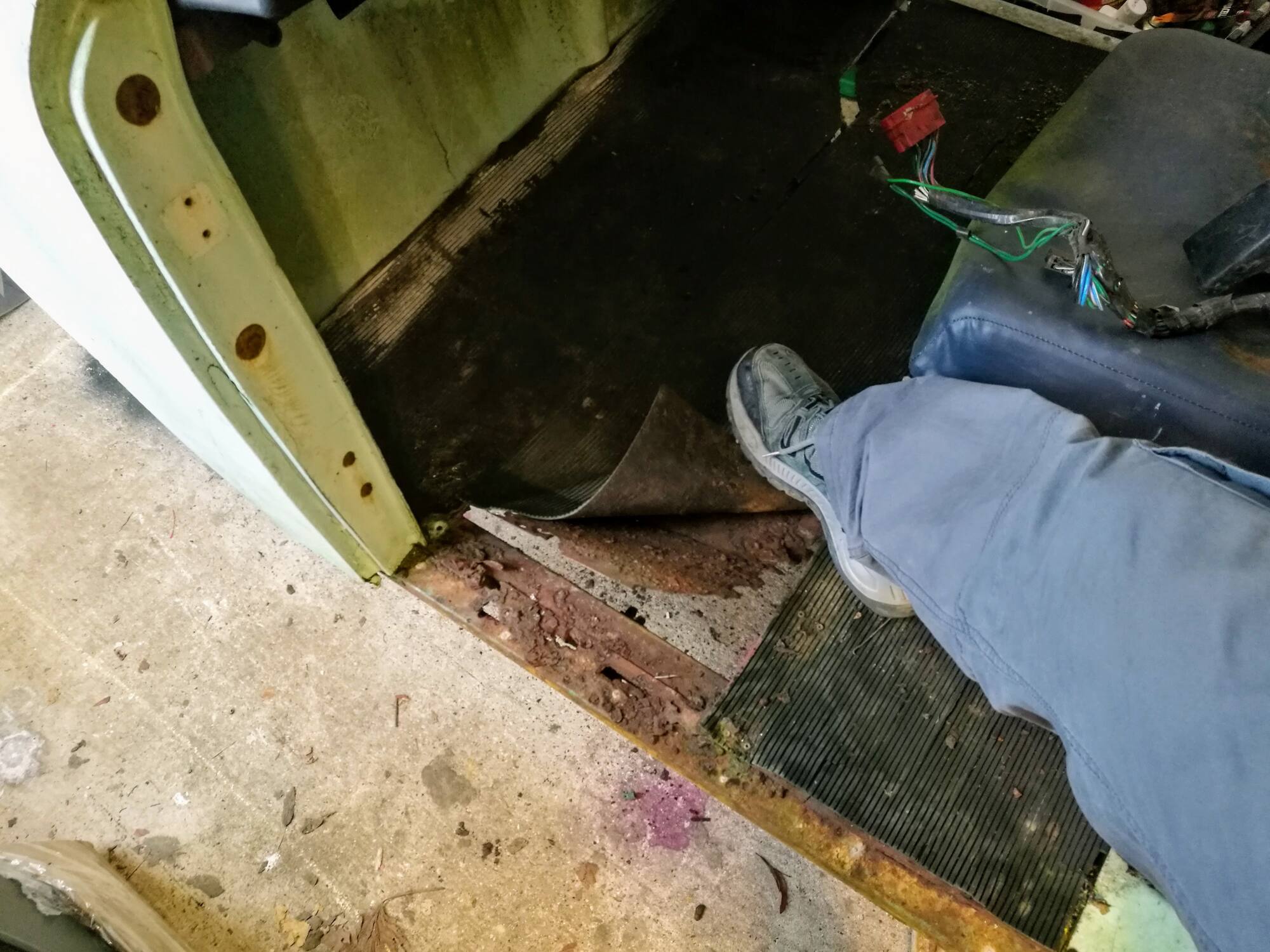

This seems to be the worst part of the body damage simply because it covers the whole rear quarter.

thanks for the bulb pics, shame there are no visible markings... however if you take the bulb and pop in your fridge or freezer till its nice and cold, then breath on the top of the bulb your breath condensating on the bulb may bring out the etch once more :)
I do wonder if its original to XWC... (if you dont want/need it then please keep it for me dont throw it out! and ill happily take it off your hands some time)

Burnt fibreglass has an amazing* patina
And there's a couple of patches on the roof where the gelcoat has burnt away completely to expose raw fibreglass

....Until i hoovered up %46 of the chassis with the shopvac. :D
There's about 3 foot of brake line that has dissolved into nothing too.
Edit: LightBulbFun; i'll do the glass etch thing sometime. If i don't re-use the bulb then i'll make sure you get first dibs and it's not going into the bin.

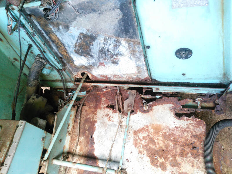

In many ways, this car is a lot like the more exotic Fiat X19.  Engine at the back, lightweight, dissolving...
That's pretty much the same state the floor in KPL was in when she arrived in my garage...
Which after ten minutes with a hammer looked like this.

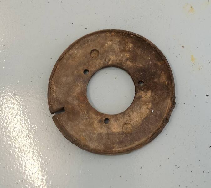

That whole crossmember will be replaced, the pic is to illustrate the severity of the current rust situation. :P (it happened while dragging it through my garage, wasn't intentional but i couldnt resist getting a pic of it like that)

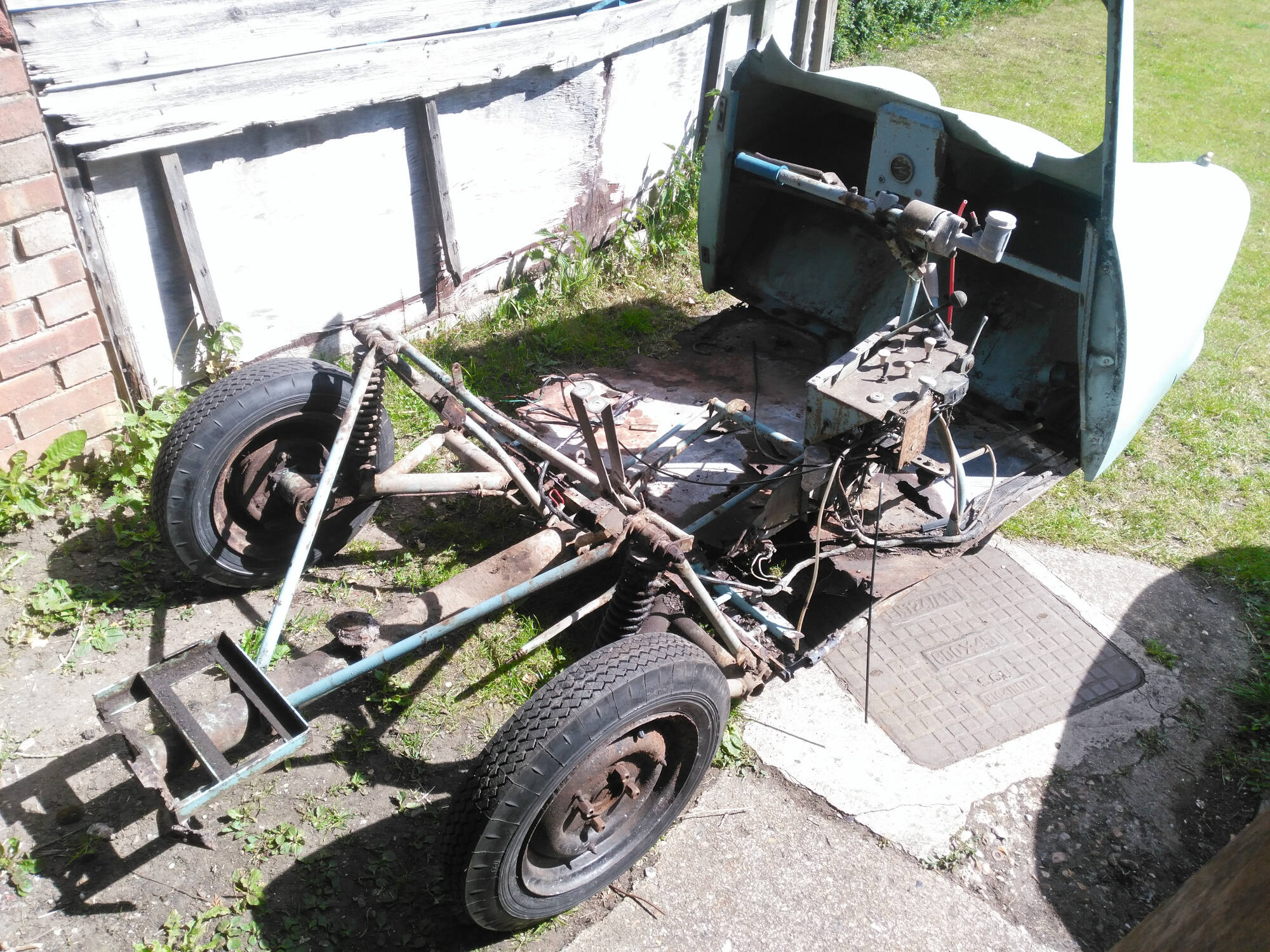

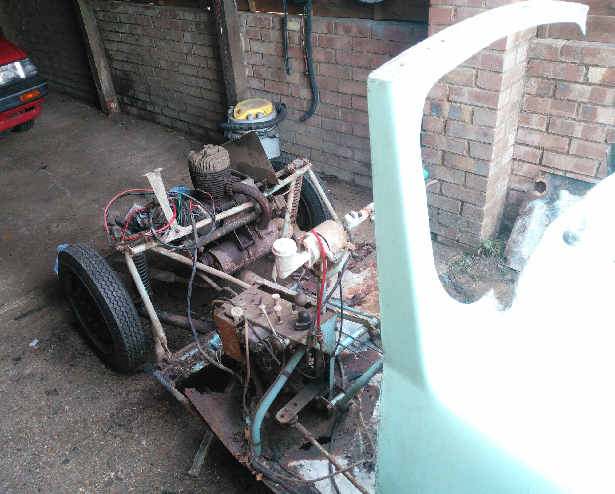

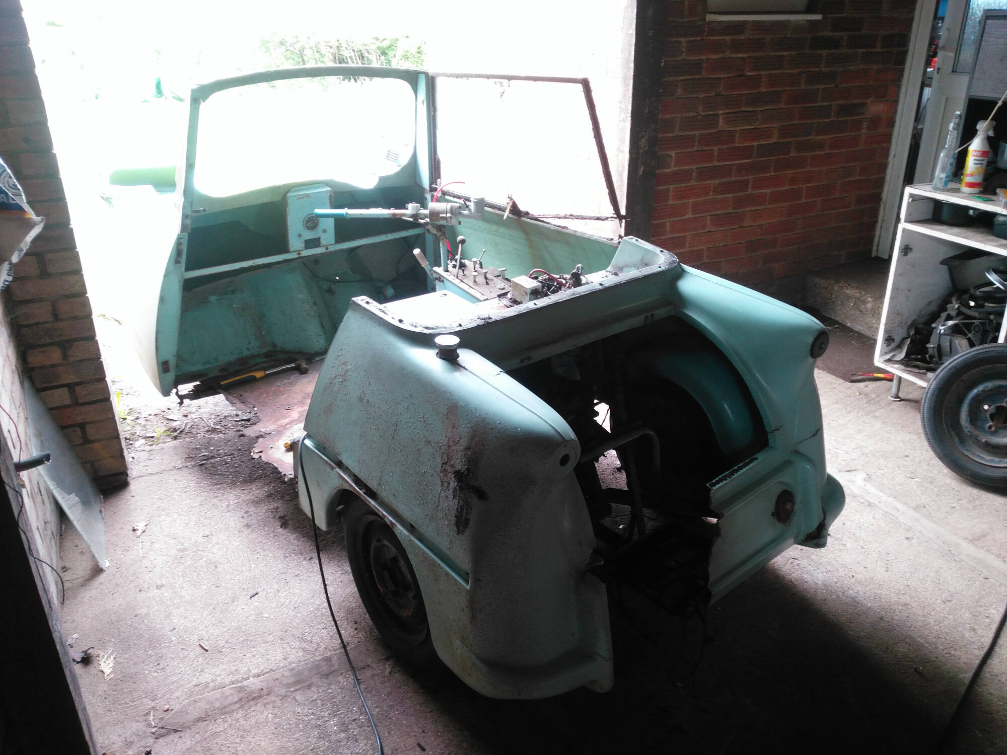

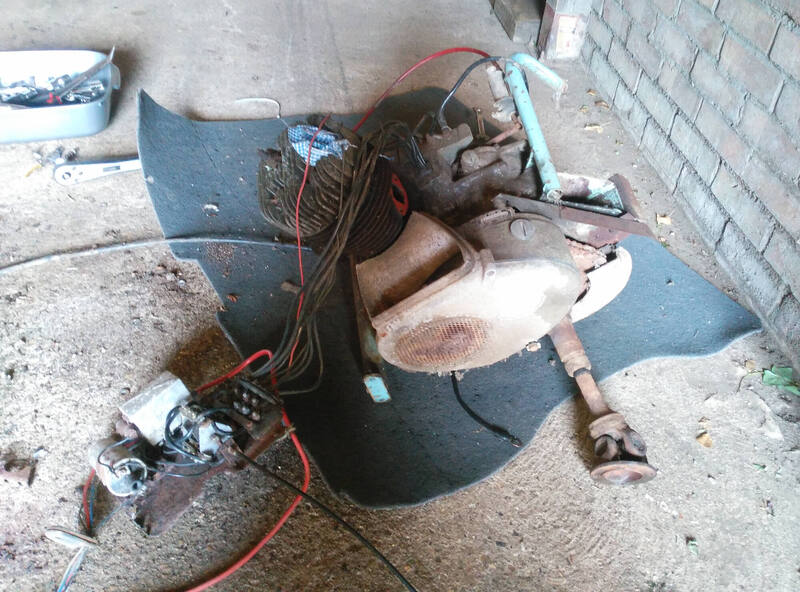

Got the rear-end bodywork off, then the side door-like panel.
Separated the engine wiring from the body wiring and disconnected the drive shaft.
Disconnected the clutch, gear shift connection, accelerator and choke cables then removed the engine.
With the entire engine/drivetrain removed, that last wheel is still seized so it'll be the brakes or bearings on that side that's locked-up i'd say.
Next job will be to clear all the misc crap out of the engine fan housing and see if it spins freely. The clutch arm on the old engine doesn't spring back but the cleaner looking spare (thanks again btw Egg :) ) seems to have a functional clutch and the engine spins freely on the spare too so i'll be relying on that to get the invacar running.

Oof, that is somewhat crispy in places isn't it.  Hopefully the repairs aren't too hideous.  I guess at least there isn't a huge amount to the metalwork to begin with.
I guess considering the age and storage conditions she hasn't done all that badly really to be honest despite the appearance.

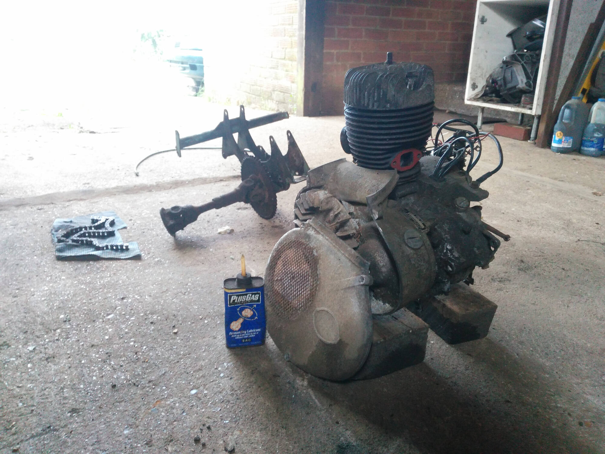

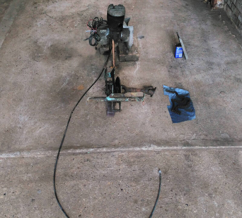

InvaUpdate:

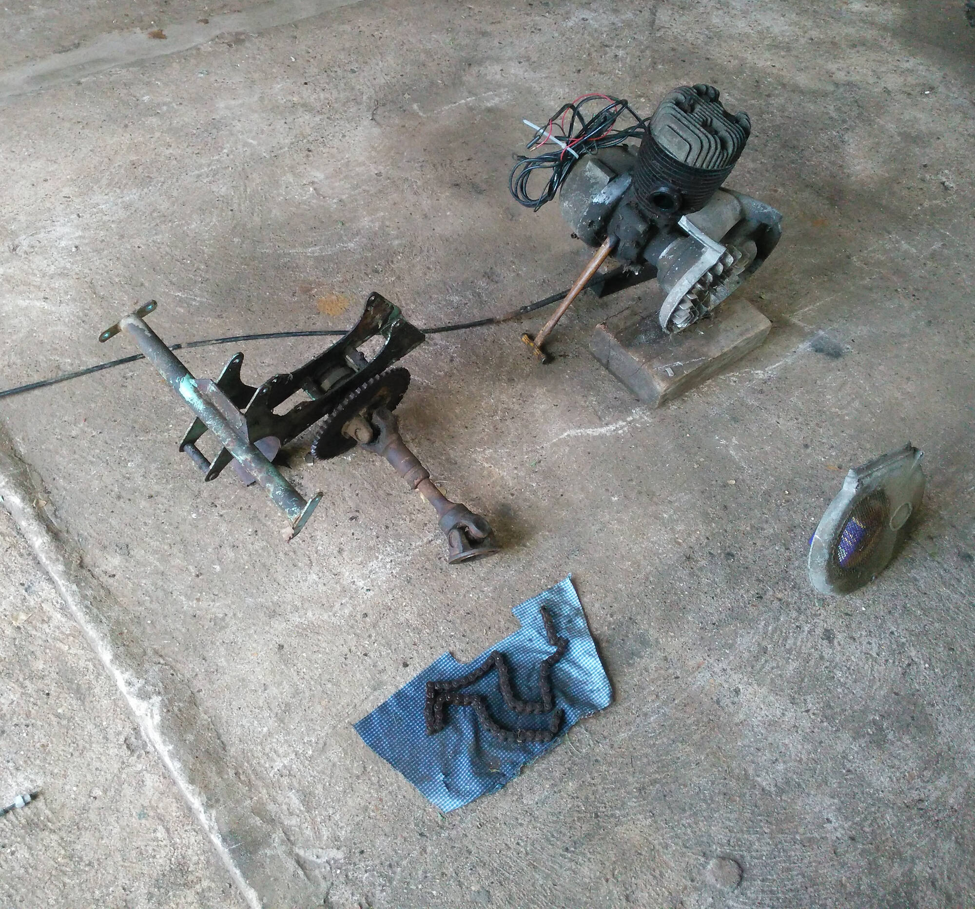

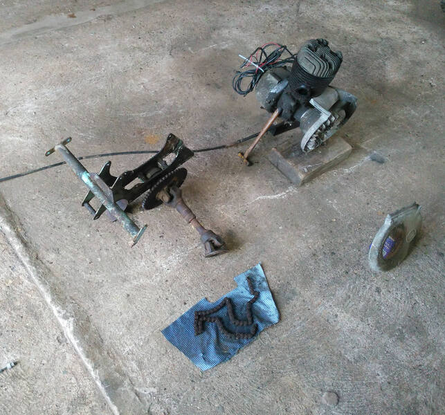

Lower fan cover removed, nothing visibly jamming it. The fan only has the slightest amount rotation but i'm not giving it any more than a finger-tight strength twisting for safety. Cleared it out and still not turning over. (surprise surprise)
On the other end of spinny bits however, the driveshaft and what i'll call the large "final drive sprocket" are able to rotate about 30 degrees, a little more with some effort until i can get the chain-drive assembly (with driveshaft still attached) to rotate about 90 degrees in total. I found the chains removable link and popped it off, the chain was rusted to the final drive sprocket so tightly that i had to hammer it off with a rubber mallet.
Once the chain was totally off i could rotate the driveshaft and final drive sprocket in its bearing fully, no grinding or binding up. Still aligned to the engines smaller output sprocket through its full rotation. :)
With the chain off that allowed me to separate the engine from the engine mounting cradle thing:
Black thing is the speedo cable, still need to get that out, it's being a b'stard.

Excellent work! Does the engine turn now you’ve freed it from that knackered chain?
