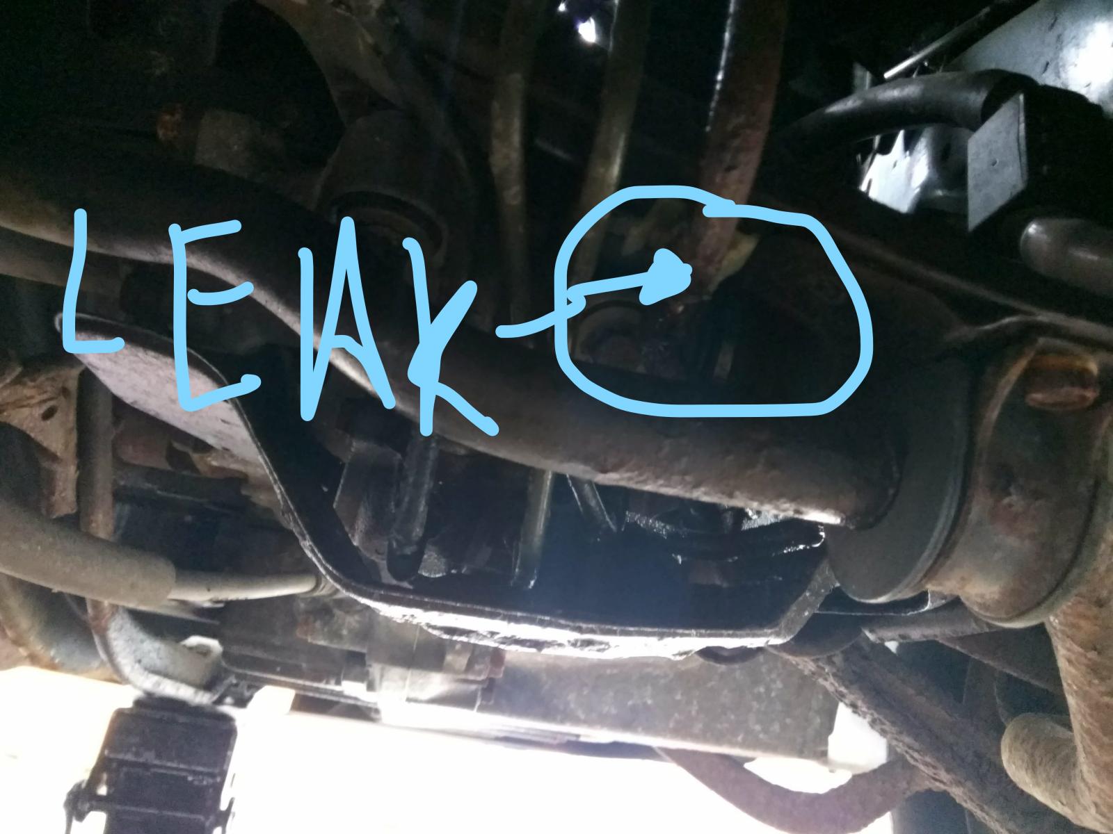

A rudimentary check of the power steering leak identifies it is, of course, from the rack itself, so that's a job for next week to see if I can work out where it's from exactly and what fix, if any, can be done. Cardboard now lives under the car.

I'd try some PAS stop leak first, might save you changing the rack.
I've heard about this stuff - I wondered whether it's just snake oil - have you had any success with it ?
I think once I've got a better understanding exactly where the leak is from I can decide next steps.

Unfortunately not as the leak on my last 75's rack was just too severe for it to have much effect. If it's just a small leak it may be worth a try however.
Managed to get some time to jack her up and slide onto the cold ground to have a looksee at the power steering rack.
The good news is not's a leak on the rack itself. The bad news is it's on one of the very badly corroded metal pipes which are all but unobtanium these days. Obligatory potato cam shot
It's a steady drip drip drip leak when the engine's turning over, but not so bad when it's powered off.
So onto snake oil remedy number 1:
Bunged most of it in the reservoir, consistency of treacle. The proof will be in the soggy pudding, as it needs 100-200 miles to do it's thang. Still felt heavy after bleeding but after a little drive around it loosened up a bit but not massively.

Have now identified the part I need is deffo unobtainium, and to confuse matters further it turns out there are different versions of pipe assembly, dependant upon whether the car is an auto or manual
There is one on eBay for £47 but they can't find a part number, so the only logical thing to do is strip mine down and then compare it to the smudgy photo on eBay to see if it's identical. Or just fucking leak PS fluid everywhere for now...two months till the MoT.
