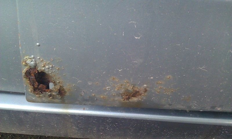

It really is about time I sorted out the rust on my door
since the part that needs filling will undoubtedly be larger, would filler or fibreglass be a better option?
Can you not hammer a slightly larger door on it?
Seriously though You'll need to fiberglass it first to bridge over the hole before finishing off with filler, Just don't expect it to last forever before rusting out again though, You'd need to weld new metal in for that.
Thanks, I shall shortly be using my "skills" to make it look better. Odd how 2 of the doors are scabby, yet there's barely a spot of rust on the rest of the car. Not that I'm complaining.
If putting in new metal isn't a option for you,then fiberglass/fibrofil will be your best friend - sand the rot out as best possible,trowel the stuff into place,then stick some cardboard over the outside to hold it in place,and help it form the correct profile until it sets - filler and perfect from there.Then lots of waxoil or plain old oil inside the door to help slow down the tinworms
Or just swap the door, but that does rather rely on being able to find a better one for sale/in a breaker's. Best of luck.
