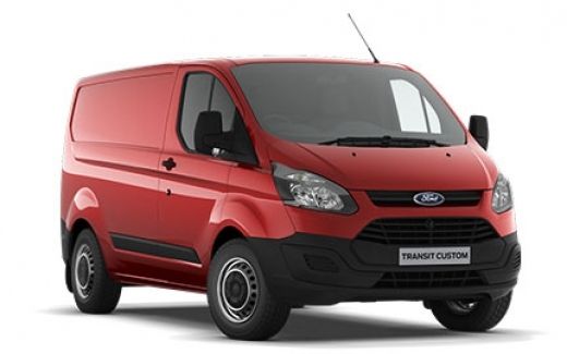

This cost me about £55.00 for a full day with a £200 deposit on a bank card.
ford-transit-custom-trend-l1_zpswngnk5xb

I rent out a Transit Custom like that for £50+vat per day. Insurance excess is £1k so any dents get knocked out cheaply by Dodgytom's mate and the cost passed on. The big boys tend to vary their prices depending on what's in stock where the little companies have a set price and either have a van or don't. Our insurance company don't care what you do for a living so long as you are between 21 and 75 and have 6 points or less.
