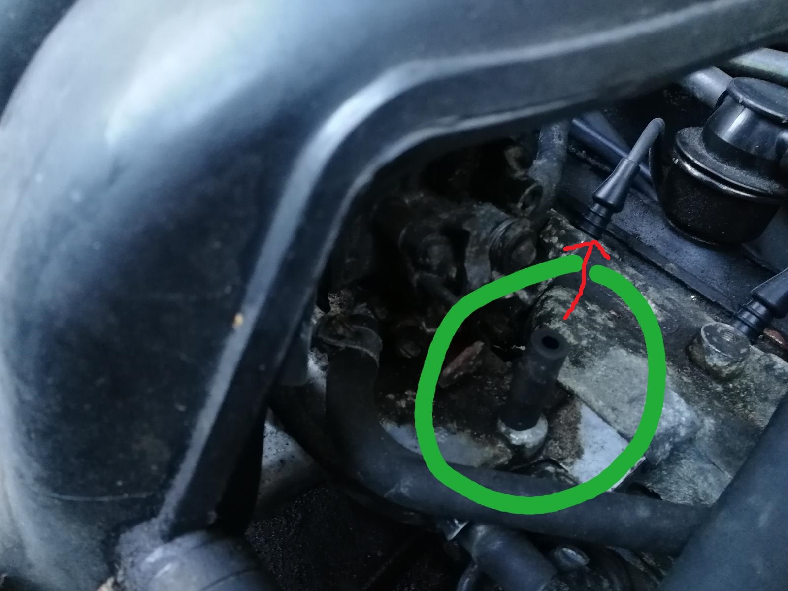

In other news I finally spent some time on the Visa. Got it running nice but am confuzzled about this pipe:
Whats meant to attach to it. I can't see owt thats fallen off, or should I get a rocker breather filter or something?
It might've always been like that and I've not noticed.
Does it connect to the pipe I've arrowed in red here:
Thats the plug lead. I had to look twice though, the perspective is a bit confuzzling.
I'm going to get one of these tomorrow I think in the absence of anything I can see to fit to it.
If its what I think it is, it should just stick on the end. Although it might be massive but I'll wait and see.

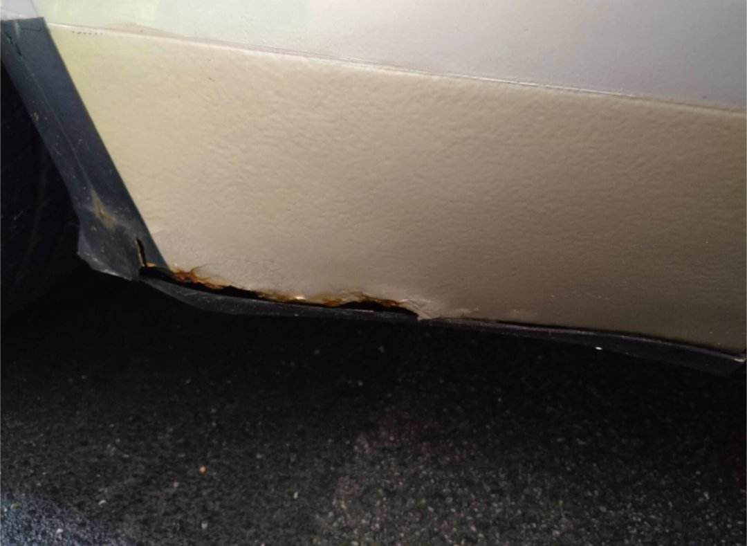

After this failed it's mot in October 2020 because the sills were fucking shit, it sat on my drive for a bit whilst I couldn't find the time to work on it, and when I did have the time, I just couldn't face it.

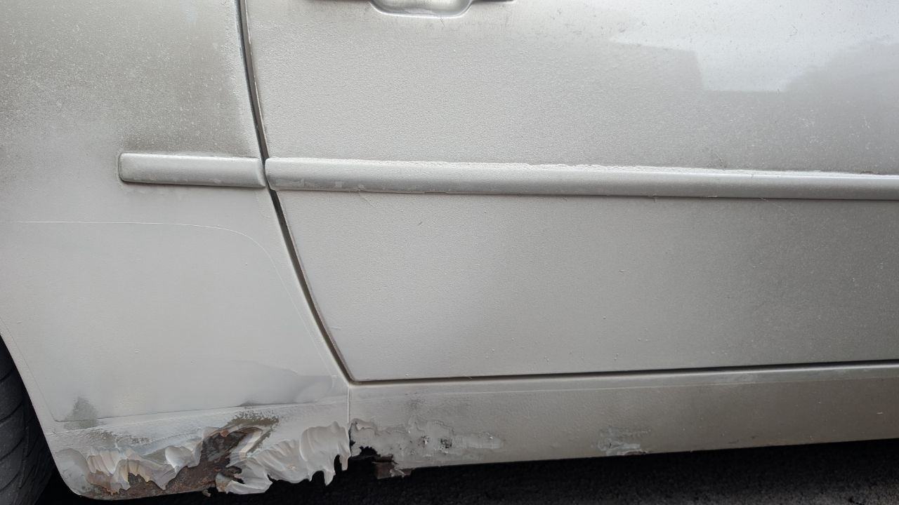

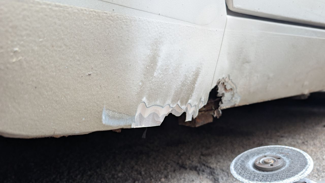

The sills looked like shit. I knew there was a bit of wob on there but was surprised to find out how much.
Look how thicccck that is. I don't think the cars been wholloped there, I think its just about a cm wider there than a normal 944 after someone's kindly hidden the rot.
The inner sill (is it still the inner sill this far back?) where it joins the floor was non existent though, which is a bigger problem than the outer sill.

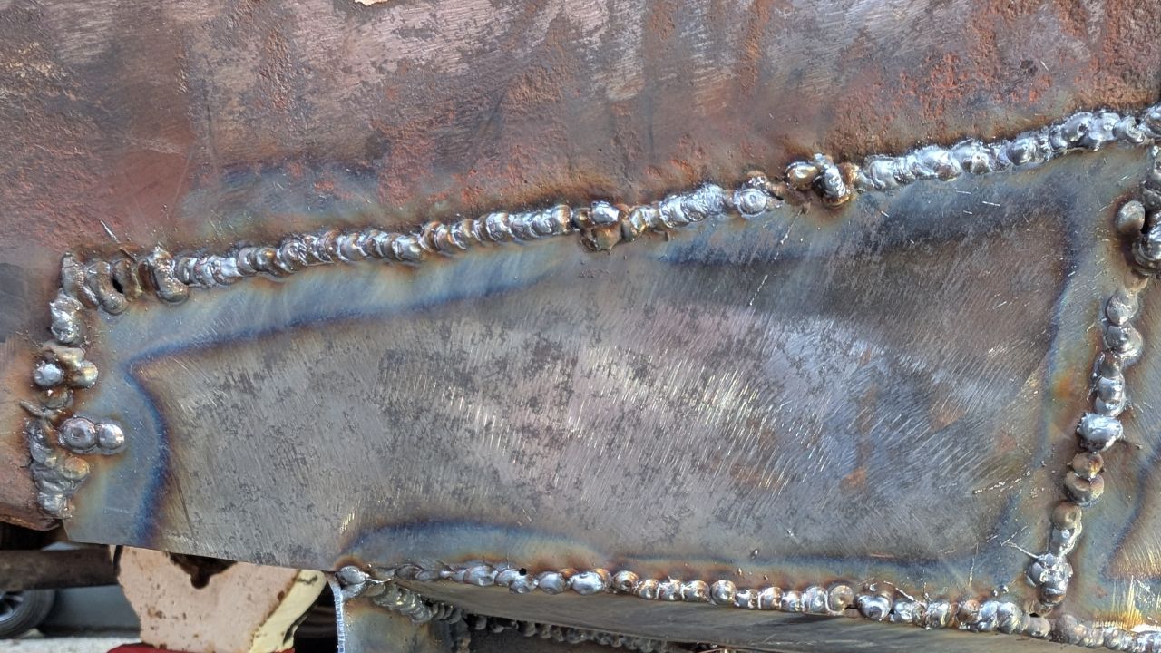

With that done, I moved to the outer sill/rear wing/sill end or whatever you call this bit.
Where it was joining the bit above at the end, the welding was fairly easy as the metal was good, even considering how out of practice I am. On the other bit though the metal I was welding to was waaaffffffer thin and ended up being more slag than anything else as it had blown more than Lilly Phillips.
Look at this shit!
and afterward grinding back, looked like this:
Fucking crap innit. I should've just quit when I knew it was shit but had been at this for a few hours and had summit fever and a sore back.
So an extra section needed cutting out until I could get to better metal.
Bit better. Still some blowing but nothing terrible, more user error than a problem with the metal. So I ground it back again with more success and gave it a lick of paint in a sort of similar colour.
Looks okay from 20ft and you're not wearing your glasses 😂
Will be okay with a bit of filler to shape it (or maybe 6kg of it like before) but whats important is that its now metal and hopefully an MOT pass on that side, unless anyone can spot any obvious errors.
So will move onto the other side next time I get a chance. It doesn't look anywhere near as bad but I bet its still hiding some horrors.

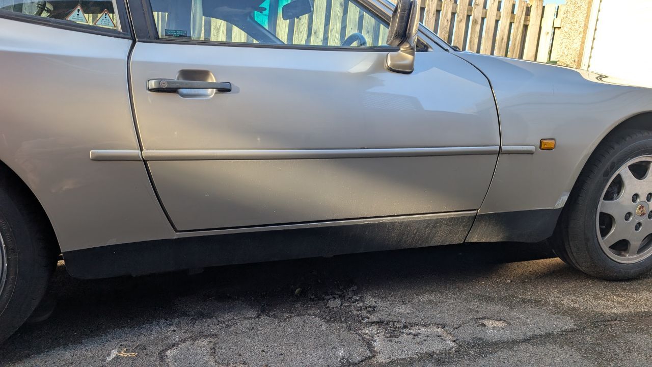

Also realised I've not updated this for a while so will edit this with a couple of pics of the finished but unpainted sills and wings.
Bit better than before
