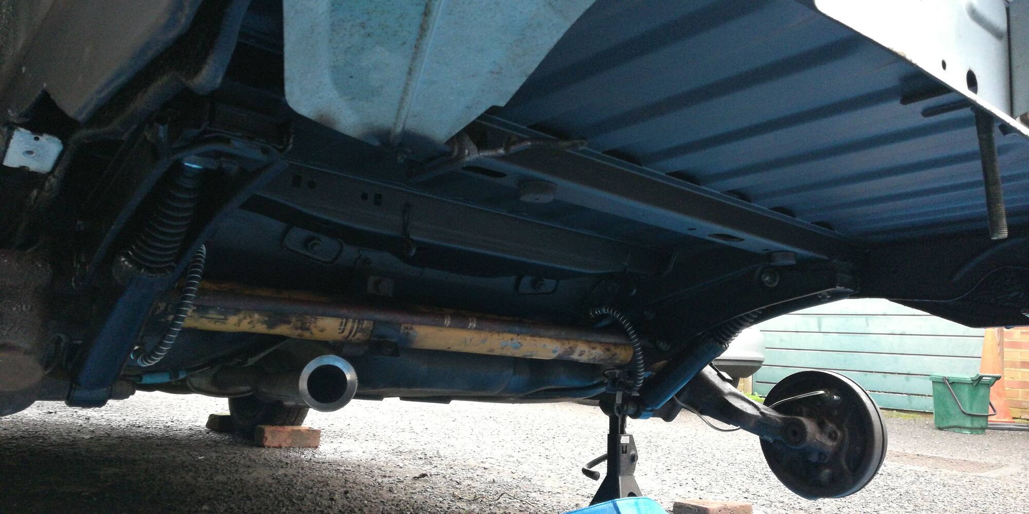

First off. The rear dampers and subframe.
For some reason I decided that I wanted to properly Dinitrol the underside of the car at the rear. This of course meant I had to drop the rear beam/sub-frame - which, whilst quite an easy job, is still heavy and awkward.
Still. Out it came and I cracked on with wire brushing, rust converting and then covering the underside of the boot floor, rear valance, inner arches etc with Dinitrol. The result was quite pleasing. IMG-20191231-WA0002.thumb.jpeg.965b8a591f75076ca4f6d2ee2c36c60c.jpeg
This was using a combination of the Dinitrol Cavity wax for seams and cavities and then the black panel wax to go over the larger areas. I will be keen to see how it holds up over the coming years.
Whilst the beam was out, I fitted new dampers and also re-did the rear brakes with new cylinders and shoes. The wheel bearing races were also cleaned and re-packed with new grease.

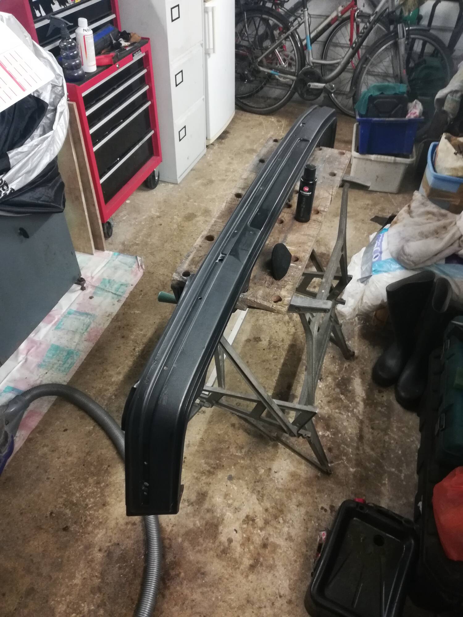

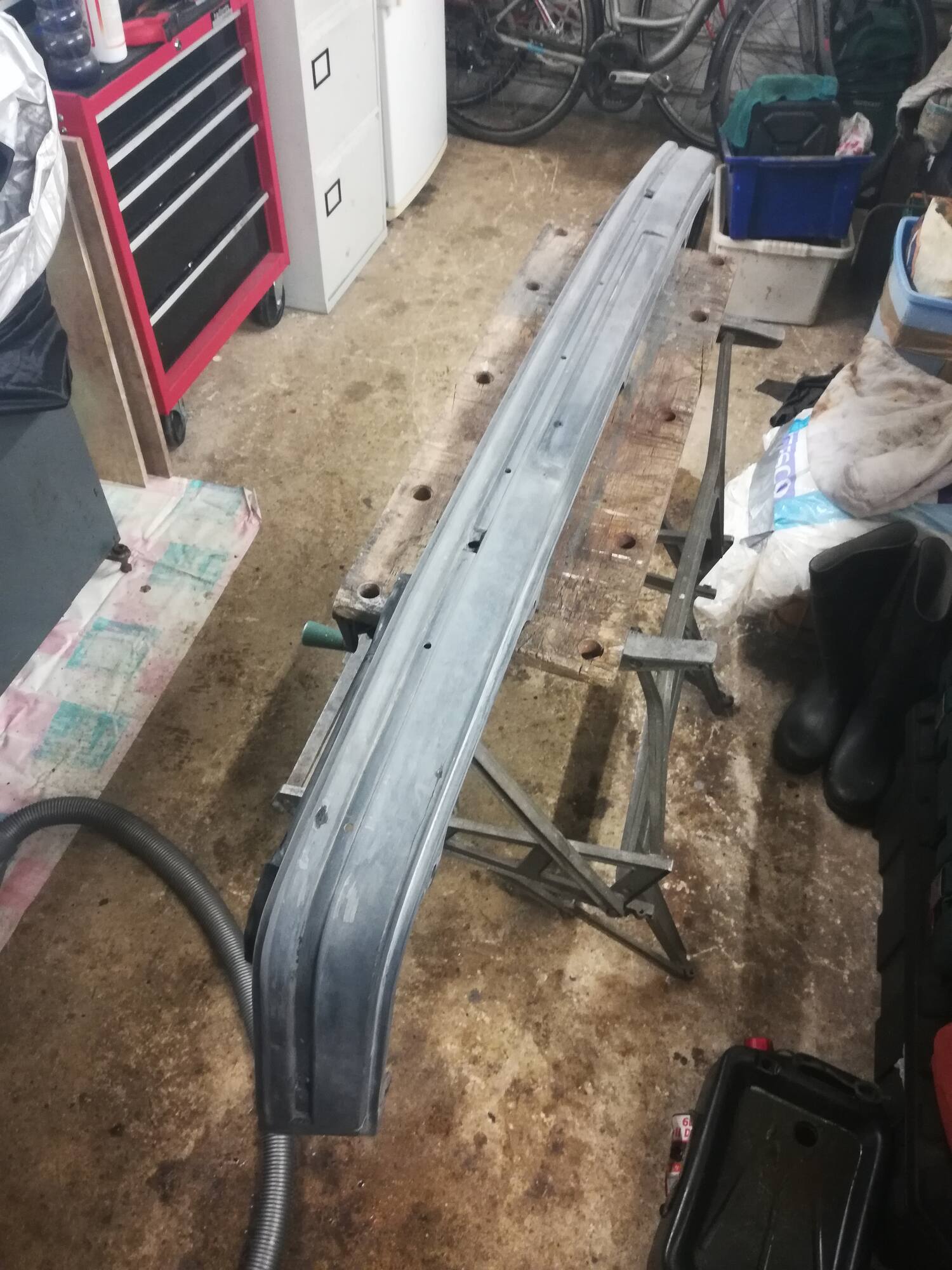

Now the purists will know that Ph1 205's had grey bumpers and external trim. I am no purist, I do what I like - and I like black bumpers. So I set about cleaning and re-dyeing the front and rear.  Here's a before and after shot of one!
Much better. This was done using black trim dye which you can get off eBay. I've used it on several cars and have found it to be pretty long lasting.

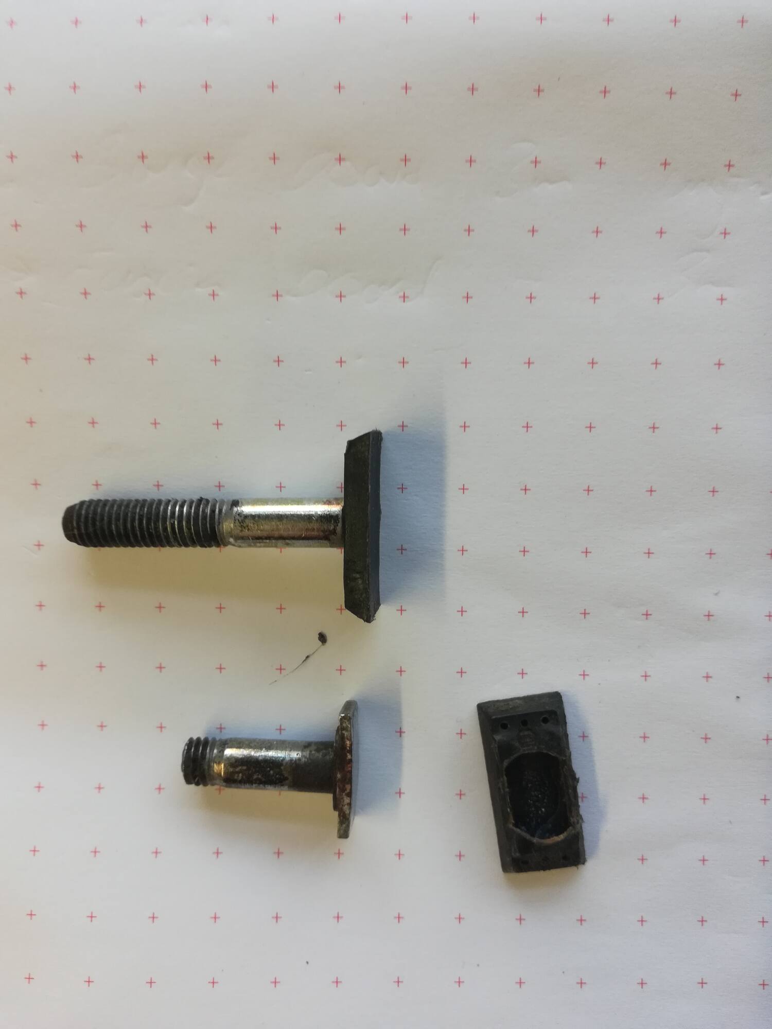

As part of the bumper process, they of course had to be removed from the car. Whilst doing this I unfortunately snapped a couple of the retaining bolts - they were exceptionally rusty and I don't think I would ever have got them off in one piece without a LOT of heat and in such close proximity to rubber and plastic that was not going to happen. So, I then had a little conundrum as the bolts, of course, were special Peugeot ones with a special headform - bastards!
You can see the brown one alongside a complete one. The thin section rectangular head is pushed into a black plastic cap which is then heat formed around it.

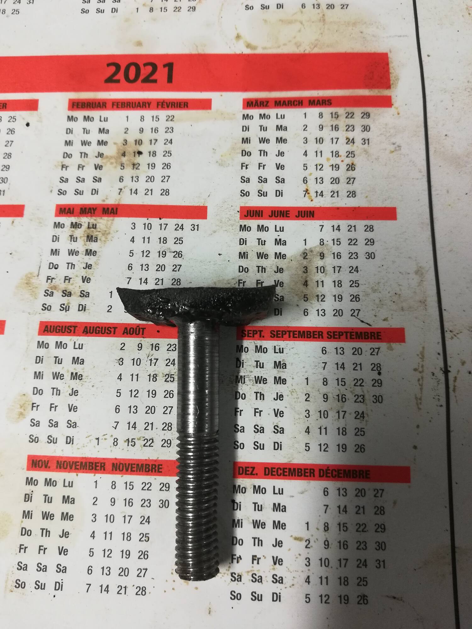

Ordinarily, I would trawl eBay and breakers yards to find another. But, over Christmas I acquired a Lathe (Myford ML7) - so I figured this would be a great introductory project. I am not machinist, yet, so this took a couple of attempts and rookie errors but I eventually got a result.
On the right is the new bolt turned down ready to have its thread put on. The rectangular head has also been filed to shape.
And this is it completed with the plastic cap formed back over it using a combination of heat gun and araldite. Very happy with the result!

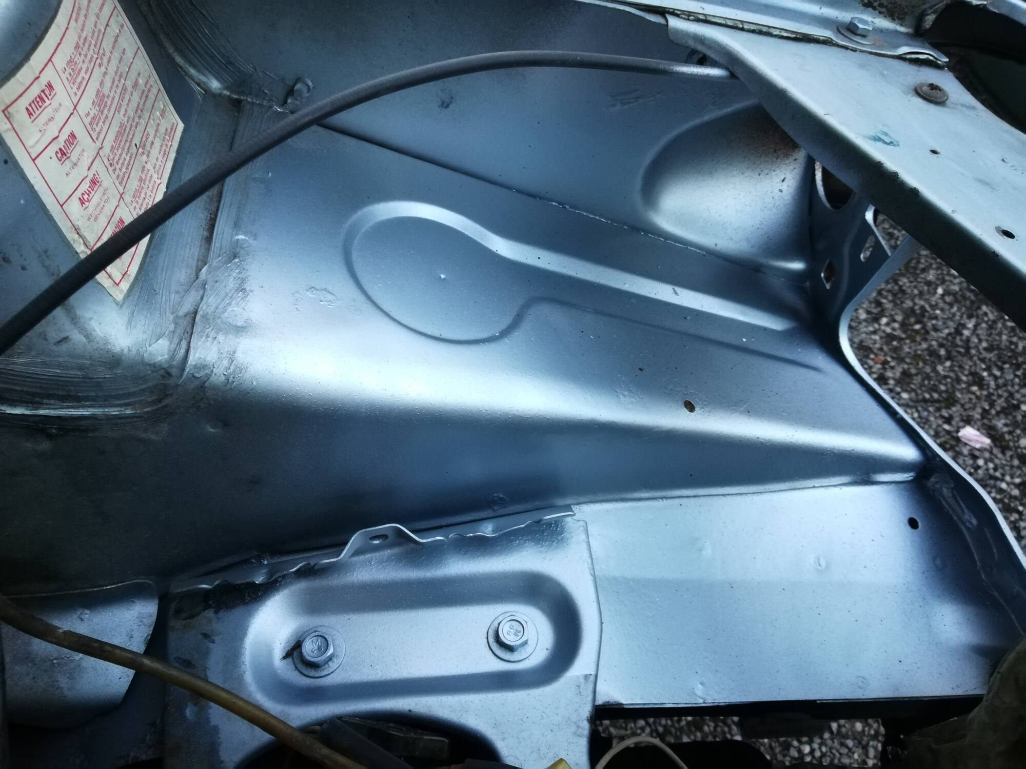

After this I moved on to tackle the leaky radiator - which grudgingly I had to replace with a new unit. Whilst doing so, I took the opportunity to rust protect the inner wings and front slam panel. The area under the battery tray was starting to bubble and rust, so I cleaned it back, neutralised the rust and resprayed it.
The front end is now waiting to go back on, as the evenings get lighter later I will be able to progress quicker once again.

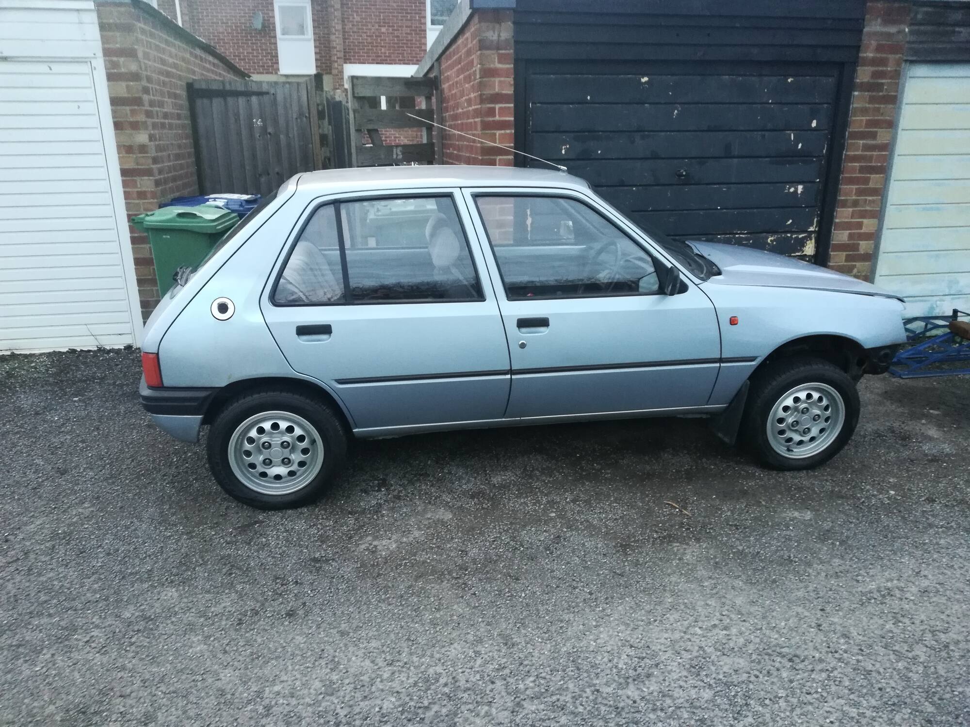

And finally, a big thank you to @Daviemck2006. Thanks to him, I now have a gorgeous set of 1.6 GTi pepper pot alloys on the car.
Quite a transformation. Very happy with them.

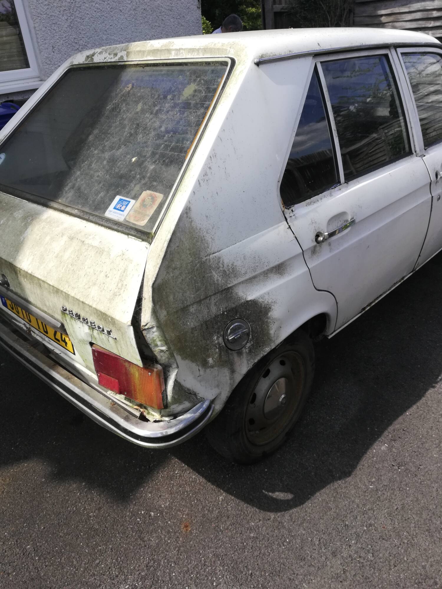

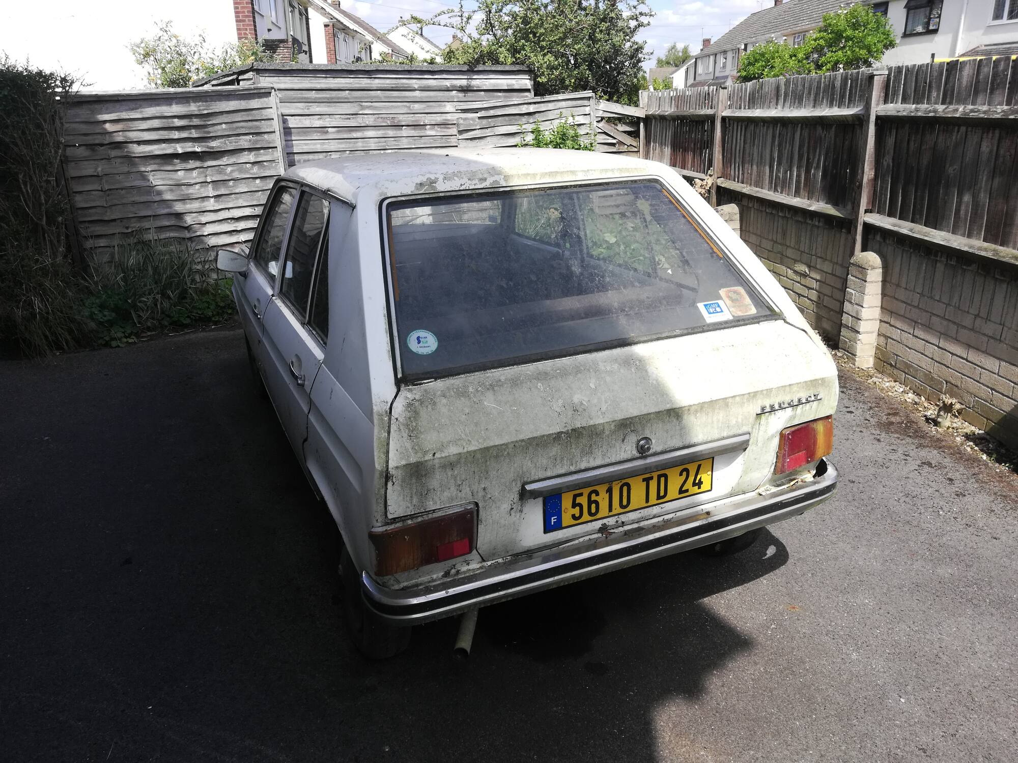

This one, is french - as in French registered and LHD. I did what you really should not do, buy an unregistered import with no paperwork. Why? Alcohol.
This one was similarly cosmetically challenged, including a whopping parking dent. But, unlike the blue one, had spent it's life in Bordeaux so is very rust free. It also happens to be an early 104 - meaning it has a crap saloon style tailgate rather than a hatchback, which makes it really impractical! It's just perfect!

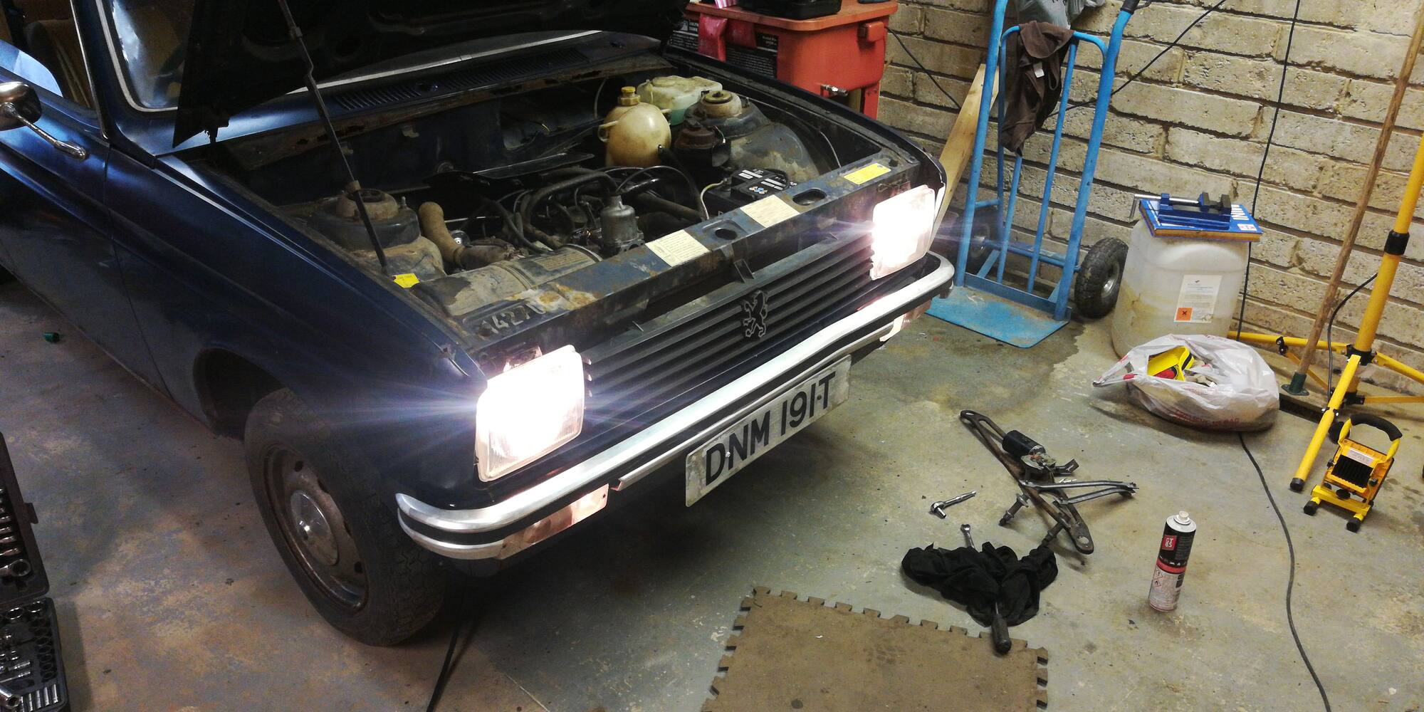

Today, I was able to get the electrics to behave on the blue one.
Next stop is, will she run? The original Solex carb was missing, so I have improvised with an SU from a dolomite. Hopefully it will do the trick.

Anyway. 104 update. The blue one runs! A manifold to fit an SU from a mini was fabricated, the points changed and re-gapped, all electrical connections cleaned up and off she went! A bit more work is required, including cleaning out the fuel tank, to get it to run continuously but happy progress nonetheless!
