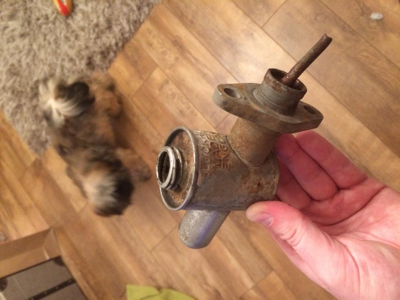

So this is what the cylinder is supposed to look like courtesy of Haynes post-26627-0-29168800-1542788998_thumb.jpg and this is what mine looks like post-26627-0-56742700-1542789009_thumb.jpg with added dog in shot
So you have a broken shaft (K), which is retained by circlip J.
My opening move would be to remove the circlip and have a look at the contents of the master cylinder. If it's rusted to fuck you'll need a new one, or the old one re-sleeved. If it's viable you'll get away with new rubbers D & G.
