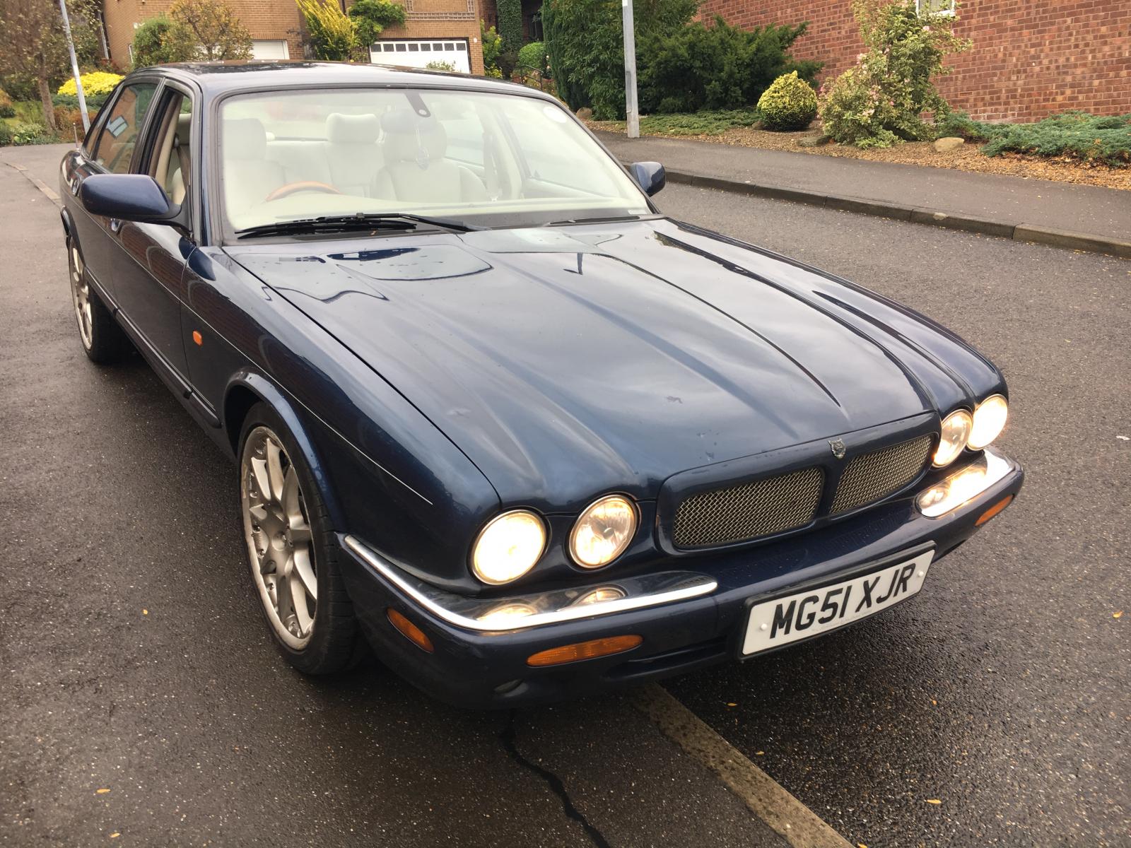

Broadsword Posted October 12, 2018 Posted October 12, 2018 So I've been pretty much obsessed with Jaguar XJRs since trying a broken one (X306) in the spring. They are not very easy to buy though especially as I prefer the XJR6, which is starting to creep up in value. Anyway long story short an X308 fell into my lap just like that last week. I was close by, got there first and did a deal. Interestingly the car was not for sale in a sense, the number plate was. The car was just a freebie. The deal I did, after very nearly just walking away from it, was for the dealer to keep the plate and for me to have the "free" car fairly cheap. The dealer pushed for this since he really rather wanted to deal with me than scores of people who were trying to swap for an Xbox ONE M8. There was total understanding it's a rough car, but given the price it would be fine even in the event that it died since it could just be chopped on for spares. Anyway I left it for a week to clear some room on the fleet. Speaking of witch "PLEASE BUY MY XJ SPORT AS SEEN IN ANOTHER THREAD!". My main concern despite having already test driven the XJR was that would it make the 85 mile drive from Bury to the East Riding. Today was collection day in horrendous weather. The first problem was that the battery had died. I later realized a interior light had been left on which might have drained it. With the engine running a quick check of vital fluids said all was ok, then £35 and off home. The winds were so strong on the M62 that even a 1.8 tonne Jag was getting blown about. I took it very gingerly on the way back, which is evident in me achieving a claimed 25 Mpg. So it's on the drive now. There is belt noise from cold and the headlining has dropped completely. Those are the two main issues off the bat. Also the wheels are hideous. I bought a set of X300 "Sport" wheels. which I picked up cheap. Problem is now I realize the brakes aren't standard XJR, they seem to be the optional Brembos which makes me think 17 inch wheel will not clear the caliper. As irresponsible purchases go, this is up there. Weapons grade Autoshite, hope you approve. I' really pleased with the functional air con and heated front screen as with the lambs wool rugs. They are really rather silly. Obviously the plate is coming off when the DVLA have processes the application, other than that it's running and on the road. For how long, who knows. Haven't made an attempt to use the performance yet due to the terrible conditions. I get the feeling it could go rather quickly though. Exiled_Tat_Gatherer, Bren, stripped fred and 35 others 38

Isaac Hunt Posted October 13, 2018 Posted October 13, 2018 Is that body filler on the wheels? Nahhh, Nikasil Coating, same stuff they used on the bores innit. Ghosty 1
Broadsword Posted October 13, 2018 Author Posted October 13, 2018 No Nikasil after MY 2000 from what I read. So buying the magnificent X300 XJR “Sport” wheels seems to have been a rare* lapse in judgement. They don’t clear the massive brake callipers. That’s sad. If anyone wants to buy the set, let me know. They are currently stripped of laquer and I was planning to paint them silver because some oxidation has ruined the diamond cut look. Have a full set of Conti Tech 3 tyres. Two usable, two not really. The wheels themself are not curbed at all. Tyres are 255/55/17. yes oui si 1
Isaac Hunt Posted October 13, 2018 Posted October 13, 2018 No Nikasil after MY 2000 from what I read.As you were Sir, if it was a DIY refurb it is P38, If it were a pruffesnal job it is Upol. Car looks great and the wheels will respond to some fettling again.

Rave Posted October 13, 2018 Posted October 13, 2018 I think the wheels are great, they just don't particularly suit the car, and make it look a bit like a donk. Though if you need 18s to clear the calipers I guess your options are limited. Something with thicker spokes might suit it better, or a more dished wheel.
Broadsword Posted October 13, 2018 Author Posted October 13, 2018 Pics of condition?I'll get on that tomorrow. There is some laquer residue I still need to get off, then the front surfaces are at least in a consistent* state. I've been using paint stripper and doing it gradually. Today I had a quick look at the supercharger. I was able to slip the S/C belt of very easily. Two 10 mm bolts hold the radiator cooling fans on the rad. Undo them, then pull up carefully avoiding snagging on anything. When the fans are most of the way out you can unplug them both and cut the cable ties holding the cables on. With the fans out you have lots of access to the S/C belt and auxiliary belt. They both have auto-tensioners. At least for the S/C belt you can fit a 1/2 inch square drive into the tensioner and lever it. I used a large 1/2 inch breaker bar which made it very easy indeed. There is talcum powder all over the shop where someone has tried to stop the belt squealing, which probably made it worse. Below is a video of me getting a feel for the S/C. There is no end float, but it doesn't feel tight at all. It feels like weights shifting. Anyone got an informed* opinion? Two videos attached. One showing me fiddling with the S/C and the other with the engine running. Now that I listen to the engine, it sounds like the exhaust is blowing also. There is a small split on one the flexi pipes by the look of it.
Broadsword Posted October 13, 2018 Author Posted October 13, 2018 I think the wheels are great, they just don't particularly suit the car, and make it look a bit like a donk. Though if you need 18s to clear the calipers I guess your options are limited. Something with thicker spokes might suit it better, or a more dished wheel. Yes I think the wheels ruin it really. It's kind of a shame it has the massive brakes otherwise I bet the "Sport" wheels would probably go on fine. I'm pretty stuck. I can't justify spending lots and lots of money on wheels. It will have to have a full set of matching tyres given the lethal performance, so I will have to commit to a set of wheels. Worst case I guess I just stick with these and fit new tyres (maybe they would look better painted black?). It's looking more and more that this car is indeed a XJR R1, which should have come with BBS Milan wheels (they look ok). My wheels look just like those from the XJR 100. Anyway at the moment I have thrown away a load of money on the Sport wheels which I need to try and break even on. This will never be a very exemplary XJR, but it might have a fighting change at getting the engine running right. The interior will clean up definitely (just that arm rest and the sagging headlining are real eyesores). The bodywork might just scrub up to medium good. If it then went on to pass an MOT, I would be rather pleased. Rave and Carlosfandango 2
xtriple Posted October 13, 2018 Posted October 13, 2018 Gonna go against the grain and say 'I like the wheels!' They'd look good with a splash of silver paint around the rims... or stripped and polished What's an XJR R1? Isaac Hunt 1
Broadsword Posted October 13, 2018 Author Posted October 13, 2018 Apparently: "Available on late XJR models was an "R1" performance option. This included 18" BBS wheels, larger Brembo brakes with cross-drilled rotors, and re-tuned suspension." xtriple and dome 2

dome Posted October 14, 2018 Posted October 14, 2018 Top work here! I love these. Looking forward to seeing how you get on with it.Agreed on the wheels letting it down but be patient, sort out the other bits and pieces and a set will come up. Although powdercoating would make them look a milion times better, have you thought about that?I'm keen to see how you get on with the supercharger, I've never had one in bits. Or even owned a car with one. Yet...

Noel Tidybeard Posted October 14, 2018 Posted October 14, 2018 as daveX3 suggests the wheels would prolly look a millionty times better after a refresh xtriple 1
