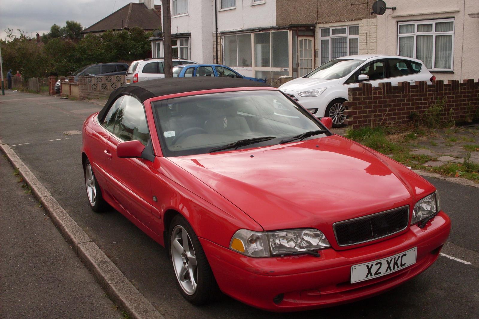

The Red Baron. Surprising.

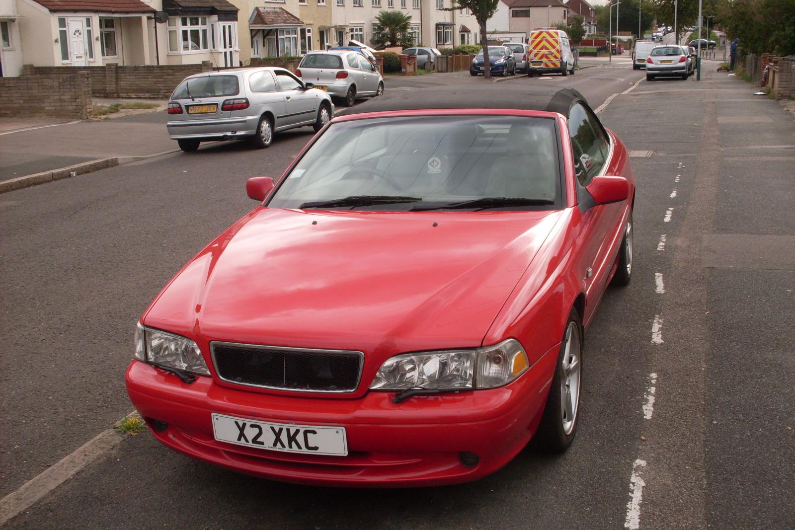

So, what do you do when you decide that a convertible may not be the best idea for the winter months?
Easy, you put your Autoshite head on, and go and buy one of these:

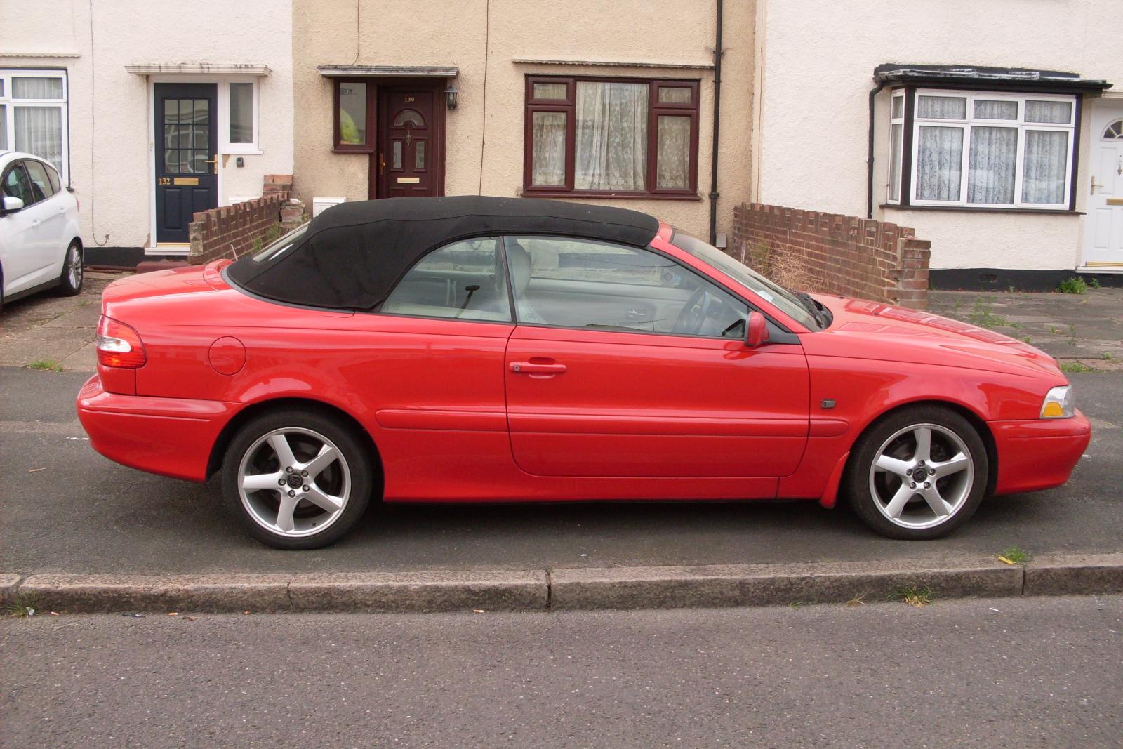

Photos are 'as bought'. I've done nothing to it yet, save turning off those bloody day running lights.
Collected yesterday from Waltham Cross, Essex. It's a 2.0 litre GT auto. MOT until late June '19. Mileage is just north of 85k. Drove extremely well back to Rainham. It was originally on an 03 plate.

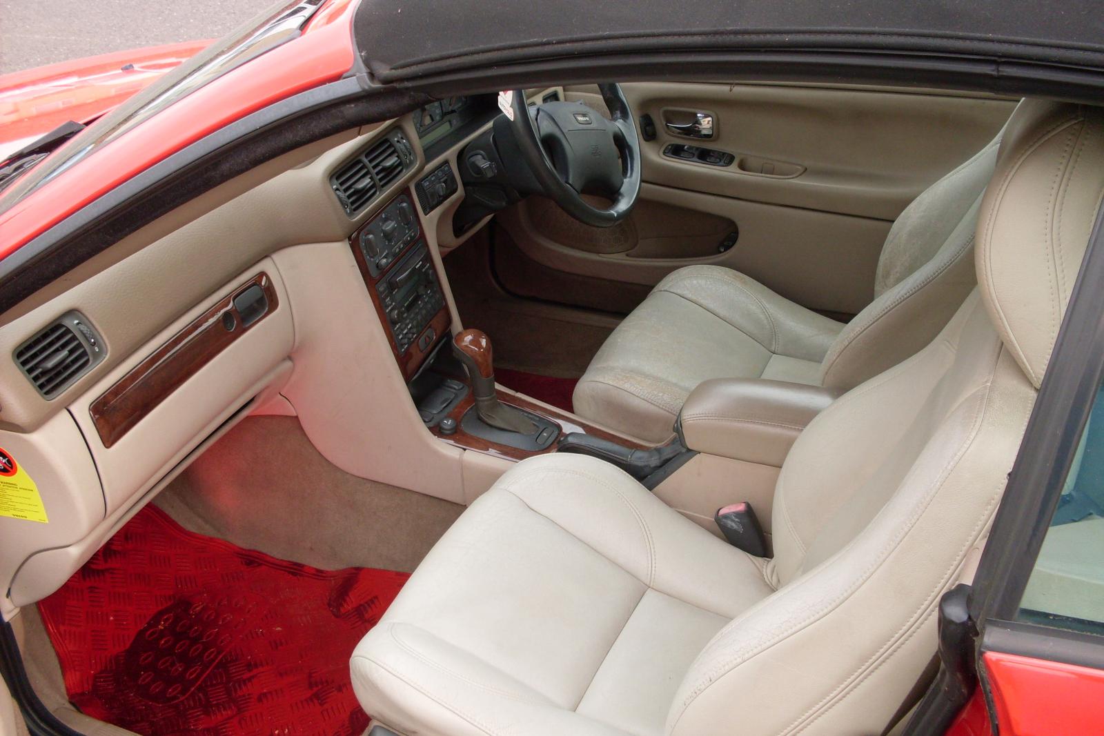

They are a tad garish, aren't they.
It's got original overmats in the boot, so may just change those.

Pretty car.
Volvo seemed to encourage buyers to choose actual colours on c70's , which when it comes to convertibles always looks better than the default Germanic silvergreyblack.

That looks amazing (bar the mats). Well done.
Bloody brilliant that looks

The mats, well, my first comment to Mrs Tet was to say I was going to get rid, but she actually likes them, so because I'm a doormat - sorry - thoughtful husband, they can stay for a bit longer.
Looks like the Devil's lounge, doesn't it!

That looks lovely, would prefer a chip cutter grill. but love the colour

Floor mats aside, that looks very tidy.

It wants the proper grille and badges refitting.
I don't have 'em Rev.
Some people rather like these mesh grilles.
I'm shruggy shoulders about them, neither like nor dislike.

Ebay is your friend. 20-30 quid and it'd be back to standard.  It looks dreadful with that grille.
