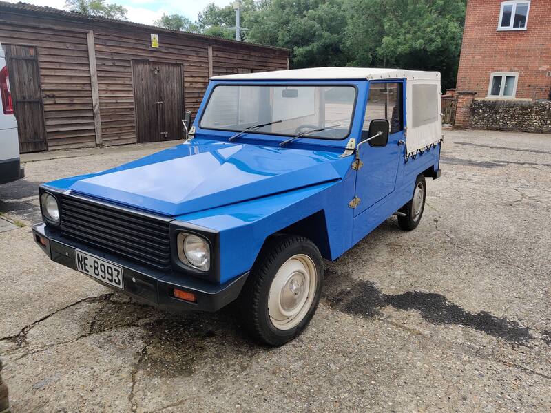

Popped down to Hampshire today to pick up a replacement door for the van. The man selling it was clearly a serial 2cv botherer,  and had many many 2cvs. He was also about to start making kits for a pony replica, this is one he had brought over from Greece
Looks fun!

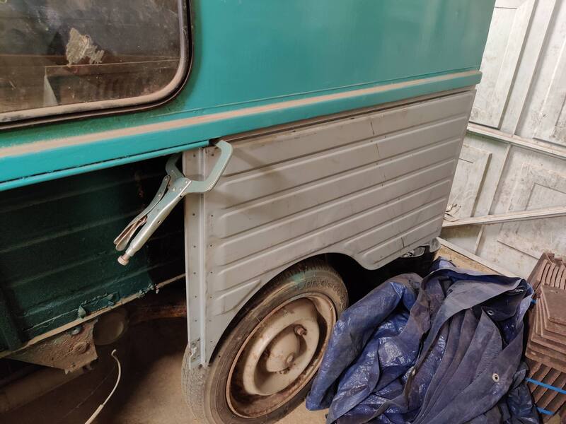

Where were we? Ah yes, fitting the nearside rear wing:IMG_20200618_203941.thumb.jpg.95e20db5912ab4e15eeaf46b5dbd97a3.jpg

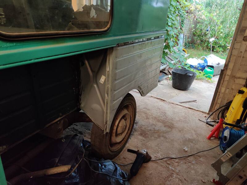

Found some more time today:IMG-20200822-WA0005.thumb.jpg.75024d958a534b8f92854bab0637b98b.jpg
Ta da!
Hopefully the etch primer I've ordered will arrive this week so I can paint it over the BH weekend. I think that is hopefully welding complete.

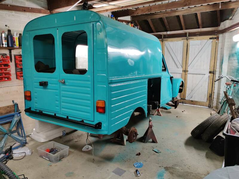

Where did we leave this? Oh yes. Bit of welding on the rear wings. That's all done and dusted, front doors painted now too. Couldn't find a windy window door so I picked up a replacement slidey door. This had a repair panel fitted , not too badly fitted but filler wasn't the best finish. Not claiming I can do any better of course, but I tried and at least the shonky work is my shonky work.

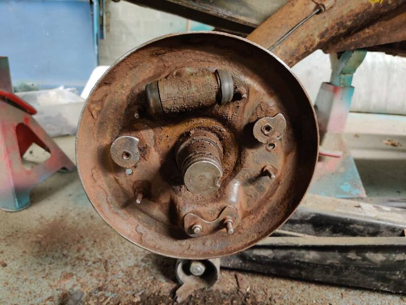

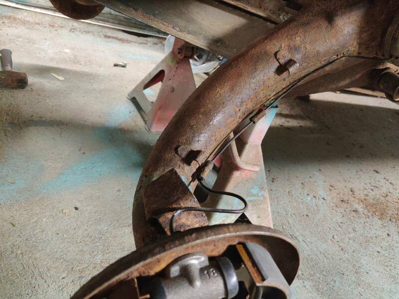

With that all done I thought I'd pay some attention to getting the car rolling and running. When moving it the rear brakes sounded like the were grinding, so best to inspect and replace.  Up she goes:
Now get the drums off and .... Oh. Nasty.
Eagle eyes readers will notice the next picture isn't much good news...
Yup, pivot sheared off. Not sure what to do now... I fear those are brazed/welded in. Anyone faced this before? I can't believe I'm the first...I'd ask on the 2cv Facebook group but I've forgotten my password and one of the three 'trusted' password release people is my 80year old dad... He's never going to manage to authenticate me. No bother, I'm not missing out on much on there anyway 😉
Eesh! Not good. I've never heard of that happening, but that doesn't mean it hasn't. I had a hell of a game getting one shoe off on my 2CV so can't have been far from doing the same!

I would tack on a tube which tightly fits over the remains of the sheared stud then use it as a drill guide then replace it with a bolt entered from the back held in position with a blob of weld.
Or if you have a steady hand you could grind it off flush then centrepunch and drill out dispensing with having to find/make a drill guide.
From my pal Laurence. "I heated around the stud and then hammered it out, new one pushed in and a bit of weld to secure. Obviously stays in place once it is tightened. I have had a look around and as I feared it is no longer available, but a tame lathe man could easily make one. Lesson learned though for us all - treat these very carefully! The nut and eccentric are available, the stud isn’t!"

I was wondering if back plates are available, seems they are from some places, but it's not clear how easy they are to replace. No pivots available? Sigh.

Unfortunately the backplate is welded to the suspension arm.   A brilliant piece of innovative design!
Damnit! And of course acadiane rear arms aren't particularly easy to come by.
10 minutes ago, meshking said:
Damnit!
Yeah good luck welding the new one on straight.
I can make a few pins or any similar parts if anybody is really stuck, but would need accurate dimensions or an unmolested pattern.
In practice you would probably get away with a plain through bolt and a nyloc nut.
Yeah, I've gone off the idea of welding a new one on. Will try to find a replacement arm. Sigh .

Looking at the pics, I'm not sure it would be so difficult as the backplate has a spigot which locates it on the stub axle.
So where did I get? Happened to mention this to a travelling 2cv mechanic and he swung by one evening.
After 45 mins:
He drilled out the snapped thing, tapped the thread into it, screwed a new bolt in and welded it to the back plate.
What I didn't realise is that this has a larger bearing making the replacement drums made of unobtanium. So he kindly offered to take the drums away and separate the wear surface from the hub and replace with a set of drums he had turned on a lathe.

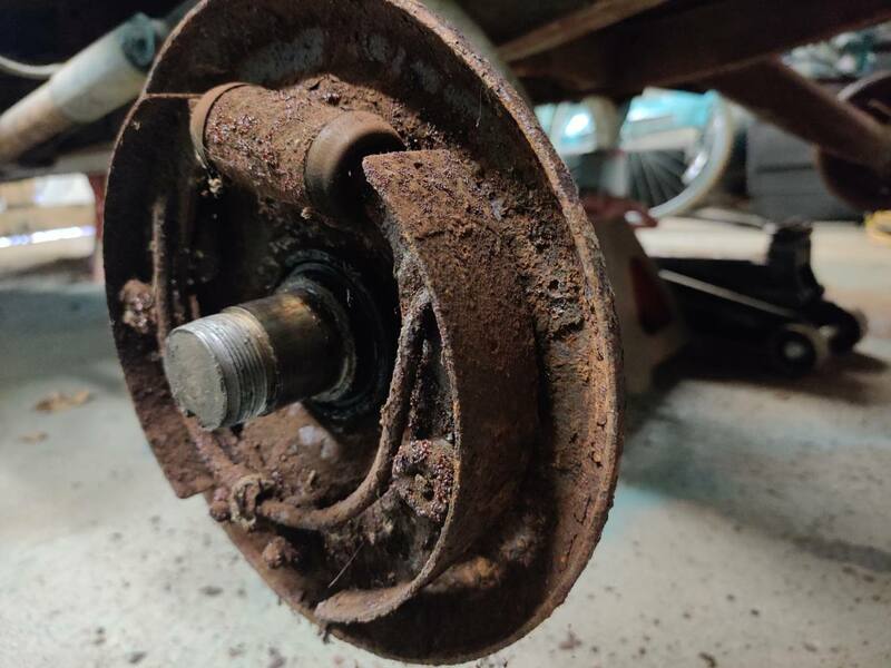

Better take the other side....IMG_20201104_115403.thumb.jpg.f6780cecf80259e59e2251fe6d290dd0.jpg
Same story. No friction material left here either. Looks like it has been parked in a lake. I'll get all this cleaned up, new brake pipes going in and we should be back motoring.

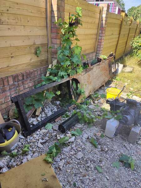

This work took sometime as I managed a change in job and dealt with the loss of my father. This meant that certain things left in the garden had begun to return to nature
Here, my grapevine has decided it prefers french vans to cling to. Understandable.

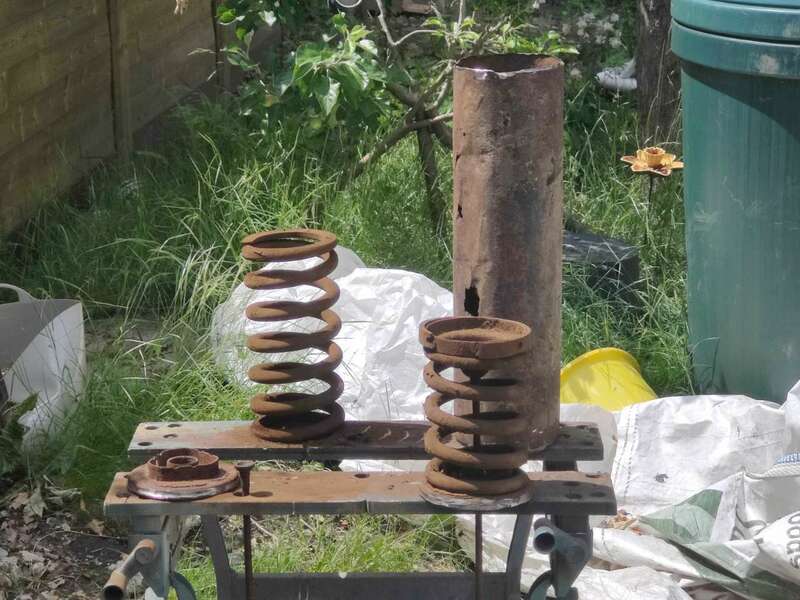

Spring cans were knackered, so can was replaced.
IMG20220611103600.thumb.jpg.7b7116660f7a627ca40ac0a7357cf0a4.jpgIMG20220611103608.thumb.jpg.0c230bf35e70f111807b16cfc5c08451.jpgif anyone wanted to see inside an Acadiane spring tube, here's your chance:IMG20220602132302.thumb.jpg.5b91f0461840655a6546c591963068e6.jpg

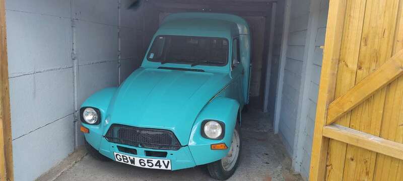

Thread update : a new project vehicle has been purchased and this needs to get driven to my lockup. Luckily, it's nearly done!
It's not concours, but tbh it'd be triggers new broom if I got it anywhere near that standard. "Good enough" or "that'll do" were the motivational words in my head.
  • 3 weeks later...
As the foo fighters sang " Done, done and I'm on to the next one "
Drove the van to my lockup and tucked it in:

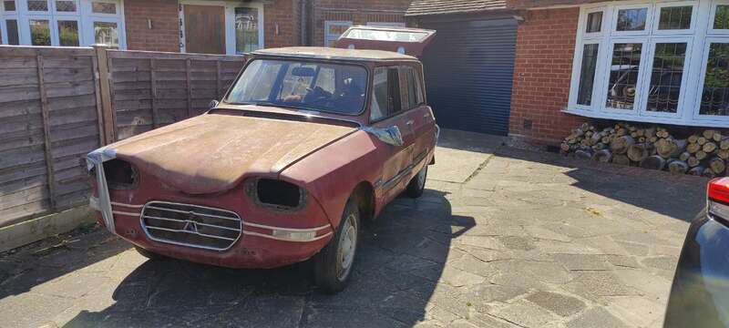

With a hole in my garage, the itch started again. Definitely not encouraged by @Skizzer @320touring @Kiltox and @RobT, one copy of 2cvgb later, a couple of phone calls and today this arrived:
Definitely needs some work - but it's honest. Chassis is solid (genuinely, not acadiane solid) but the floors less so.

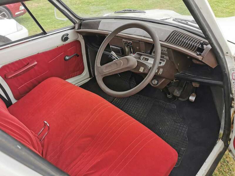

So what is it? It's the Citroen a series that I haven't owned - 1967 Citroen Ami 6 Break. My wife was ecstatic* to see it arrive today.  Doesn't look great now, but look at it - just needs a bit of love.
Bench seat at the front, single spoke wheel. Lovely. I'm a happy bunny. Friday has been taken off to start stripping the interior out and forming a plan of attack.
