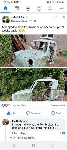

Eyersey1234 Posted May 17, 2022 Posted May 17, 2022 @LightBulbFunanother spot on faceache, sorry I have no idea as to its identity.

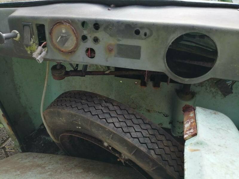

LightBulbFun Posted May 17, 2022 Author Posted May 17, 2022 16 minutes ago, Eyersey1234 said: @LightBulbFunanother spot on faceache, sorry I have no idea as to its identity. thanks for the heads up that is the Pemrbokeshire car as posted above and a few pages back I do know its Identity thanks to @dollywobbler managing to grab the details for me when he visited it in person but I still need to contact the new owner and see what his plan is for it! (hopefully nothing silly) AnnoyingPentium and Eyersey1234 2

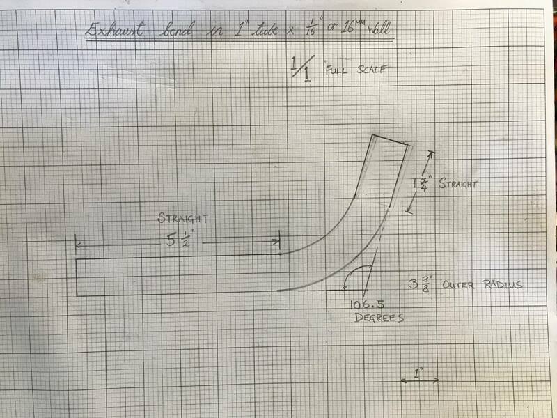

AdgeCutler Posted May 18, 2022 Posted May 18, 2022 I can’t do the exhaust bends so making up some drawings this lunch break. Mrs6C, LightBulbFun and Mr Pastry 3

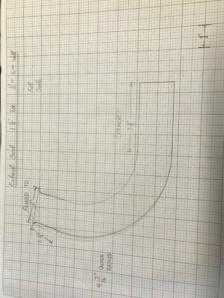

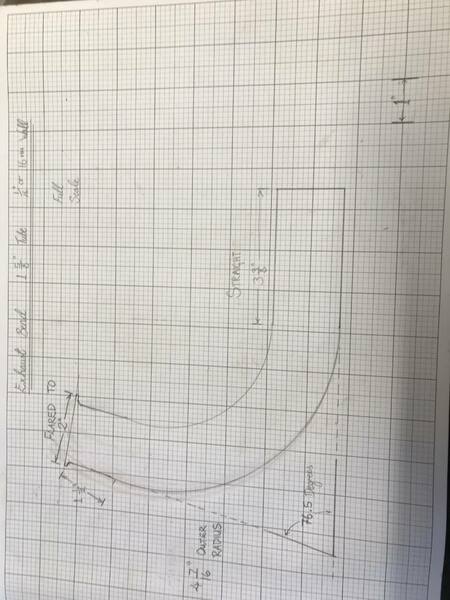

AdgeCutler Posted May 18, 2022 Posted May 18, 2022 Oops, better add the angle! LightBulbFun, Mrs6C, Dick Cheeseburger and 1 other 4
High Jetter Posted May 18, 2022 Posted May 18, 2022 Might be tricky to bend with a 16mm wall - I guess that should be 1.6. Snake Charmer and AdgeCutler 1 1
AdgeCutler Posted May 18, 2022 Posted May 18, 2022 9 minutes ago, High Jetter said: Might be tricky to bend with a 16mm wall - I guess that should be 1.6. I was waiting to see who'd spot that one! Snake Charmer, Blake's Den, High Jetter and 4 others 7
LightBulbFun Posted May 20, 2022 Author Posted May 20, 2022 smoll update on the Pembrokeshire car, I got chatting with the current owner, a nice enough bloke, who is planning to reproduce a chassis for it and get it back on the road! (although I dont know if he means an exact replica of the existing chassis or just something knocked up to get it moving, he did make mention of a Motorcycle engine and a live rear axel which is a bit worrying!) its an ambitious task, but he claimed to be quite skilled in the matter and also quite skilled in Fibreglass so thats good!, and he says that despite the Rocker covers being full of water, the engine was relatively good shape otherwise, so thats good hopefully maybe the engine might be salvageable! (reminds me a lot of the Isle of Skye car, the engine externally looked utterly fucked, as did everything else metal on the car, but internally the engine was perfect!) he made mention that he was not sure how the rear chassis was constructed so, I supplied him with pictures of that, which was he quite thankful for, so hopefully he can be persuaded to knock together a proper chassis for it! I also did the usual thing I do with new Model 70 owners got him up to speed with what he actually has and supplied him a PDF of the workshop manual and hopefully sometime soon ill be getting pictures of the interior to see if I can figure out what controls it may of had egg, Dick Cheeseburger, AnnoyingPentium and 3 others 6

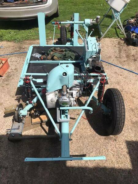

AdgeCutler Posted May 21, 2022 Posted May 21, 2022 This morning saw Brians engine placed back into its cradle and throughout the day I have been refitting several parts. LightBulbFun, Mr Pastry, catsinthewelder and 11 others 14
Weird Car Posted May 21, 2022 Posted May 21, 2022 1 hour ago, AdgeCutler said: This morning saw Brians engine placed back into its cradle and throughout the day I have been refitting several parts. Brian is going to be the best MK12 possibly in the world, I can't wait to see him complete. LightBulbFun, AdgeCutler, 500tops and 2 others 4 1

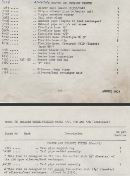

LightBulbFun Posted May 22, 2022 Author Posted May 22, 2022 3 hours ago, AdgeCutler said: Quick video update. its really awesome to see Brian come back-together at long last on the exhaust front, you are correct in that the heat exchanger (Store No 3191) is also the main silencer, the extra bit on the end I think is called the tail pipe by the parts manual (Store No 4128/4132) I wonder if its something to do with exhaust tuning? I know 2 strokes are rather dependent on the design of the exhaust to be performant and can be tuned quite a bit by it, while I dont know anything about it beyond much more then that I do wonder if the tail pipe has something to do with that?, (as I would of thought otherwise a standard heat exchanger arrangement as shown would be quite restrictive to exhaust flow of a 2 stroke engine) AdgeCutler and Mrs6C 2
AdgeCutler Posted May 22, 2022 Posted May 22, 2022 3 hours ago, LightBulbFun said: I wonder if its something to do with exhaust tuning? I know 2 strokes are rather dependent on the design of the exhaust to be performant and can be tuned quite a bit by it, while I dont know anything about it beyond much more then that I do wonder if the tail pipe has something to do with that?, (as I would of thought otherwise a standard heat exchanger arrangement as shown would be quite restrictive to exhaust flow of a 2 stroke engine) 2 strokes like to have a bit of pressure within the exhaust and the balance is important for efficiency and power output. As the exhaust gases are forced out of the cylinder by the air/fuel mix being driven from the crankcase the correct pressure within the exhaust helps minimise the air fuel mix following the exhaust gasses out to the exhaust before the port is closed. As the exchanger is the first resistance the gasses face this is where the back pressure and main silencing is carried out. The tail pipes main function in this case is I feel to take the exhaust gasses away to the rear of the car, the expansion chamber upon it will help further smooth the gas impulses and lower noise levels further. A perforated pipe or baffles here may have been deemed unnecessary and more restriction, detrimental to power output. My thanks in advance to Mrs6c for taking a look into the expansion chamber on her car to further confirm this when the chance arises. LightBulbFun and egg 2
