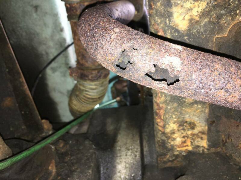

LightBulbFun Posted December 28, 2021 Author Posted December 28, 2021 the rear wheels of a Model 70 are permanently coupled to the CVT system, the gearbox only couples or decouples drive from the centrifugal clutch drum that the clutch shoes on the engine fly wheel engage onto speaking of, just got back (well an hour ago, took me a while to write this!) from some REV tinkering, had a poke at the brakes, well the nearside rear wheel at least! I think the handbrake is working alright, and it looks like adam did a good job greasing all the moving parts like the pivot points and the levers on the back of the brakes but I think something is up with the hydraulic system, either sticking pistons or collapsed flexies acting as a 1 way valve? I can back the adjuster off a click or so and the wheel will then spin freely (accounting for drag from the CVT system of course) and I can work the handbrake no problem, but the moment I press down on the handle bars, the brakes apply but dont let off the curious thing is I can then back off the adjuster once more and it will again free off, but again bind up if I actuate the handle bars, im guessing im slowly pushing the pistons out of the cylinders by doing this? (so I did not do it too many times!) I did try and get some video of this in action, but my knackered phone battery decided then was the perfect time to call it quits I did manage to find the exhaust blow mind! as I thought its one of the downpipes, nearside in this case (aka left hand side if your looking at it standing behind the car) no signs of a patch sadly, dont know if it fell off or after I was told it got patched it was realised it was not working so got took off? im glad its just a down pipe as those are relatively easy to source rather then the actual exhaust/heat exchanger! those are much harder to get ahold of in good order! after the phone battery died before I went back upstairs, I also finagled the twist grip, managed to actually get the new twist grip I had on hand to fit using one of the washers @CaptainBoom very kindly supplied, but Im not sure the quality of the twist grip itself (I cant quite get it to tighten itself to the handle bars satisfactorily) is all that good, but the action works, and knowing the washer method seems to work, ill order up the same set of twist grips that Zel has, knowing that one way or another ill have a way of fitting them! also played with the indicator stalk, as I noticed on my first couple drives that its a bit floppy/vague and I cant indicate right without the stalk fowling the plastic housing and then the entire stalk flopping down, I had a go at tightening it up to the handle bars, but I see the self tapping screws have pretty much pulled out the plastic body of the indicator stalk hopefully I can bodge something up! perhaps see if I can substitute the self tapers for nuts and bolts? (I do have her original indicator stalk on hand perhaps I can get that working again and try refitting, it was working when I got REV, but apparently by the time it got to adams it had mechanically jammed so I wonder if I can un jam it) Andyrew, CaptainBoom, Mrs6C and 5 others 8
