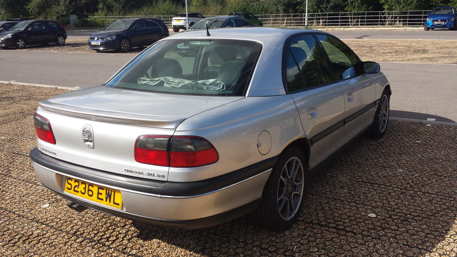

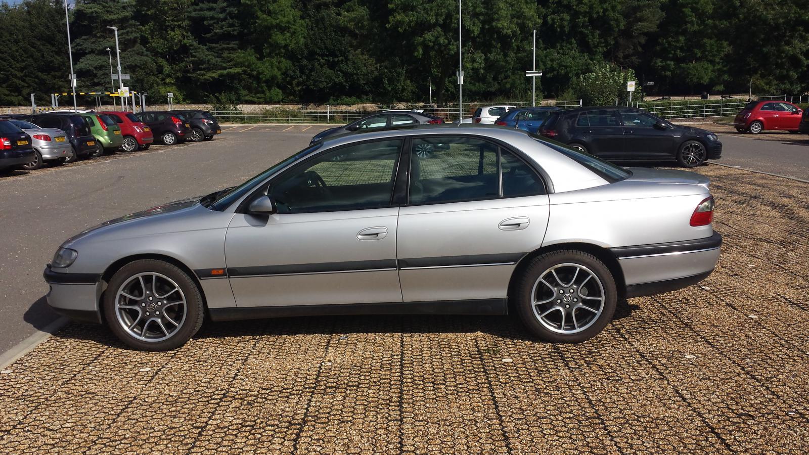

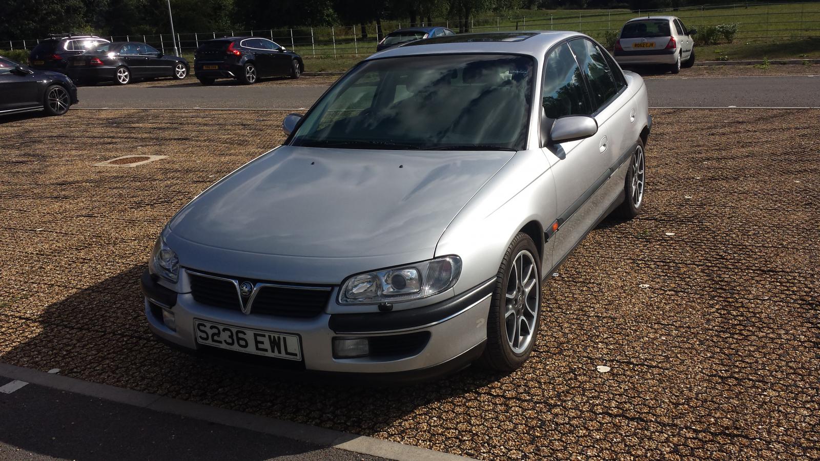

More photographs. I'm not a big silver car fan but the wheels really help give the side profile some interest...

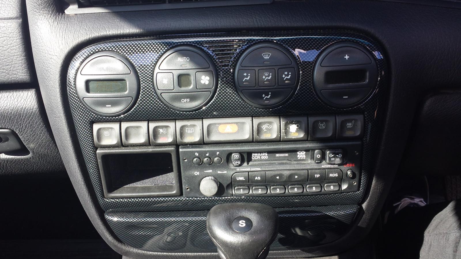

This dashboard is a new one on me. It looks better in person...I prefer it to the wood!

Almost a full complement of buttons above the radio there, looks like the only one missing is for the electric rear window sunblind.
