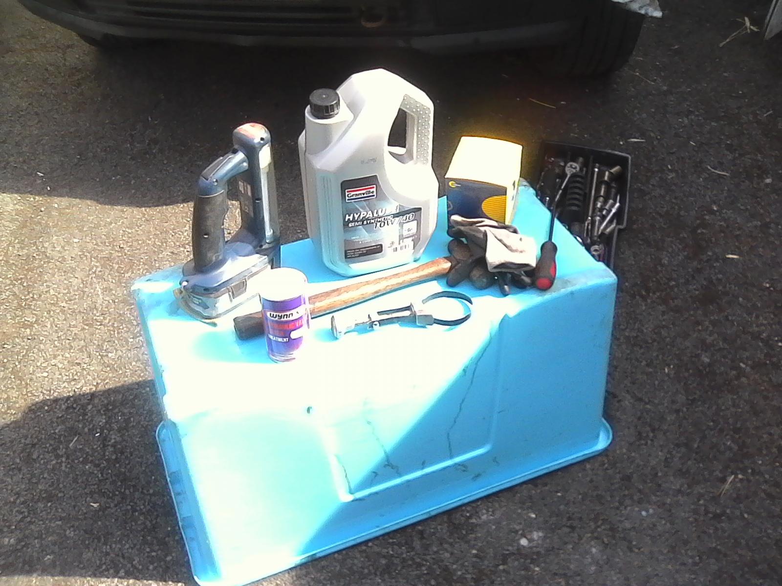

just been to the local motor factors who happily had the correct oil filter in, purchased it and some 10/40 semi synth, and a can of Wynns snake oil for tappety shit :)
The noise came back on the short trip, but I was confident :)
No need for a jack, plenty of room under there with even my girth :)
About the right amount of dead, black, runy oils, dirty filter, who knows when last changed!
Supernatural potion made fuck all difference so far, bah :(
