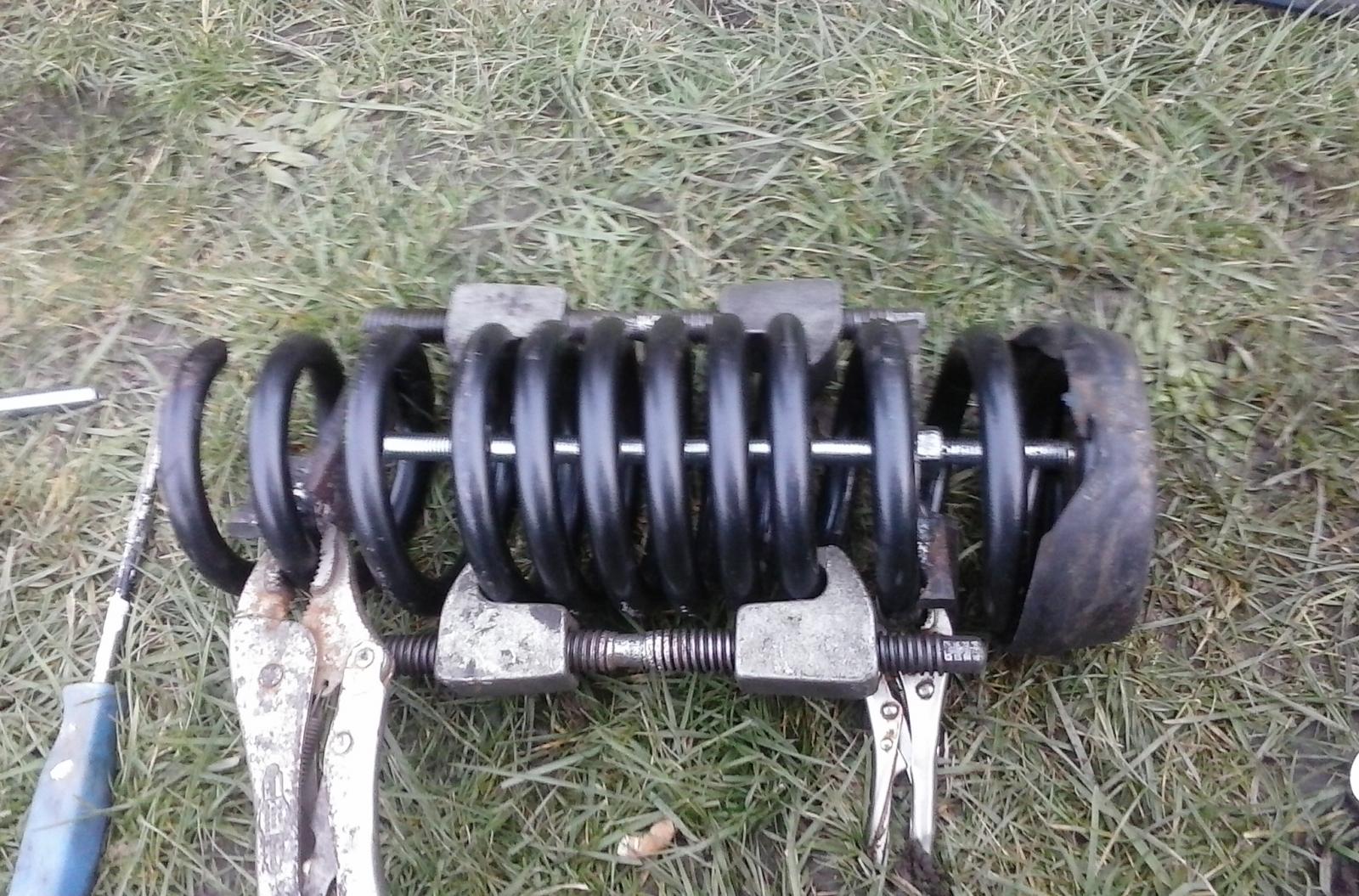

b6200_1024x1024.jpg?v=1402671137
This is the type I've been looking at.

I've got a set of clamps like that.   Useful for coilover type suspension with the really small springs, frightening on anything else.
Braver than me having a go with them :D

I bought a set of these second hand,used once to do a front spring on a W126 a couple of years back, I wouldn't do one with threaded rod and hook type compressors, I've twice had those fly on much lesser springs. Mine were branded Bergen and I hoped they were a slightly better quality Chinese tat than some others, i've seen some shocking shit quality tools. They were available as 1250kg and 3750kg but I didn't see anything to say which springs need the heavy duty ones.
The Merc springs I've done, 300SE and 320CLK, were very strong and needed a lot of compressing, these made it a little less intimidating.

I've done 124 front springs with the Bergen tool, it's worth taking your time and care - you don't want stuff letting go. Second and third time round is easier and quicker.

If it was a MacPherson strut I'd piss it to be fair, those clamp on tools make light work or them if you have good ones and take your time and compress and release evenly.

I used something very similar for the springs on my old W202. I just took my time and made sure I got the 'discs' the right way around. I also ensured, as best I could, that I was out of the 'firing line' at all times. In the end I replaced all four springs. They are notorious for the 'pig tails' to break which was the case in three out of four of mine. No problems to report and I still have my head where it should be.
