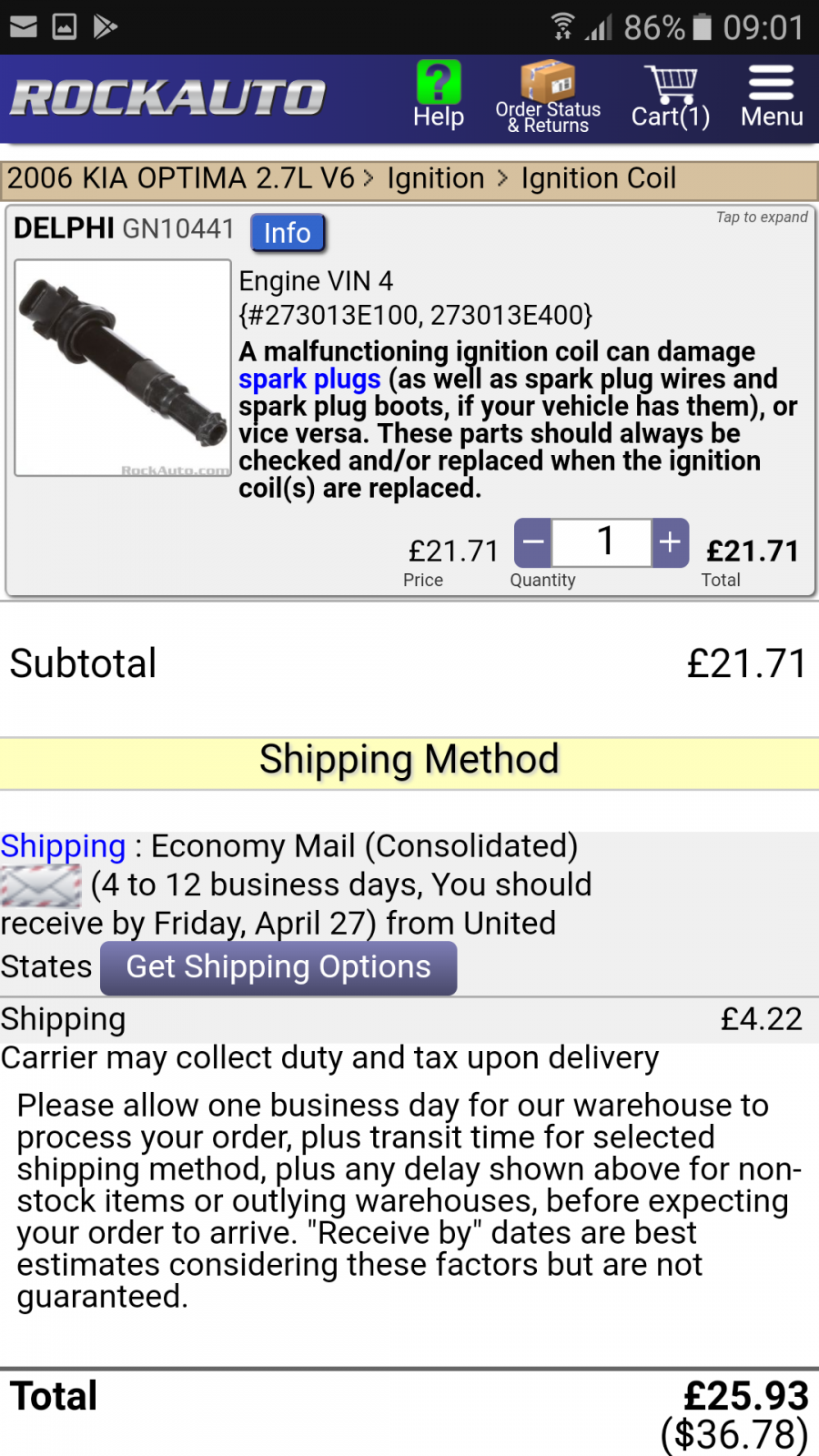

Might be worth looking at www.rockauto.co.uk for coil packs, especially if they are £130 each! Price includes shipping to UK.
1st pic is for a 2008 model with the later theta engine with the vvt, 2nd pic is if you have the earlier delta engine.
