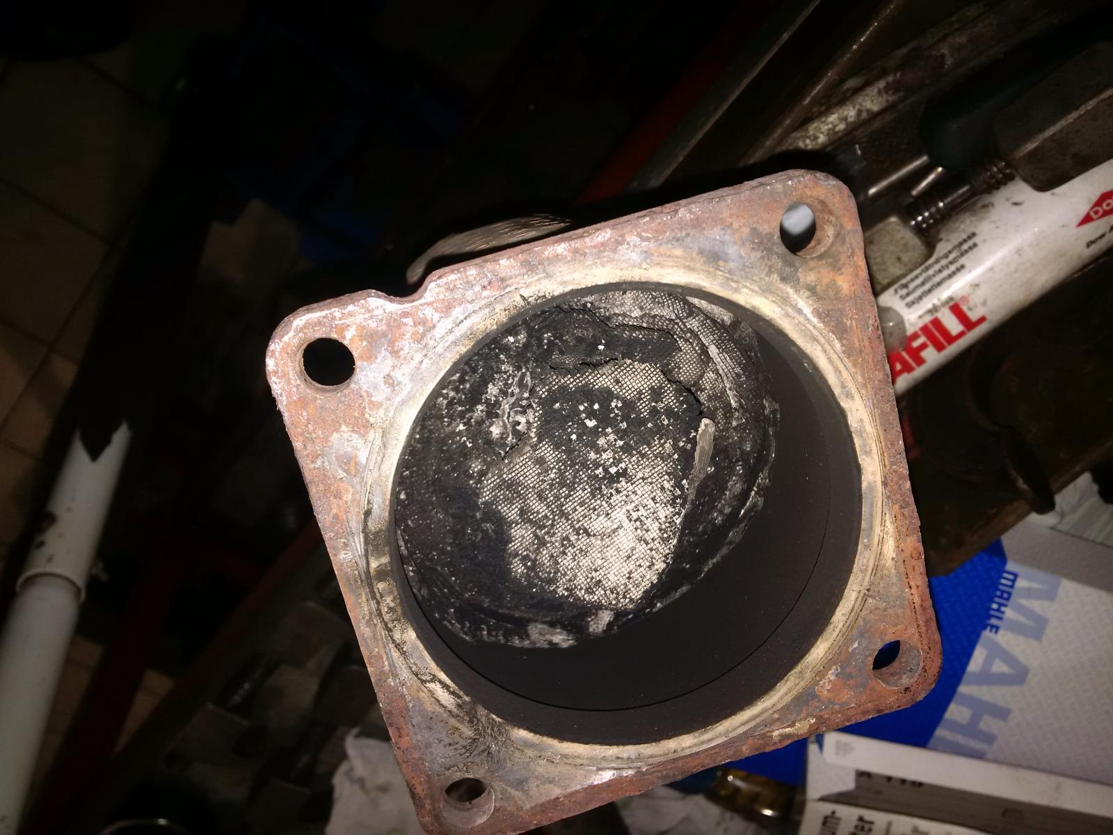

tommotech Posted February 26, 2018 Posted February 26, 2018 This was the melted catalytic converter from the Pug 207 I bought as a non runner. Jerzy Woking and The Moog 2

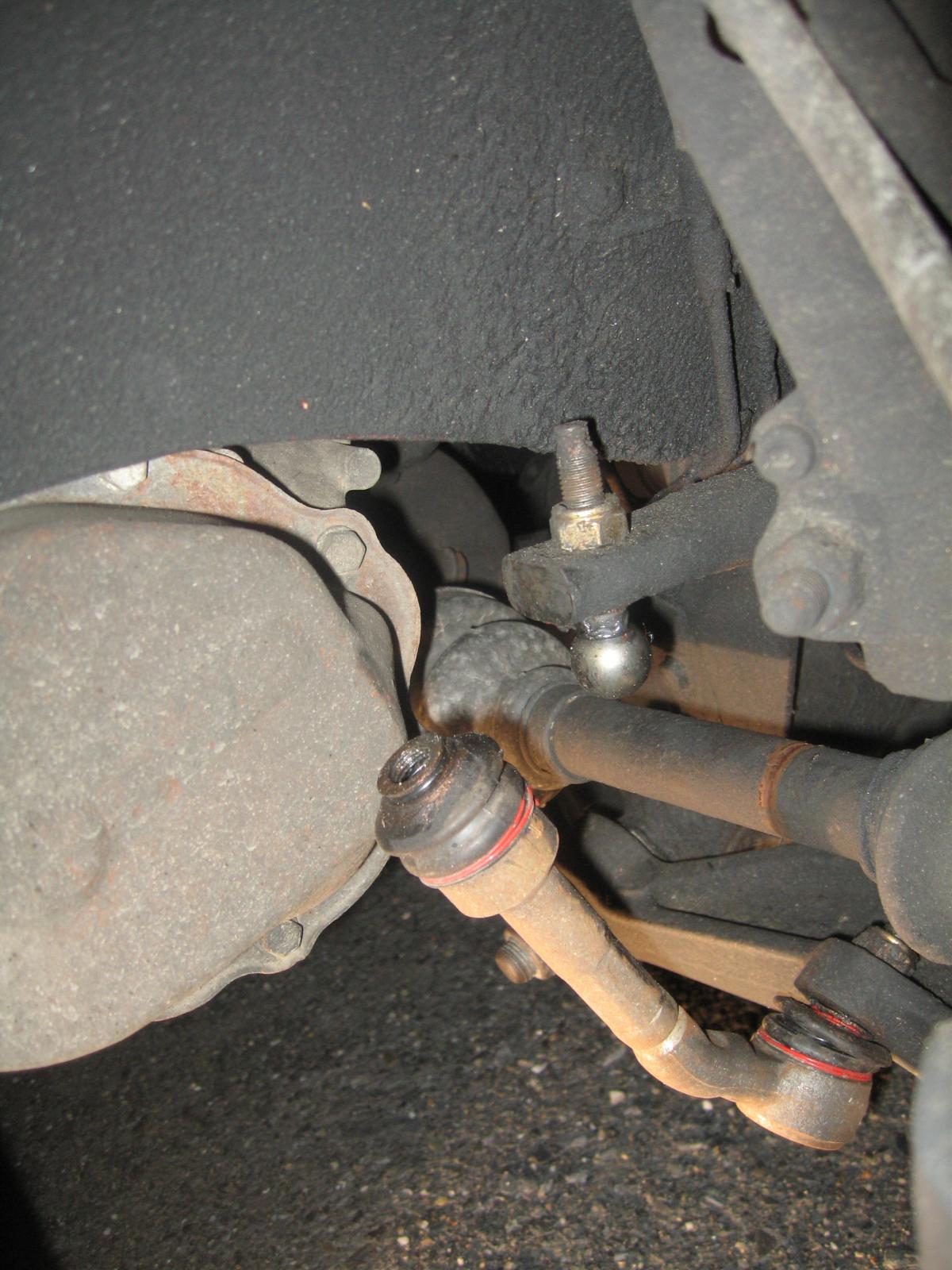

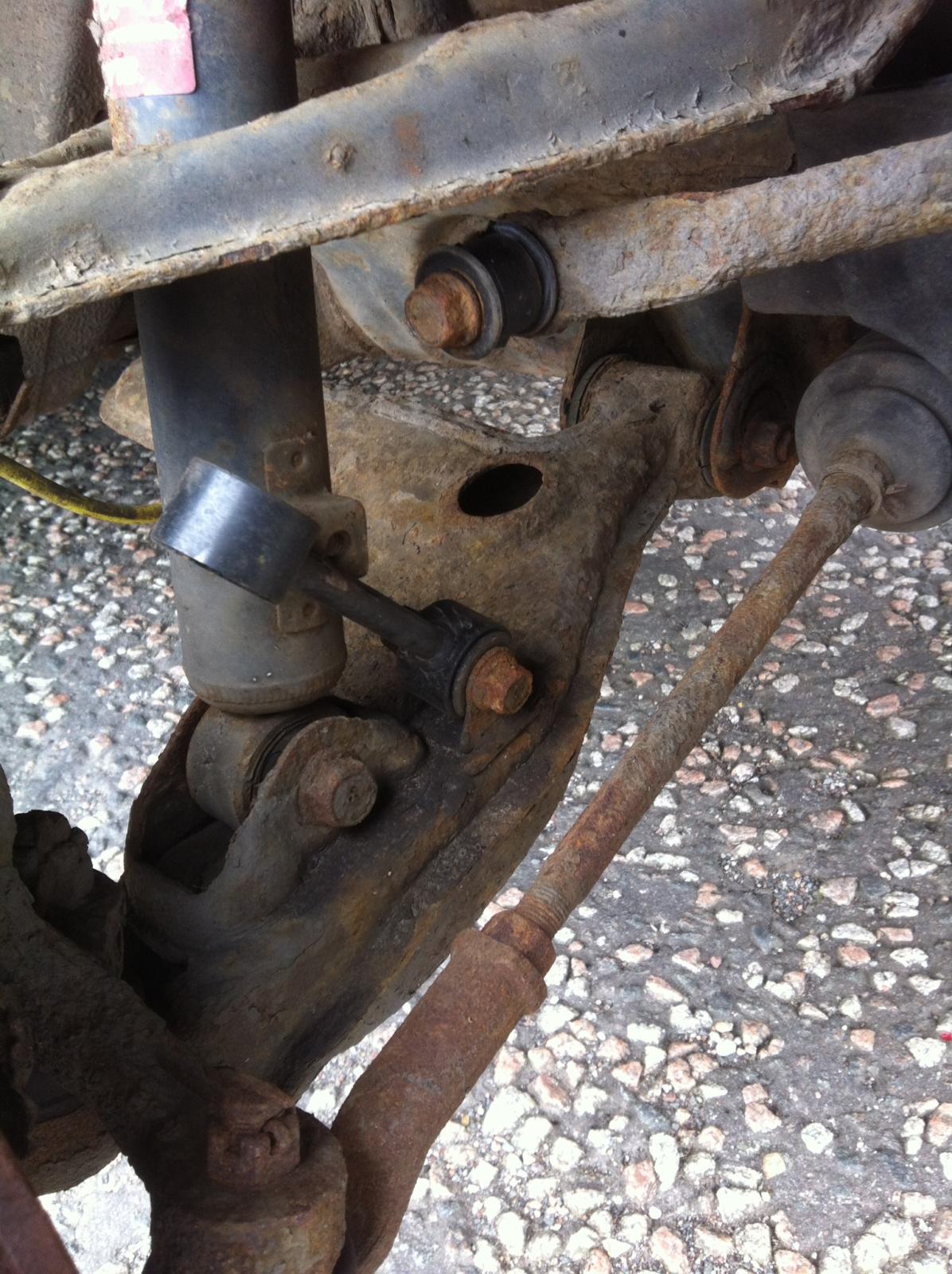

mat_the_cat Posted February 26, 2018 Posted February 26, 2018 This happened on the BX in 2012, after 1 month and 1000 miles. I'd changed them due to a knock, but the only ones my local factor had in were suspiciously cheap at £9 each. Not expecting a long lifespan, I fitted them anyway as they aren't exactly difficult to change. Until a loud bang when going round a corner! As the front height corrector is connected to the ARB, the lack of a drop link on this side meant the suspension strut went up to almost full height, limited only by the compression of the diagonally opposite corner at the rear. That, coupled with no functional ARB at the front made for 'interesting' handling on the 400 mile drive I was on... I went for genuine drop links after that - phoned up my local dealer only to be unhelpfully told they were NLA from Citroen. They were about to put the phone down when I asked if they could do a dealer stock search for them, when it turned out that they themselves had one in stock, and so did another dealer about 30 miles away! Talk about disinterested. richardthestag, Talbot and 320touring 3

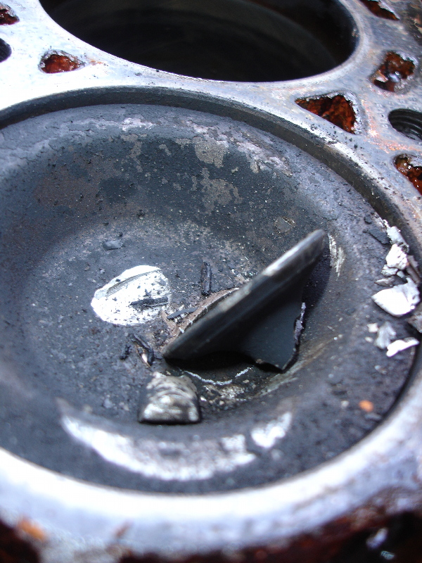

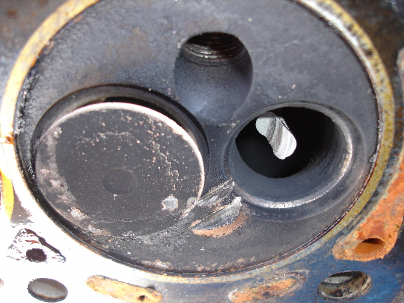

Guest Hooli Posted February 26, 2018 Posted February 26, 2018 This was due to slight* overheating due to a blocked sludge trap. It also took both cams, cam followers & tappet blocks with it. Made for a bit* of smoke etc as I was on the M1 at the time. Sigmund Fraud, Squire_Dawson, HarmonicCheeseburger and 9 others 12

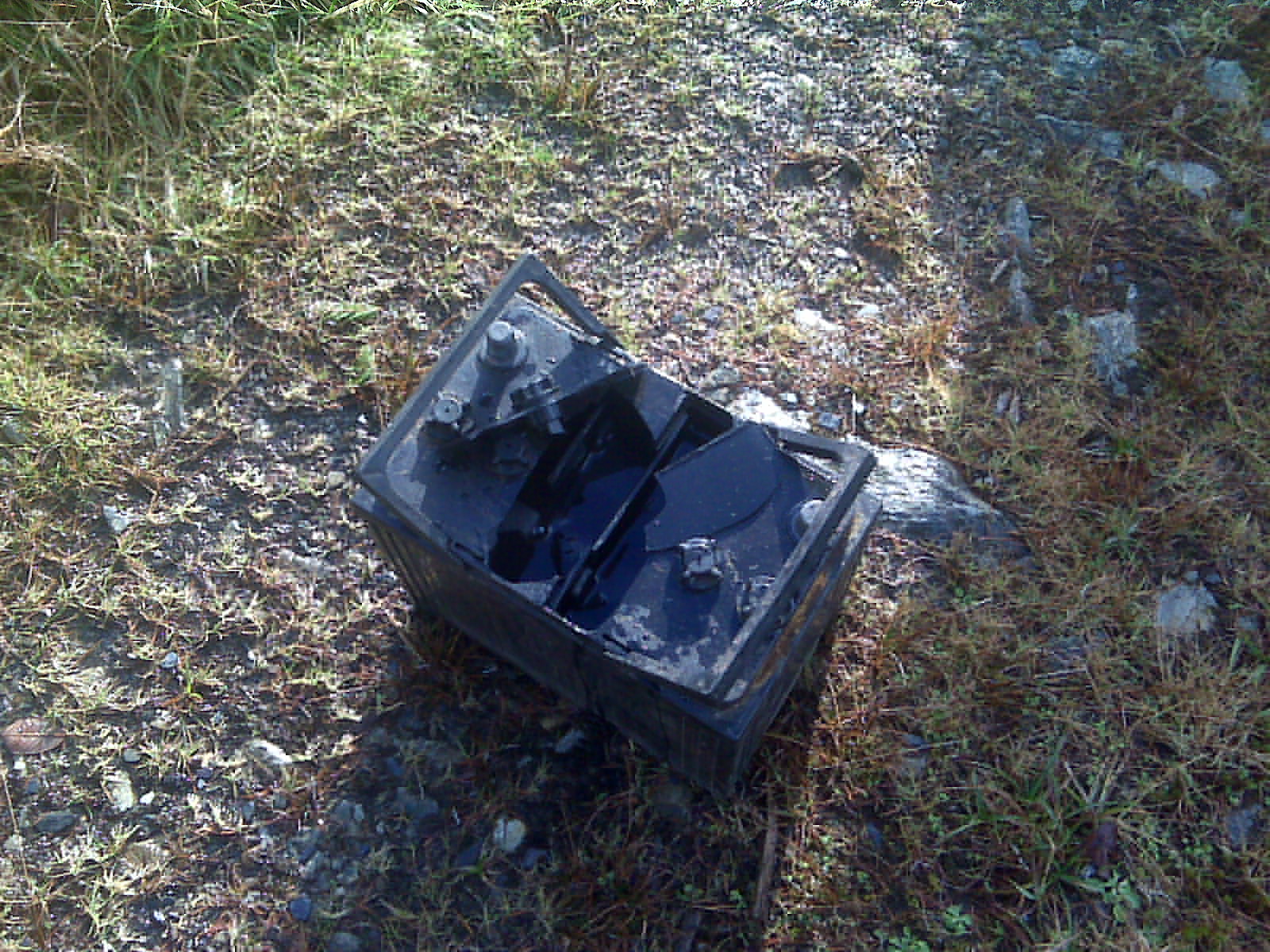

dollywobbler Posted February 26, 2018 Posted February 26, 2018 broken drop link.jpg This happened on the BX in 2012, after 1 month and 1000 miles. I'd changed them due to a knock, but the only ones my local factor had in were suspiciously cheap at £9 each. Not expecting a long lifespan, I fitted them anyway as they aren't exactly difficult to change. Until a loud bang when going round a corner! As the front height corrector is connected to the ARB, the lack of a drop link on this side meant the suspension strut went up to almost full height, limited only by the compression of the diagonally opposite corner at the rear. That, coupled with no functional ARB at the front made for 'interesting' handling on the 400 mile drive I was on... I went for genuine drop links after that - phoned up my local dealer only to be unhelpfully told they were NLA from Citroen. They were about to put the phone down when I asked if they could do a dealer stock search for them, when it turned out that they themselves had one in stock, and so did another dealer about 30 miles away! Talk about disinterested. Did you get any photos of the battery you once managed to blow up?
mat_the_cat Posted February 26, 2018 Posted February 26, 2018 Did you get any photos of the battery you once managed to blow up? Oh yeah, forgot about that one! I was angle grinding near to a battery on charge, when there was a sudden bang and a mild stinging sensation to my face. Minor damage to the workshop roof; rather more terminal (groan) damage to the battery. richardthestag, 320touring, Squire_Dawson and 10 others 13

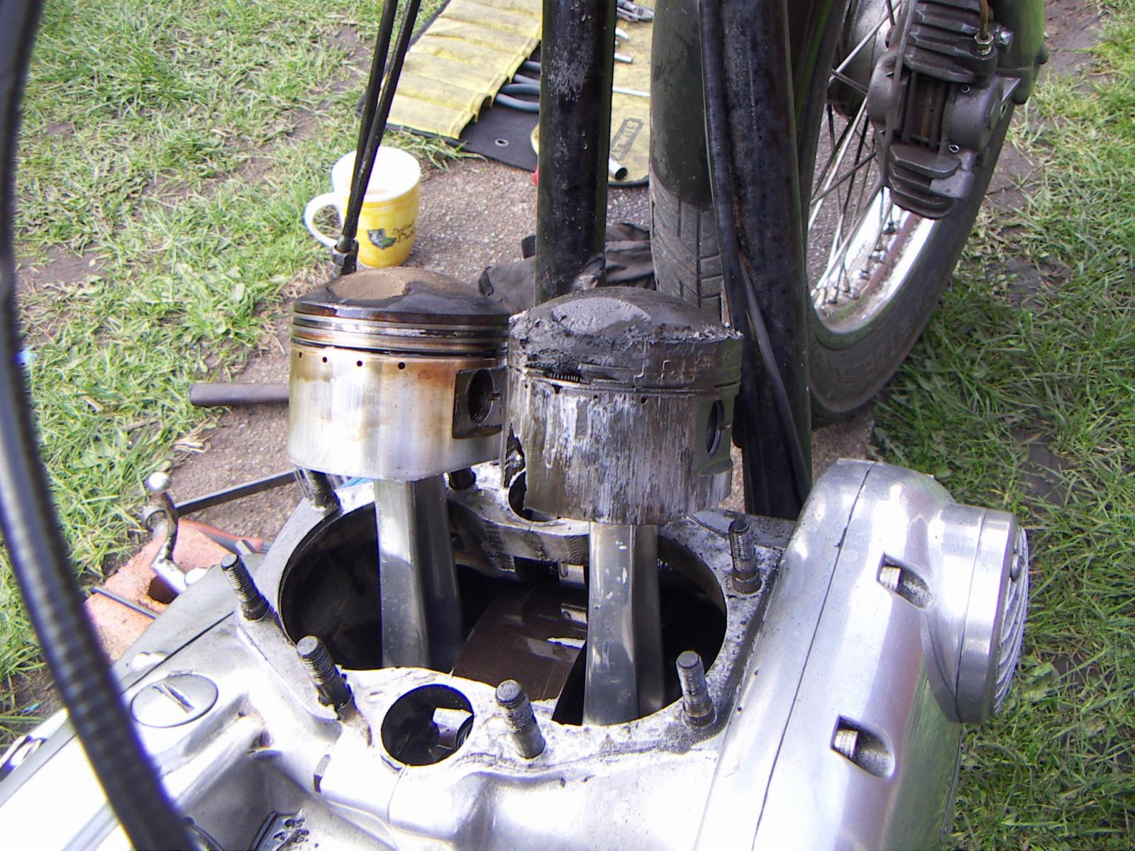

djim Posted February 27, 2018 Posted February 27, 2018 A piston ring snapped on my Yamaha RD125 on the A2 at about 70 mph, causing quite a rapid deceleration a long walk to the nearest phone, and a fair amount of wear to the engine. A few weeks and an engine rebuild later I was attempting a wheelie outside my 6th form as was the style at the time when the throttle cable snapped fully open and, unable to slow down, the bike deposited me on the outside of the curved driveway. I still miss that bike. catsinthewelder, Lacquer Peel and yellowperil 3

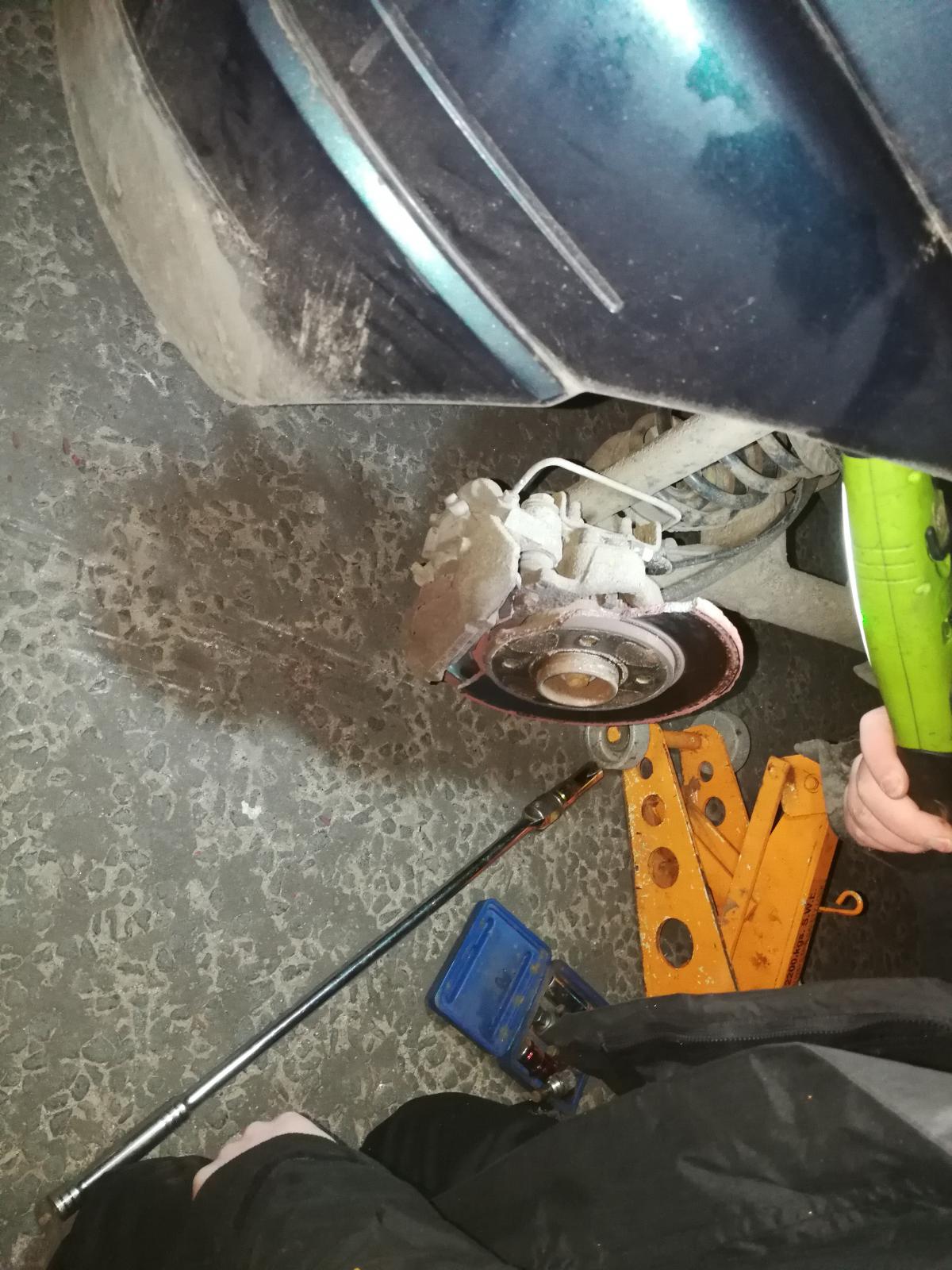

Supernaut Posted February 27, 2018 Posted February 27, 2018 Rear wheel bearing on a Peugeot 306. The wheel wobbled like the bolts were almost completely removed, then upon removing the drum, the above scene greeted us.The noises it made while driving were 'interesting'. Every time the bearing caused drag, the back end of the car would drop down due to the design of the torsion beam rear suspension on them. It dragged a few times, creaking and groaning each time, until it went BANG and started wobbling. There were wear marks on the plastic arch liner from the tyre scraping it. 320touring and Lacquer Peel 2
