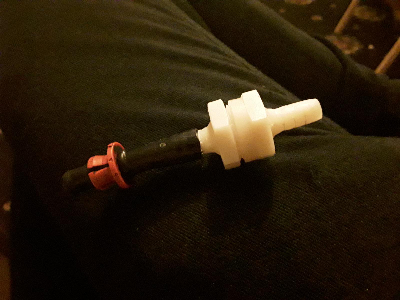

I think it's the non-return valve on the PCV. It's snapped (and has obviously been glued in the past). This is apparently only available as the entire pipe assembly, for thirty notes. £30! For a short plastic pipe and a plastic valve. Cue a bus journey to the local factors for a generic valve.

Looks very similar to the snapped one on my 95. It's stuck together with stickafllex & cable ties.
This had already been glued up once, and there wasn't much area to glue or sticky-out bits to hold it together mechanically. I've got a replacement, lightly modified to fit. It'll go on tomorrow-need the wife's hairdryer to get it into the tiny pipe.
