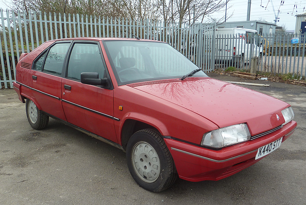

This afternoon I helped a friend move his car 30 miles, what a treat to drive a BX again as I have not driven one for a while.

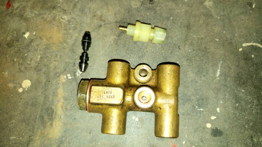

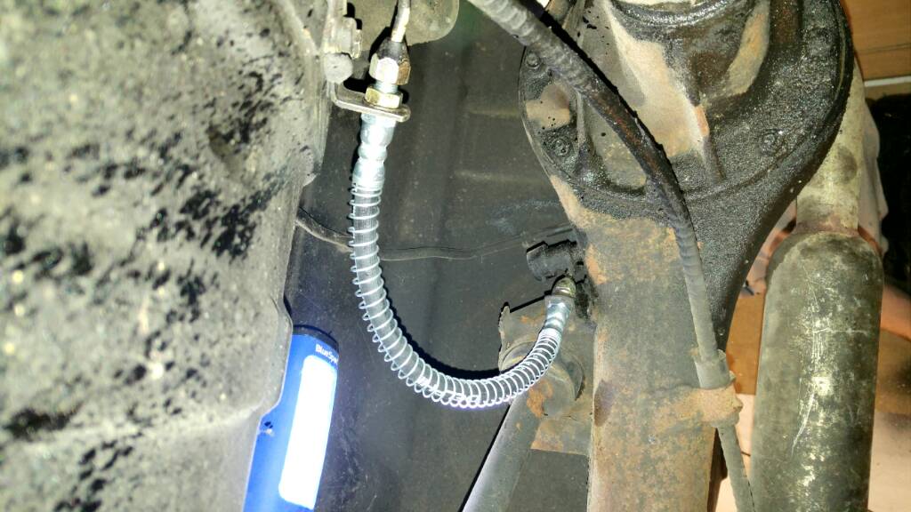

Yesterday I had my dad round to help me with the brakes on the Dolomite, the pedal drops when you have pressure on it and the Brake light says on. We already rebuild the master cylinder and replace other parts to no avail but a read online says the PWDA valve which transfers the braking power between front and rear could be at fault so I ordered a repair kit for It which is basically 2 tiny O rings and a copper washer for £9!
First we replaced all the brake hoses to rule them out and the removed this valve which was a right faff, I had to cut my nice 11mm brake pipe spanner in half just to get all the 5 pipes of this valve as the access is poor.
After rebuilding it and putting it all back together again we bleed the brakes which took 3/4 litre of DOT4 only to find the fluid was pissing out the switch on the valve... Arse. So off it all came again and stripped down to find one of the O rings got a chunk sliced out of it when we pushed the piston back in. FFS.
