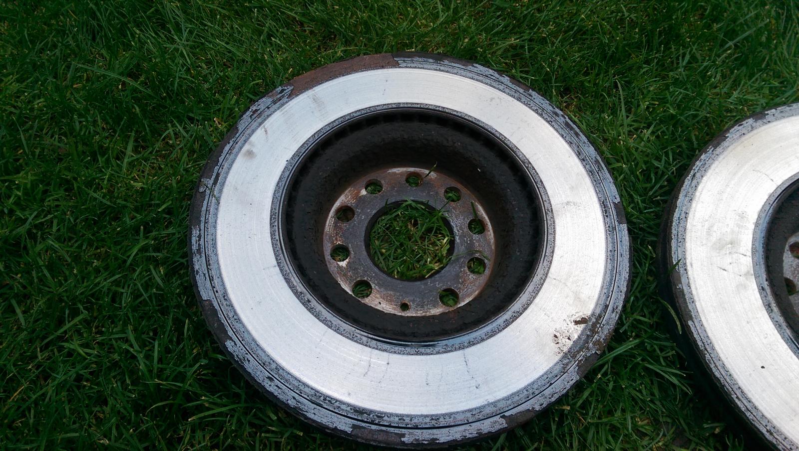

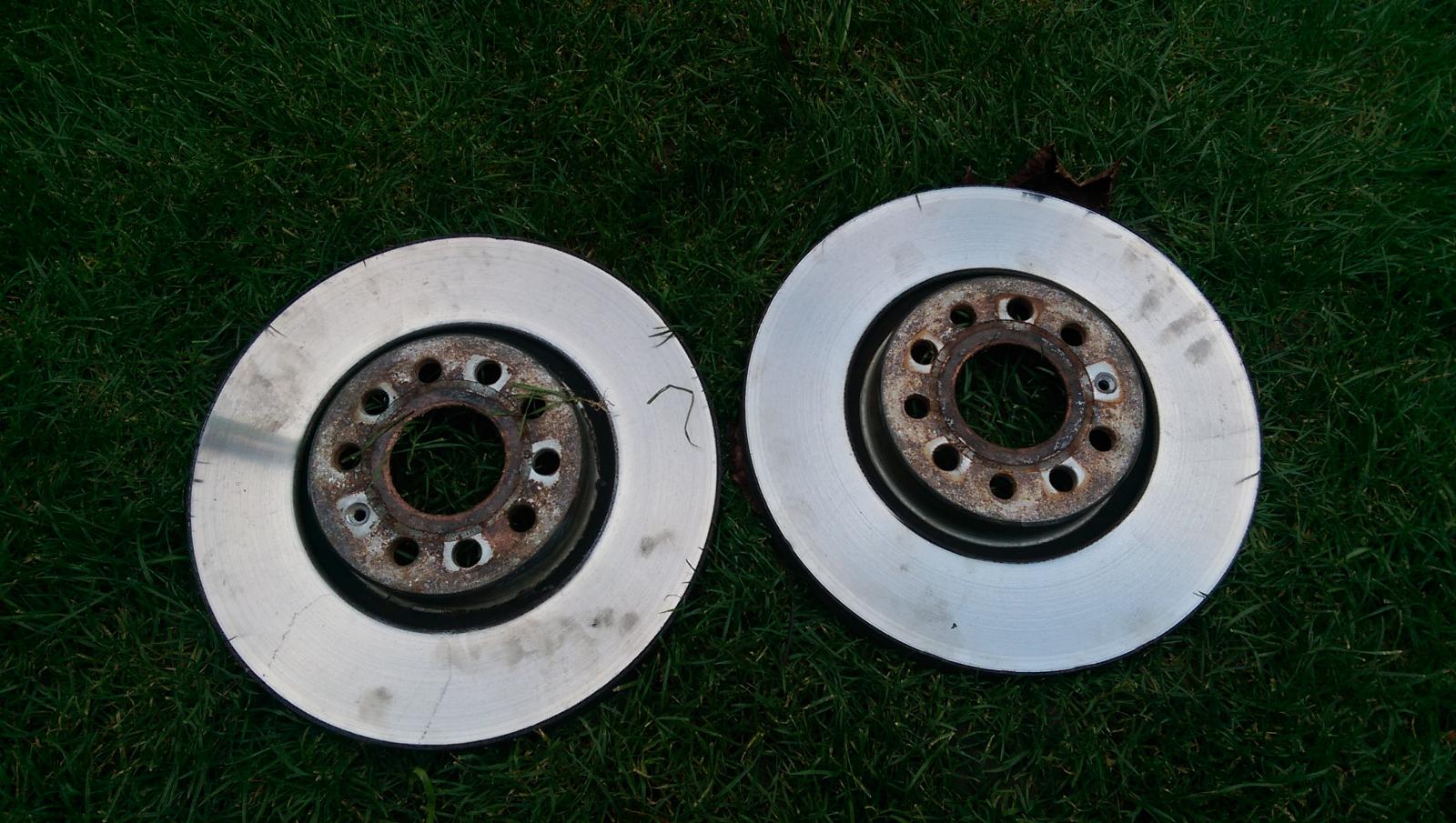

Front pads and discs changed on my mates 2010 octavia. Fronts went well, and were well due changing (56k, original parts if the vag stamped pads were anything to go by)
Couldnt do the rears as he needs to buy some spline bit, so thatll be next weekend.
We put vented and grooved discs on the front though, and under braking you can hear the pads catching the grooves. Is this normal/will go away when it all bedd in or have we done something wrong? Never played with vented and grooved discs before...
The breaker bar came in handy though, first time many of the bolts had been off since leaving the factory I think.
Grooved discs will be noisey and that won't go away. They are a bit pointless to be honest I had them on my Maserati and they still cooked the red stuff pads with enthusiastic driving
They look nice though, especially through the vrs alloys. I wound him up (hes a detailing geek, more so thsn me now tbh) that his red calipers were filthy, and looked shite next to the shiney discs. I bet he has them off again now he knows how and cleans them up.
He got a deal with the brakes (and their huge), milltek pads and discs all round for £70 delivered. Shame thats still a good £30 than a full set of ecp special stuff for my car
Yeah, grooved disks are always noisy. My Ibiza Cupra came with drilled + grooved ones all round and they make such a row when braking. I was going to put up with it but they are all cracking between the drill holes and stuff so they are coming off ASAP with some decent stock ones going on.
Probably the same size disks as your mates Octavia too (312mm disks up front!) so there's no need for the extra bit of performance the grooving supposedly gives.
