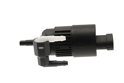

The windscreen washer pump of my daily Megane stopped working earlier this week. The fuse was OK, so further investigation was necessary. I drove it down to the unit this morning, expecting to spend "no more than half an hour" fixing it.
Being a Renault, the washer bottle is placed in the most inaccessible area the designers could think of, this being the offside front wheelarch.
So the front wheel and arch liner had to come off, the latter being held in place with a dozen of those cheap, fiddly trim clips that snap as soon as you touch them. Then, I had to take the washer bottle off the car - a job that would have been fairly painless, had the bottle not been completely full of screenwash...
Completely soaked, and mumbling various obscenities, I disconnected the wiring and checked it with my multimeter. The little screen showed 12.8v, so it was clear that the pump had given up the ghost.
An easy fix, then. All I had to do was find a place that was open on a Sunday, within walking distance of my unit, and keeping a 20 year old Renault washer pump in stock.
As you would expect, such a place does not exist.
I considered the option of putting everything back together, ordering a new pump off ebay, and repeating the whole process next weekend. Being far too cheap and lazy for that, I decided to take the pump apart.
This is how they look :
The body of the pump consists of two parts, which clip together. Using molegrips and plenty of swearing, the body came apart, revealing a tiny electric motor that looked as if it had been at the bottom of the sea for the past few decades. It was, unsurprisingly, completely seized. I gave it a bit of TLC and a lot of WD40, and was eventually able to unseize it by gently turning the little axle with my pliers. I then put the pump back together, reconnected the wiring, pulled the wiper stalk and was pleased to hear it whirring into life !
Reassembly was the reverse of removal (apart from the screenwash incident - the bottle was now empty !). The car has fully functioning washers once again, and my pump rebuild SKILLZ have saved me £6.50... Well worth* the hassle.
