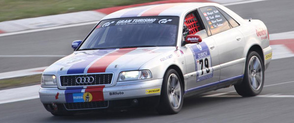

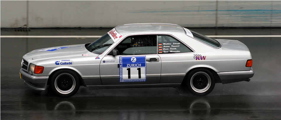

Previous entrants include this fine beast
And the legend that is this thing
