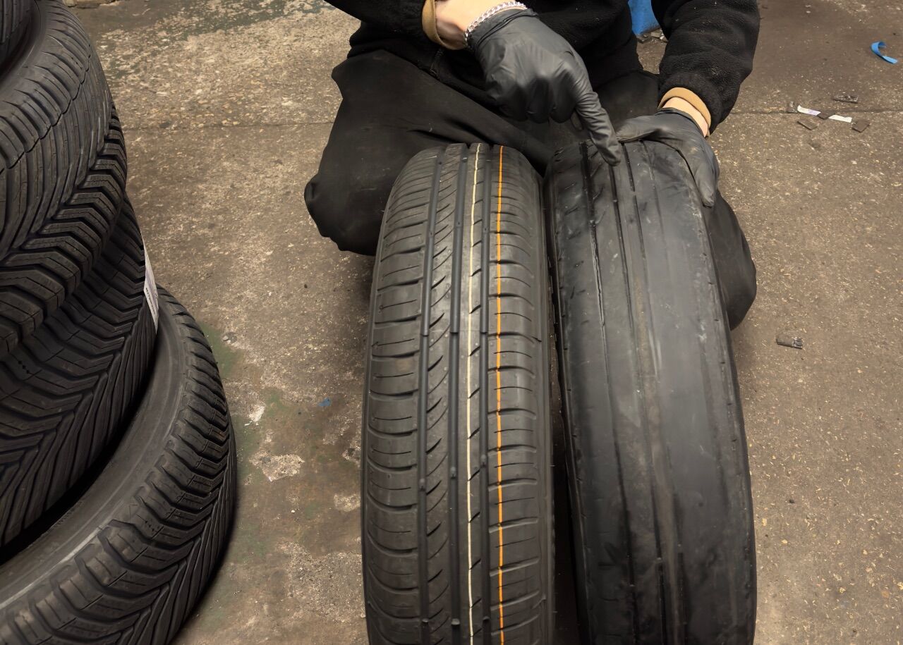

The Chevy has felt weird to drive but I never found out why...
Then in the space of a couple of months and not many miles, a legal tyre became this..
That wore fast...
And apparently, more on the opposite side?!
Pretty sure that's why it felt odd, but scarily, I'd somehow only seen the bit with tread when I looked before and it was booked in for four new tyres anyway because one was losing pressure and they're all shit brands.
This is. Was. A Landsail. I can only assume the canvas inside is failing as I can't see or feel anything up with the wheel or hub!

Crikey... Looks like some pretty epic scrubbing going on there?
It's a back wheel on a beam axle!
The car's felt like a wheel was loose for a while and I think this must be what happens when a tyre gets twisted on a rim, or it has a bent wheel, but the way it's all worn on the outside but half is more worn on the same edge is remarkable. And it was doing it in August, when I had both back wheels off to replace the dampers, and there was nothing obviously wrong or illegal then - maybe 700-1200 miles ago but I haven't been able to do much with cars since October due to pain - so GF's been driving it, mentioning it feels odd, I shine a torch at the wheel and shake it, try it, think it's bushes or something.
I have had a twisted tyre on a Capri but it felt more like an out of balance wheel. This must have been squirming in harmonics 😂

No problems with wheel balancing or other issues...
Other than abject shaming
Inside the old tyre had no signs of problems, the canvas had just delaminated and warped and the tyre probably reached that state in tens, not hundreds of miles.
2019 date coded Landsail.
It now has four Kumho Ecowings and feels much, much nicer obviously. Noisy buggers though.

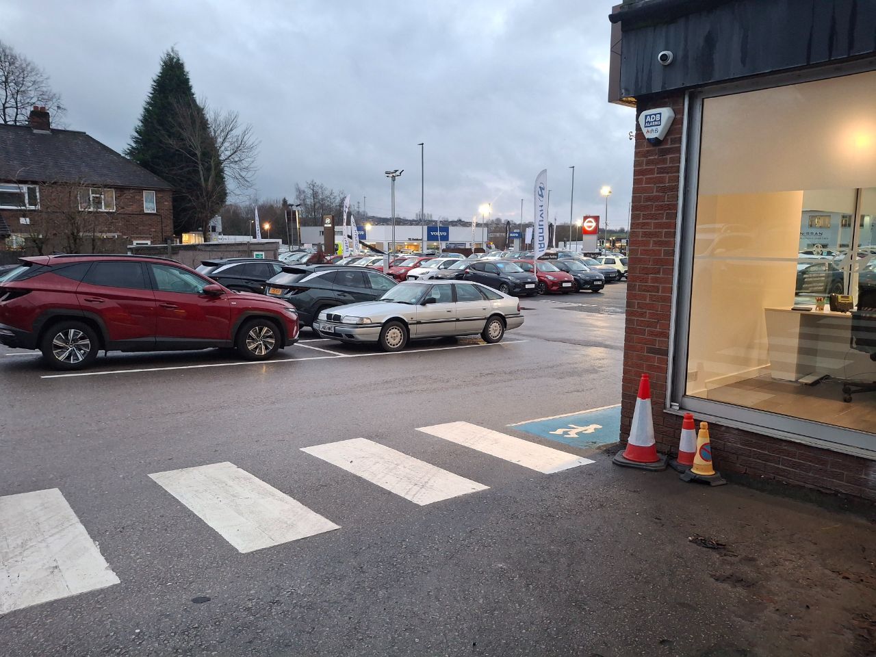

57 minutes ago, Marina door handles said:
My commute to work was more Rovery and less Landrovery today...........
Help out an old (ish) geezer here - just wtf is that huge thing in front of the Rover?
Hyundai Tucson, I should know really as I sell for parts for the things!
