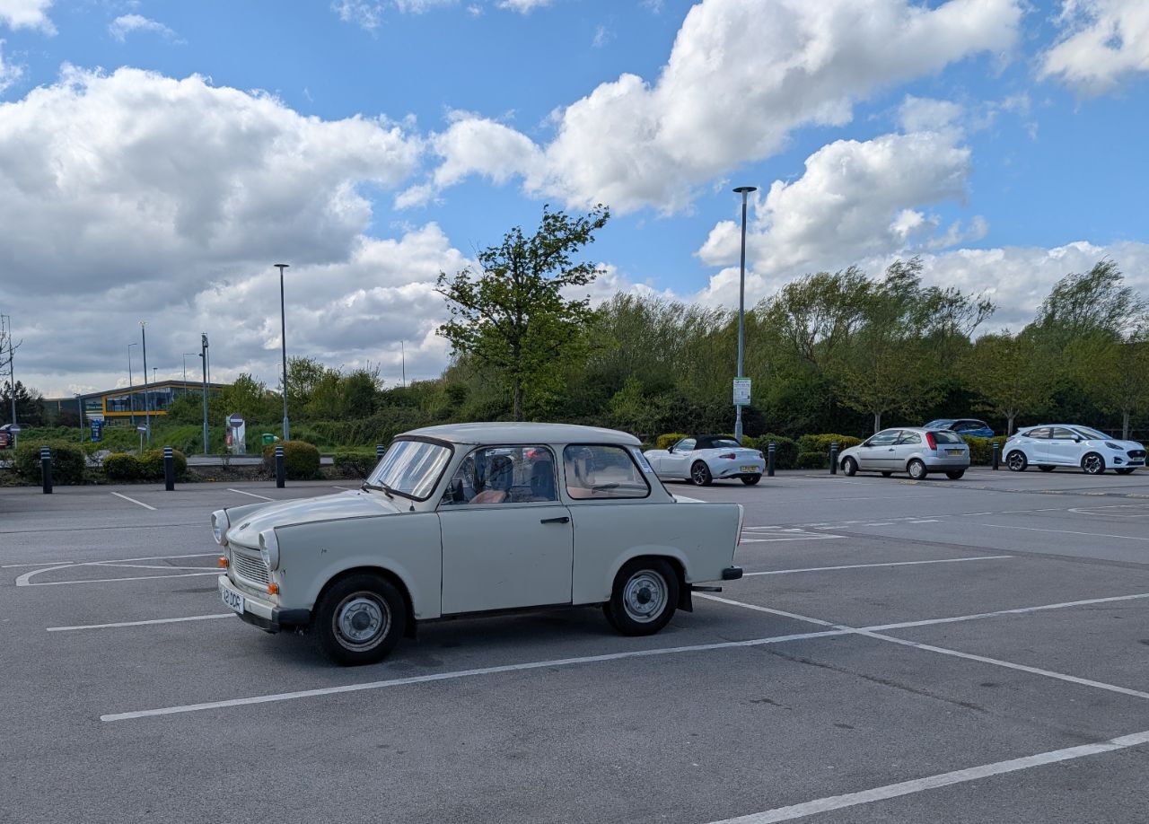

15 hours ago, stuboy said:
Trip too the pub....
Lots of illegal plates there!
