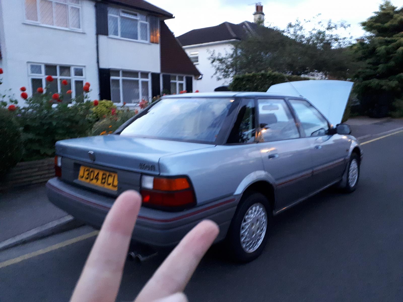

Rover was booked for its MoT tomorrow. Gave it a wash and check over this evening then this.
Stalled on a roundabout and the oil light came on. No one helped me obviously but I managed to push it to a safe place. There's oil in it so pump I assume.
Shame it's on a yellow, otherwise I'd get Mrs T to pick me up and deal with the bastard tomorrow or whenever. Haven't had me tea yet, I'm starving!

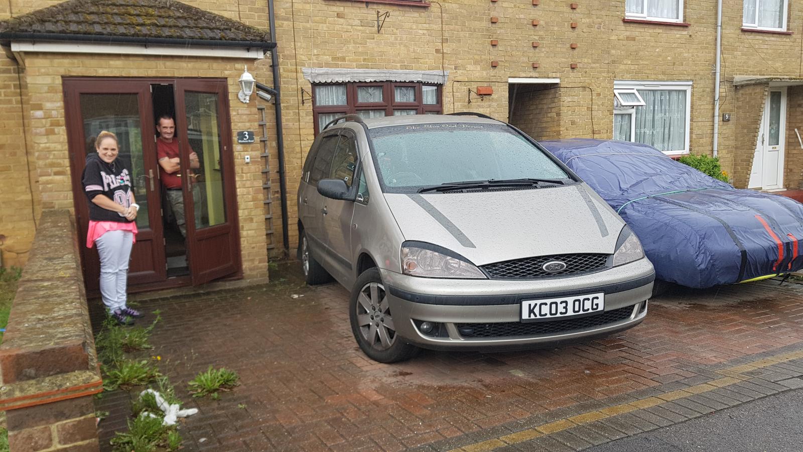

One for 'egg' popped to see friend with yellow mondeo... shame hes not well enough to do stuff to it and so the old gal been wrapped up sadly.. so brightened up his drive with my daddywagon..
Hang on, oil light came on then the engine cut out OR
Stalled/ engine cut out then oil light came on?
REELYABUL HONDA ENJIN M8. But as others have said, if you stalled it, then all the lights will come on. I wouldn't fear the worst yet.
Yes I was too quick to judge caught in the moment. It started up after 20 minutes and I managed to get home, but then it stalled on me again. I then noticed with the ignition switched on the warning light doesn't illuminate each time, so there must be something amiss with the electricity side of things instead.
I tested the battery and that's healthy, so wire fiddleidge is on the cards for tomorrow. I suppose a new voltage regular wouldn't hurt either, as the alternator is one thing I've never touched on this car.

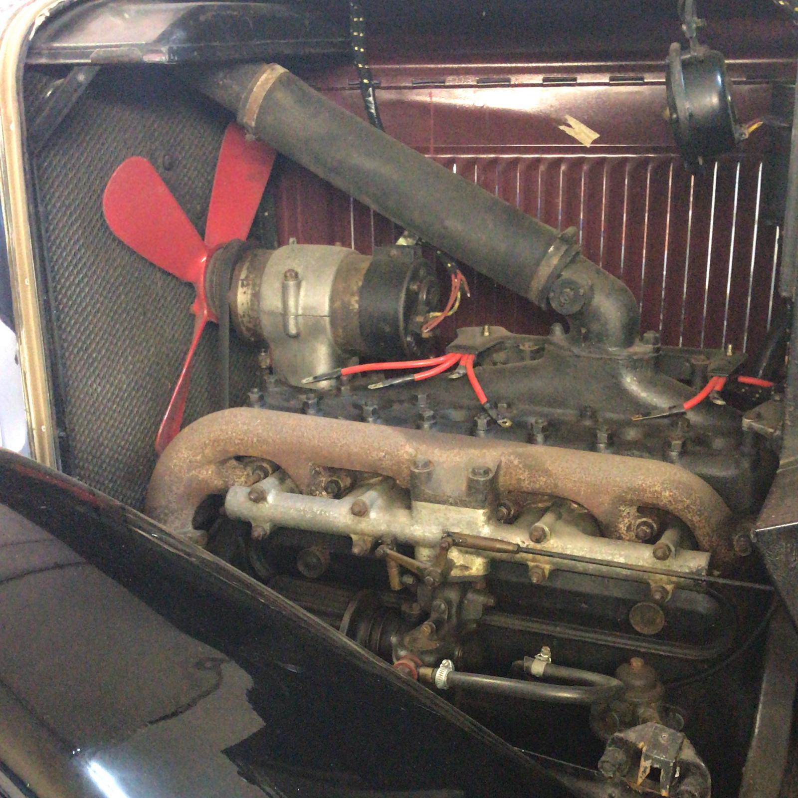

Austin 12/6 project has arrived. It’s a 6 cylinder from 1931, of 1461cc - unfortunately seized though. Project thread to come.
There's a main relay behind the centre console that may have some dry joints.
Unscrew the trim piece from the sides, get the gear lever out of the way, and unclip the trim and lift it away. The unit is a brown box on the passenger side.
The circuit board levers out of the box and then can be repaired with some soldering.
That's another option as I did repair* that relay a few years ago. Could well be causing problems again.
