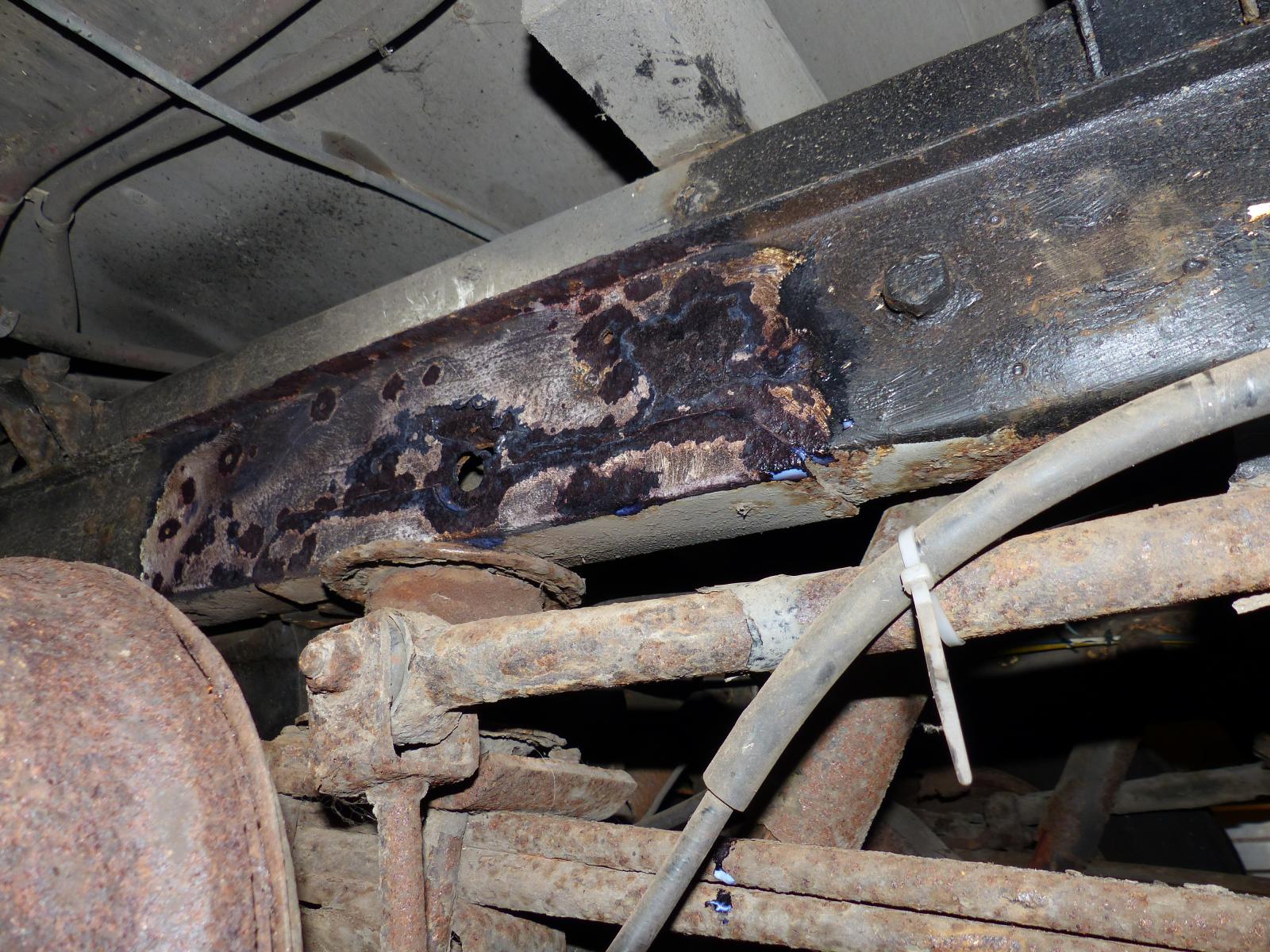

Apparently, the day before yesterday was Wirebrushing Friday.
Today was Kurusting Sunday
Today may turn out to be Grinding Monday and hopefully will also be followed by Tickling Tuesday
This is the o/s chassis rail on the camper, that I was told by my tame MOT man many months ago should get some attention, if I have any love for the vehicle. The pic doesn't show how badly the steel around the big round hole is delaminating. I may need to go out and buy some thicker sheet steel.
 WCPGW?

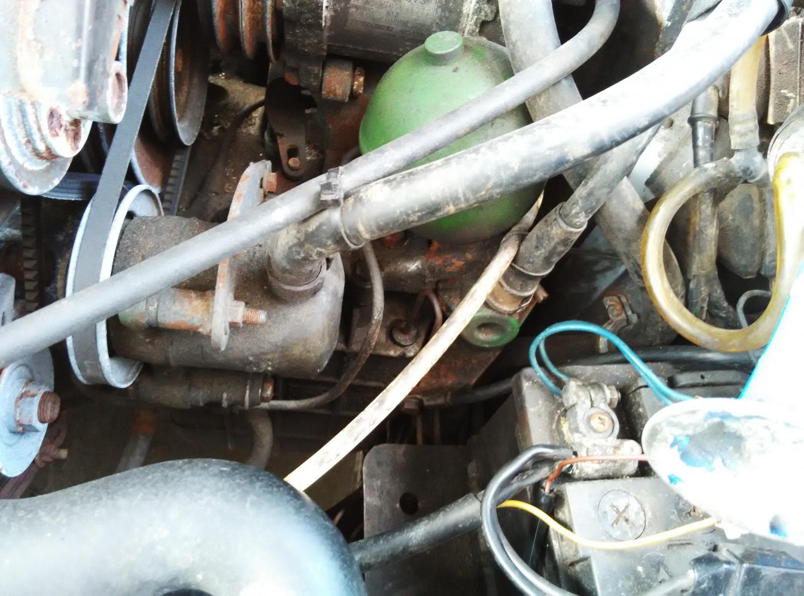

The HBOL sez the auto box looks like this:
That's not what it looks like from here:
That could be a dipstick, but who knows!?
Looks alright to me?
The HBOL showing the torque converter to the right, but your engine bay pic shows it to the left. Engine bay pic of dipstick below the green sphere matches up with the dipstick on the top left of the HBOL.

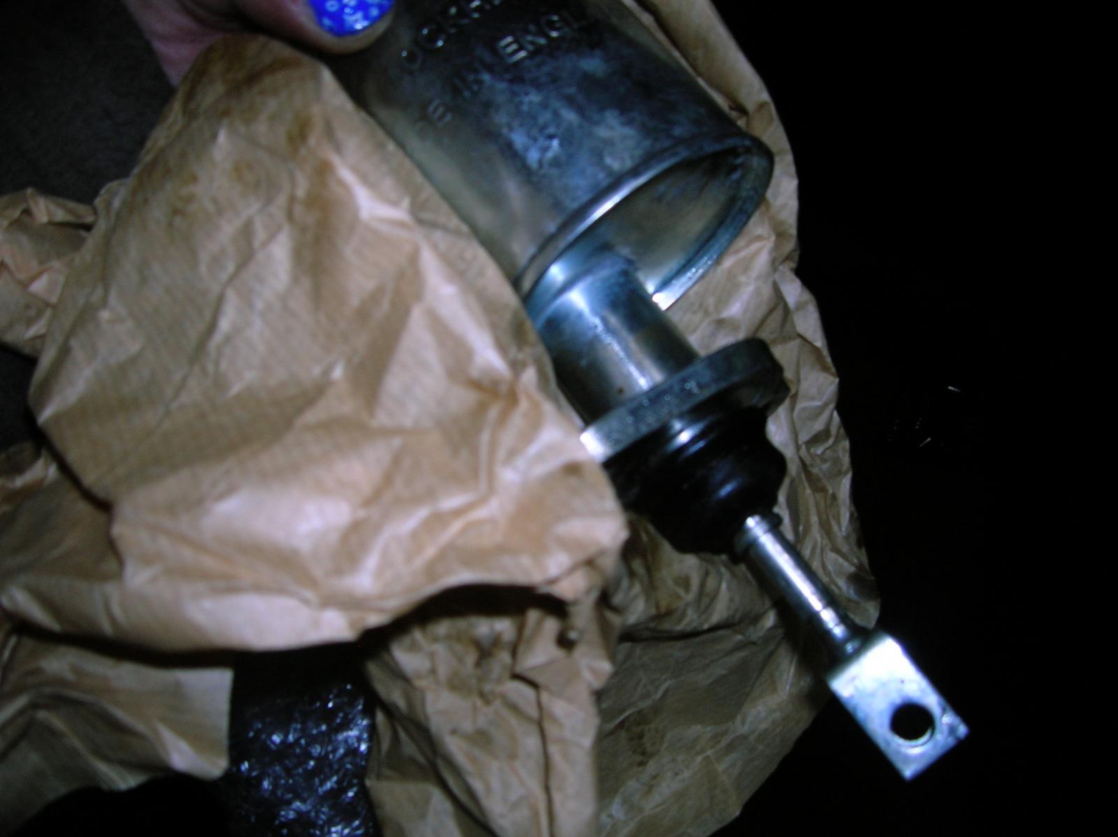

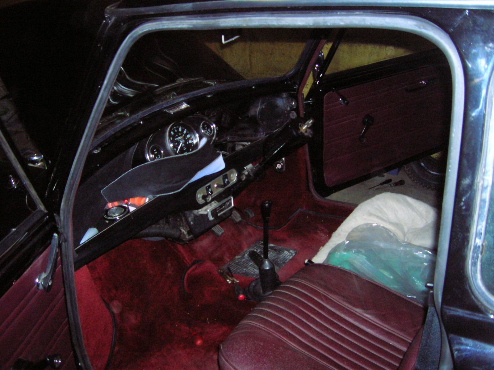

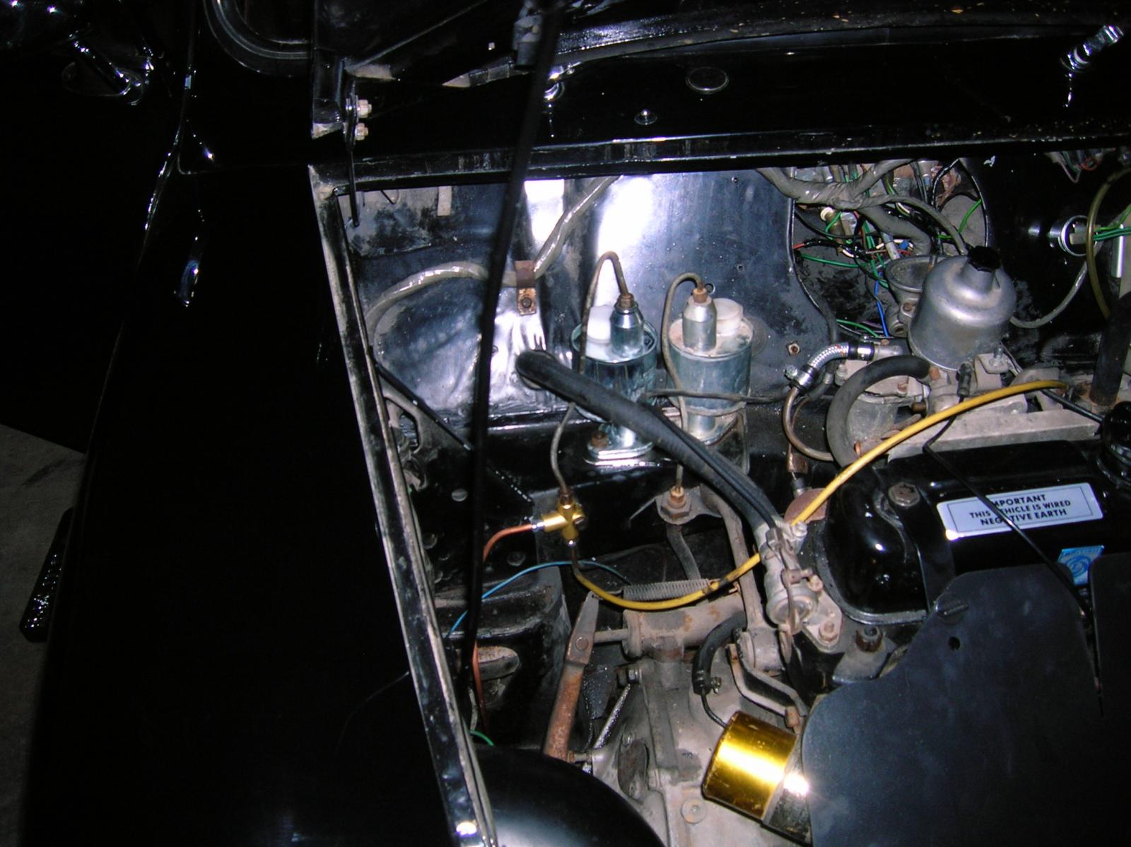

another day, the same friggin' mini been tinkered with.....
today we have mostly been going backwards
all this to get at the split pin and clevis pin in the brake pedal so that the master cylinder can be changed. a fiddly crappy job on any car, but no fun at all on a minature one. (this actually took us a couple of hours to get this far)

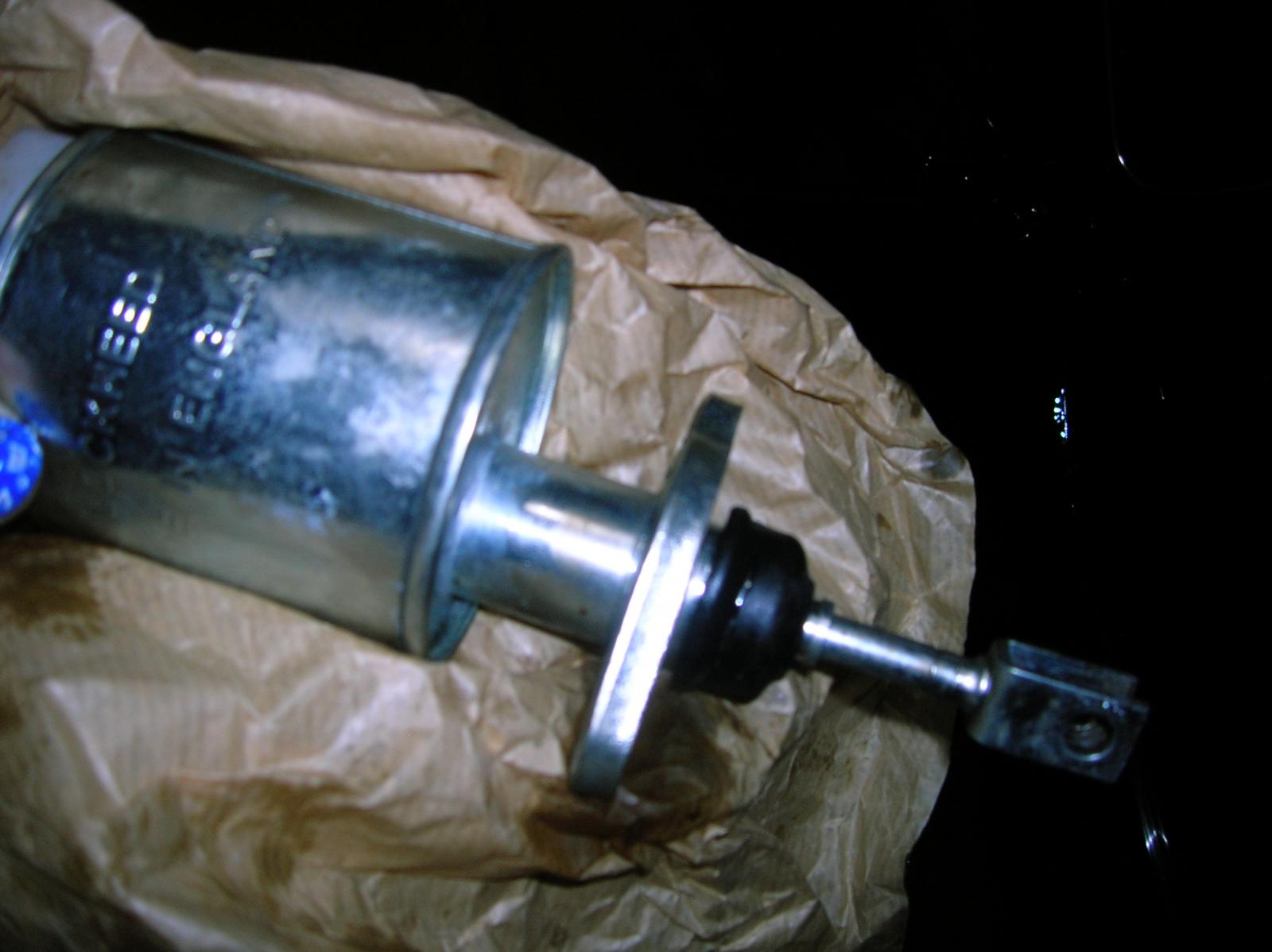

new one on, i'm hoping that i've put it on the right way round as it was a tight fit into the hole down to the pedal. now the old one was tight there too, but looking at the bottom of the old cylinder, the seal has a split in it and it was wet. so i think we may have gotten to the bottom, sort of, the brake problems. (this bit was dead easy)
hmmmm, we wil see......
