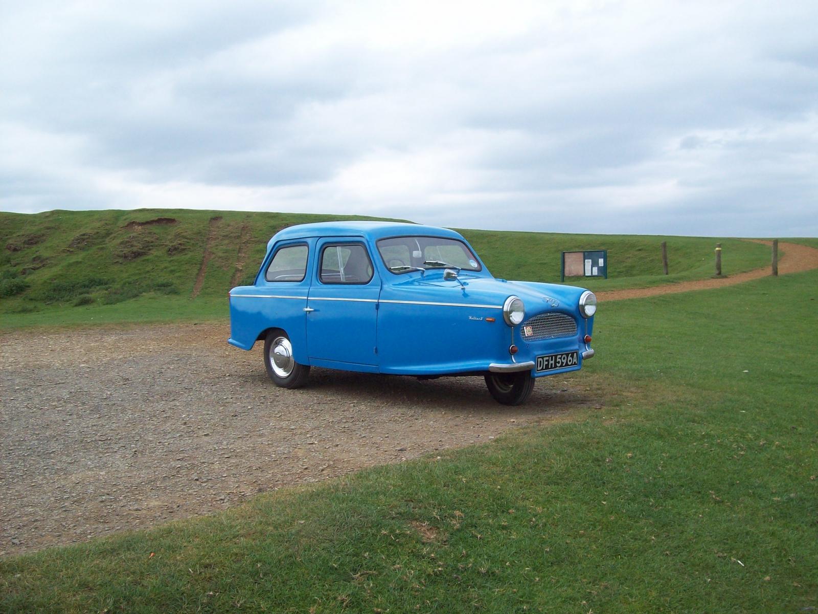

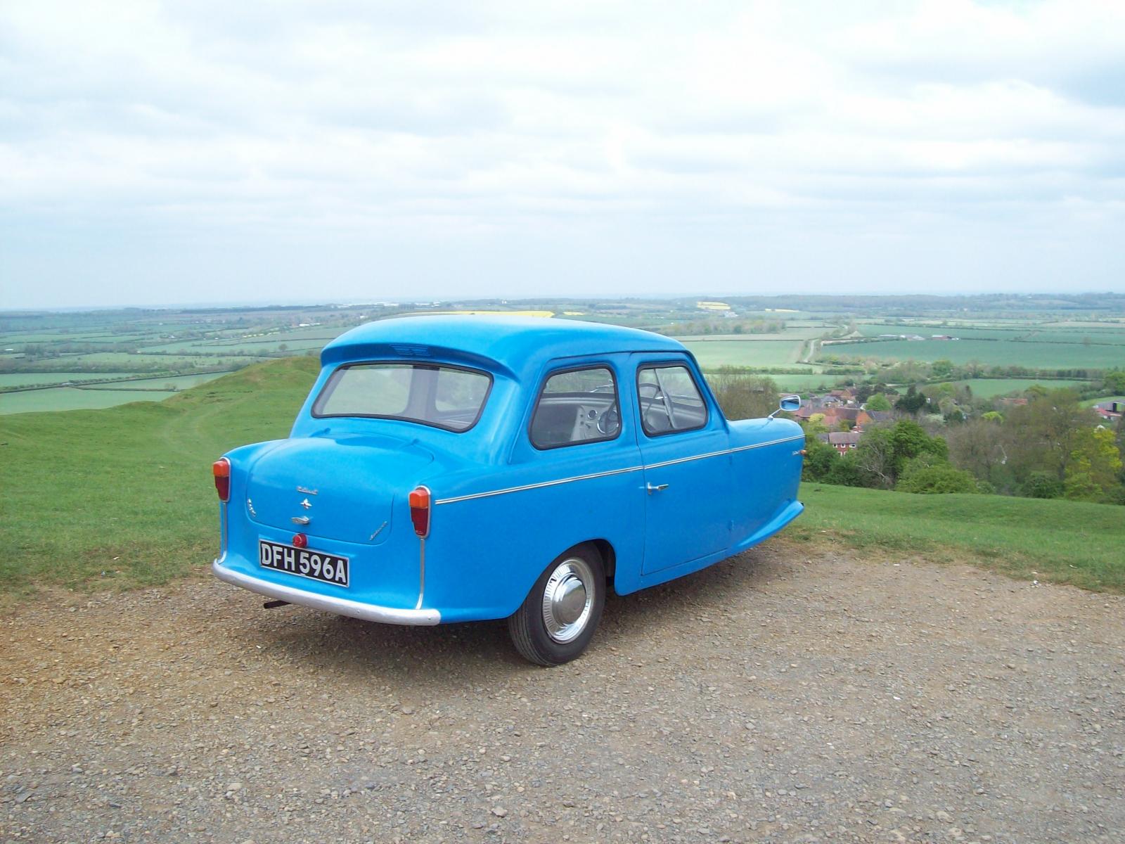

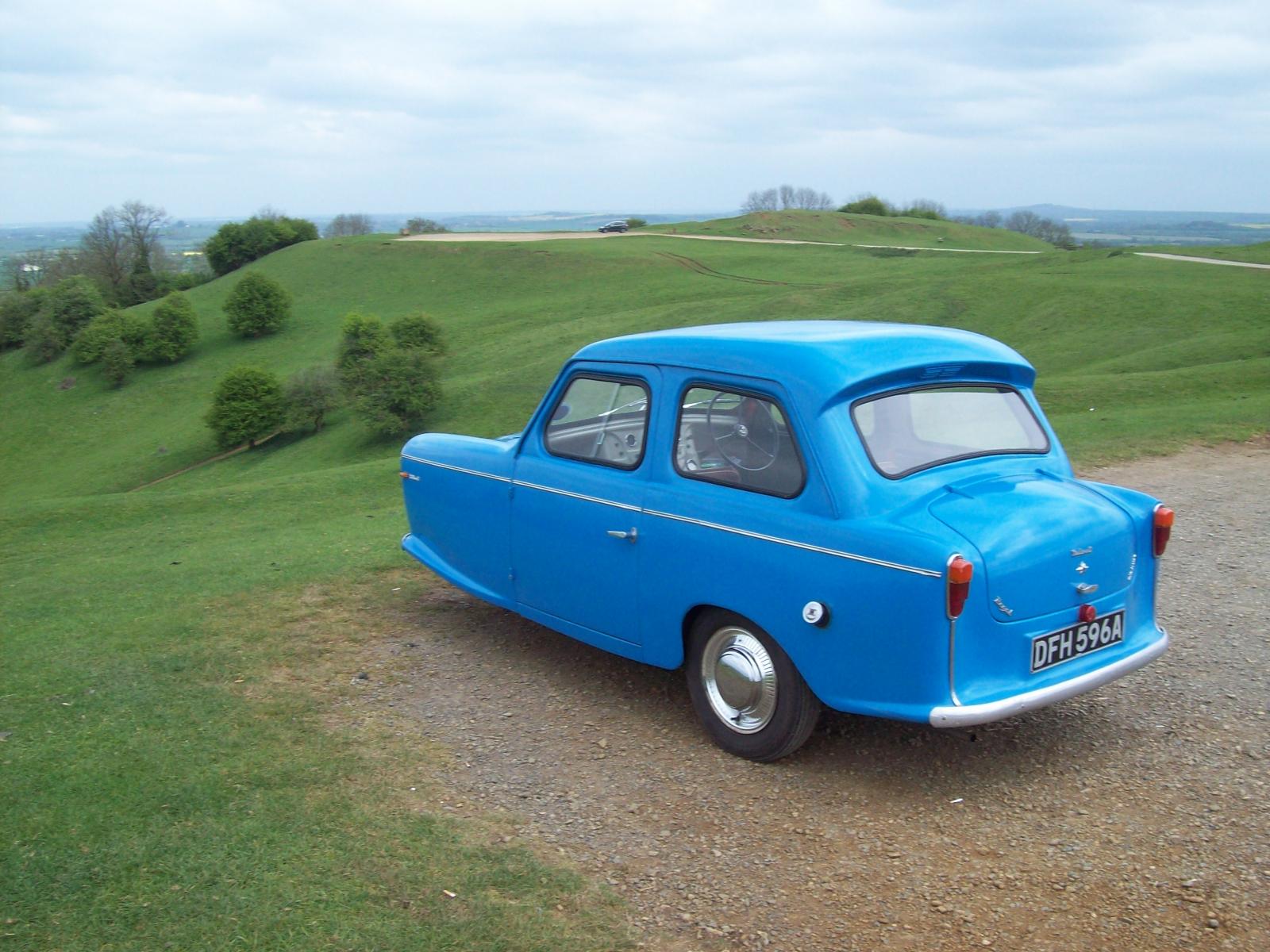

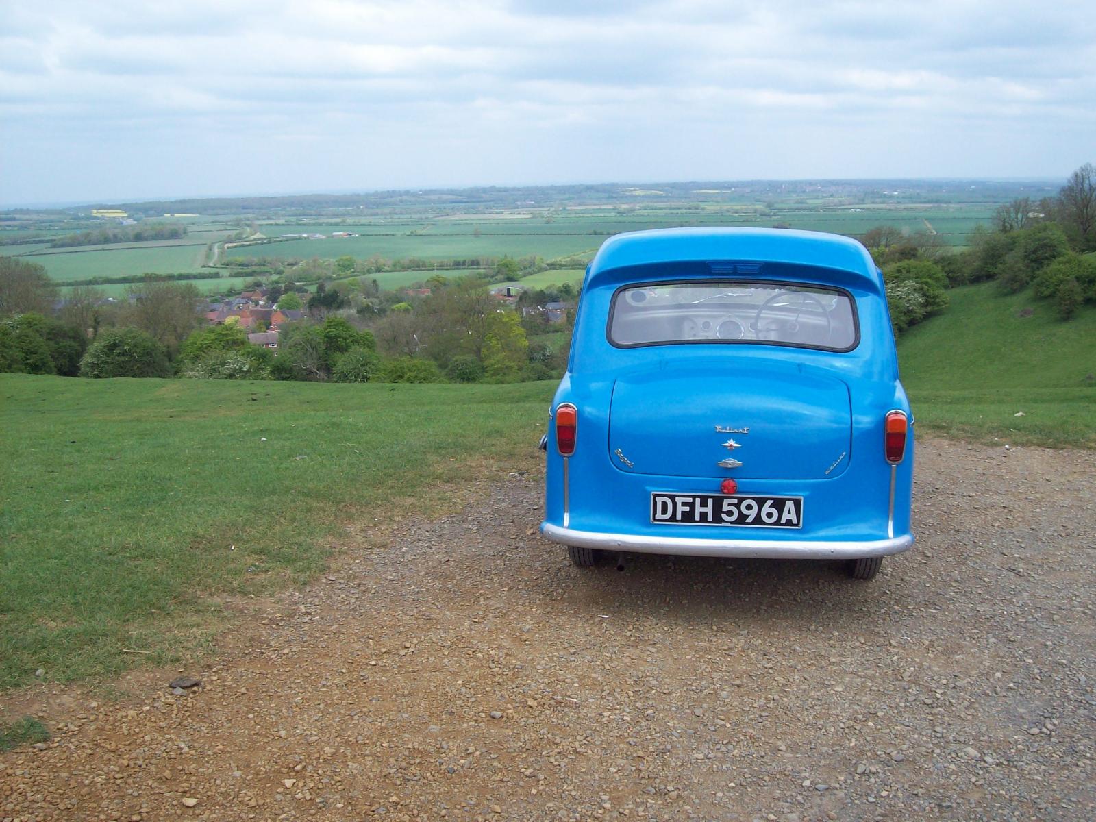

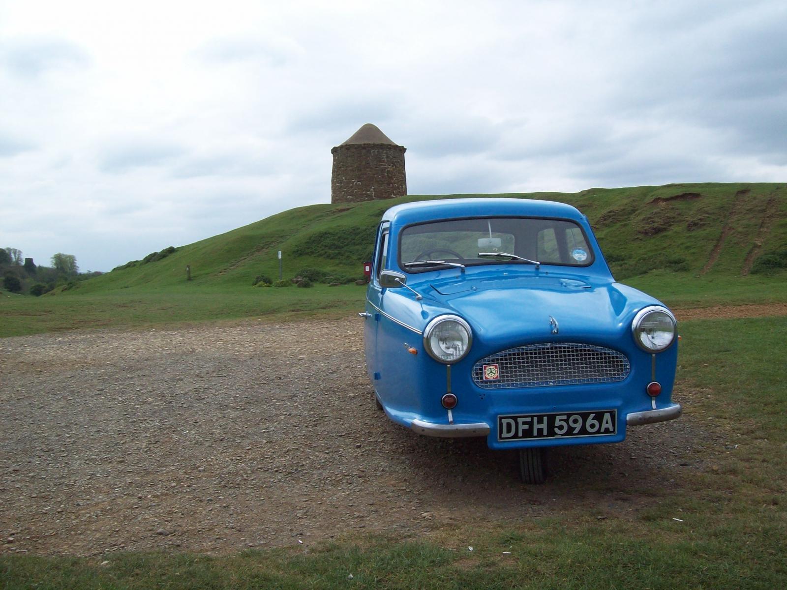

My Reliant Regal MKVI passed its MOT this morning with no advisories. To celebrate, I drove it to Burton Dassett country park (piccies below), with a full tool kit and aerosol carb cleaner in the boot.  The car has not been on the road since last August when the previous MOT expired and I was half expecting problems from mucky petrol/tank crud after its long rest.  The drive there was ok and I parked to admire the view and have a sandwich.  When I restarted to drive home about 30 minutes later, the car would only idle.  The engine died at the slightest bit of throttle. Choke made no difference.  With the engine exposed by removal of the internal cowl (two toggle clamps), the Solex carb jets are easily accessed.  I removed each one in turn to blast with aerosol carb cleaner, also blasting the vacant orifice whilst the jet was out.  With everything re-installed and cowl replaced, the engine started readily and responded normally to the throttle.  The run home was uneventful.  Having got used to the terror of handling 17bhp (on a good day) and a fierce clutch while balanced on three elderly cross ply tyres, I sort of enjoyed it.
Sounds terrifying but it's a lovely little thing
