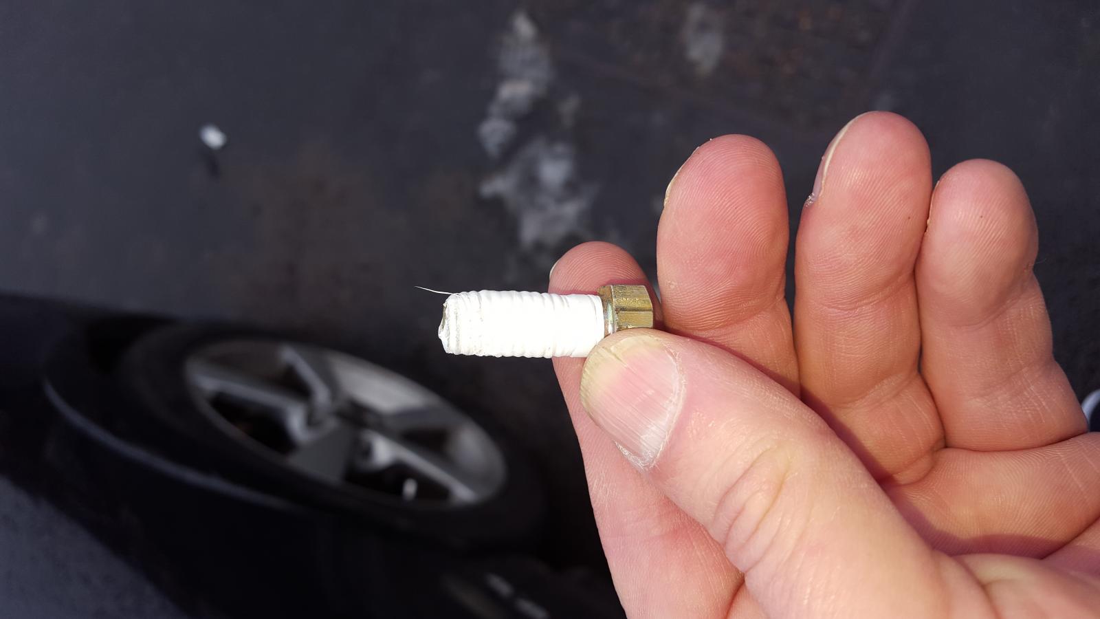

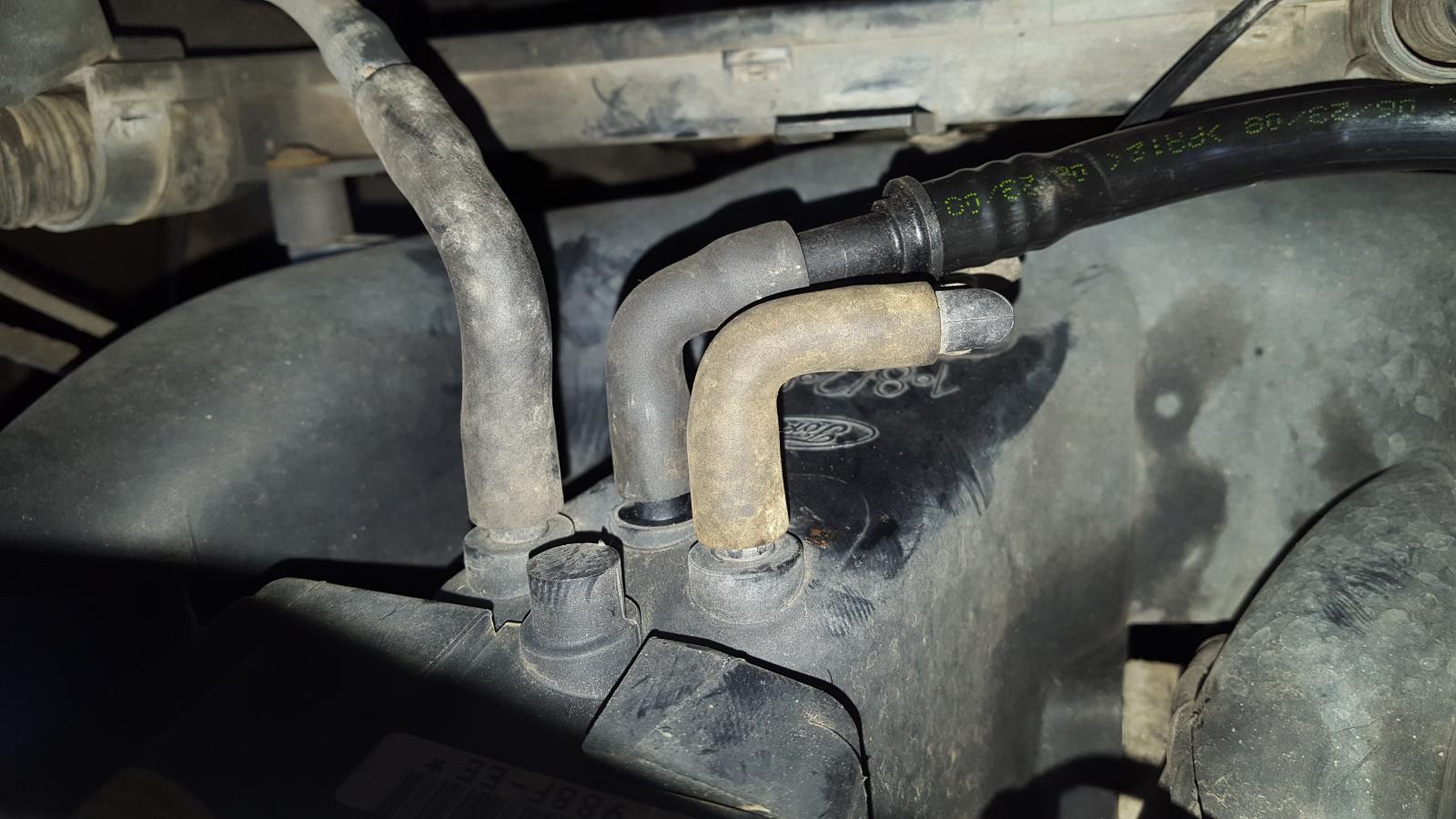

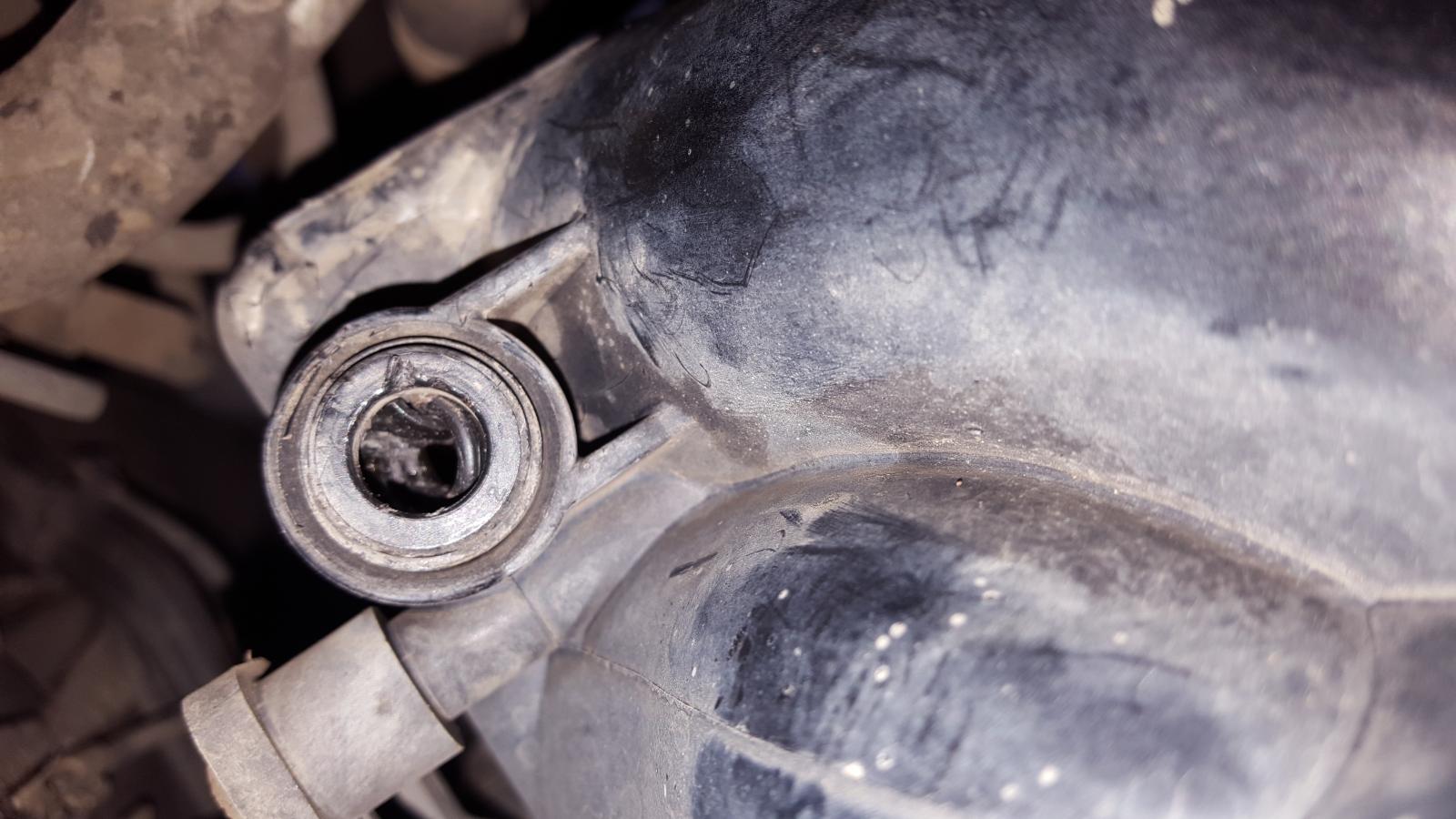

Lost brake servo assitance.. thought i know ill check the one way valve and that fell apart..snapped out of the plastic inlet too.. i wouldnt mind but i wasnt heavy handed, so ordered new part.. £43 for bit of plastic, the end would for inlet wouldnt stay in due to old pipe breaking the securing clip, so after advice i managed to steal a vacum of the inlet crankshaft breather and found a bolt with some ptfe tape on it to seal it up..
Oh and brakes still not servo assisted...grr

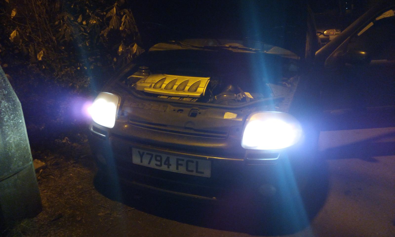

WTF? Changed the headlamp bulbs in the Clio with no cuts/bruises or damage to the car...
They are the "odd" HB3 set up- dimple to get the connector off, and a spin in to seat properly. A joy to use- and so they should be at £15 a bulb with a hellfrauds trade card!
Took the chance to put in better performing ones, and have also procured a headlight refurb kit to remove the cateracts at the weekend (goddam plastic headlights!)
A mid job action shot..performance was improved after I made her clean her lights too:) post-17572-0-99061000-1487102804_thumb.jpg
This morning before work ive taken boots the pharmacy and went outside pulled off drivers whip out slide pins of the caliper cleaned up and regreased then ensure they are free with a hammer, then i did the other side and went to put the wheel on but there was movement firstly i guessed just me not holding wheel up enough, so carried on and still loose...hmmm so i thought id whip of the wheel and look and found free play in driveshaft nut (strange as i stood on the bar when i did it at fiance's dads house when did the wheel bearing) any way i got almost 2 turns on it until unable to tighten more, so i thought hang on i have a spare nut in tool box, the one on the car was a new multi plate one and one spare is a  one piece so i double it up, driven to traceys and brakes seem to work much better now.. strange how nut was looses and i googled it just now and found this ...

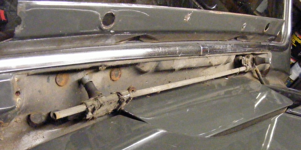

All this winter the P4's wipers have been less than effective, both of them flapping about like a cock in a shirt-sleeve. Today I bit the bullet and heres what it looks like under the cover 60 years after it was screwed down.
Rover had a bit of a rubber fetish back then and mounted just about everything they could this way- Maurice Wilkes and his Mrs probably did too. Body to chassis, wiper boxes, wiper motor, heater motor, fuel pump all have rubbers, but the wiper boxes eventually break free; on my previous P4 I just fixed them solidly as I'm too uncouth to appreciate such refinement.
Heres the wiper box with its very own bobbin which will swapped for a bit of 1/4"bsf threaded rod when I've grubbed about in the scrap pile and found the leftover from last time.

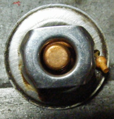

Another pain in the arse has been thermostats. The car brewed up in a queue on that hill near Corley services in December because the shitty one I'd just fitted lost its wax. A replacement 82 degree jobbie opened at 65 -I checked it in the kettle, handily demonstrating the wisdom of keeping me well away from anything remotely domestic.
  The replacement 'Intermotor' thermostat came in a big box, but inside was the same plain carton that cheap ones are supplied in. Same 'out of true' thermostat, and on fitting it the temp. went up to 90 on the gauge and water blew out of the rad.
I rang Mr Intermotor but he wasn't really interested if what I had bought from Dr Car Parts on ebay was a counterfeit one or not. I'll just have to sneak the kettle out and check before fitting in future.
