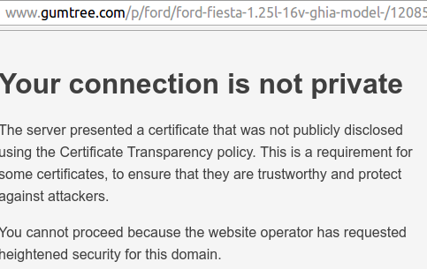

Had an email from gumtree thanking me for posting an ad.
I logged into my gumtree account and sure enough, I'm selling a vw Tiguan in London.
Contact was John(me) on a mobile number (not mine).
The only way to contact gumtree is via live chat.
After waiting in a queue, I chat to Mike, who likes music and art and a few cold ones with free thinking friends.
Don't worry, he didnt tell me this personally, he has a blurb. It failed to mention his poor spelling and grammar.
Anyway, Mike claims I've been duped by a fake email and given my gumtree login to a con artist. Said con artist won't have a Tiguan and will be hoping to rob someone of a deposit.
I definitely haven't given my gumtree login to anyone. I suggested to Mike that maybe their security could have been compromised.
The ad has been deleted and I have a new password.
Do you use the same password across different websites? If so, another website you use could have been comprimised, sold details on and your email+password combo used on other sites to see if they work.
Can check your email address here: https://haveibeenpwned.com/
Do you use the same password across different websites? If so, another website you use could have been comprimised, sold details on and your email+password combo used on other sites to see if they work.Can check your email address here: https://haveibeenpwned.com/
According to that, I've been pwned? on two sites.

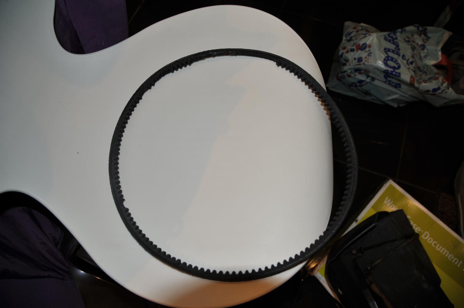

Drove to Ma's, was parking and it shredded the fan belt :)
