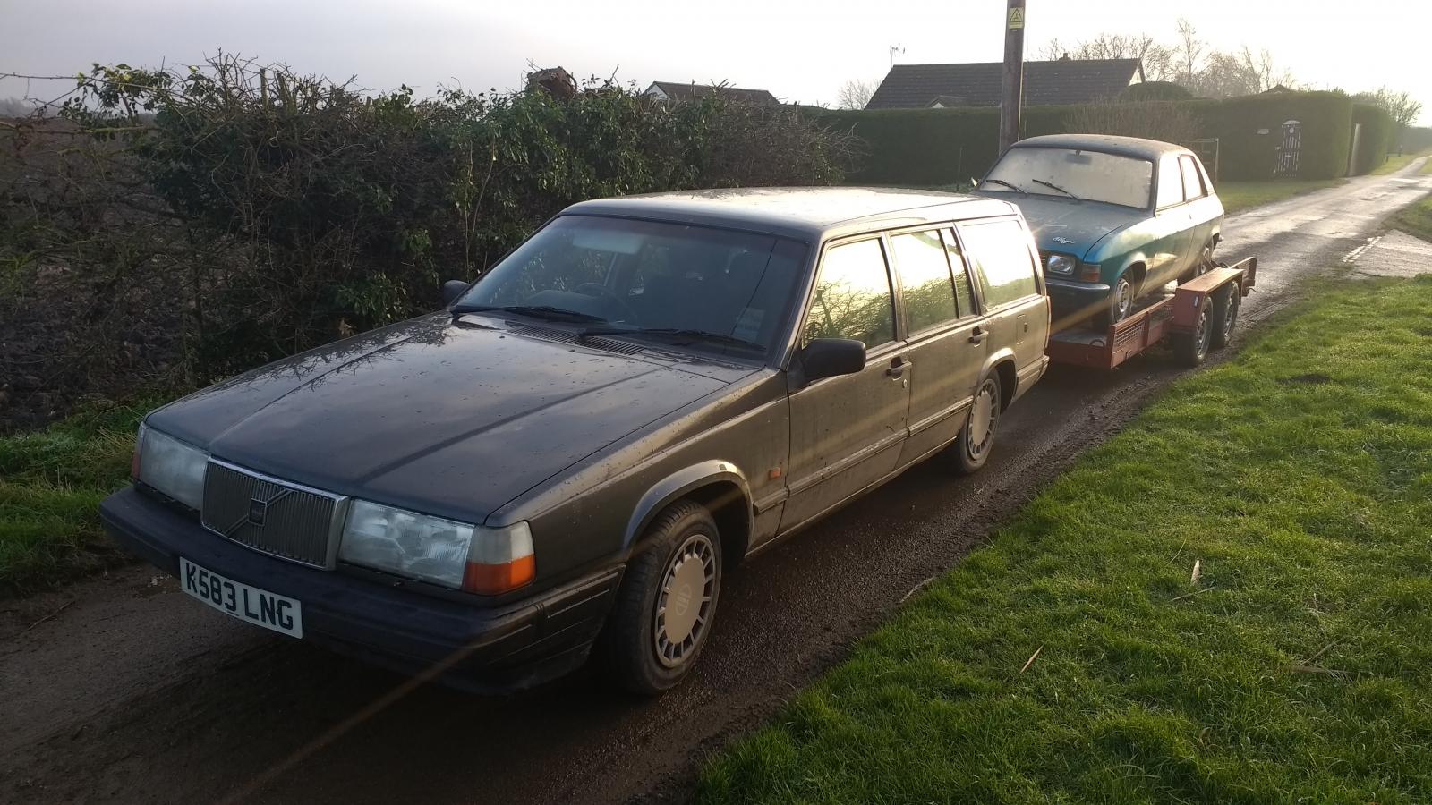

Did some car shuffling earlier today with one of the Allegros going to beige1100s house for work to get back on the road in the spring. LDV decided to lock its rear brakes on the slightest application so the Volvo did towing duty.

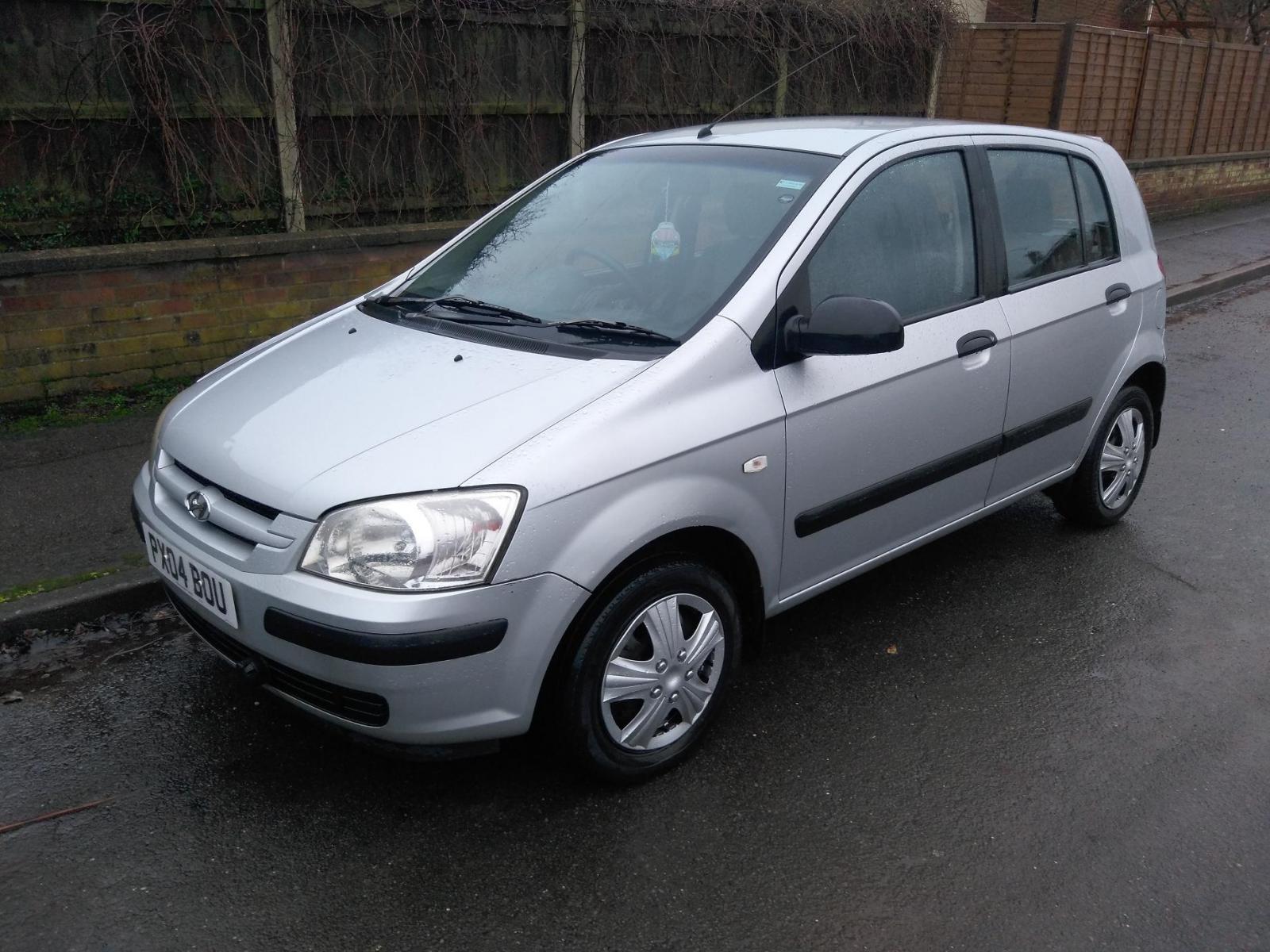

I've been wondering what the Getz diesel is like for some time, so thanks for the info!
Note that this info is only valid for the 3-pot Getz.  The later version with the 4-pot Kia Rio engine is a very different animal - faster, more economical and much, much more refined.  Baz formerly of this parish has / had one and I remember being seriously impressed with how it went.  Doesn't have the same curiosity value as the 3-cylinder cars though admittedly.

Taxed the Getz today - £115 a year, not cheap but not too bad for such an ancient engine.  I chucked a bucket of soapy water over it yesterday and fitted a set of crappy trimz I had laying in the back of the red Rover - it looks a bit more respectable now.
The exhaust blow turned out to be two sections that had basically slid apart - looked like the exhaust clamp hadn't been fitted properly.  I jacked the system up, slid the two sections back together properly and refitted the clamp and it's a lot quieter now.  Still a very slight blow - I probably should have used exhaust assembly paste or something - but it's not noticeable from inside the car now.
