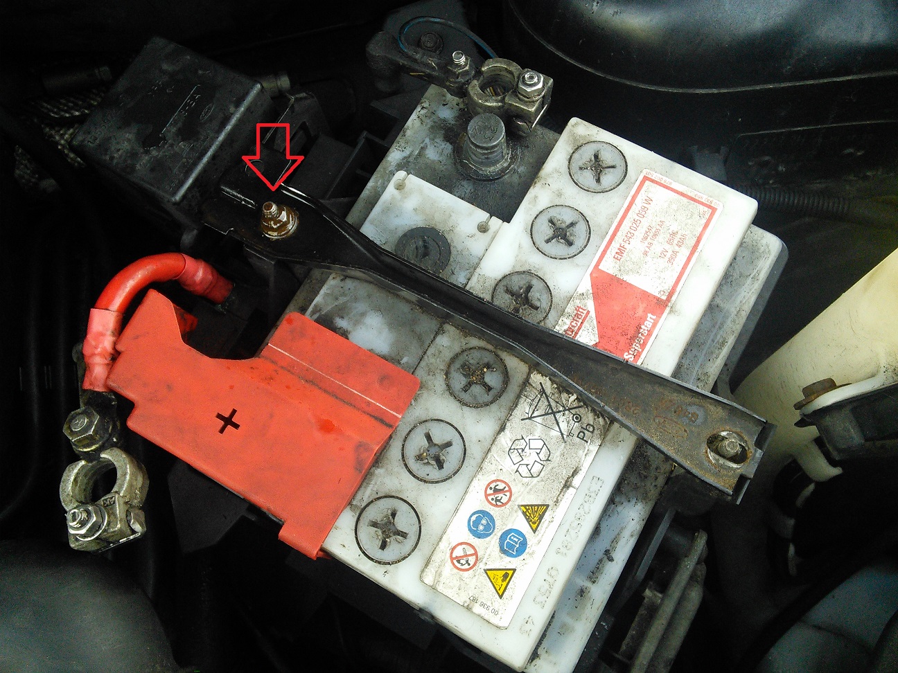

Any clever ideas in undoing this nut? Screw just rotates with it in whatever stupid plastic mounting it's in. As you can see a Motorcraft battery on a 14 year old Fusion suggests it hasn't been undone in a while. Current next plan is to hacksaw the nut off in bits! Can't swing the clamp out of the way either.
Ring spanner on the nut then mole grips on the thread? You'll need to be careful not to ruin the thread though. Maybe clamp it using a rag over the jaws, then hope once the nuts cracked off it just spins freely?
Or just hammer a bigger battery over the top
Or cut a slot in the top of the bolt and hold it with a flatblade screwdriver then spanner the nut off? The nut should clean swarf off the top of the bolt as it meets it
Good ideas. I don't have mole grips, usually borrow my dad's ones. Tried with some pliers and have damaged the thread a bit. This car has fought me for the last two years on every job!
Going to leave it to soak overnight and the Mondeo will continue to provide work transport for now.
Cut the bracket off and cabletie the battery to the tray? The Meriva has this because the thread on the clamp bolt is fucked and even the massively picky MOT place I use didnt flag it up!
TBH, the bracket/clamp seems like a bit of an overkill anyway, the battery sits in a solid plastic box and is very unlikely to move much! Ministry of crap design as Ben Elton used to say.
It'll still fail the MOT as insecure if you don't have an alternative way of holding it down - "unlikely to move much" isn't really acceptable.

can you not prise the clamp up from the end youve undone and once its clear of the threads rotate it out of the way?

I think there is usually another clamp on the tray holding the battery down. Those stupid over the top ones are more trouble than they are worth. Seeing how the stud is already spinning in the plastic housing I'd just prise it out and throw it away along with the rest of it.

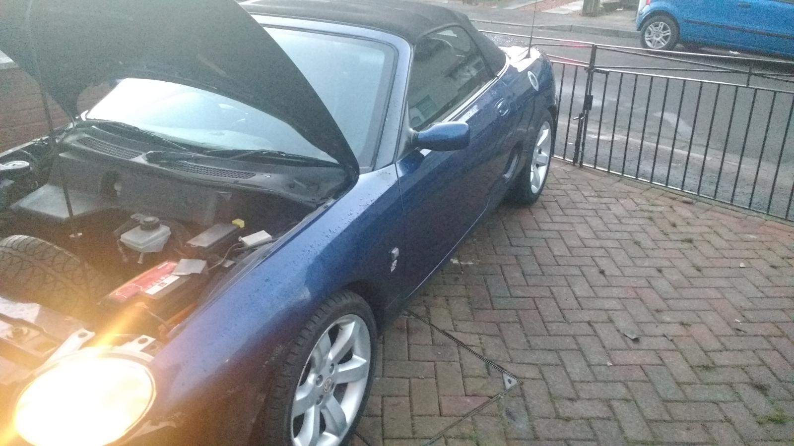

Starts off the button in -5, it's getting there!post-62-0-06413600-1481043710_thumb.jpg
Unfortunately the over the top clamp also has some electrical gubbins attached on mounting at one end (relays maybe?) so serves more than one function. Bit annoying as this mounting prevents any rotatation left or right.
cable tie it back together after you break it.
