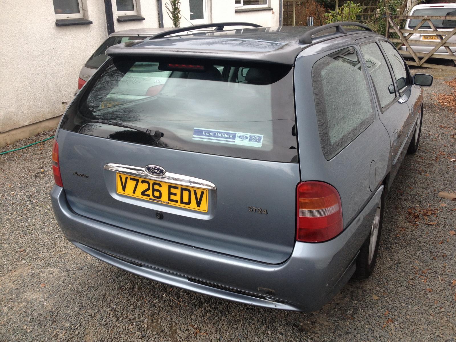

Had the newly acquired mondeo out for daily duties in preference to the usual berlingo. The starter sounds on its last legs, and there's a whining noise when the clutch is pressed, not too loud, but noticeable. The clutch bites and operates with no other issues. Any intel on if its likely to go bang, or carry on like that for ages?post-4673-0-06545800-1480799082_thumb.jpg
Saw the local Favorit estate out and about today parked next to it in mine, but no camera on me. As only 265 are licenced, missed opportunity!
Starter will be full of debris from a disintegrating DMF taking it out and cleaning it should make the starter last longer
DMF shredding itself into the starter is an issue on mk3 diesel Mondeo admittedly, but not mk2 pezzle ones surely?
Sorry me bad, retro fit DMF by previous owner maybe as they are such an improvement*
Is the starter actually disengaging straight away once the engine is started
Whining noise could be the clutch release bearing.
Btw, when did we stop calling these thrust bearings?
Yeah, that whine (might sound a bit like a supercharger?) is probably a clutch release bearing. I wouldn't imagine it's a high priority - after all our A4's been doing it for the 5/6000 miles we've owned it over 18 months.
Yes, clutch release bearing. It will be fine right up until the point when its not, when it will jam up and chew its way through the fingers on the clutch plate, leaving you with no clutch at all. Could be tomorrow, could be 4 years from now. If its not too loud, I personally wouldnt worry about it.
New clutch kit will sort it.
Had that clutch noise on a Midget years ago, it was still doing it five years later when the clutch wore out.

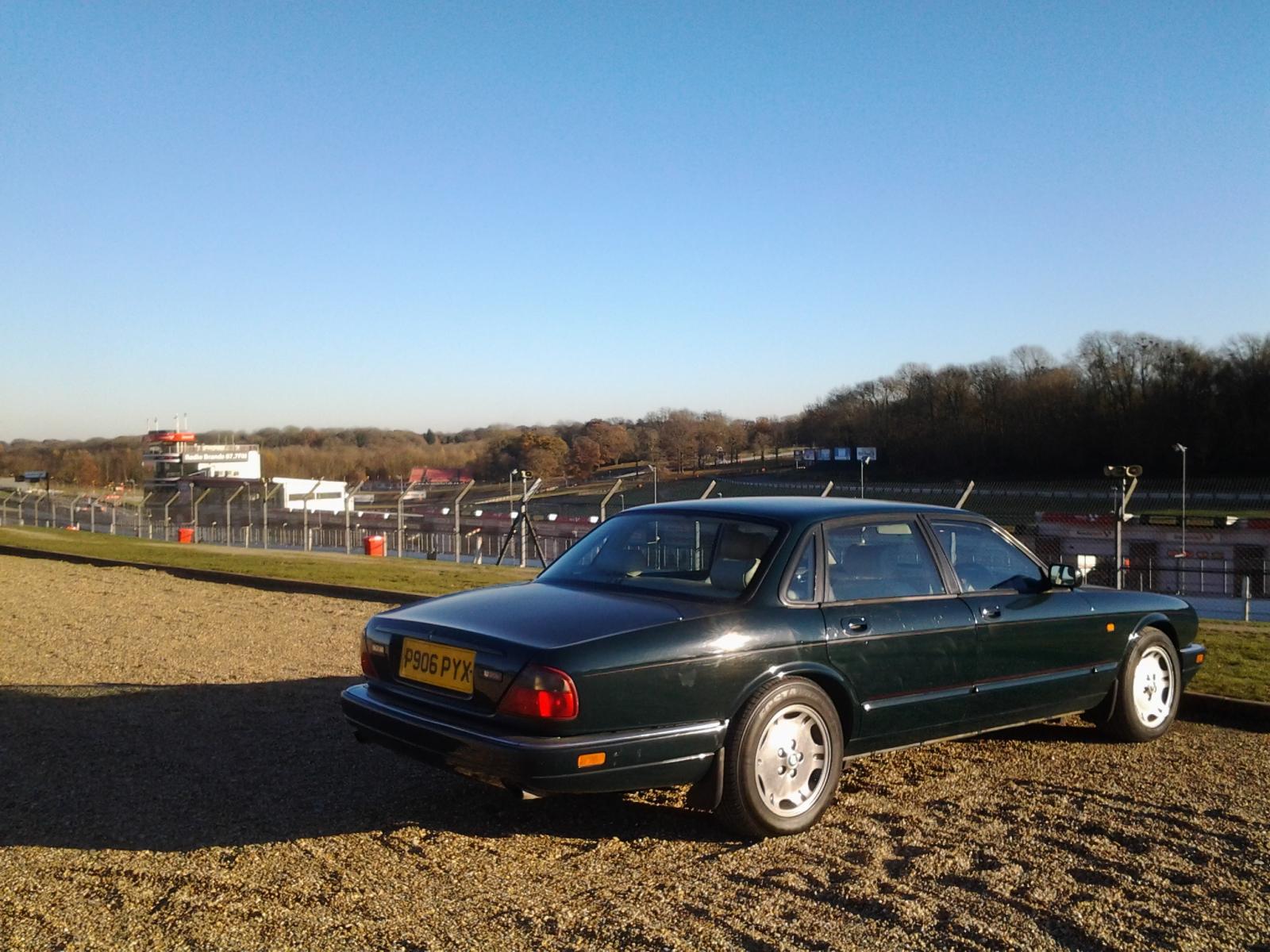

Took the Jag for an 80 mile run today, just for the sake of it. Here it is at one of my regular haunts, Clacket Lane services on the M25.
The battery warning light flickers every so often just to keep me on my toes, but I've ordered a new alternator and am carrying a spare battery in the boot just in case. Managed to get the trip computer to read 21mpg, which is economy mode compared to the 15 I've been getting doing local pottering.
This is the first time I've used it properly since collection day in October, as it had a few jobs to sort, and I must say it's bloody lovely. Not mega quick but is plenty enough for waftage purposes, and despite being called a Sport there's no actual sports option on the gearbox. No cruise control or heated seats either (and aircon shows as an option on the original invoice), so I'm wondering if this was the poverty model in the range!
Mrs T really likes it and is suprised I've actually bought something 'nice' for a change, so it may be sticking around for a while.
There's myriad other jobs to sort, such as a few more bushes and possibly a new pair of tyres. Some tool has put two new ones on the back but they are a different size to the fronts, 225/60 versus 225/55, the latter being the correct size for this car apparently. I'm tempted to get two more 225/60s just so I've got new tyres all round. I'll look into it as I don't want to cock up my speedo readings obviously, but does it really matter that much?
Anyway, another gratuitous pic, this time at Brands Hatch. Paintwork is a bit rubbish being full of swirl marks and so on, so a clay bar and polish session is on the cards (that can be a job for Boxing Day or something when I'm bored stiff of all the Christmas shite!).
If it's the same as the XJ40 then either tyre size is correct but sports tended to get 55s for slightly better handling. From memory the sport was low in the range, but is also slightly lower & stiffer than the rest so earns it's name.
That looks a goodun Rob:)
The 'sport' moniker is to do with the fact that its dechromed..
That and the sport of actually trying to get anywhere;)
