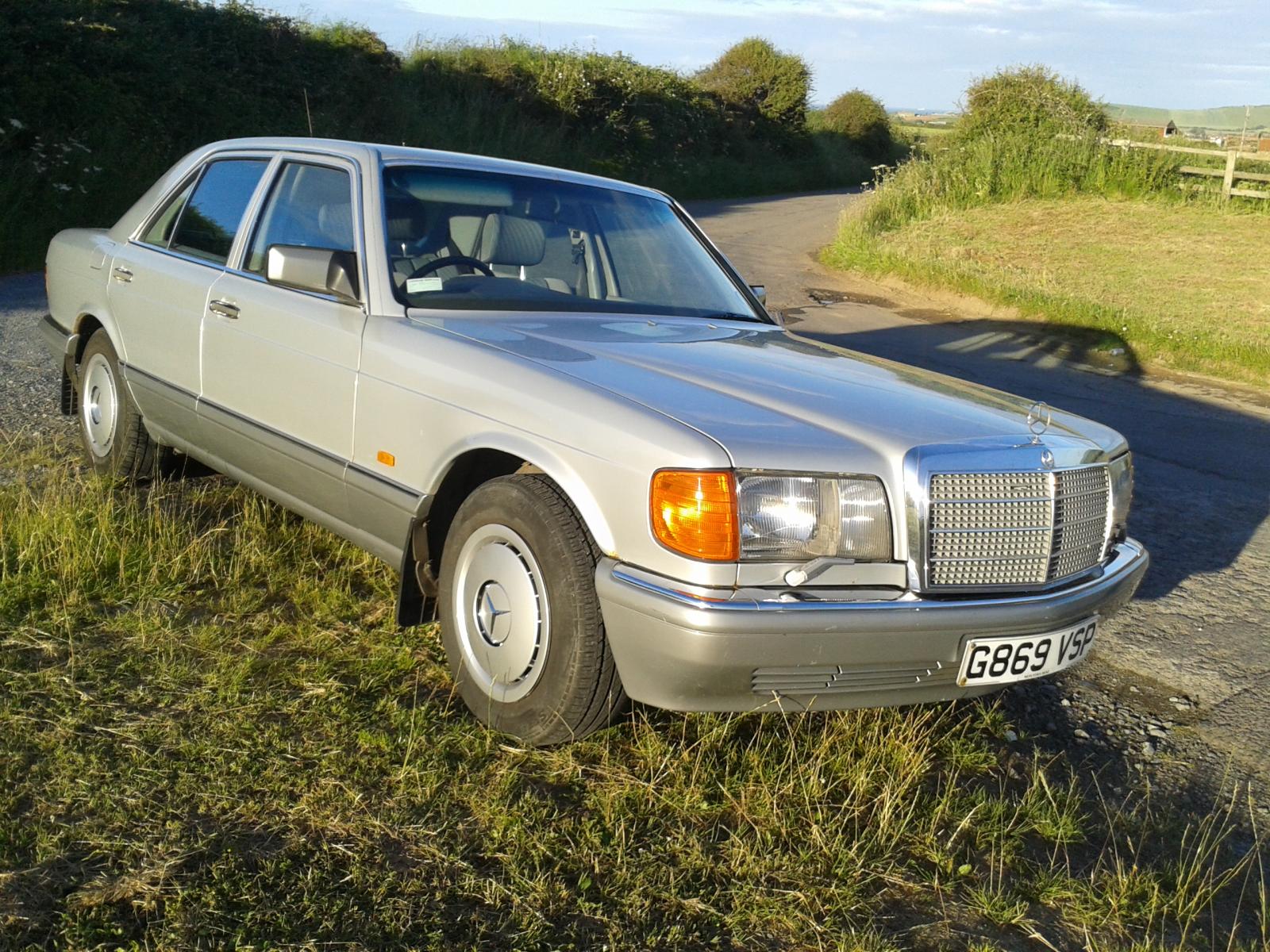

The old Merc 300SE I bought last year has been getting some overdue attention, namely to it running like crap when warm though spot on when cold. It would start and run well with slick auto changes until it reached 75c when the throttle response went to shit, making the box upchanges crap as they are controlled by throttle opening. The CO meter showed the fuel mix was badly weakening with throttle.
After doing the usual vacuum leaks and buying a fuel pressure gauge set I got a bit more involved and wound the eha valve in about half a turn. This apparently alters the fuel pressure differential. After a little fine tuning it is tranformed, lovely low down power on light throttle and sweet upchanges. The internet has uses. :-D. A few more jobs to do but on the whole it's OK for a 200k donkey that spent 8 years parked on a pig farm.
Have a pic of an unwashed Merc on it's test drive near Staithes.
Excellent photo for ebay listing!

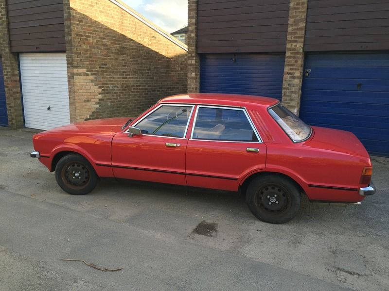

Got some time to do some work on stuff today, managed to move the ex-KruJoe bubble Rover on, made a start on zipping some fresh metal into areas needed on the Cortina and did a bit of painting.
Anyway, this momentous occasion occurred in the Cortina on the way to Shitefest...

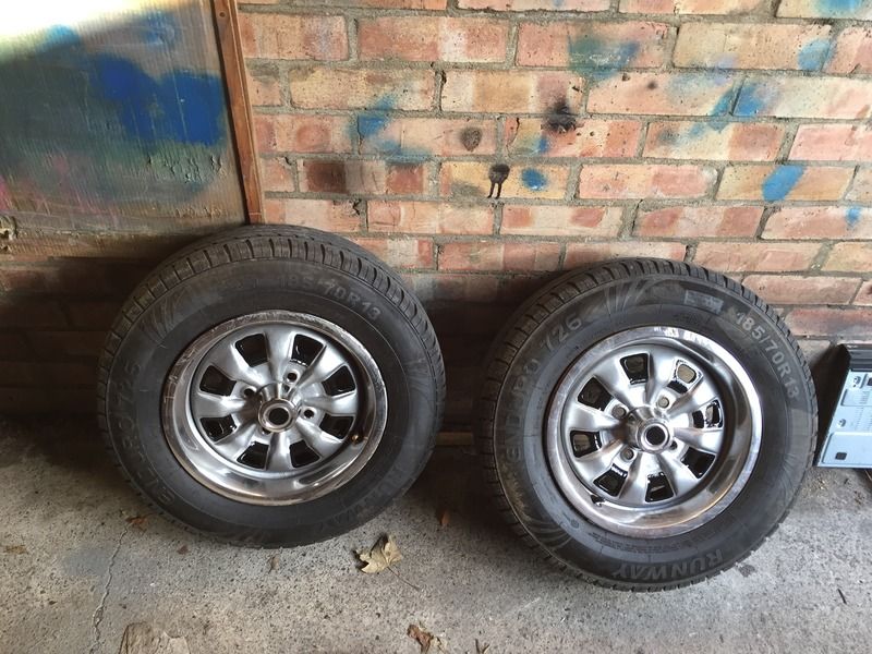

Once I had put some metal into the Cortina I took a look at these:
E246D8A4-4857-4814-AF76-534790E426FD_zps
And decided I needed to start a job I've been itching to do for ages ... Got half way through
EA59F161-66C2-44C6-A27D-C46EBA807B62_zps
Leaving the poor Cortina looking a bit rough on Sierra steels:
F0EAAF54-997A-4D0A-BE07-A221D9282B7B_zps

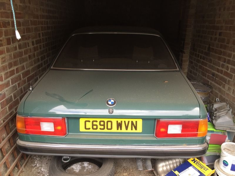

Briefly checked in on my 86 728i which I haven't looked at since before Christmas when I put the engine back in
4D2203AA-7D14-4E17-8D3E-ECC57EE389DB_zps

The old Merc 300SE I bought last year has been getting some overdue attention, namely to it running like crap when warm though spot on when cold. It would start and run well with slick auto changes until it reached 75c when the throttle response went to shit, making the box upchanges crap as they are controlled by throttle opening. The CO meter showed it was badly weakening with throttle.
After doing the usual vacuum leaks and buying a fuel pressure gauge set I got a bit more involved and wound the eha valve in about a turn. This apparently alters the fuel pressure differential. After a little fine tuning it is tranformed, lovely low down power on light throttle and sweet upchanges. The internet has uses. :-D. A few more jobs to do but on the whole it's OK for a 200k donkey that spent 8 years parked on a pig farm.
What's an eha valve then?
Electro Hydraulic Actuator apparently. It seem the injection unit has different pressures for upper and lower sections, this controls it. I think it needs fairly specialist gear to set properly so I used the blind guess method. It needs the fuel mix reset after adjustment.
The EHA valve is what I had to replace on my Audi - it was working fine but piddling out lots of fuel. Cost more than the car.
