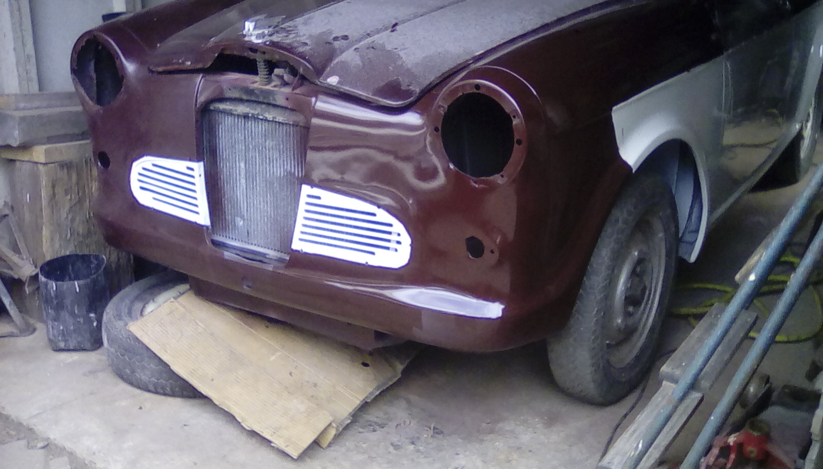

D Spares & Tyres Posted June 21, 2018 Author Posted June 21, 2018 This week's update... Took the wing back off to finish the welding. ( I only put it back on and primed the corner because I was bored of welding and wanted to see some fresh paint ) I made a bump stop mount but I think I have cocked up and made it too far down. The old one was too rotten to measure properly but also with the box section i put in the wing, that isn't quite to factory dimensions either! So I painted the front panel. Loosely placed some chrome in the holes to give it a face again! So, it's just paintwork left to do on the panels now. NO MORE WELDING!! (Bound to be a small bit somewhere that I've missed, I'm not that naive) Is it just me or does it look prettier without a bumper? With one it looks a bit catfishy I reckon Squire_Dawson, GrumpiusMaximus, Mrs6C and 23 others 26

Ghosty Posted June 21, 2018 Posted June 21, 2018 Is it just me or does it look prettier without a bumper? I really agree, looks a lot less dowdy. Rocket88 and D Spares & Tyres 2
Squire_Dawson Posted June 21, 2018 Posted June 21, 2018 This is first-class workmanship, very pleased to see it taking shape. These cars are little gems, must have one someday. D Spares & Tyres 1
D Spares & Tyres Posted June 21, 2018 Author Posted June 21, 2018 This is second rate workmanship, but looks ok on a small picture. very pleased to see it taking some kind of shape. These cars are little gems,one day I'll turn up at your place with some cash and buy this oneEFA catsinthewelder, wuvvum, Squire_Dawson and 3 others 6

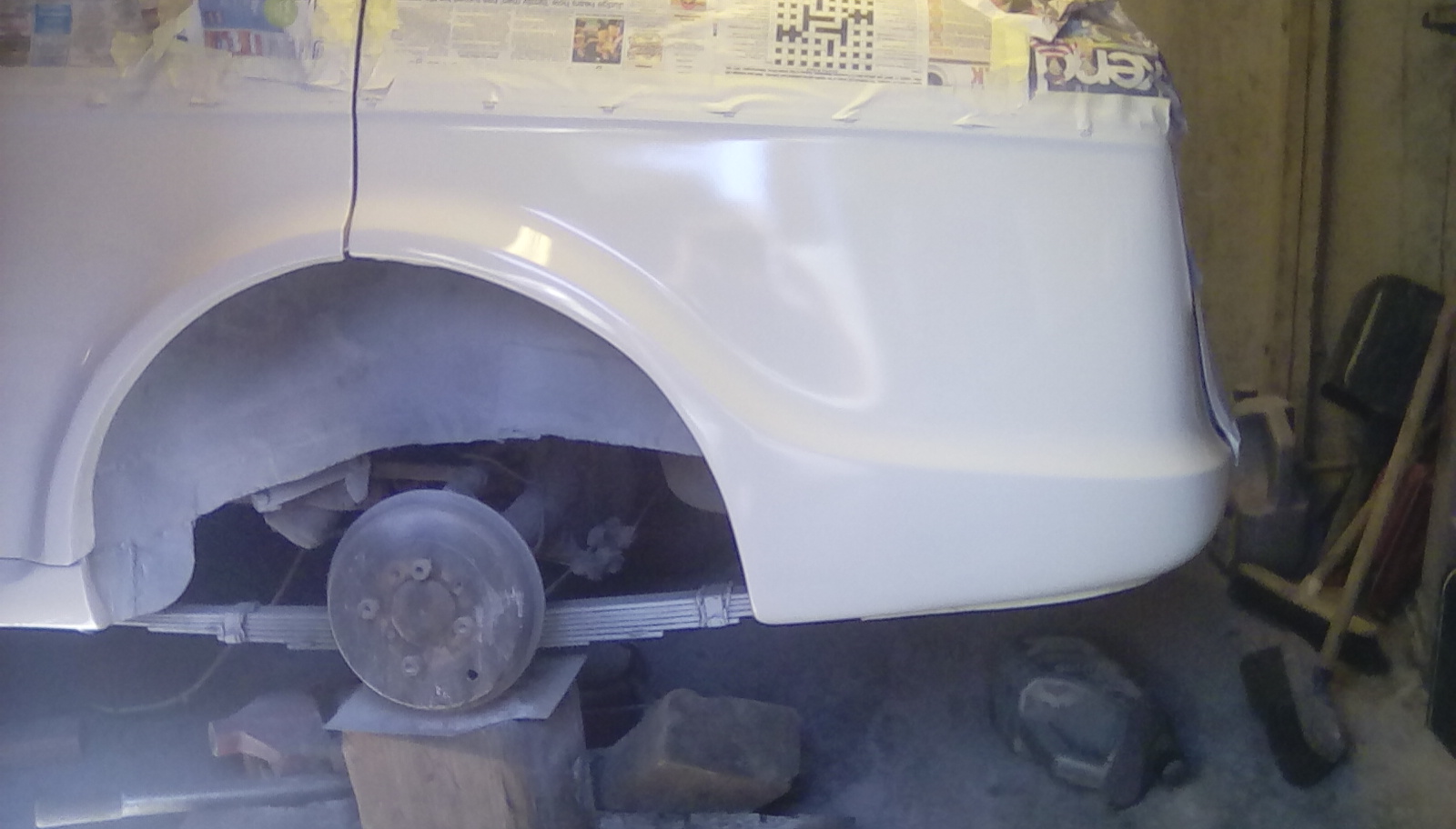

D Spares & Tyres Posted June 26, 2018 Author Posted June 26, 2018 Primer! I thought the rear wing was fine but there are some suspicious looking bubbles down here in the corner behind the rear wheel... Doesn't look too bad on the photo but it's those kind of big bubbles that mean there is filler down there. Fair play though, it must be a pretty old bodge, I've had it five years I think and there were no fresh bits of paint on it then! I'll attack it tomorrow but it's probably going to be a MIG job... So much for no more welding! mercrocker, Uncle Jimmy, GrumpiusMaximus and 5 others 8

D Spares & Tyres Posted June 29, 2018 Author Posted June 29, 2018 Paint! Next job? Sand down paint with 2000 grade paper then polish with some G3 Asimo, The Reverend Bluejeans, mercrocker and 12 others 15
D Spares & Tyres Posted July 12, 2018 Author Posted July 12, 2018 Paintwork done! (Well, externally anyway. Engine bay needs doing) Next job I suppose ought to be fixing the exhaust pipe. It was fine when I got it but in my haste to get it off the trailer i caught the exhaust on the trailer... I have put the front part back on for now. Mainly to keep the noise down when moving it. The original strap that would have held it was brokenIt was quicker and easier to replace it with a more modern set up As much as I am enjoying seeing this car come back to life, it isn't what I want in my garage. I must remember that I am doing this to sell it and get my Renault 16 inside. That is what I want to keep long term, I already have a very nice 1950s car on the road, I don't need two. So... If anybody here wants it then let me know. Currently what is it worth? £1500? I shall carry on doing it up so the price will gradually up. I'm not willing to subject myself to the general public though, just you miscreants. puddlethumper, Conrad D. Conelrad, GrumpiusMaximus and 15 others 18

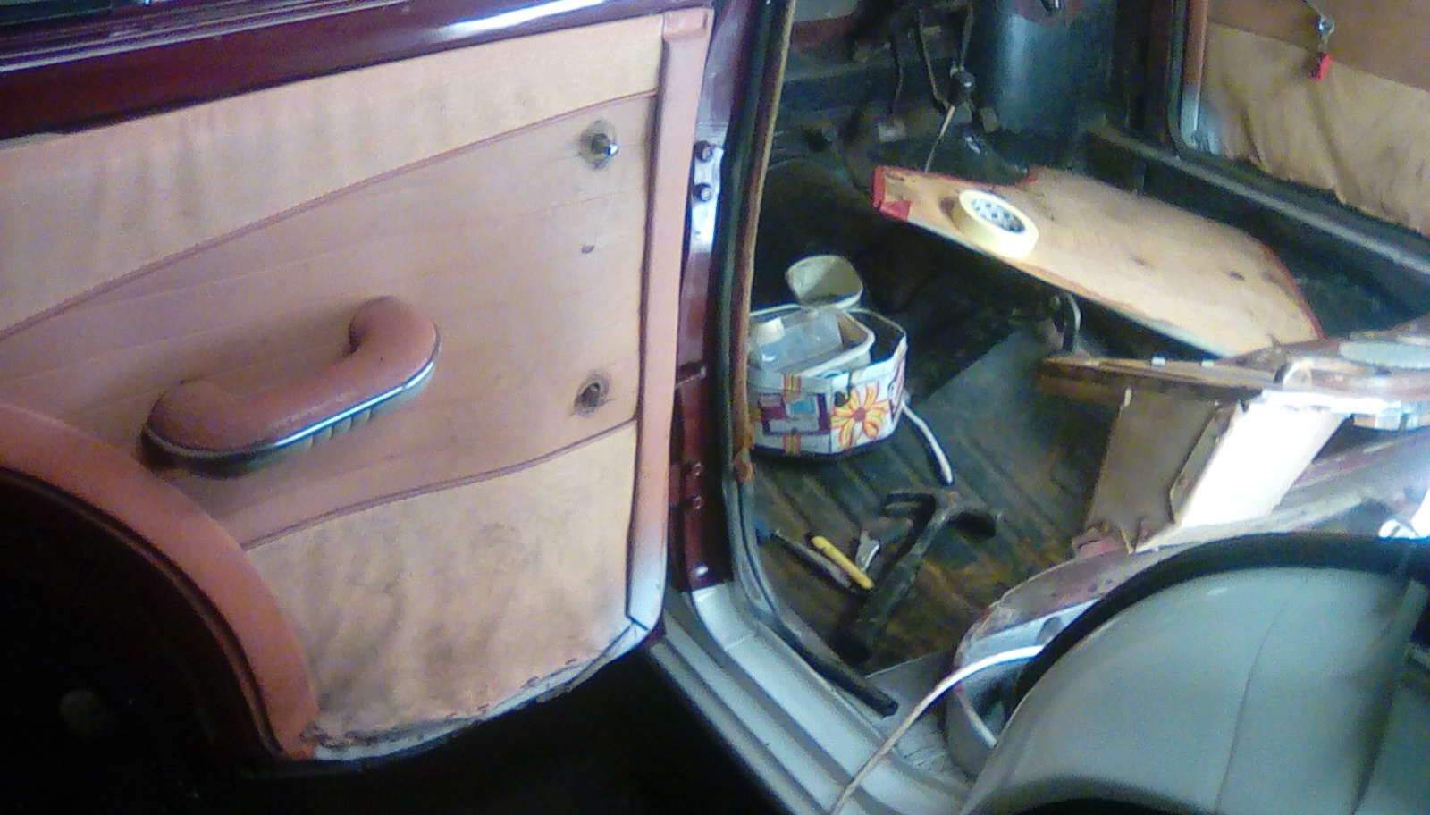

D Spares & Tyres Posted September 21, 2018 Author Posted September 21, 2018 Haven't done much to this for a while. Now the welding is finished I thought I would turn to the interior. The original one is filthy, tatty and beige So a couple of years ago I drove down to Cornwall and bought another, far better one. It still needs repair but its better than the previous one johngarty, Cardinal Wolseley, GrumpiusMaximus and 10 others 13
vulgalour Posted September 24, 2018 Posted September 24, 2018 Are you matching the big grille insert to the nostrils leaving the shell chrome? That might look okay with the rest. Nice find on the interior. D Spares & Tyres 1
D Spares & Tyres Posted October 17, 2018 Author Posted October 17, 2018 Are you matching the big grille insert to the nostrils leaving the shell chrome? That might look okay with the rest. Nice find on the interior.No, the centre inserts are stainless steel. Don't want to paint them. The interior is out of a MK2. Have just realised it has a totally different front seat frame design. Not sure yet if that is going to be an issue or not
