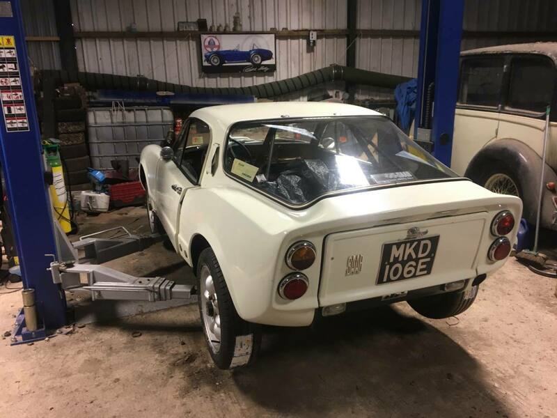

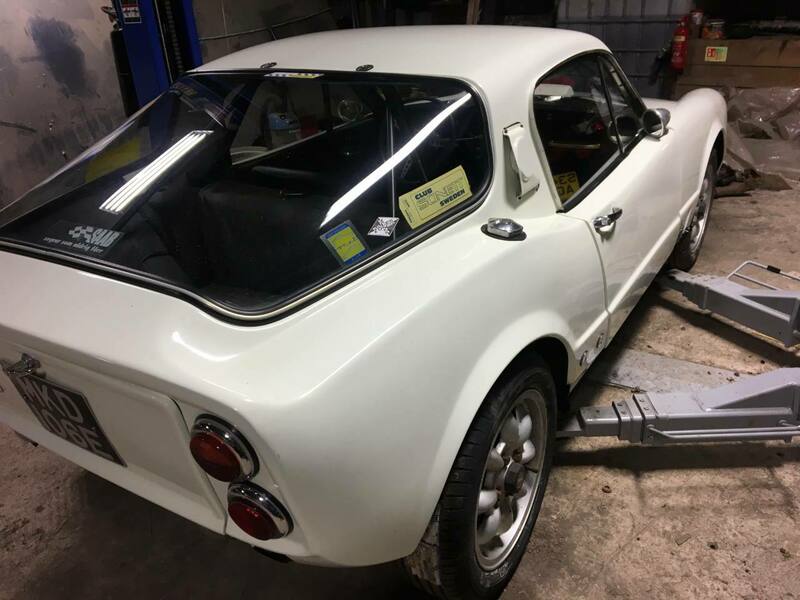

Today I remembered why I hate cleaning cars, I much prefer to use them than clean them, but it does not help when you are about to sell a car. The last couple of weeks I have been getting the Sonett ready for market, some what reluctantly as I still love it but my knees disagree everytime I get in or out. Of course, a lot of the minor jobs are ones I have been putting off since I bought the car 10 years ago!
I have derusted the underside of surface rust as documented previously, and applied Lanoguard to help keep it at bay, and that has turned out nicely
Next job was the bodywork. Considering this is the original 55 year old gelcoat, it is in remarkable condition. First was a coat of wax (whatever is lying around, this time it was some MER I have had for years)
After which a coat of my favourite product. This was recommended to me by a professional detailer many years ago and I have used it ever since. Easy on, easy off and a superb finish that lasts for ages.
That done, it was clean the glass, refit the boot floor, vacuum the interior and job done.
Of course, it is now better than it has ever been and I started to think about keeping it. I have to be sensible, so have listed it on C&C before I changed my mind. Mind, I really won't be upset if I end up keeping it.

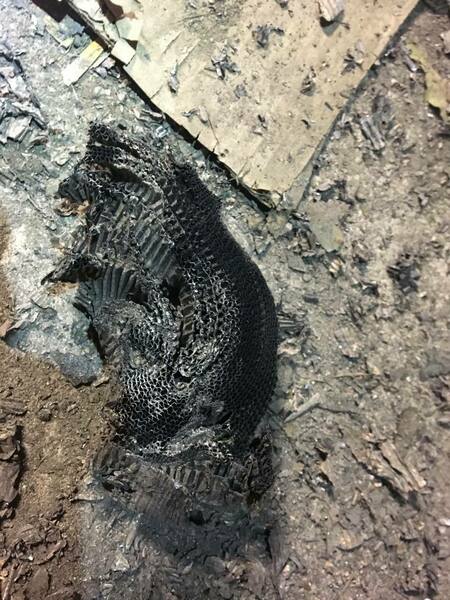

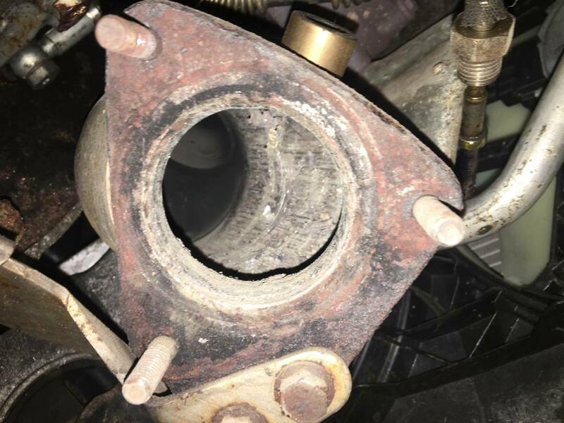

Cleared the Sonett off the ramp so time to investigate the recently (re)acquired Saab 9-3.
Collected by trailer from Edinburgh after being towed in to the garage |I collected it from as a "non runner" although technically it did tick over if in a haze of smoke, but would not rev. The dashboard showed "DPF Filter Blocked" and "Limited Performance". I was 99.9% sure it was the blocked DPF causing the problem but in a worst case scenario it would provide many spares for my other one.
Got it onto the lift
Removed the downpipe and fired it up just in case. Took a lot of starting, no difference to the running and no noisier! Checked the value of a scrap CAT from a diesel Saab (Nah, we don't want that mate, nowt in 'em) so with nothing to lose decided to try a knock through to see if that is actually the only fault. My ex-MOT tester arrived and whilst here gave it the once over. All good except a leaking NSF strut, a bit of misting on the OSF strut (advisory) and some play within the steering rack (also advisory). The steering rack was fitted by the PO at the garage I collected it from, supplied by ECP. In May this year! Thanks ECP.
Much hammering with chisel, air chisel, drills etc and a mere 3 hours later the innerds were out
Flushed with success, even with aching arms and covered in shite, I lowered it down and started it. Took a bit of starting, was satisfyingly noisier, but still runs like crap, won't rev and smokes. Sounds like it is only on 3 cylinders. Bollox. That will be the 0.1% I wasn't sure about :-(
Tomorrow I will put it outside to save smoking the workshop out, connect up my Tech-II and see if it identifies a fault. If so and it is simple, the car may well live. If not, as I suspect, it will be parked in the naughty corner to become a spares car.

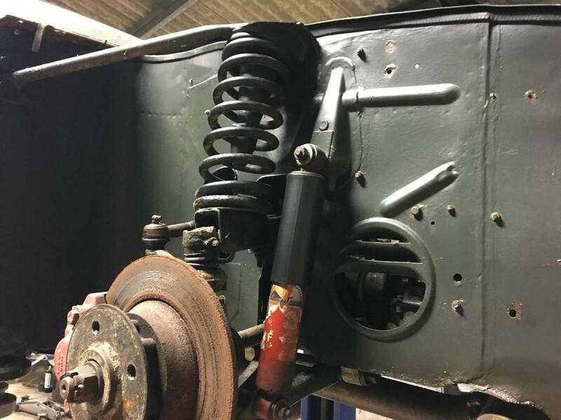

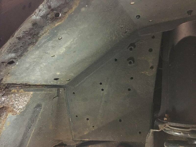

Christmas eve, I pressure washed the Disco under the wheel arches so I could investigate how big a patch was going to be needed to get it an MOT. Then drove it into the shed and positioned it on the ramp. Got the torch and had a look, the pressure washer had helped* and the small patch had become the bottom 8 inches or so were missing. Depressed, I left it and went to celebrate* Christmas.
Christmas day I forced myself to stay out of the shed and instead opened a bottle of red. It helped, but I was still bored....
Today, I decided that when I got the wing liner off it would all look better so out I went.
Firstly the bit missing at the front of the inner wing is quite large
and as a bonus, the battery box behind it needs a patch
Moving back, my hopes started to rise as the main innerwing looks good
But at the top in the centre a small patch is required
Sadly, the top of the footwell also needs a tickle
but, in true disco form, that was not all as the drivers floor is mostly missing after giving it a prod
To tackle the floor and footwell, the carpet has to come out which means the seats etc have to come out. The outcome is this is not going to be a quick fix so the Disco is going to be SORNed and moved down the list as a major project. This will leave me without a tow car/4x4 so it is a good job I have not completed the end of year tat accounts
