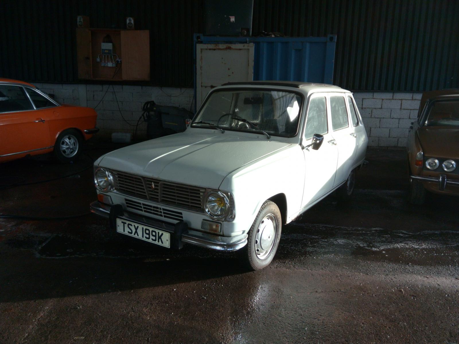

Looks like the one that was tucked up in a showroom in Kirkcaldy years ago. Apparently it was an ornament cos the engine had gone, and the details on the ownership match the last time I saw it. If it is - and that's a big if - the bodywork was pretty good.
I've found some photos from the last time it went through - crustier than it looks here, but possibly not beyond hope. Really do need somebody to get underneath and check the sills out. Doors all look knackered but that's an easy replacement. Already got my eye on a good running engine for not much money, maybe a set of doors too...

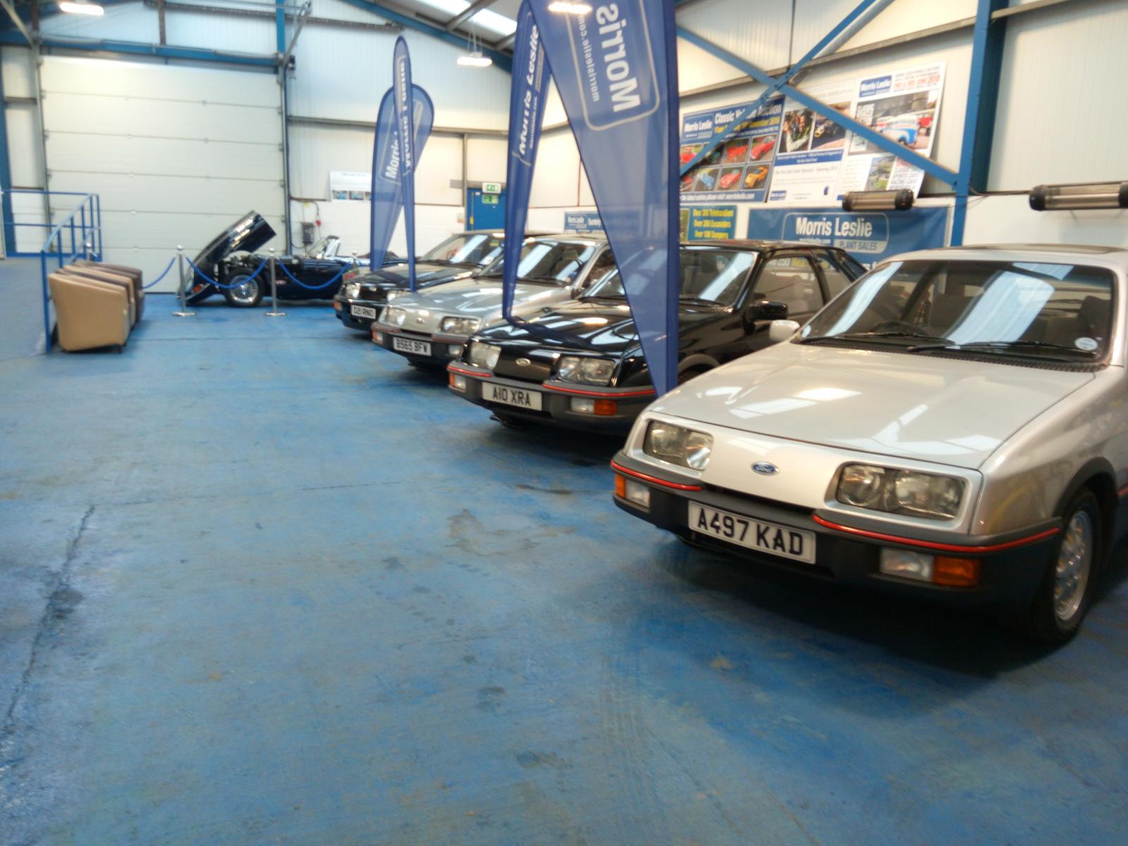

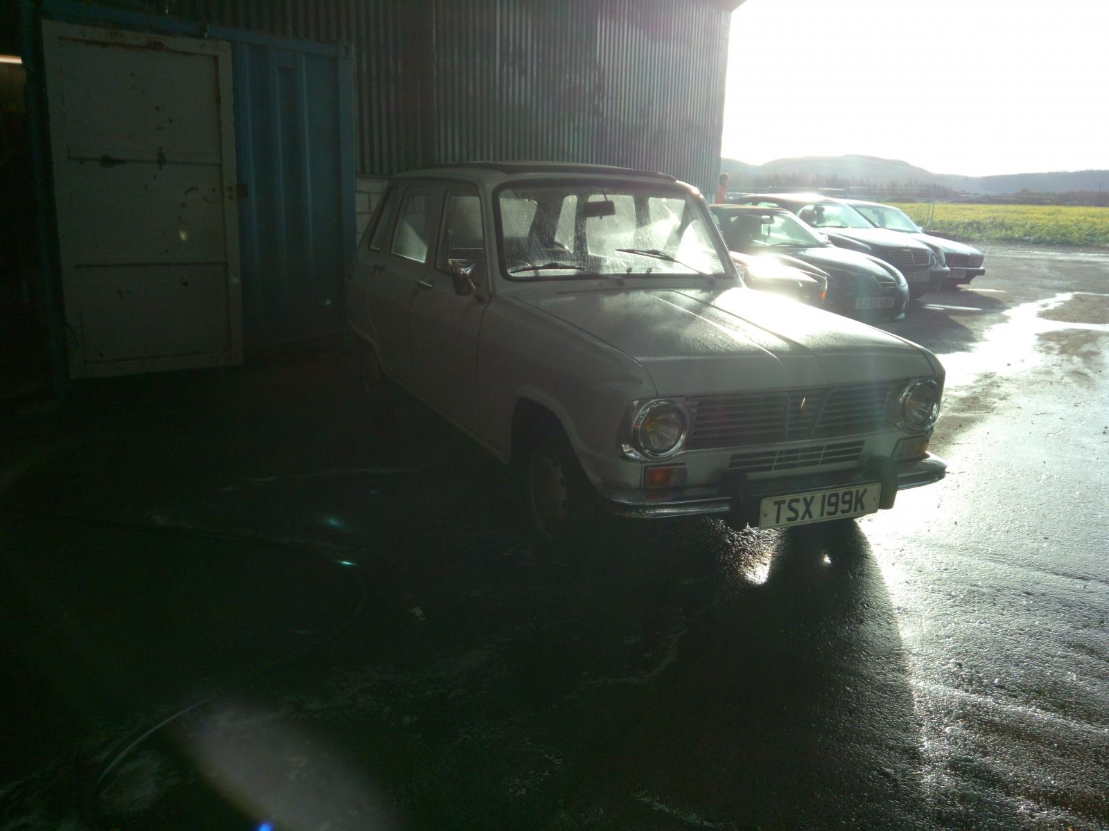

Well Friday arrived and I set off to Errol to have a look, I wandered around the nice shiny cars looking for it and saw some very nice cars. Also saw this.
What were they thinking.
Anyway the no doubt expensive corner.
That is more like it.

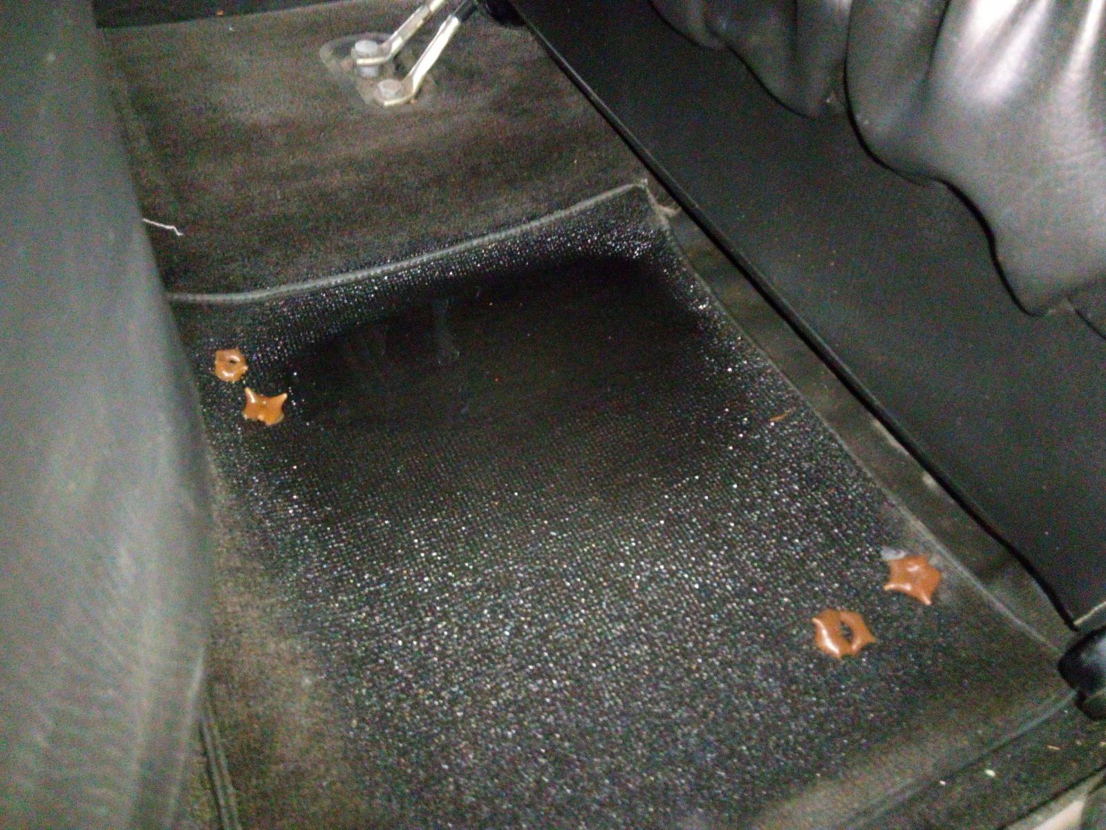

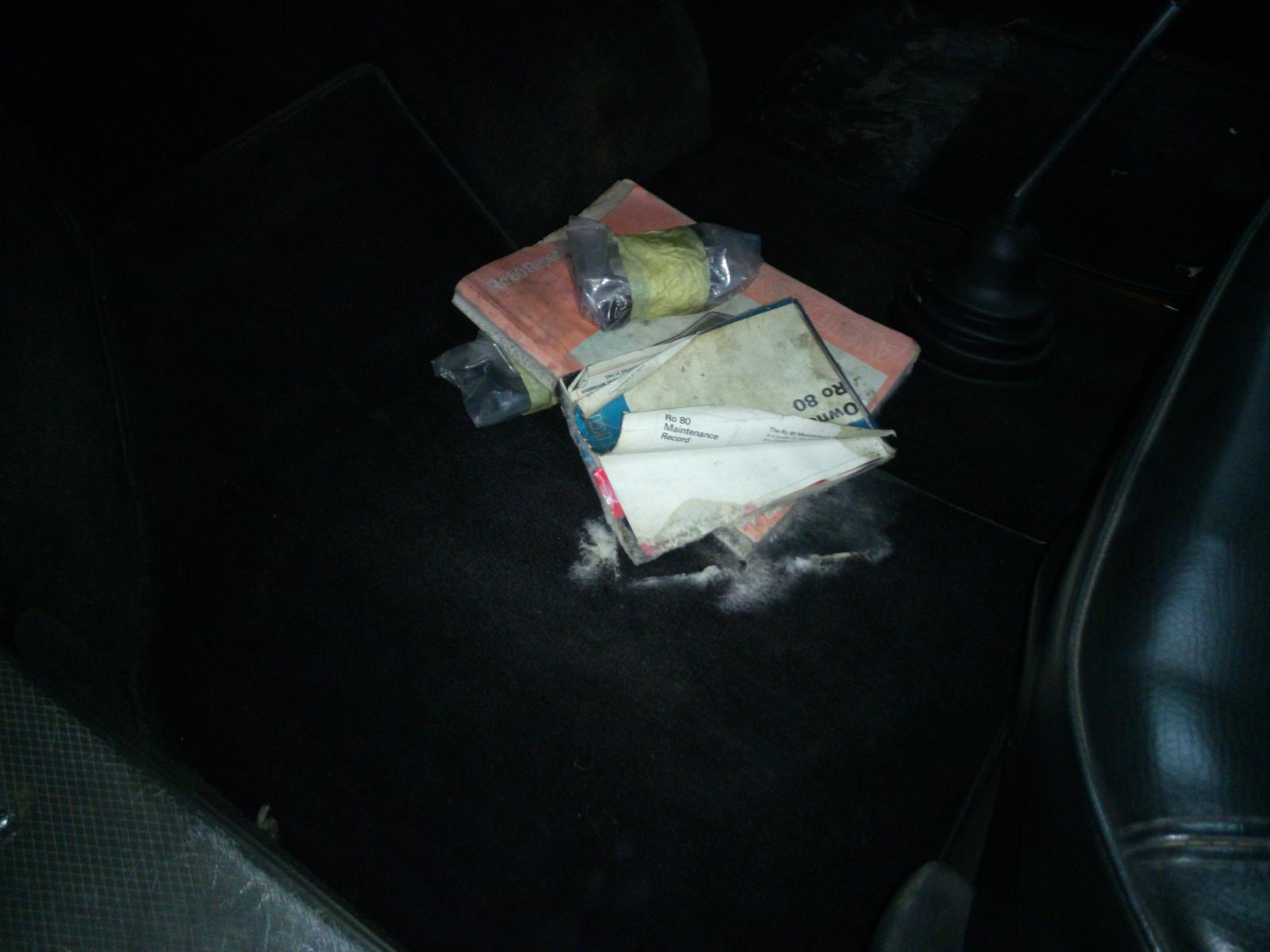

Front passenger floor had these books on it as well as the mold from the damp.

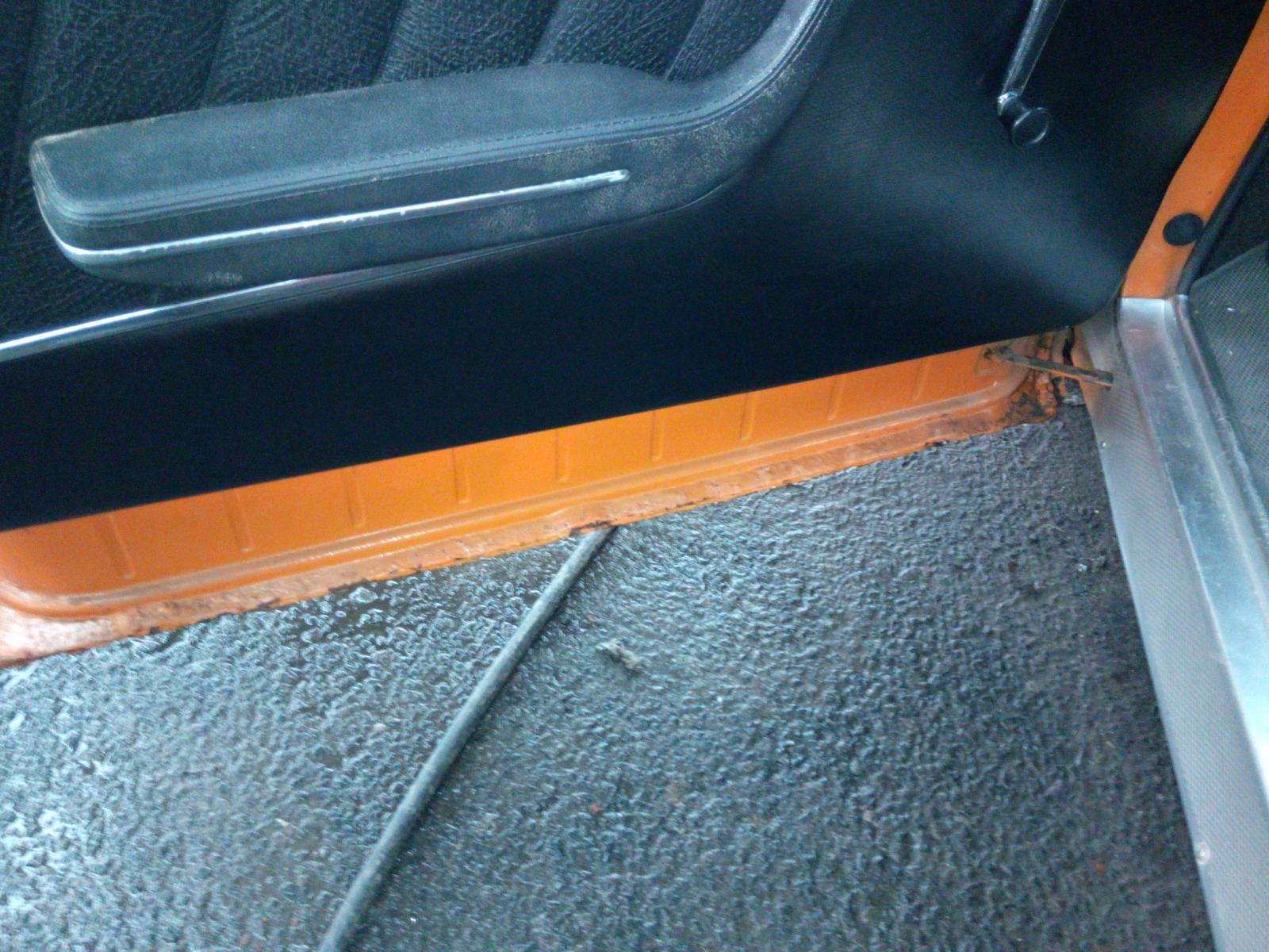

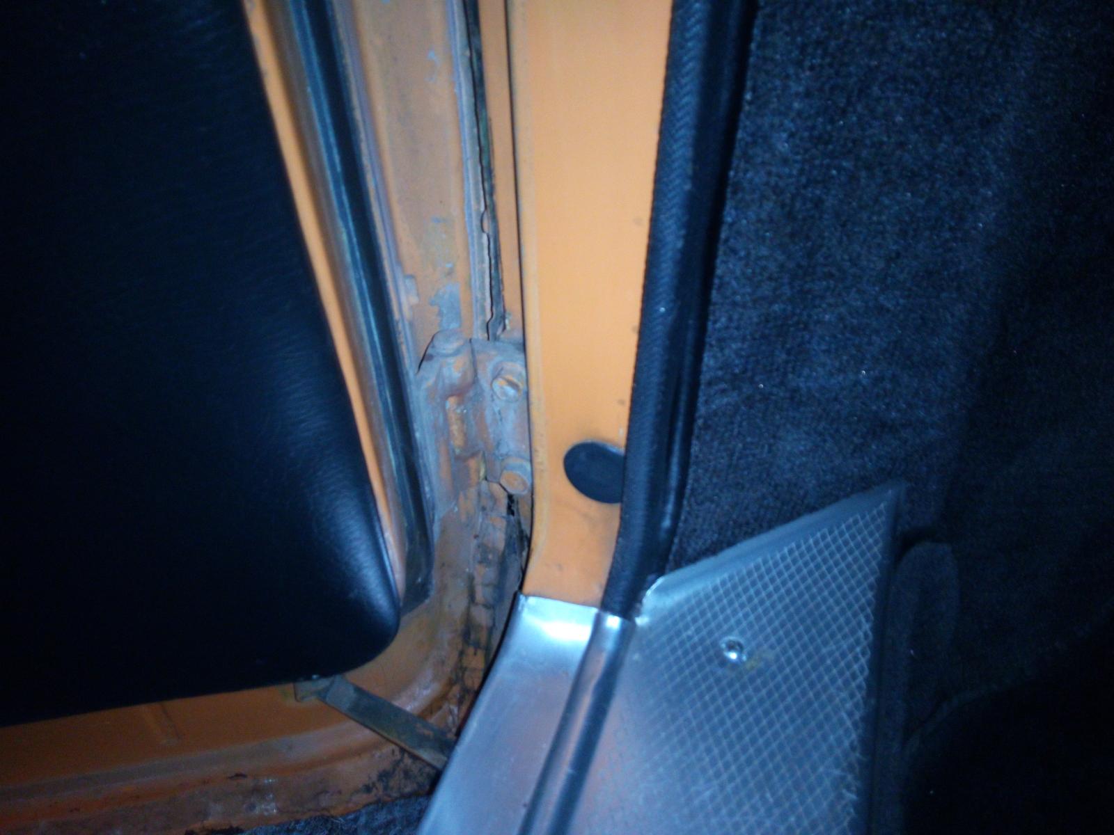

Front passenger door (as with all the doors) is needing work at the bottom.
Lower hinge pin is fucked. (Door needs lifted to close)
Back passenger door.

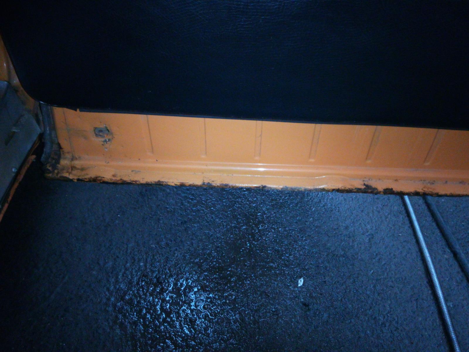

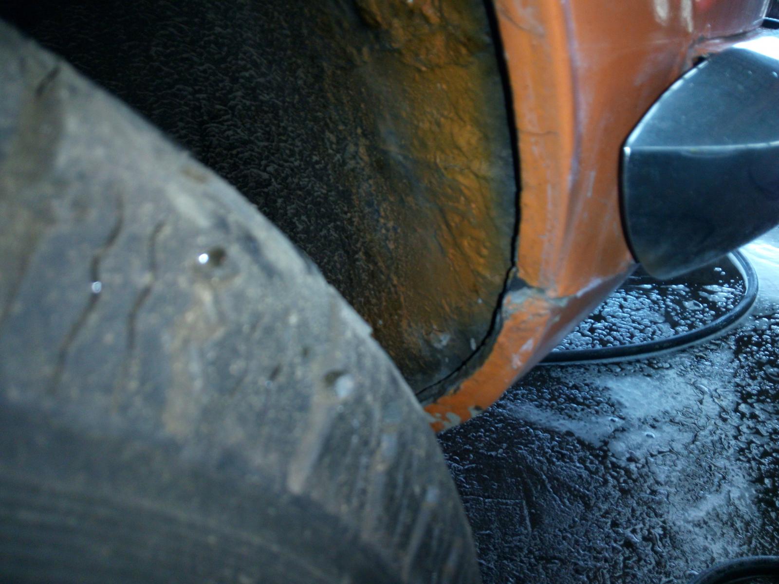

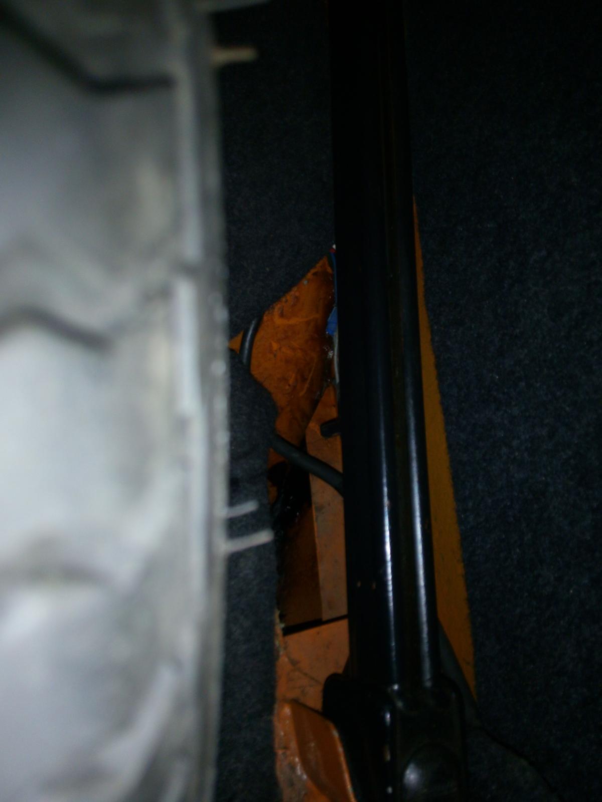

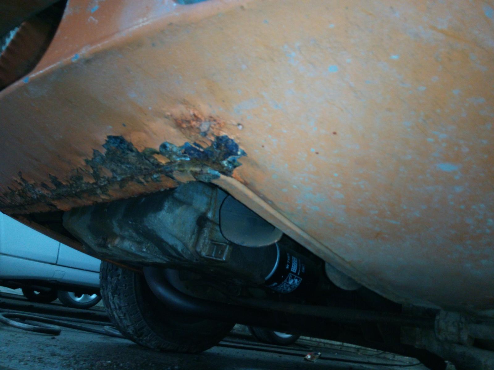

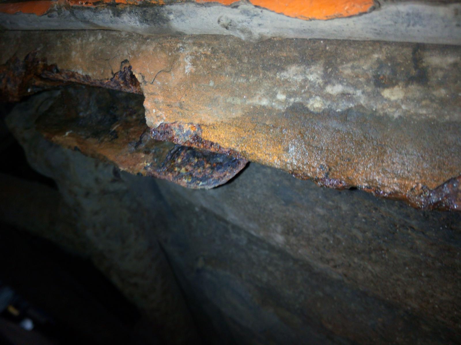

Passenger side of the boot (where the rear arch comes down behind the wheel)
Driver's side the same but the spare was in the way.
Rear driver's door.

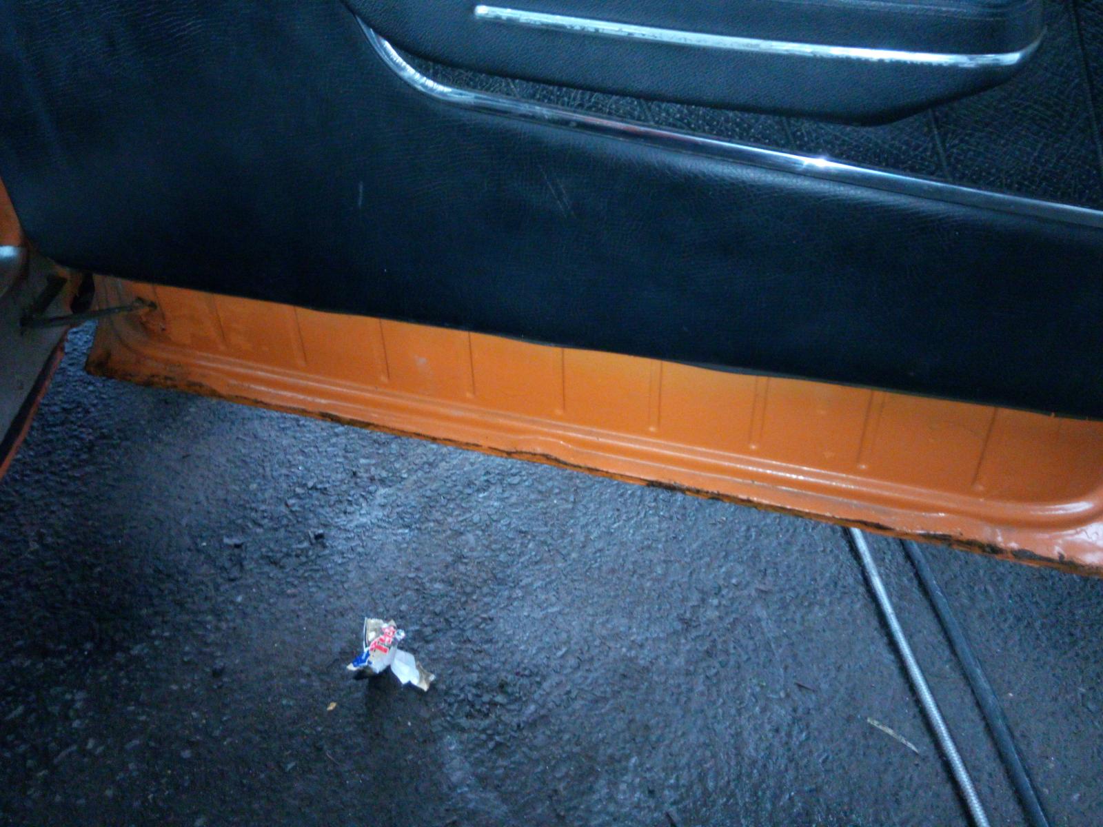

Rear driver's side footwell had a lake and fungus.
Drivers door.

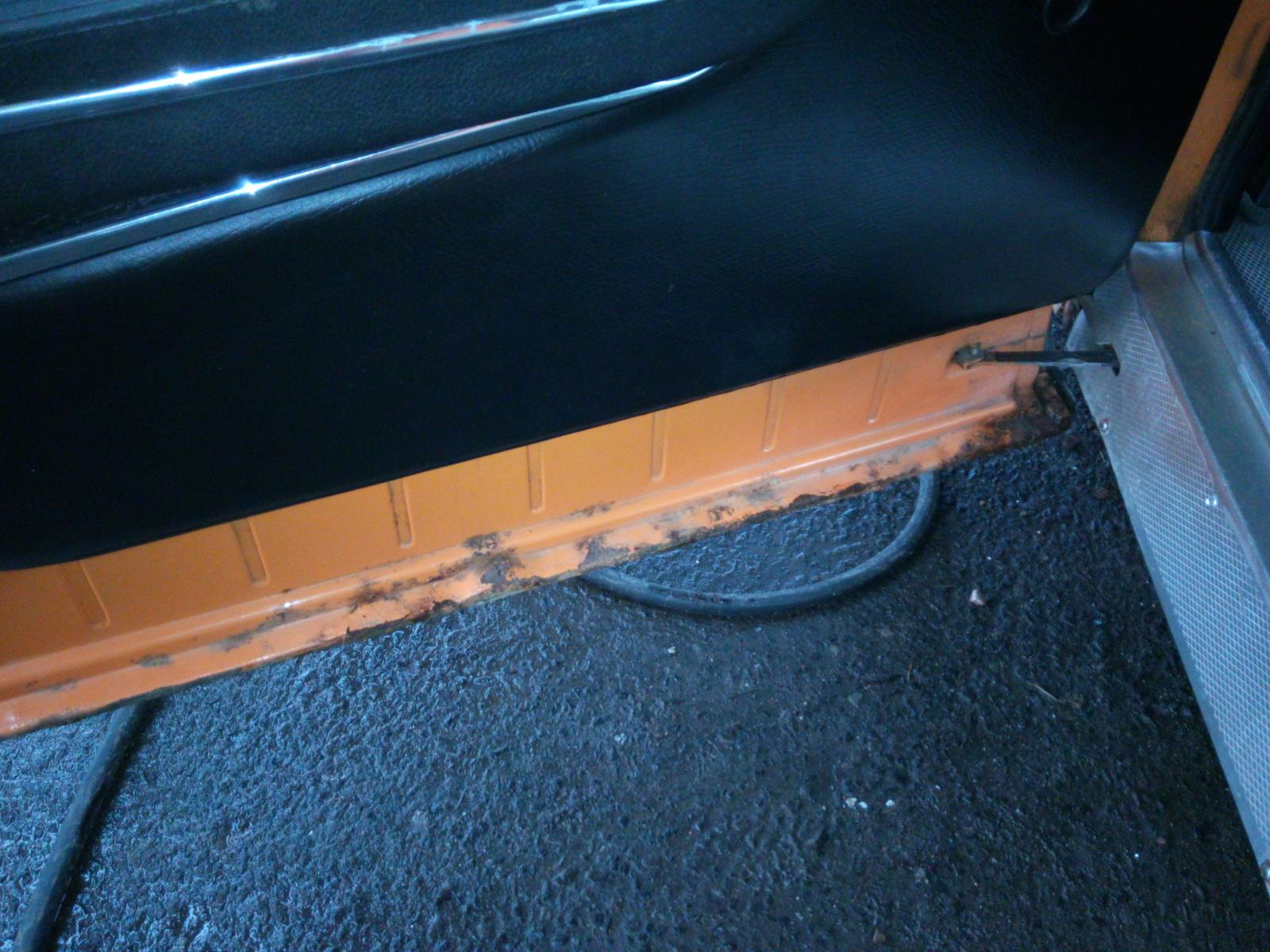

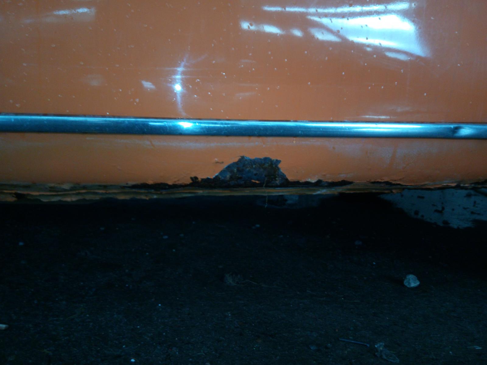

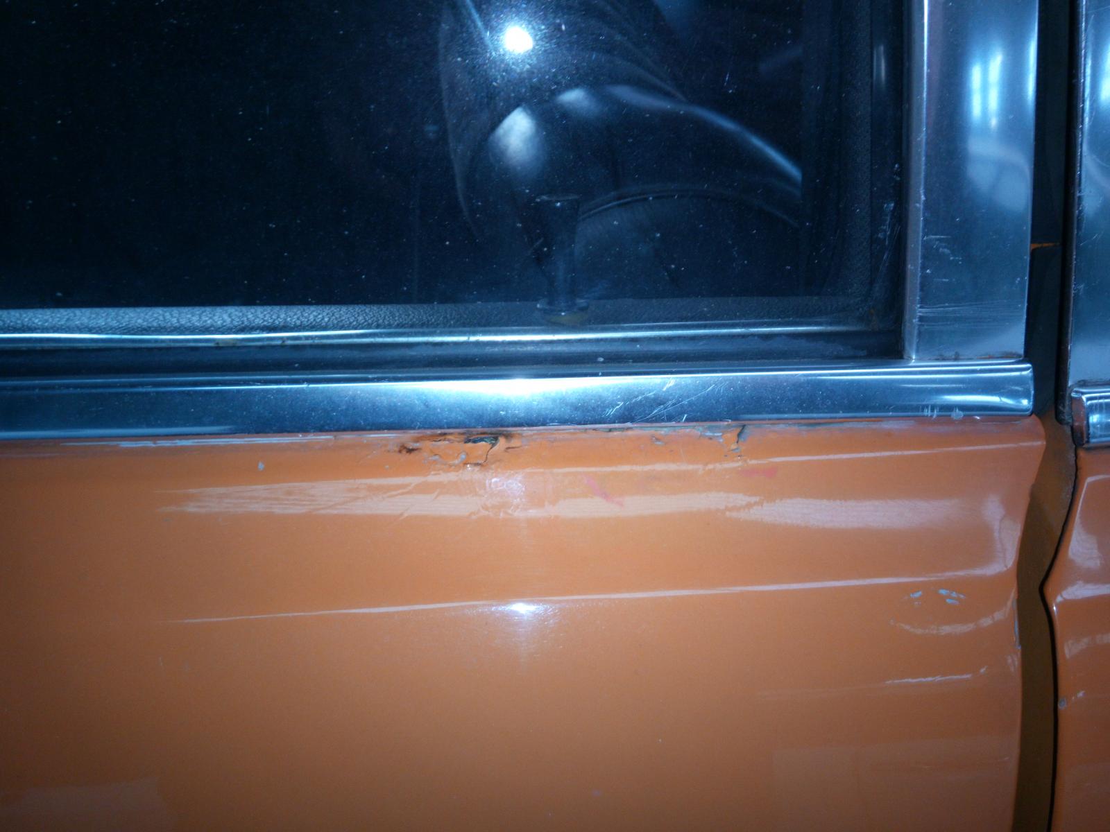

The outside of the driver's side rear door.
The sill end looks to have had filler and is bubbling up.
But didn't look too bad.

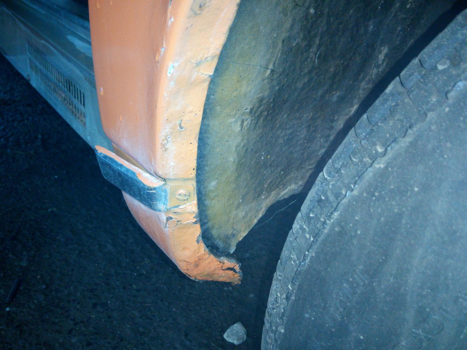

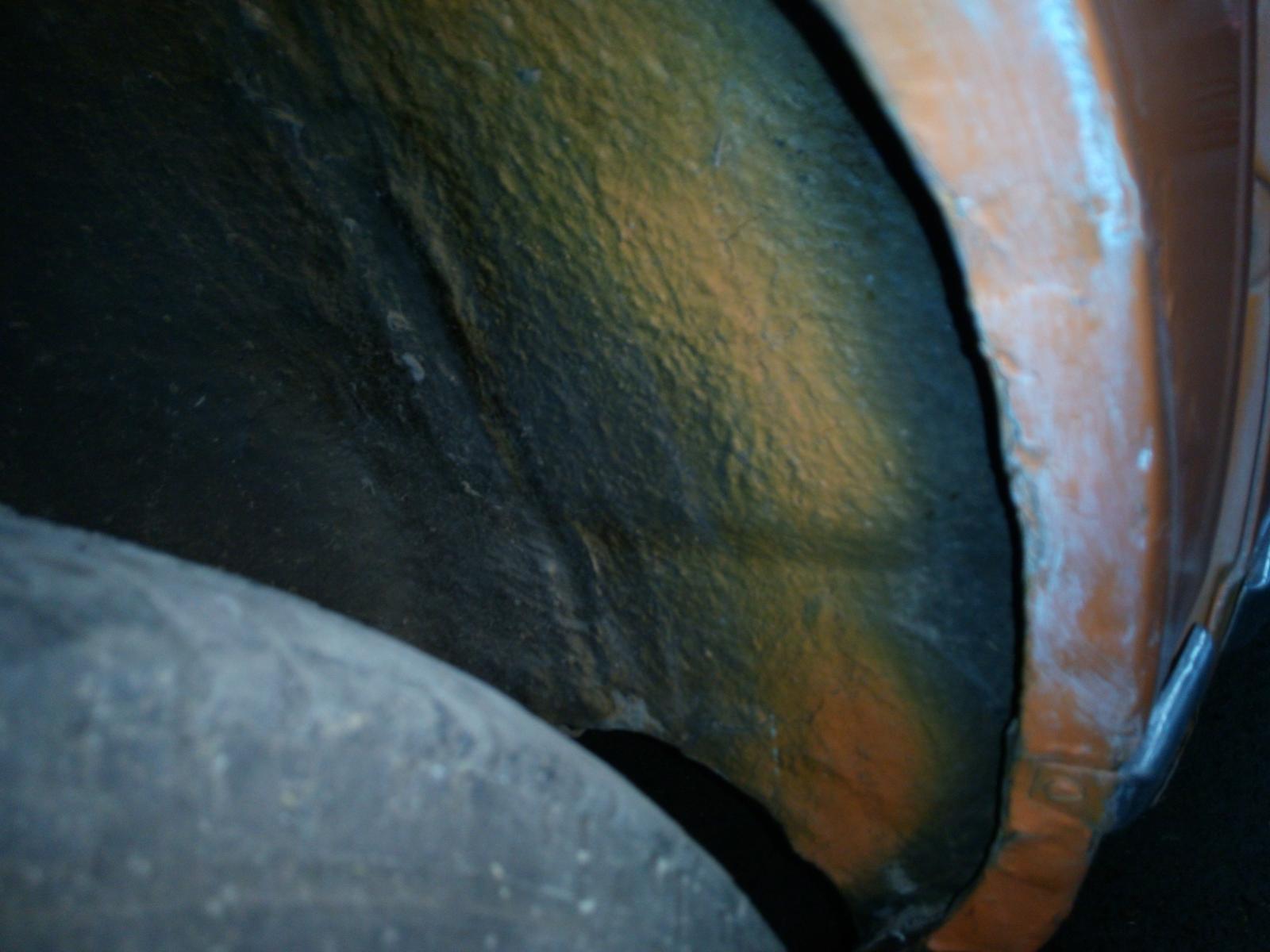

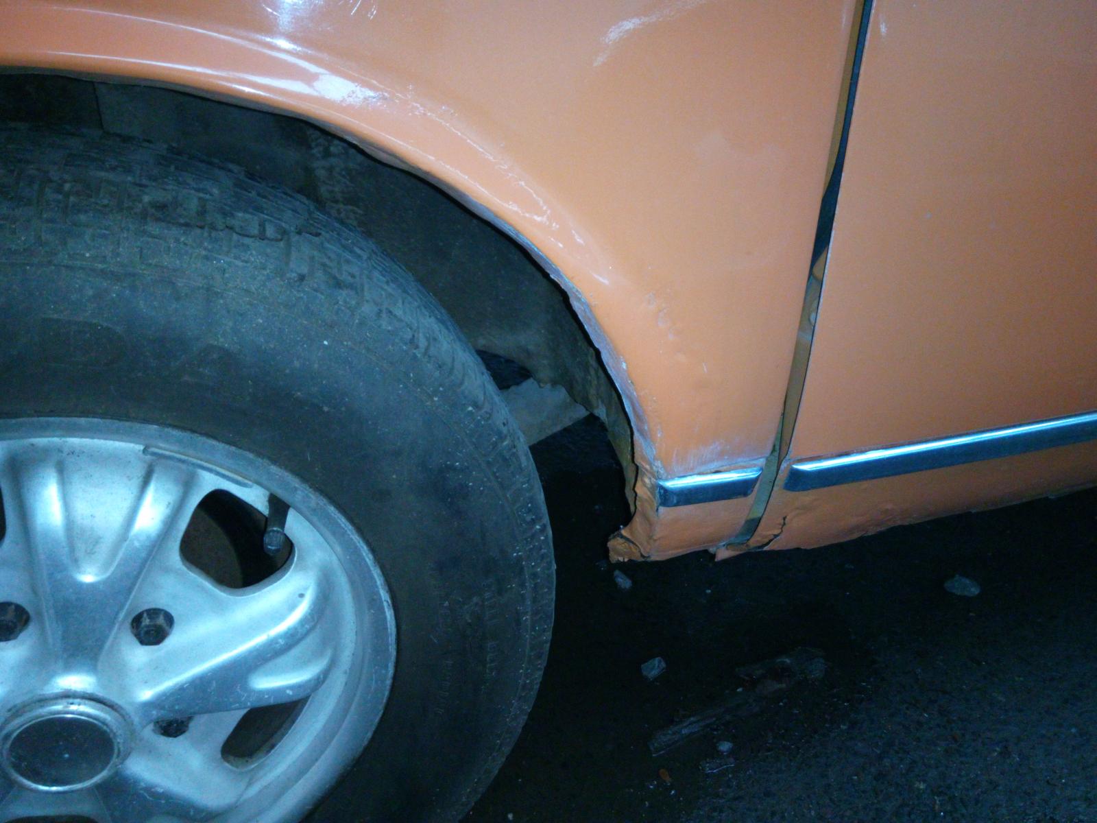

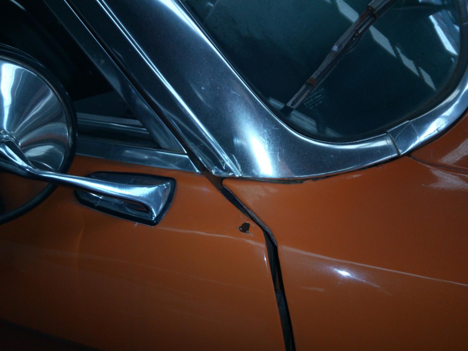

Drivers side front arch/valance joint
Rear of the arch

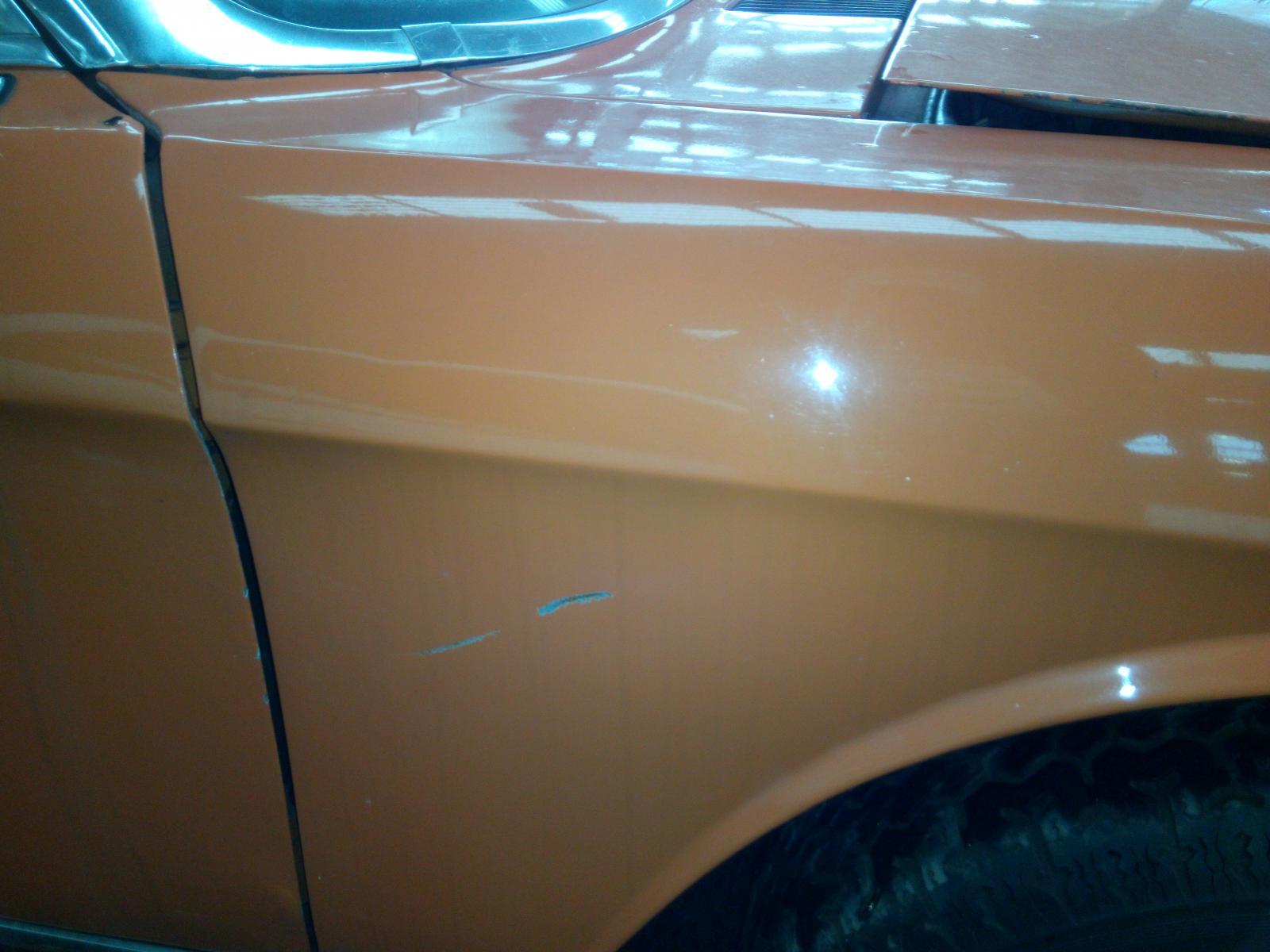

Decent sized scrape in the wing

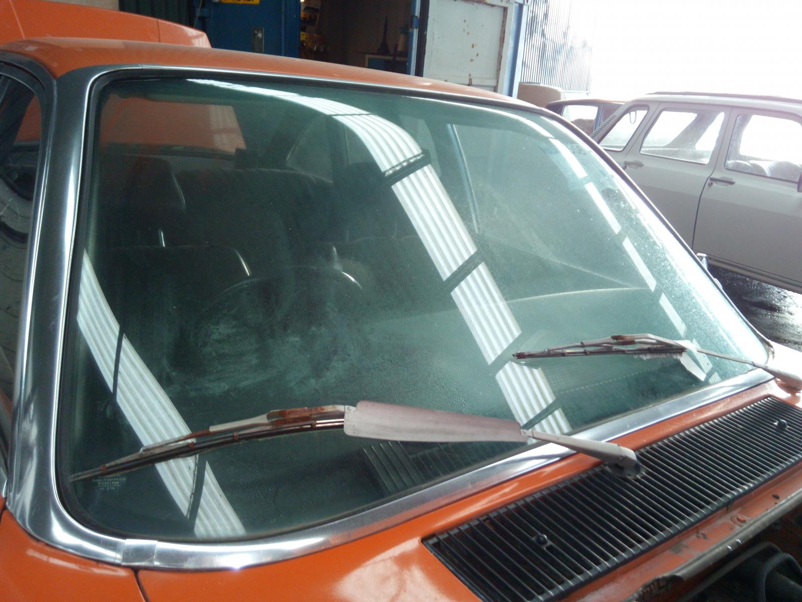

Back window on the passenger side.
Rear quarter window.

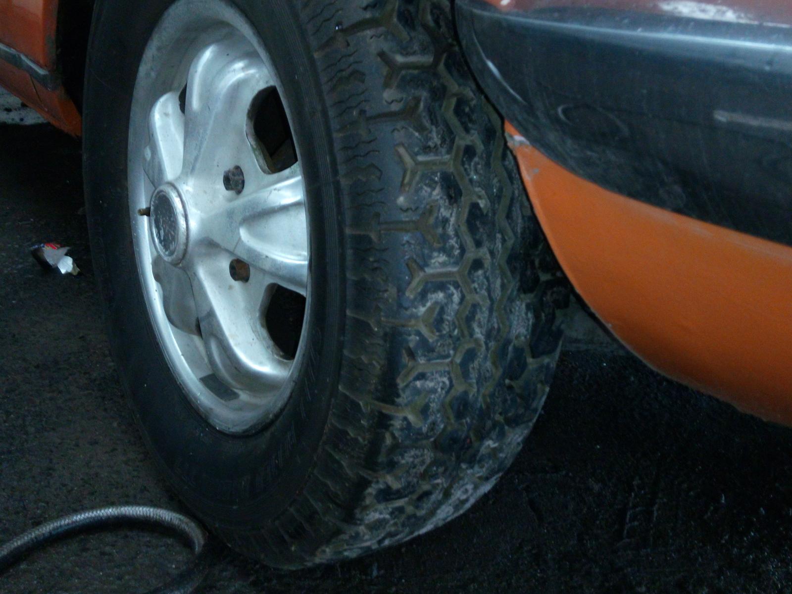

The tires are best described as what was around to be fitted, the passenger front is flat and the driver front looks like it should be for an offroader.

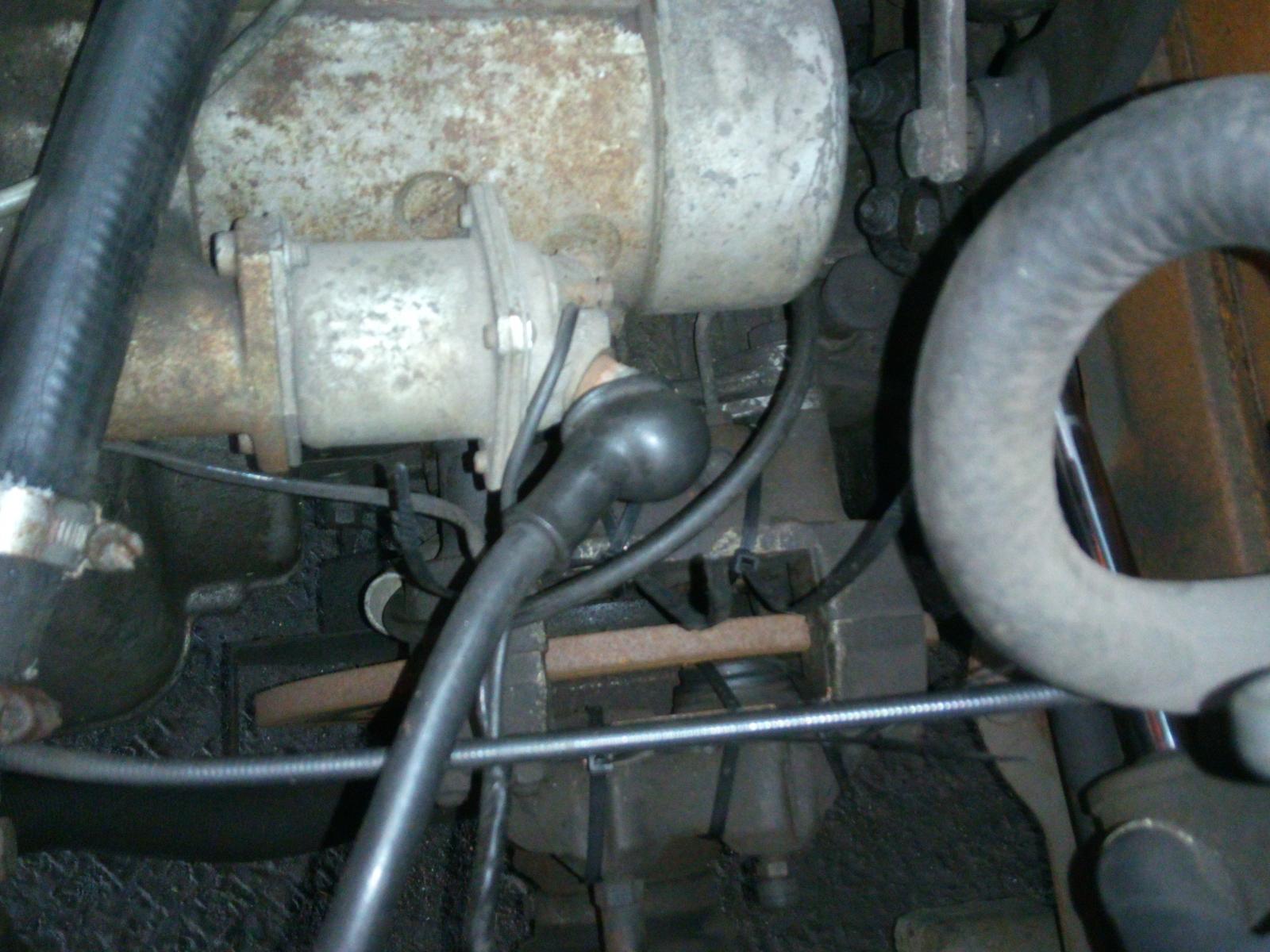

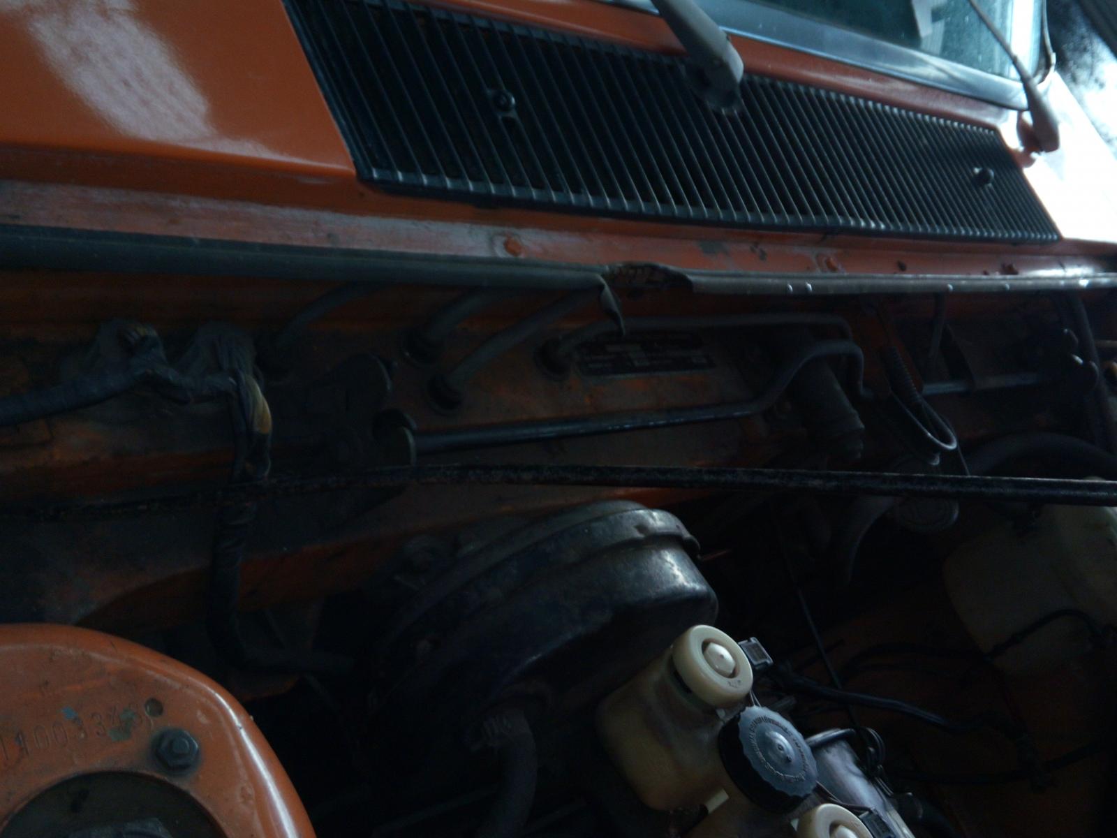

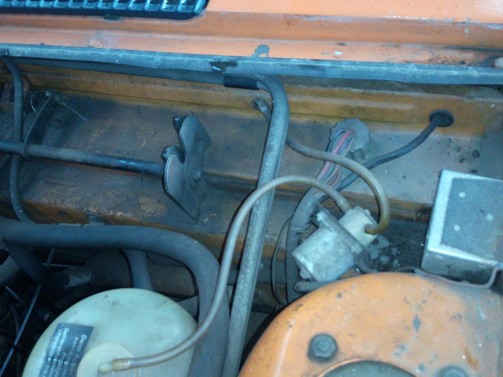

Under the bonnet looks quite tidy with regards to the metalwork but the front brakes have no pads and the piston's cable tied in place (not very well)

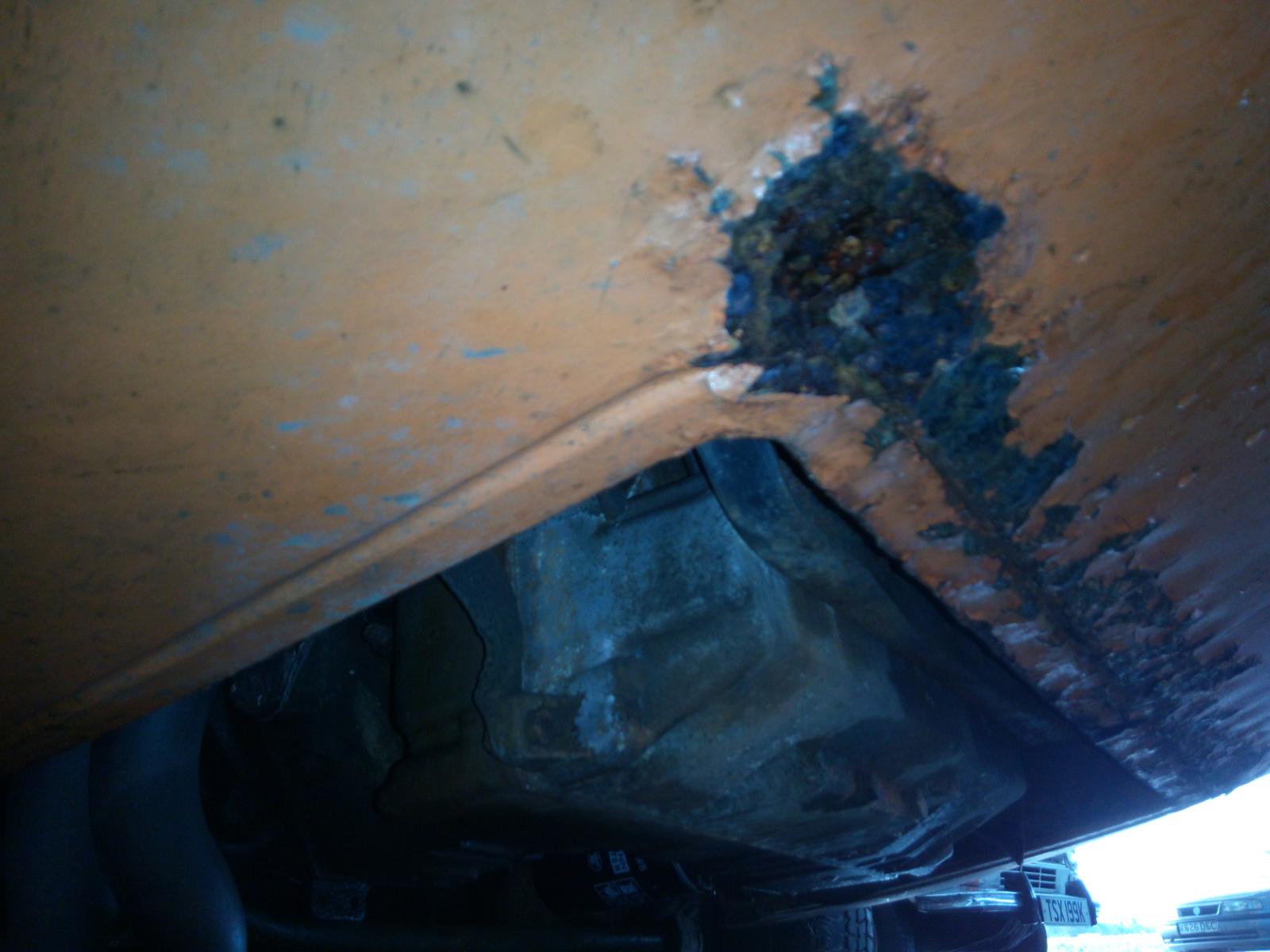

If I had bought it and it turned up at mine I wouldn't be kicking myself stupid, the bits underneath didn't seem to be falling apart, chassis rails appeared to still be box shaped and from what I could see (because I couldn't get to them) just surface rust but I would guess it is one of those sell it now or open your wallet situations.
There is no battery in the engine bay so obviously nothing system wise could be tested.

My phone seems to have eaten the picture of the boot floor which has a hole on the passenger side, the rest is covered by the sound deadening.
