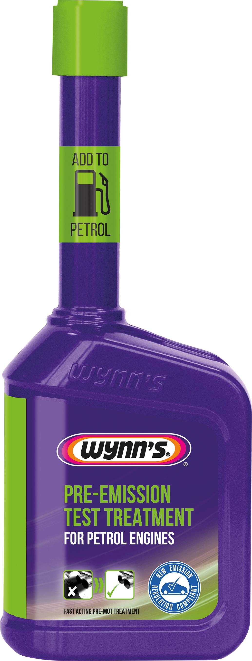

I've seen the garage local to me use snake oil like this before the test and it's got the car through. It depends how far out it is though. Obviously doesn't work on LPG.
Wynn’s Petrol Pre-Emission Test Treatment 212526
