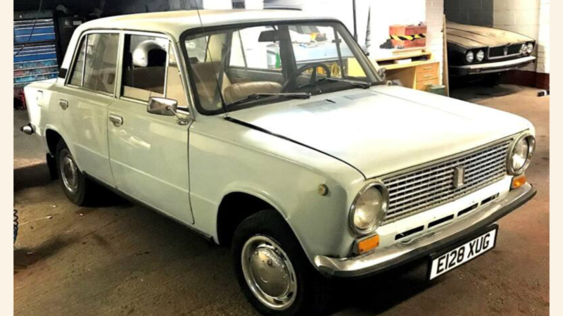

HMC Posted December 19, 2020 Author Posted December 19, 2020 Arches great, sills good, rear sill/ inner arch bit crusty Where they join and a couple of its on the floor. I’ve had a w210 that was worse. (Is that not saying much?) Verdict- quite well preserved. Looks like Maybe a Faded communist version of a dinitrol sticker on a door glass which may have helped matters. I was hoping for some comedy eastern block tyre names but they all look fair recent and bought from a uk supplier. privatewire, Split_Pin, Jim Bell and 9 others 12
