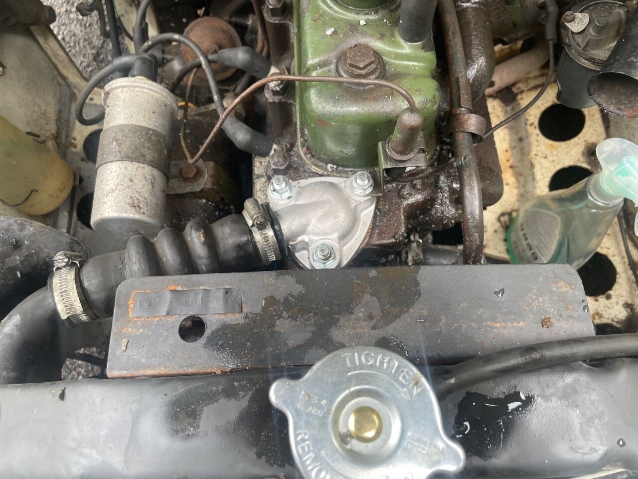

Remember my poorly minor? cooling system woes with pressurisation but i didn't feel it was the headgasket….
Looking at the history theres an invoice where this came up a couple of years ago (when the car was last used i recon) where the the head was pronounced ok but the rad was replaced. Doesnt look like the ‘stat was…
Result? Its sorted it. Presumably it was totally blocked, which was consistent with the top of the rad staying cool. Happy days, Although i might just give the lot a good flush out when i have time.
Why is the gunk multicoloured? Or is it just a trick of the light?
Looks like they used the wrong sort of anti-freeze, which has reacted and formed the gel.
Probably worth doing the bypass hose, removing the water pump in the process so you can clean out the rest of the water ways, if you haven’t already.

That looks like a pretty classic example of what happens when you mix coolant types.  Either that or it has been left sitting for decades and the water has evaporated just leaving the solids behind.  My money is on the former though.
It would be well worth thoroughly reverse flushing the whole system as there absolutely will be more of it in there.
Definitely worth doing this. It does look like different coolant types have been mixed and reacted forming the crystal like gel. It can corrode soft metals if it’s left long enough too (like ally castings and even solder used in old radiators etc). If that’s what’s visible where it’s got stuck against the thermostat there’s most probably more still in the system. Radiators and heater matrix are favourites for getting clogged with it!
I had a similar issue with my Capri when I got it running again. The Thermostat got plugged up pretty soon after getting it running. It was full of whitish scale and sandy crud though which I think was just from the inside of the engine building up over the years. When the engine was stored it was drained and left dry which loosened it all. Then when I refilled it and ran it again it all just got washed around the system until something blocked it - the thermostat!

At least half the thermostats I've ever changed have looked like that
