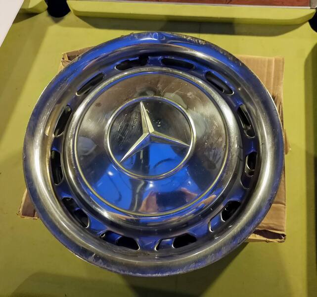

Well I learned something this afternoon: apparently there is more than one type of these trims to suit different wheel offsets.
These are about 1/2" too shallow to clear the centre of the wheel dish.
Balls.  Back to the drawing board I guess.  I know there is a version of these which fits as I've seen a T1 with them fitted, so they are out there (unless that van was wearing non-standard wheels of course), so back to looking for those or the smaller centre caps.
Thanks to SK for bringing them down anyhow, really appreciate it.

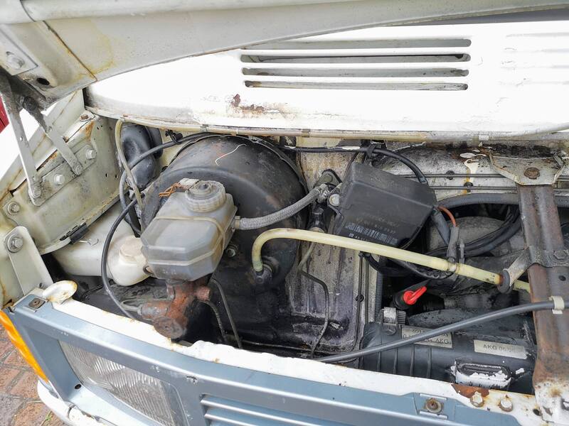

Some of you may recall I had issues with the clutch master cylinder on the van a few months ago in that it wouldn't hold pressure, so the clutch would slowly engage itself again over the course of a few seconds even if the pedal was kept to the floor.
This was initially resolved by thoroughly cleaning it, however the problem has now resurfaced...so I think it's going to be time for a new master cylinder this time...have got one on order.  Hopefully no more comedy kangaroo hopping away from junctions once that's fitted.
Both it and the Xantia are due a service too, so need to get the stuff in for that shortly.

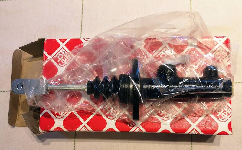

Care package arrived for the van today.
Thumbs up for Simply Car Parts...I only ordered this on Monday evening!

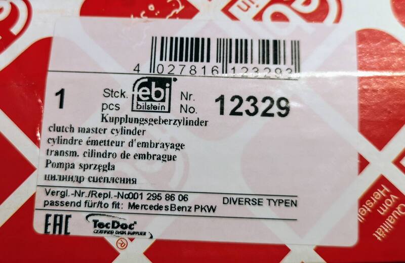

Here's the part number for those of you playing along at home.
This is what Mercedes would have ordered apparently...however didn't because the dealer has gone crazy and now won't order anything for me because it's a commercial vehicle and they insist that I deal with a local commercial vehicle specialist they've apparently partnered with.  Said specialist won't deal with non-trade customers - and even before that had been ascertained, literally laughed in my face when I went in looking for parts for a 29 year old van.
The guy at the parts desk at Mercedes agrees it's an utterly stupid situation and has on a couple of occasions so far gone well out of his way to get around this situation by tracking down which parts were shared with cars - this didn't show anything non-commercial though, only the 601 platform, so we were stuck.  Was a bit surprised they'd be ordering in a Febi part though...all the stuff I've had from them has been in MB packaging and if I recall usually showing as Bosch made.
Whatever...not going to grumble at a Febi part, I trust that just as much as a Bosch part with a Mercedes logo stamped on it.
Just a shame Mercedes have made such a daft decision, especially as their heritage parts support has always been so fantastic (and I'm sure it still is for passenger cars), I was staggered the first few weeks I had the van and they were able to find me a replacement seems lens for the cracked indicator light on the dashboard...
Not going to let it spoil things though...doesn't mean I won't rant about it though!

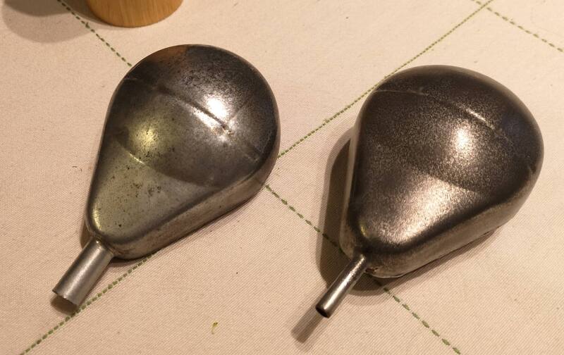

Nothing massive to report other that than with use TPA seems to just keep running better.  Had her out this afternoon to run a few errands, rubbing shoulders with rush hour traffic.  No bother.
Have finally brought the PCV valves picked up last week inside for a clean up and fitting when I next get a chance.  They're used examples but in a lot better state than the ones on the car currently.
No idea whether I should expect this to make any difference to running, but it certainly can't hurt I figure.

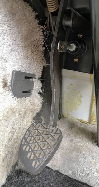

New clutch master cylinder is now fitted to the van.
Only slight headache was discovering that the hose clip had cut into the hose to the reservoir meaning I had to trim the end back a little, so the hose is now a little too short.  Not a major issue in the grand scheme of things, hose looks pretty crusty anyway so probably not a bad idea to change it anyway.
The test drive revealed quite how bad it had become.  The gearchange is considerably more slick now which leads me to believe that we weren't seeing the full range of motion actually at the clutch end.  The pedal is also a good deal lighter which is surprising given it was already surprisingly light for a design this old.
Next task there is probably going to be getting hold of some more fuel line and swapping out the tails which connect the rigid vacuum lines around the fuel pump together (I'm assuming they're something to do with the system which raises the idle speed slightly when the engine is cold) as they have perished a bit, and I figure it just makes sense to get them dealt with while I'm thinking of it.

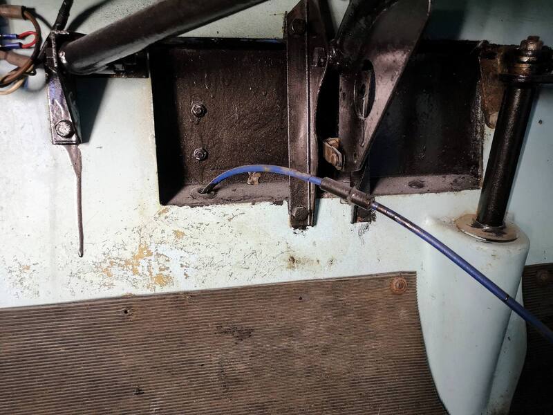

Would you mind photographing the physical layout and run of the outer throttle cable on TPA  from handlebars to carburettor? The layout on REV could be improved I think; it was done at the FoD because the old cable fell apart and so wasn't able to reproduce the exact cable run of before, which did work well. I gather it was based on the layout on Dolly, which may not have been the most ideal example to use for reference! There doesn't seem to be an obvious route for them to follow, so it would be good to see how and where the throttle cable runs on other Model 70s, to get an idea of where best it should go for ease of free movement.
You mention also the 'joiner under the dash' - could you elaborate? REV's new throttle cable goes end to end in one long run, with no joints.
I have seen that REV''s original (broken!) outer cable had a grease nipple along its length to enabel the addition of grease for lubrication. John, the gentleman who had REV and Dolly previously, advised that the nylon inserts in the outer throttle cables used to be removed on fitment, to ease the movement of the inner cable...
Many thanks!
Will grab a photo when I get a chance.
From memory it heads under the car following a similar route to the handbrake cable, then runs through the cutouts in the chassis outriggers along with the wiring loom.
The joiner under the dash I believe is the grease point.  This is about 1/4 of the way between the bulkhead and the handlebars for me.
Just realised I can do better as I have photos of KPL's underside from when we did the initial inspection.
I've arrowed the cable where it drops under the car.
Hope that's helpful!
Oh...and make sure the cable goes up through this little eyelet on the transmission so it stays clear of the CVT belt.

Firstly, Mrs6C... here's the "join" in the throttle cable under the dash.  It does look to be a grease point, though the cable outers are just a friction fit in the ends of it.

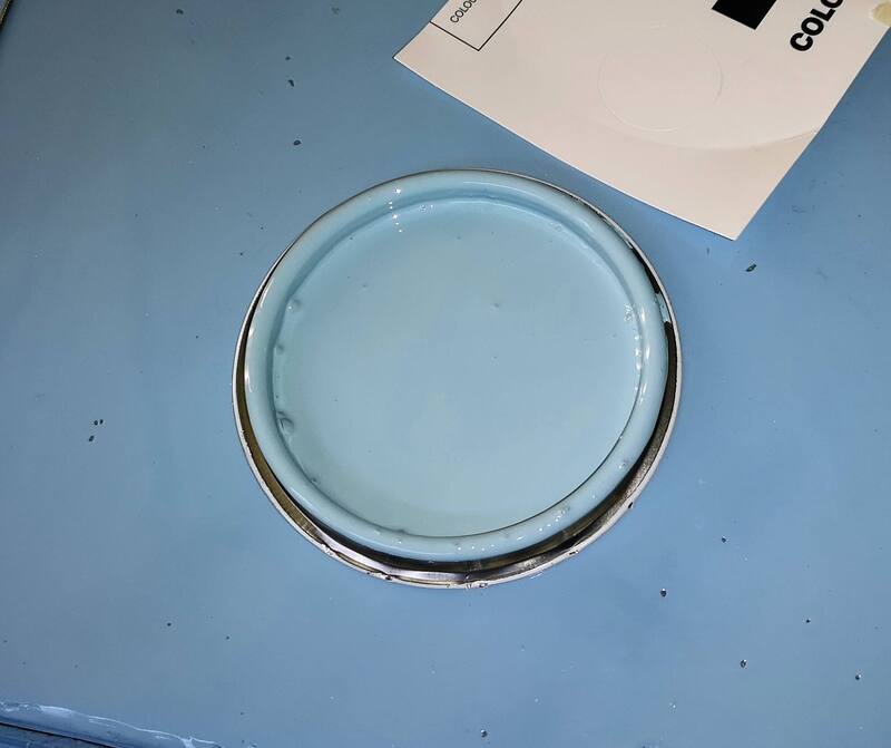

I have paint!
Took a bit of discussion to come round to what was probably the best compromise in terms of being sprayable with the equipment I have, being suitable for the substrate, and not being horrifically dangerous so as to require a respirator with a remote air supply.  We got there in the end though.
£11 for a litre - and a litre should go a lot further in a proper spray gun than in rattle cans if my prior experience is anything to go by.  The Halfords rattle cans were the best part of a tenner each.  Yeah...this should save me a few quid.
This paint has really good high build properties apparently, so all the better for scruffy fibreglass.
Picked up a suitable mask while I was there too.
Haven't even come close to having time to get the spray gun out today, but couldn't resist having a peak.
It's really hard to tell in the can obviously, but it looks a decently close match for my purposes.  If anything it's slightly lighter than the Halfords paint, which if it's not a perfect match is what I'd prefer.
Worth noting that the engine cover in shot there has several coats of clearcoat on as well, which this paint shouldn't require.  So that may also explain why it looks a bit darker.
No, there would have been nothing to stop me getting them to mix up the original colour at this point - sticking with this Ford colour is a purely personal choice at this stage.  I just like it better.

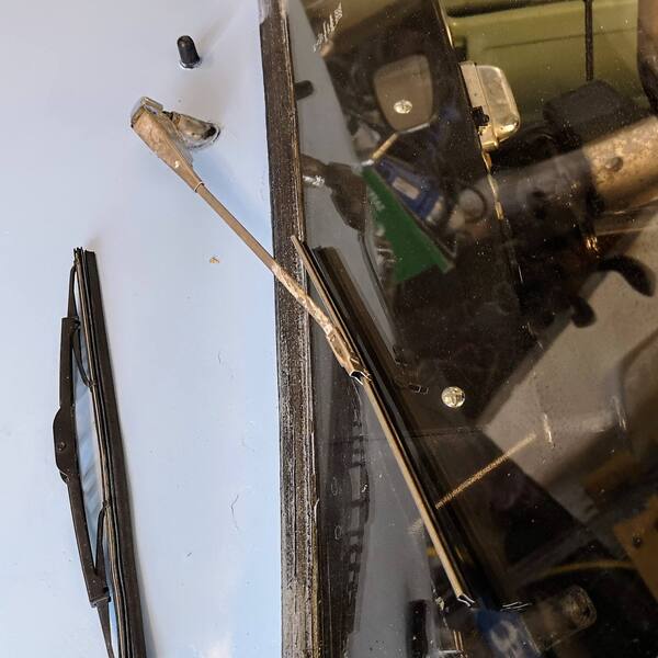

No idea if I'll have a chance to get anything done tomorrow at this stage....but I'd obviously like to get some spraying done.
Another part for the Invacar arrived this morning in the post (which I'd totally forgotten ordering).
The blade I'd been using was stuffed despite having been on there only a few months and nobody locally stocks 10" ones any more.  Nor do any of the refill kits I have fit (the blade is too fat to fit in the retainers)...so I just ordered one.  Figured if I was doing that anyway I may as well get something that looks vaguely in period.
I'm not holding out much hope for it actually being even vaguely useful in terms of actually clearing the screen - but at least it won't scratch it when I forgot the existing blade is knackered and turn the wiper on in error again.  I've already got very lucky in that regard twice.
